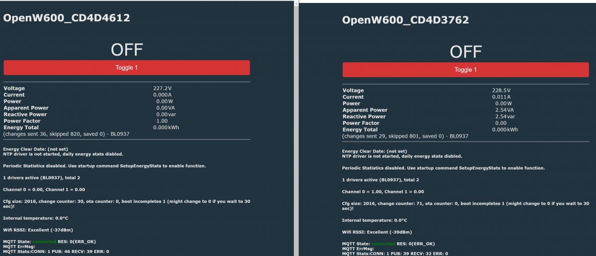

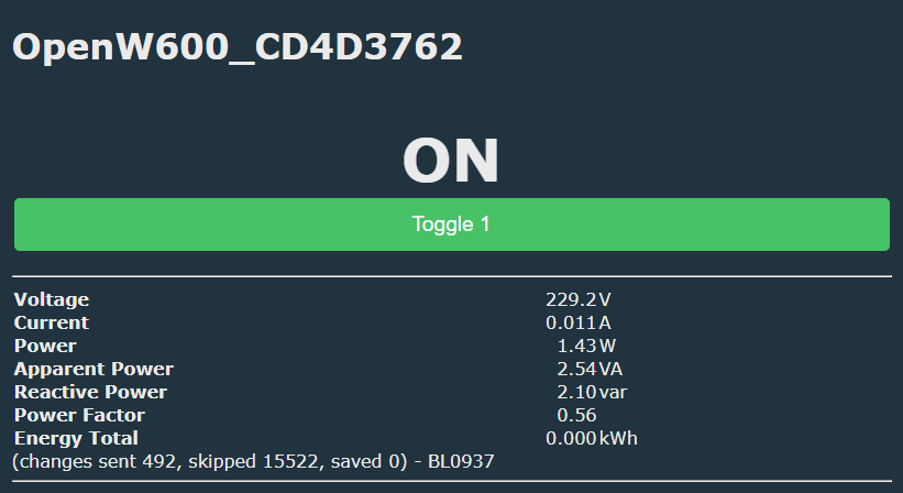

    I find that the power measurement report "1.xx Watts" consumption also with no LOAD
    Also if the plug is set to OFF
    I find a FLAG for not sent via MQTT the values when the plug is OFF (I think it is a workaround),
    but I would like to understand if there is:
    - a problem with the BL0937
    - a problem with soldering of W600 chip (TW-02)
    - a problem with some kind of pin configuration
    I have two smart plugs and One is more stable than the other,
    so I presume it can be a hardware problem?!?
    Someone else have this "phantom power" ?
    P.S.
    I am on the last firmware version OpenW600 1.17.540

    First of all, have you calibrated your device? With VoltageSet/CurrentSet/PowerSet commands, etc? Or via Web App (tools section)?

    yes, all calibrate with 60W lamp
    the phantom current is 0.011A
    the phantom power is 1.43W
    for now, i found only a "workaround" to not send this "phantom power" to MQTT with the command:
    VCPPublishThreshold 0.5 0.015 1.45 0.01

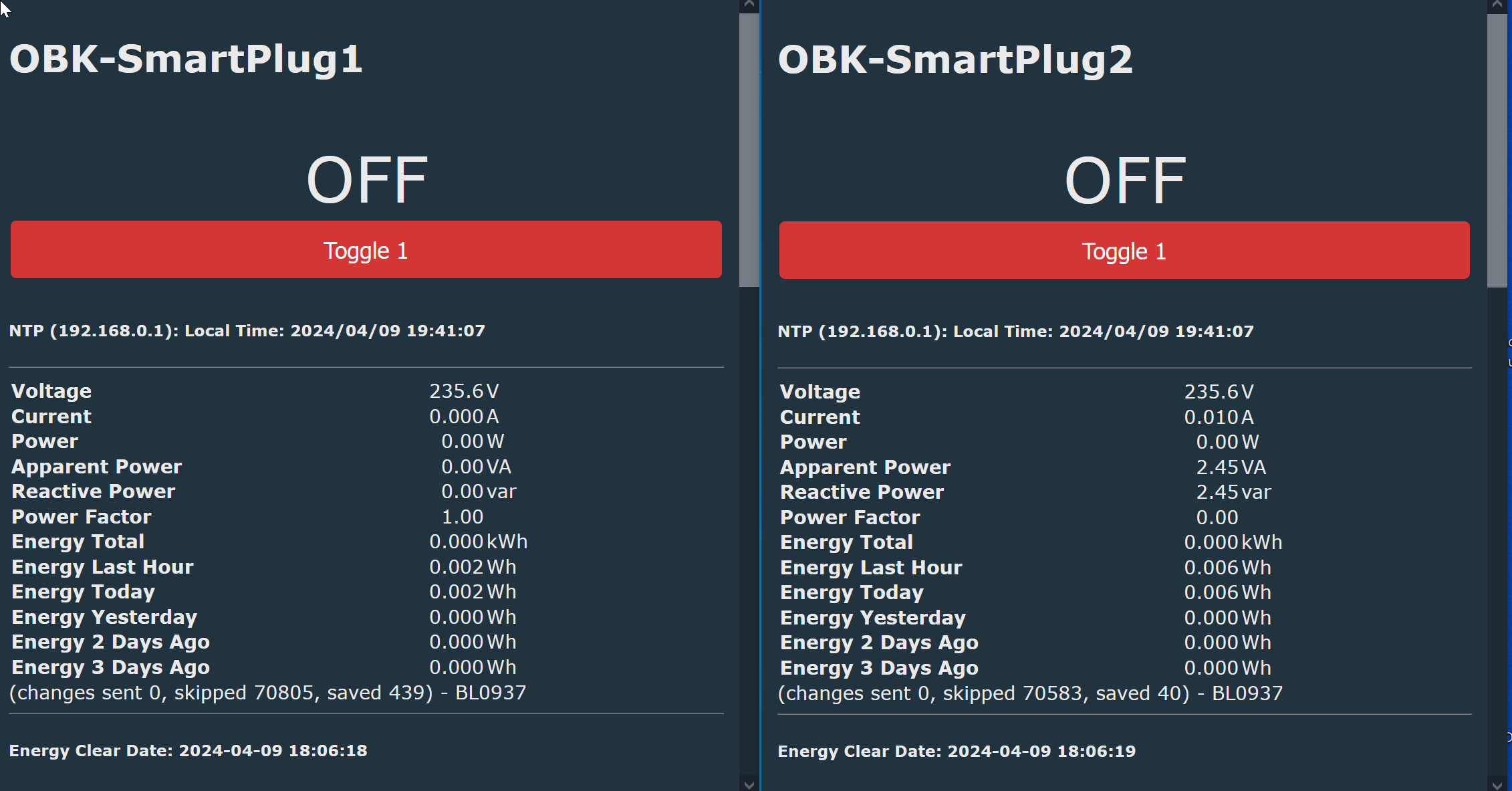

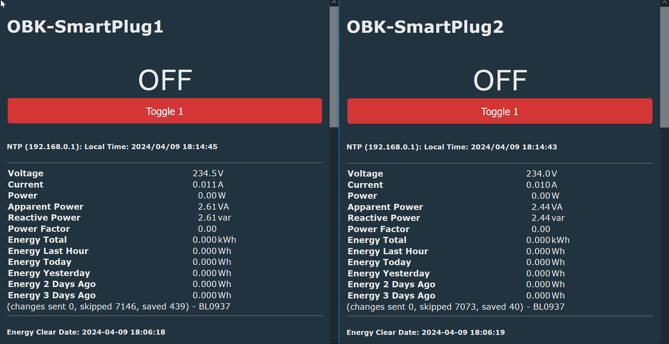

    Kind of:
    Two screenshots of the control panel for smart plugs OBK-SmartPlug1 and OBK-SmartPlug2, both turned off.
    It is comparatively rare, about +/- 0.02 W, "OBK-Smartplug1" and "OBK-Smartplug2" are not synchronized and the following situation occurs very rarely:
    Two screenshots of the control panels for OBK-SmartPlug1 and OBK-SmartPlug2 showing voltage, current, and energy consumption data.
    Both were plugged into the same strip and were therefore energized at the same time. Nothing connected - empty sockets.
    It's Action LSC Smart Power Plug 320 2087
    Build on Apr 8 2024 09:55:01 version 1.17.540
    Short name: OBKSP1, Chipset BK7231N (CB2S)
    P.S.: Both were calibrated as a compromise with a 60W and a 100W bulb, a 4-digit true RMS DMM (nnn.n V) and a not true RMS DMM (n.nnn A)

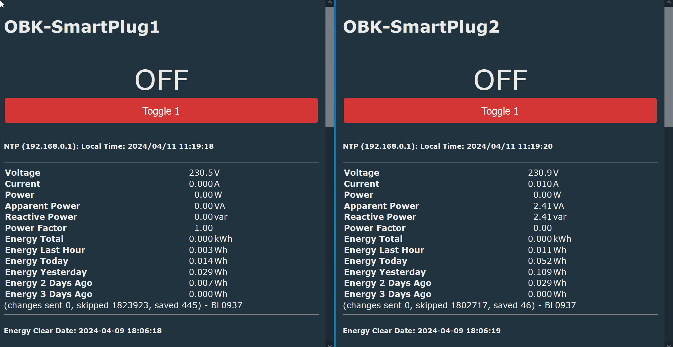

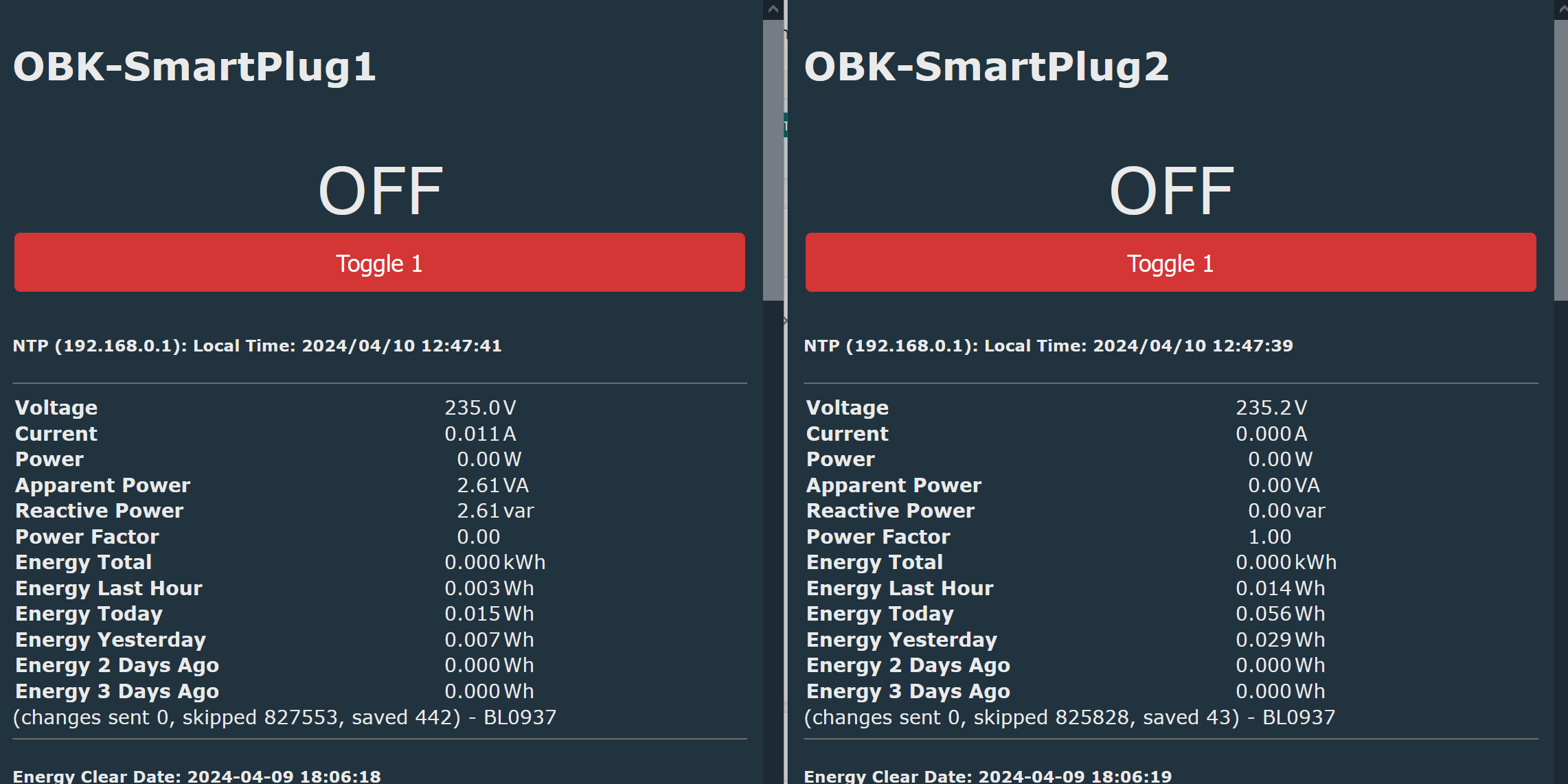

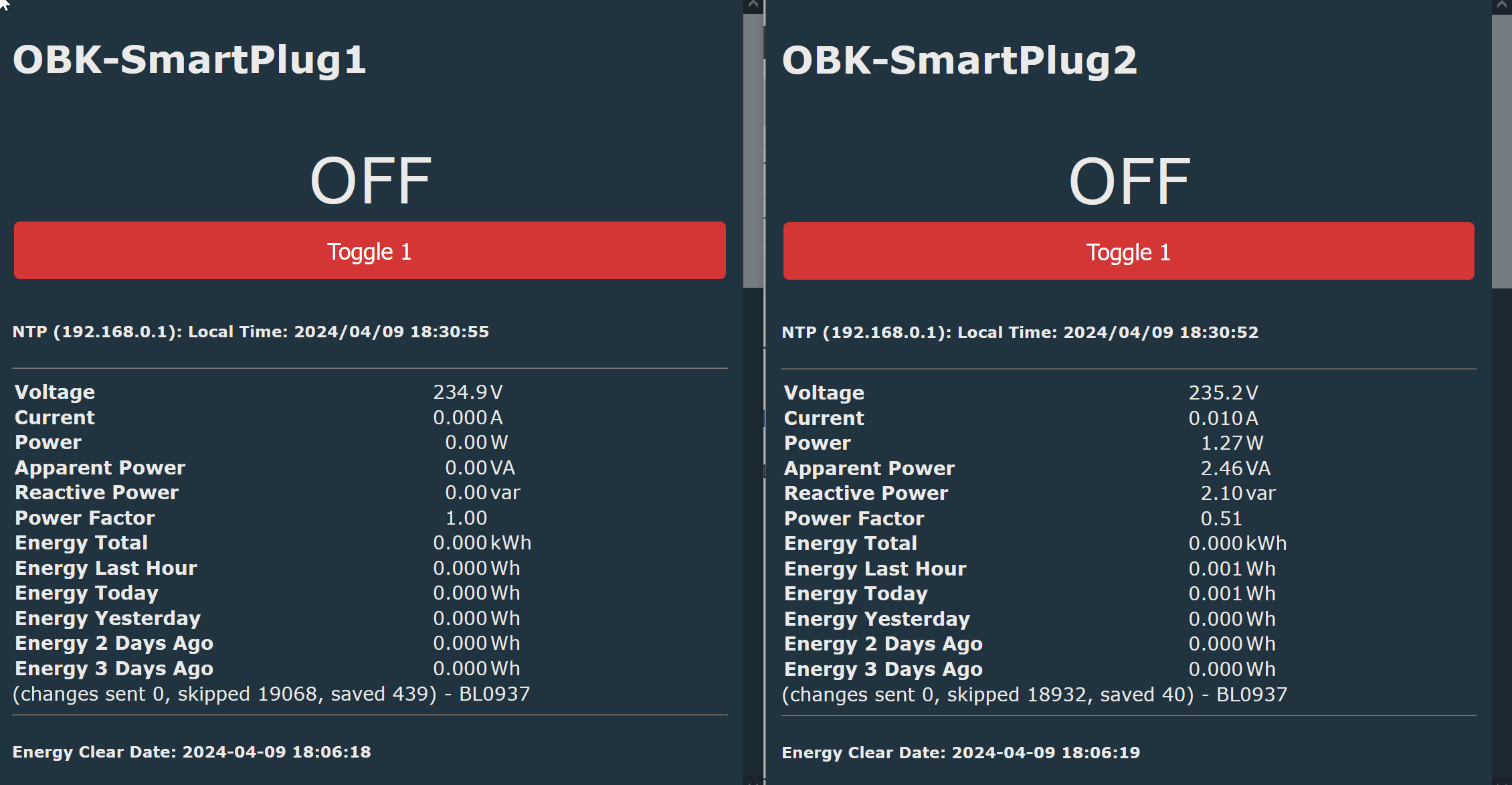

    Added after 55 [minutes]:
    The situation is now as follows (Energy last hour/today)
    Screenshots of two browser windows displaying data for OBK-SmartPlug1 and OBK-SmartPlug2 smart plugs.
    (The screenshots are two browser-windows side by side at the same time)

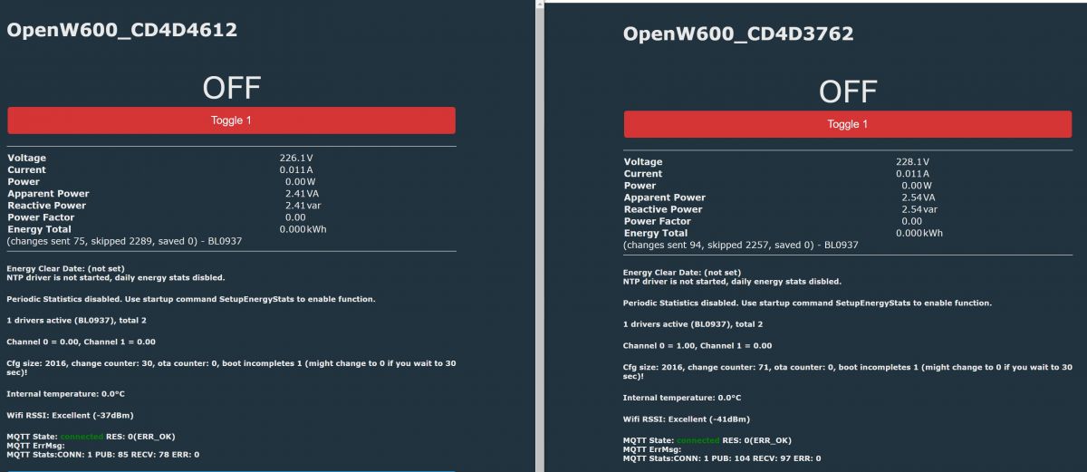

    >>21039272
    exactly like that:
    Two status cards for OpenW600 devices with different power data.
    Screenshot of two user interfaces for OpenW600 plugs, showing differences in energy data.
    Screenshot of two OpenW600 interfaces showing differences in energy parameters.
    the one in left have less "phantom power" than the one on the right... but they are the same Chipset W600 smart Plug with the same firmware version 1.17.540
    The question is:
    it depend on firmware?
    or on hardware?
    Added after 34 [minutes]:
    Before we debug any further, can you tell us whether you're using PowerSave, the so-called dynamic sleep?
    We already had reports saying that PowerSave breaks BL0937 precision because BL0937 works by sending pulses which are counted by GPIO interrupt and dynamic sleep is messing with that...
    Still, I don't think it's PowerSave, judging from the description of the problem, but it's still worth to check.
    normally I have "PowerSave 1" in startup command,
    but I send the command "Powersave 0" to test...
    Nothing change

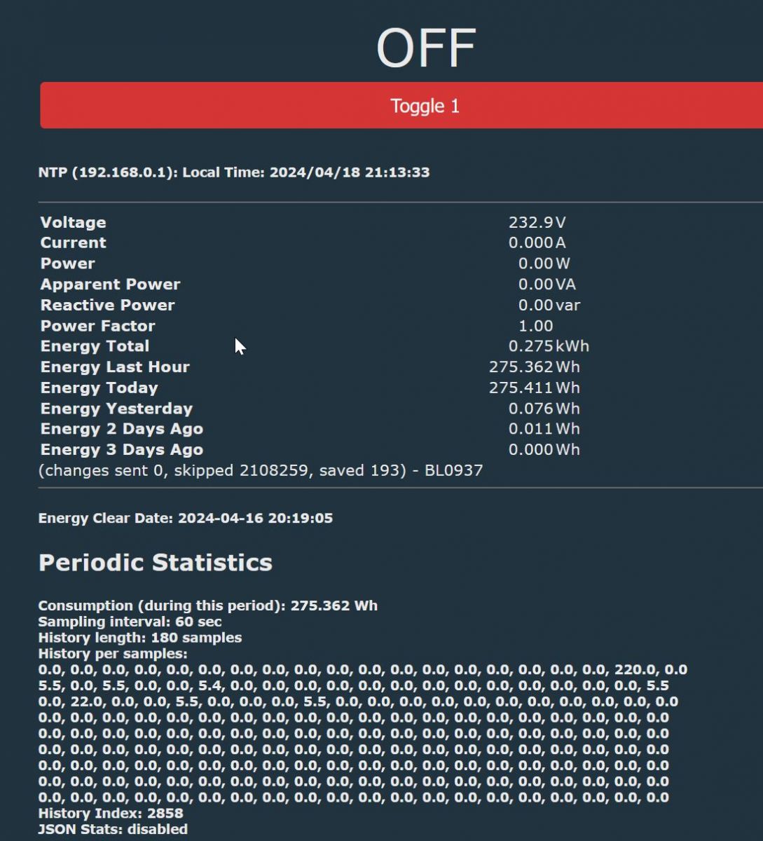

  • Intermittent phantom power readings accumulate over time
    #8 21040120
    ElektroTechnikus
    Posts: 22
    That's the current state (Energy sums)
    Screen displaying energy data for two plugs OBK-SmartPlug1 and OBK-SmartPlug2, both turned off.
    My startup command is:
    backlog startDriver ntp; ntp_setServer 192.168.0.1; ntp_timeZoneOfs 1; ntp_setLatlong 50.012345 7.012345; waitFor NTPState 1; setupenergystats 1 60 180;
    Higher loads I'll try in the evening... The (apparent and reactive) "powers" are only sometimes and only briefly non-zero, the real power is very rarely, but it adds up.

    - the "phantom power" in my case is 1.43W
    - this "phantom power" in my opinion is also "added" with all the power measurements
    ES:
    initial 0W -> sometimes measurement 1.43W
    with load 5W -> sometimes measurement 6.43W
    with load 10W -> sometimes measurement 11.43W
    etc...
    I think so because the timing when the measurement is 0W or 1.43W
    is the same that changes the measurement "onload" change... from NORMAL LOAD (W) and NORMAL LOAD + 1.43W

    Apparent and reactive powers IMO should not add anywhere. They are certain aspects of loads, that shouldn't be counted by the electricity meters, but they place a (higher/additional) load on the power lines due to the (higher/additional) current they are associated with. This is the reason why a PFC* is mandatory for PC power supplies, for example. Only the active power is counted and paid for, but the grid has to bear/transport the reactive power, too.
    I think, as seen in one of my screenshots, the BL0937 fakes sometimes some active power, too. However, this happens very rarely and only briefly.
    The "better" of my plugs is directly plugged in a power strip, the worse has a cheap energy counter in between. Tomorrow I will interchange both and conduct a "high power" test with a water kettle and a toaster...

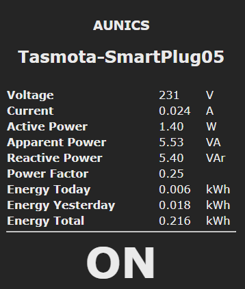

    I found another smart plug with BL0937
    This smart plug uses ESP 02s chip so I flash Tasmota on the chip.
    Well the problem is always present:
    - power on without load and the measurement is 1.4 W
    :O
    Screen of Tasmota smart plug showing power readings.
    Screen showing the OpenW600 smart plug interface with energy consumption information.
    I calibrate with the same 60W lamp:
    the result in phantom watts are similar, but I see that the phantom current and the power factor during phantom power is different
    but for the "main" PhantomPower problem I think the cause is the BL0937 chip that makes the measurement
    (maybe the watts consumption of the BL0937 chip itself? or the consumption of the smart plug?)
    I search other plug to test, but maybe this thread can be closed

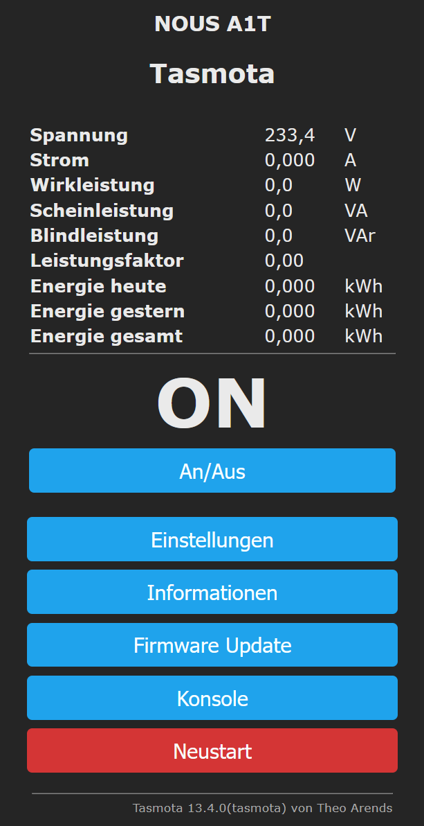

    With two NOUS A1T/BL0937 on Tasmota 13.4.0 I surprisingly don't have this problem (as mentioned above). They remain rock solid at zero. However, I have now found out by experimenting with resistors that power measurements below 2 watts are not really reliable, even with the NOUSs.
    Tasmota interface displaying electrical parameters for NOUS A1T.
    One of the two LSC plugs (the "worse" one) has even been very erratic in the last hours: it has conjured up 275 W/h from somewhere, 220 of which in just one minute. For some unknown reason, it was switched on when I got there but could no longer be reached via WiFi. I should probably keep an eye on that?
    Electric energy measurement screen showing consumption and power values.
    The connected appliance is a tumble dryer, but it must have been in STBY mode (real mains switches have become very rare...)
    So I think, too, the quality of the BL0937 is not particularly good and possibly fluctuating and it therefore depends very much on the material circuit design and the software how "nicely" the measured values fit into reality.

What noise floor should I expect at zero load?
Tiny flicker is normal. One test showed about ±0.02 W with occasional brief nonzero active power on two BL0937 plugs. This reflects unsynchronized sampling and line artifacts, not real consumption. Filter below your acceptable threshold to keep logs clean. [Elektroda, ElektroTechnikus, post #21039272]
Does Tasmota or Tuya hide low‑power readings on purpose?
Yes. Some platforms mask low values to avoid confusion. “BL0937 is not a precision measuring device,” and vendors often hide sub‑4 W readings to suppress visible noise. Expect approximations, not lab‑grade metrology. [Elektroda, miegapele, post #21043313]
Are readings below 2 W trustworthy on BL0937?
Treat sub‑2 W readings as indicative. Experiments with resistors on two NOUS A1T (BL0937, Tasmota 13.4.0) found measurements below about 2 W were not reliable. Use thresholds to exclude that range in automations and dashboards. [Elektroda, ElektroTechnikus, post #21050950]
Why do two identical plugs report different power at zero load?
Part tolerances, design, and firmware matter. Two Action LSC BL0937 plugs behaved differently, while a well‑calibrated NOUS A1T stayed steadier at zero. Quality variation, circuit design, and software shape low‑load behavior. [Elektroda, ElektroTechnikus, post #21043304]
Is phantom power like this worth worrying about?
Often no. One socket added just 0.005 Wh per hour, which is ~44 Wh per year (~0.05 kWh). The poster called that “basically zero.” Prioritize significant loads unless your use case needs sub‑watt fidelity. [Elektroda, miegapele, post #21041926]

Can anomalies inflate energy totals suddenly?
Yes. One LSC plug added 275 Wh erratically, including 220 Wh in a single minute, and then became unreachable by Wi‑Fi. Monitor such devices and consider replacement if anomalies repeat. [Elektroda, ElektroTechnikus, post #21050950]
