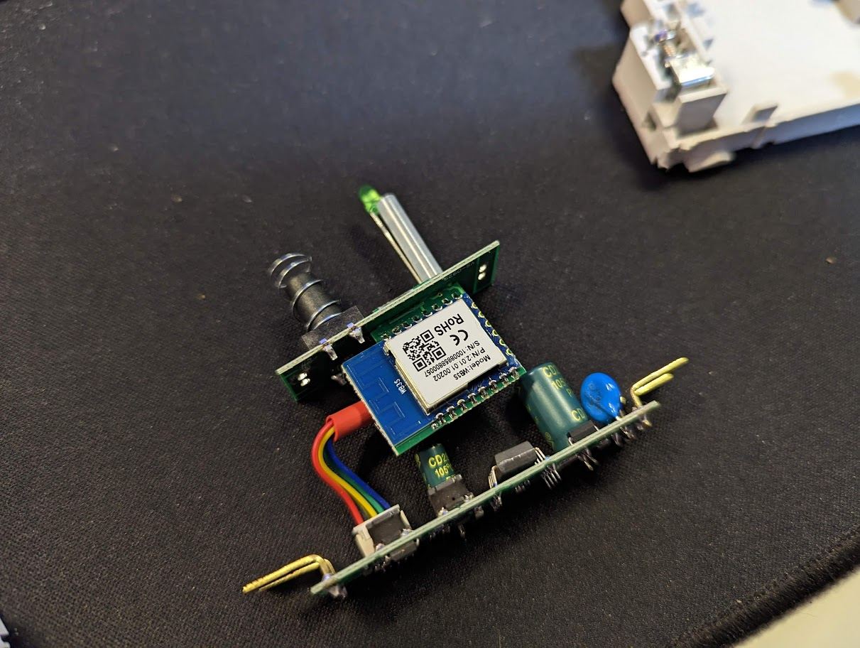

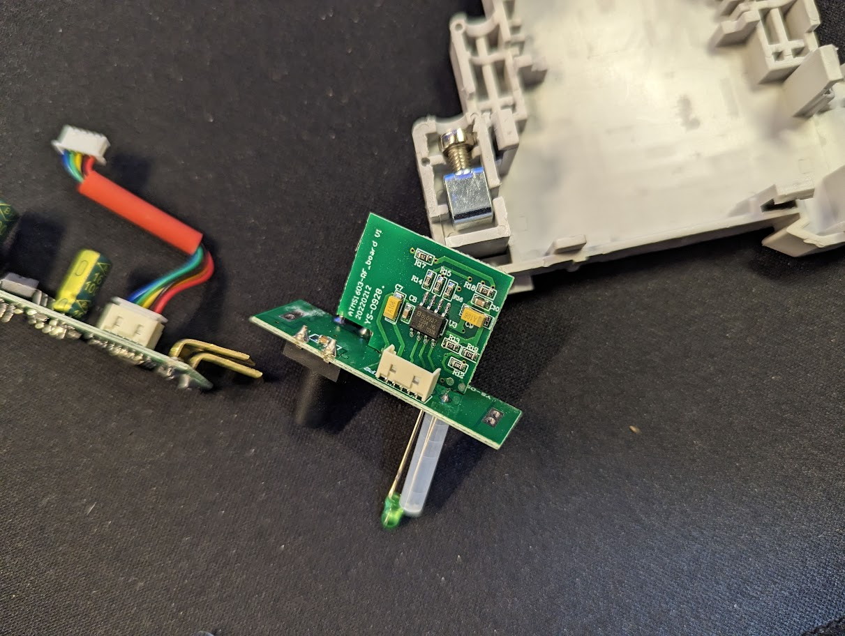

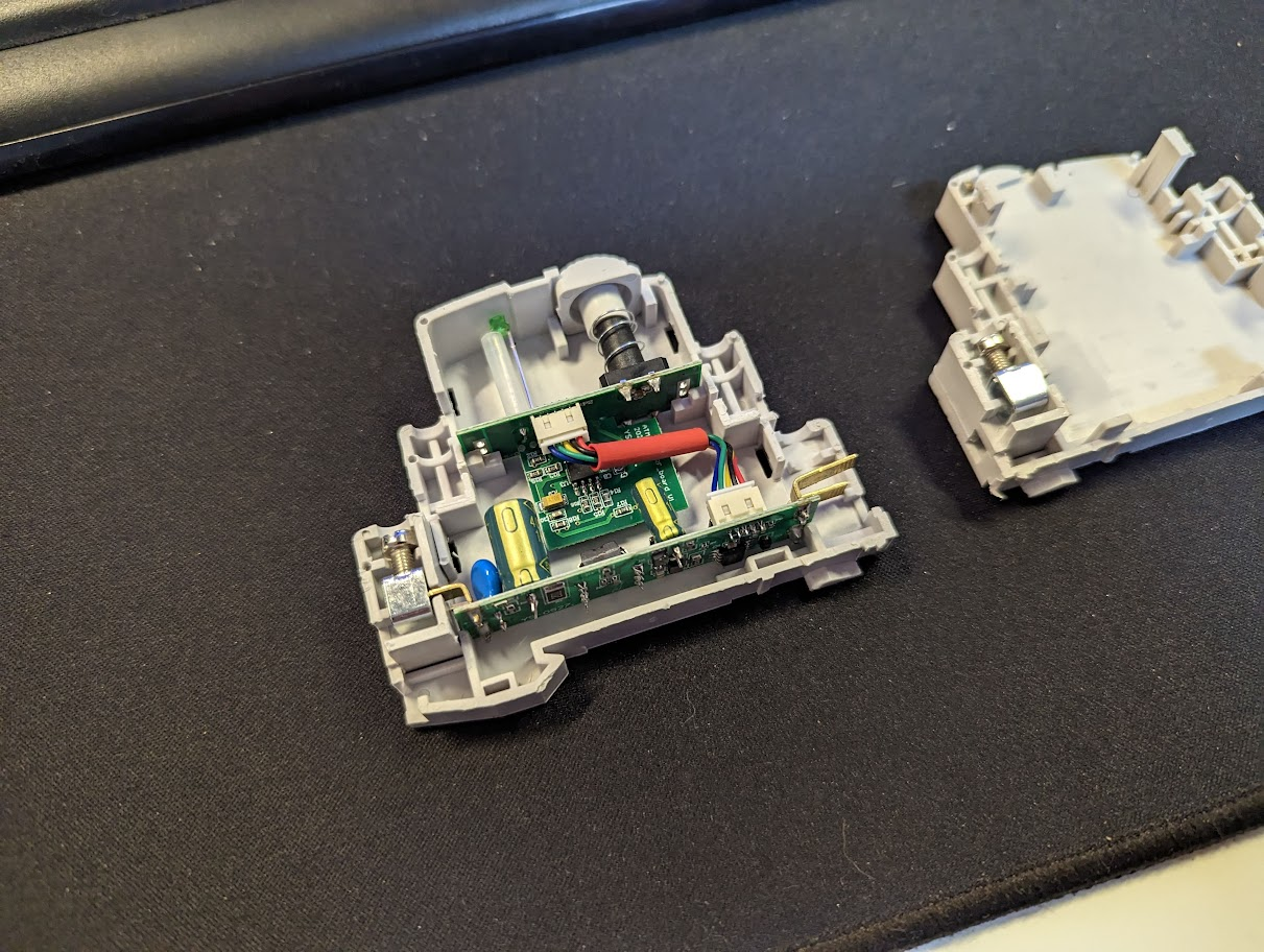

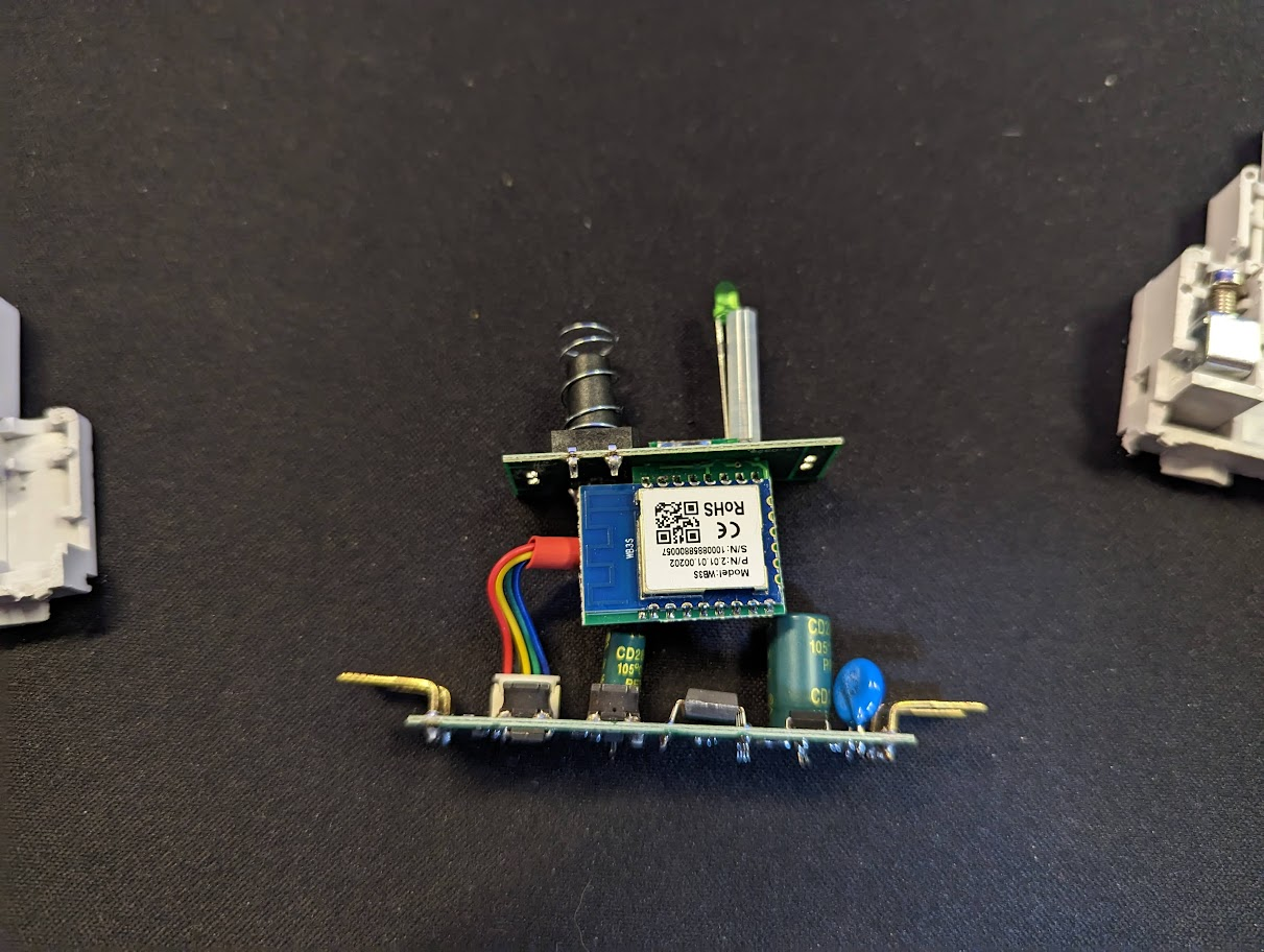

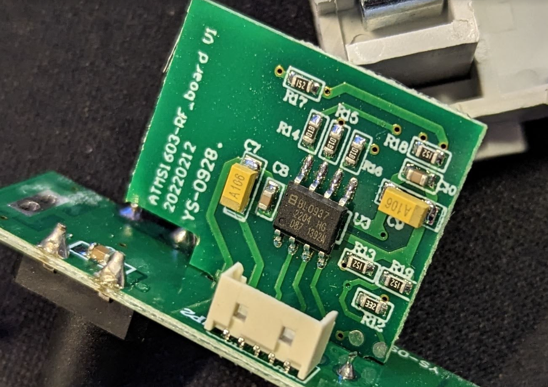

    I have now done a teardown.
    BK7231T
    BL0937
    Got a flash dump if needed.
    Flashed no problem with OpenBK
    Pins
    P24 - sel - pwm4
    P8 - cf1 - pwm2
    P9 - cf - pwm3
    P6 - led_n - pwm0
    P1 - btn - rxd2
    I will attempt to calibrate!

  • ATMS1603 firmware dump with BL0937 pin mapping
    #8 20541031
    anthonythomas
    Posts: 40
    Rate: 16
    Firmware dump attached.
      "vendor": "Tuya",
      "bDetailed": "0",
      "name": "ATMS1603 - Single Phase Single DIN Energy Meter Clamp",
      "model": "ATMS1603",
      "chip": "BK7231T",
      "board": "TODO",
      "flags": "1024",
      "keywords": [
        "TODO",
        "TODO",
        "TODO"
      "pins": {
        "1": "Btn;1",
        "6": "LED_n;1",
        "8": "BL0937CF1;1",
        "9": "BL0937CF;1",
        "24": "BL0937SEL;1"
      "command": "SetupEnergyStats",
