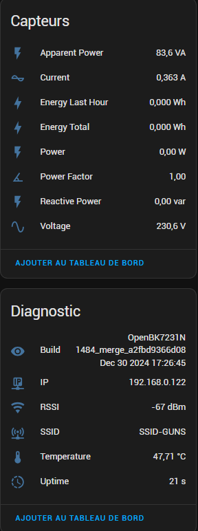

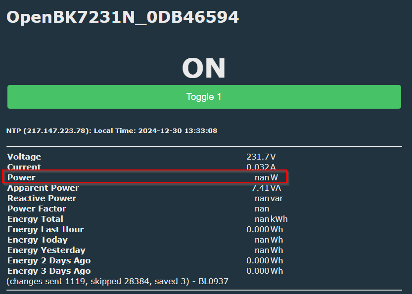

    Hi,
    I achieved to install OpenBeken on my Action SmartPlug with power monitoring (3202088). Tuya board CB2S.
    Everything works fine except the power that is always at 0 W.

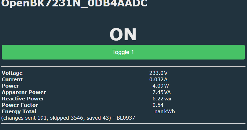

    Calibration was done using a non-flashed plug and then I see "nanW" (see picture)
    Screenshot of OpenBK7231N control panel showing voltage, current, and power reading as nanW.

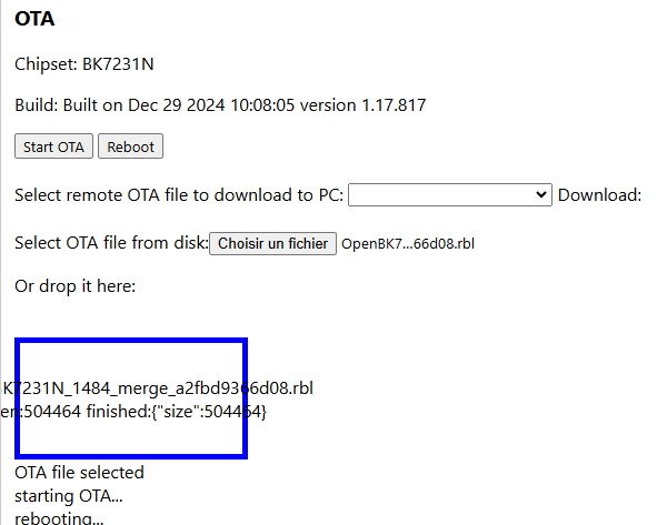

    Hi,
    I flashed using web app (I hope it's like that ;-)) Screenshot of the OTA application interface with firmware update details for the BK7231N chipset.
    no changes :-(

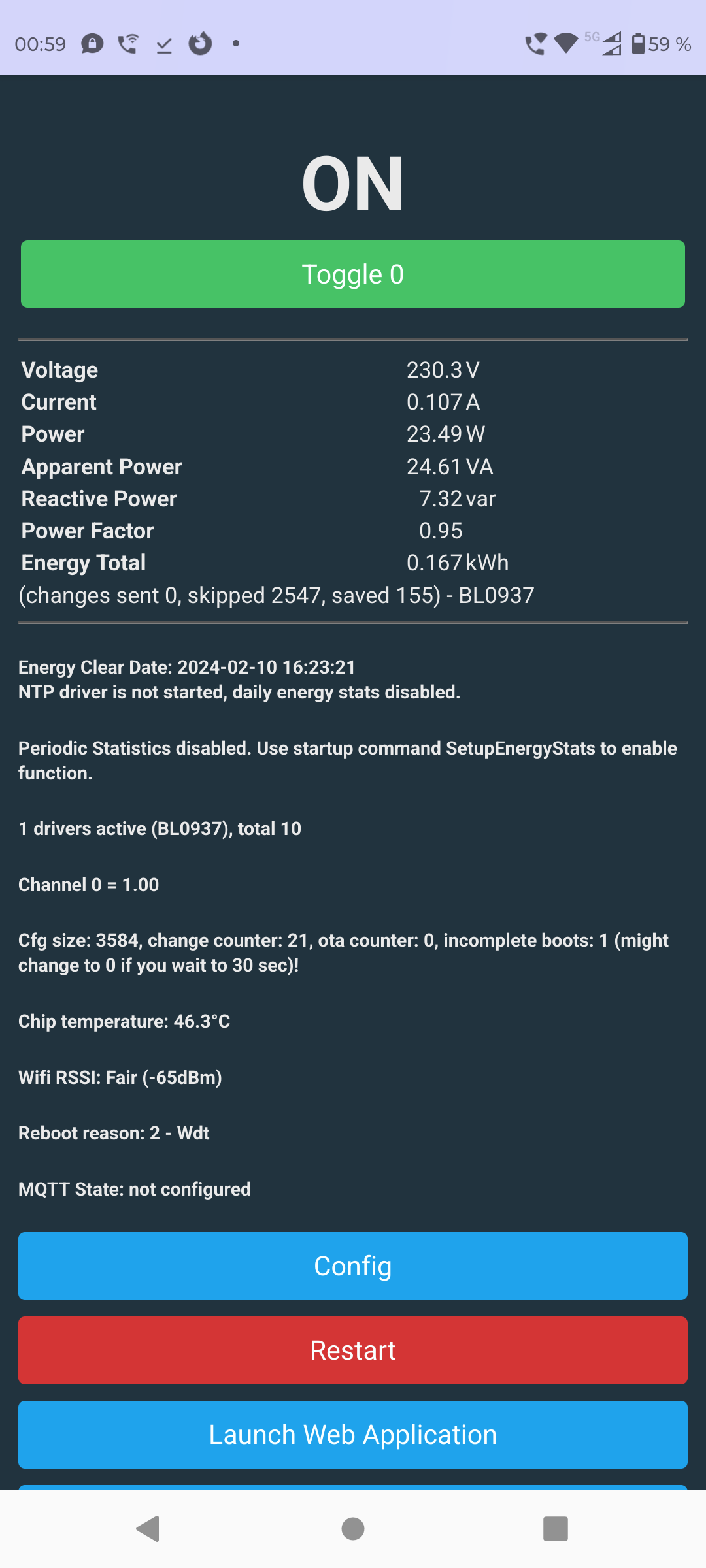

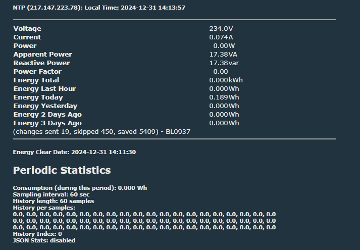

    hmm. not entirely sure. stab in the dark- is this anything perhaps fixed with your PR https://github.com/openshwprojects/OpenBK7231T_App/pull/1483 @max4elektroda ?
    you could flash anyway @guns57 https://github.com/openshwprojects/OpenBK7231T_App/actions/runs/12538557165
    Added after 13 [minutes]:

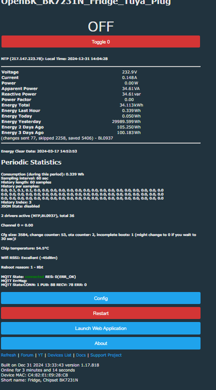

    just remoted home to check my BL0937 plug. turns out I wasn't running ntp for stats anyway.
    Screenshot of a device control panel displaying voltage, current, and periodic statistics.
    updated to general release and started ntp
    Screenshot of the user interface for the Tuya plug showing energy statistics.
    Added after 7 [minutes]:
    cleared stats and still ok.
    Screenshot displaying energy statistics and voltage readings.
    i dont seem to be able to replicate. my startup command currently is backlog SetupEnergyStats 1 60 60; startdriver ntp
    What are your current pin assignments?

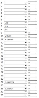

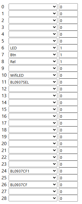

    My pins settings
    Table with pin settings for an electronic device, with various assigned values.

    guns57
    Posts: 11
    Yes mine are with CB2S and the flasher tool said that I have to use BK7231N.
    The pins config come from the flasher tool from the OBK file. I have no idea if it's right or not but all the features are working except the power.
    Screenshot showing device sensor and diagnostic information.

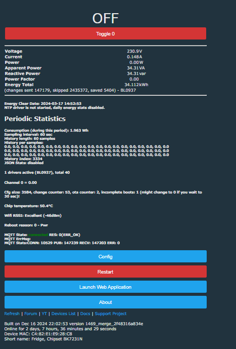

    But @divadiow what kind of load is connected to your device?
    It always reports 0 W, but current is higher on your pictures
    Just updated my LN882H to latest release to check (I don't have metering Beken device):
    Screenshot of an app displaying electrical energy consumption data of a device.

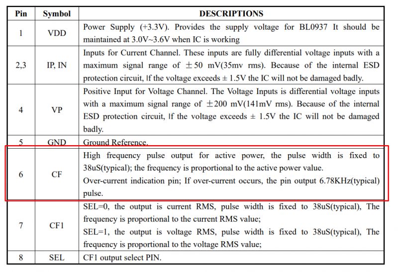

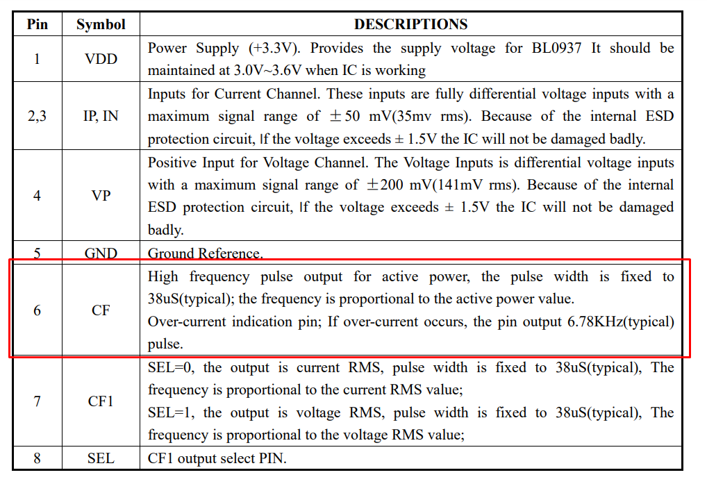

  • CF pin likely disconnected or misassigned
    #9 21371554
    Posts: 14795
    Rate: 12947
    If you have only invalid power reading, then it is relatively likely that CF pin is either disconnected (you didn't solder back module correctly) or incorrectly selected (your device is using different GPIO as CF):
    Table describing the pin functions of the BL0937 chip, detailing the CF pin highlighted as having a high-frequency pulse output for active power.
    How did you flash your device?
    CB2S don't have much pins, you should be able to narrow down to few which you have left to test.
    Btw, I think we need a separate pin role PulseCounter that just counts pulses to given channel so we can check if anything happens on his CF pin currently. I don't think so. I think his CF receives no pulses at all.

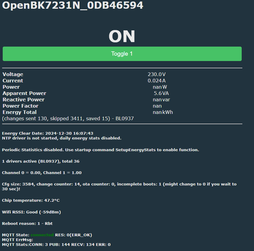

  • Calibration value 60.8 triggers 0W reading
    #22 21380980
    Posts: 5236
    Help: 450
    Rate: 919
    I've just replicated it I think- see the end of my post here https://www.elektroda.com/rtvforum/topic4093142-120.html#21380578
    all the values were fine until I changed the power from 60 to 60.8, to match my power measurement device
    Screenshot of calibration form with power input field.
    I've now done the same on the plug above to which I was posting about days ago:
    Screenshot showing measurement data for voltage, current, power, and energy.
    what did you change your values to?
    changing the value back to 60 does not clear the issue
  • #23 21381532
    guns57
    Posts: 11
    You’re right!
    As you, I changed the value. Before I had 0W and after I had NaN.
    Seems to be a software problem.
  • PowerSet calibration self-test added for BL0942
    #25 21382918
    Posts: 14795
    Rate: 12947
    I pushed a PowerSet /calibration self test and it just works:
    https://github.com/openshwprojects/OpenBK7231...mmit/5f53e20cd5640da9e4aaa23d0cde4e8dfca4ff59
    It also works with non-integers:
    Code: C / C++
    I think that you are rather getting errors because of 0 power that is read when you do calibration.
    When BL0942 (or BL0937) reports 0 pulses (uncalibrated), you get dividing by zero here:
    Code: C / C++
    The best I can do for you is to add warning here:
    https://github.com/openshwprojects/OpenBK7231...mmit/f20b5e22592a0bc1826d83331b3a0ea097102536
    You can't get it fixed because calibration will never work with 0 value reported by the BL0942 or anything you have. So if you don't have BL0942 connected, or your BL0942 is broken and reports 0 (uncalibrated), then you get divide by 0 on each PowerSet call, so you can't "undo" it.
    The problem is not software, the problem is that you have wrong BL0937 (or BL0942 if possible? Maybe BL0942SPI is used instead of BL0942 on UART?) pins, and you get power value 0, and then you break calibration futher so you get NaN instead of 0.
    And I don't think it's integer or not issue, it's just by accident, if you did those operations in the reverse order, then integer would break... @divadiow
  • #26 21383107
    guns57
    Posts: 11
    Today i installed the latest firmware OpenBK7231N_1.18.15 and it works now!
    For me it was definitely a software problem.
    User interface with current electrical measurements for the OpenBK7231N system.
    thank you for your job!

What should I check first if voltage and current appear but active power stays at 0 W on an OpenBeken smart plug?
Check the metering pin mapping first, especially the CF-related power pulse path. In this thread, the expert said that if only power is invalid while other readings appear, the CF pin is relatively likely to be disconnected, wrongly selected, or assigned to the wrong GPIO. That makes power stay at 0 W even though the rest of the plug still works and calibration commands seem available. [#21371554]
