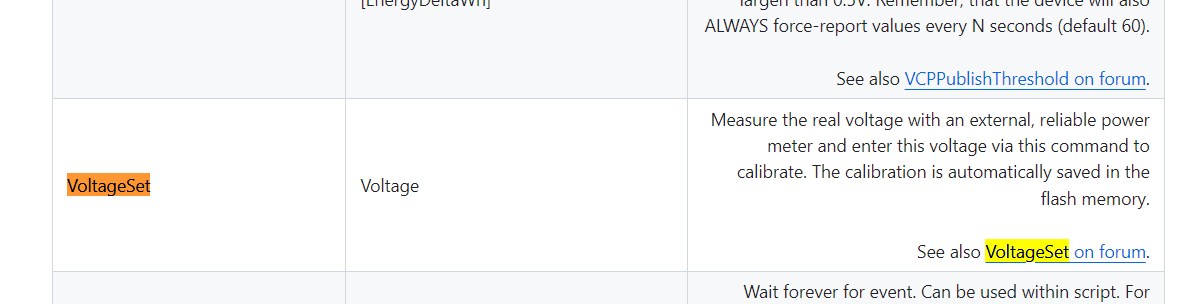

    1. You can use the commands VoltageSet , PowerSet , CurrentSet , whose names and syntax are the same as in Tasmot. We calibrate analogously to Tasmota.
    Here you have a list of commands:

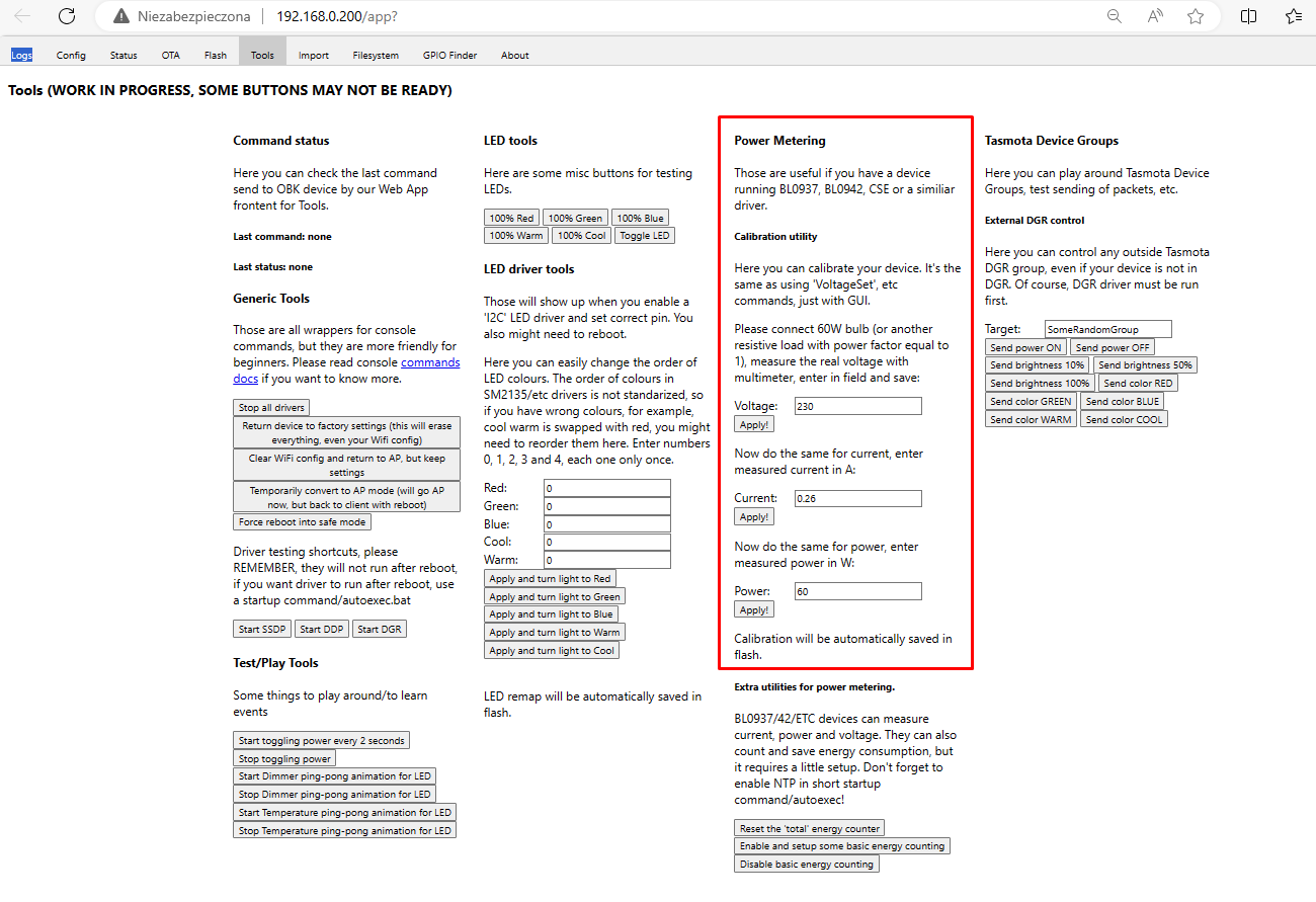

    Screenshot of a table from OpenBeken documentation showing the VoltageSet command. 2. You can use a GUI overlay downloaded from Github, i.e. open Web App and under ToolsScreenshot of a table from OpenBeken documentation showing the VoltageSet command. 2. Tools is Calibration :
    Energy measurement calibration tool interface in OpenBeken. Basically in the paragraph Calibration it is written in English what to do. This overlay uses the aforementioned commands anyway VoltageSet and so on, simply packs them into the HTML form
    For real measurements (current, voltage, power) for the VoltageSet/PowerSet/CurrentSet commands you can at least use a second unflashed socket you have or some other meter. I recommend using a classic 60W tungsten bulb as a test load.

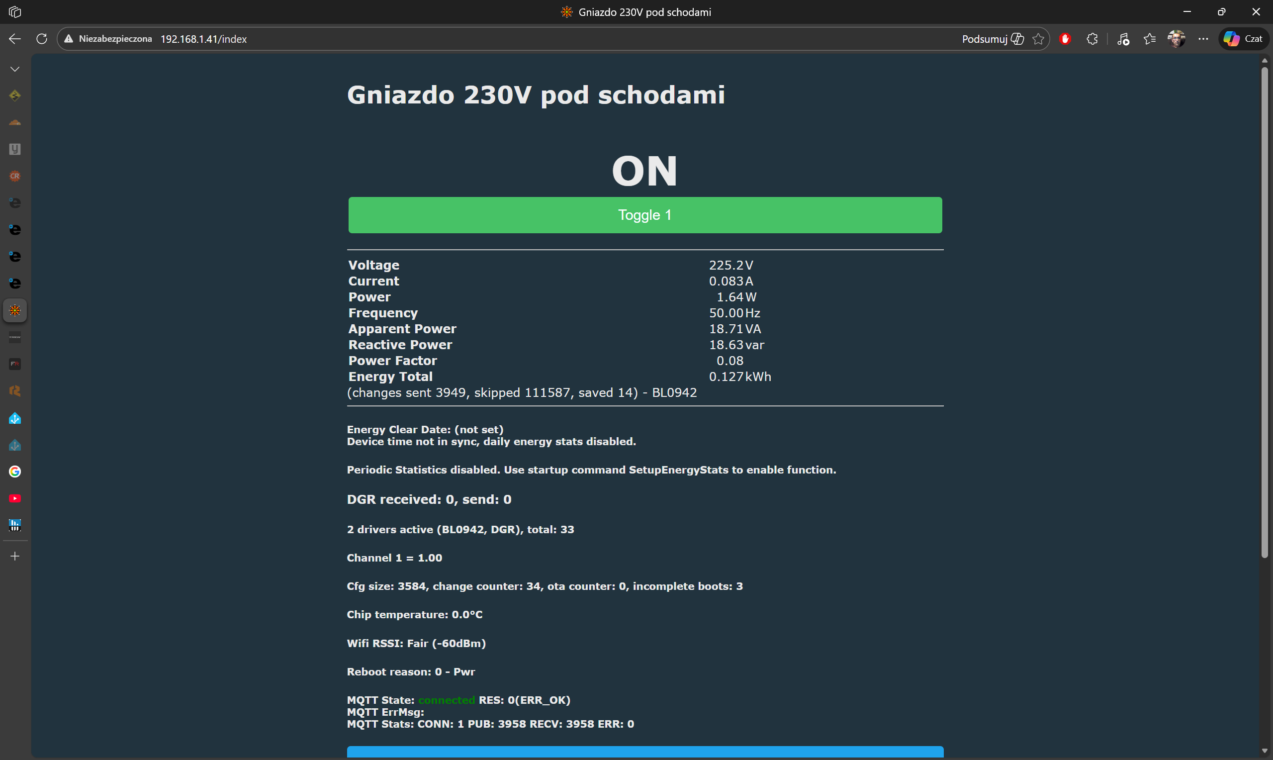

    Control panel for 230V socket showing ON status and energy data
    This much I can see.
    When I type this SetupEnergyStats with parameter 1, it pops up that there is no such command

    In order to calculate the energy per day, the device must know when a day starts or ends; hence, the time of the device must be set.
    (See the message on the GUI).
    If your device has internet access, you can enable NTP (statrdriver ntp) and it should be working.
    If not, to get a roughly calculation you might set the device time "by hand" with "TIME_settime <epoch = seconds since 1970>".
    Since there is no regular correction of the time which might drift it might become off for some seconds or minutes over the time...
    Regarding "SetupEnergyStats" it needs this arguments (see here in docs):
    [enable 0 or 1] [sample_time[10..90]] [sample_count[10..180]] [JsonEnable 0 or 1]
    JSONEnable is optional.
