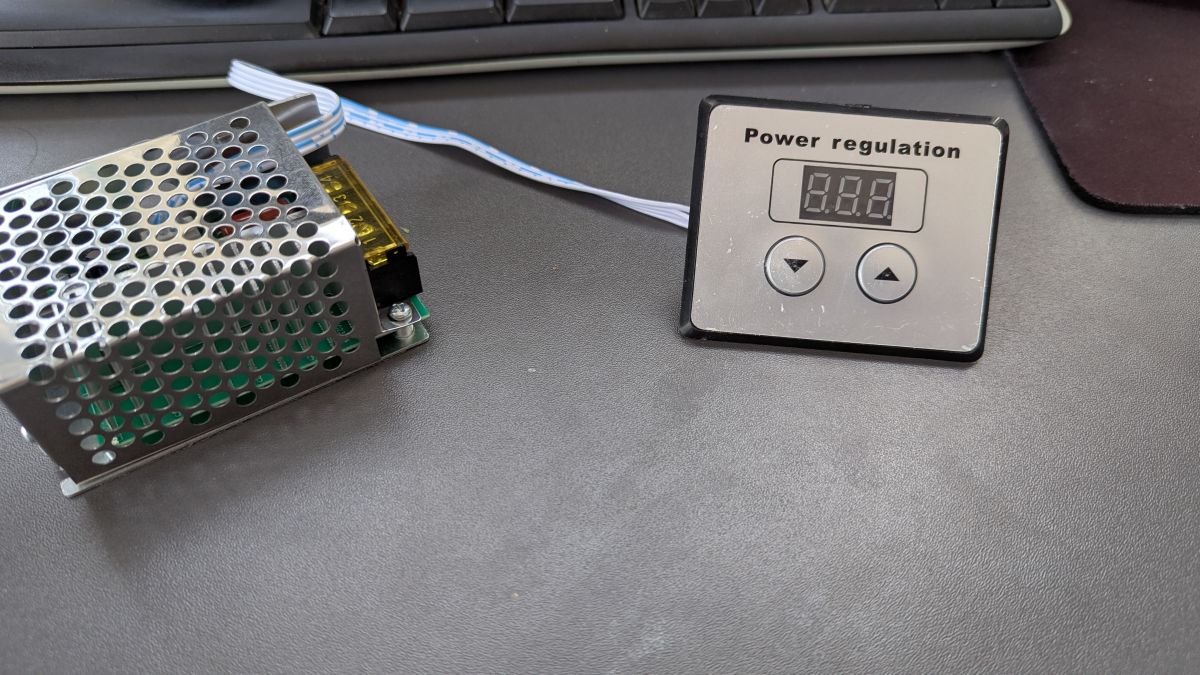

    Hi!
    It's been years since I've been here and my skills are rusty, which is why I'm asking for help.

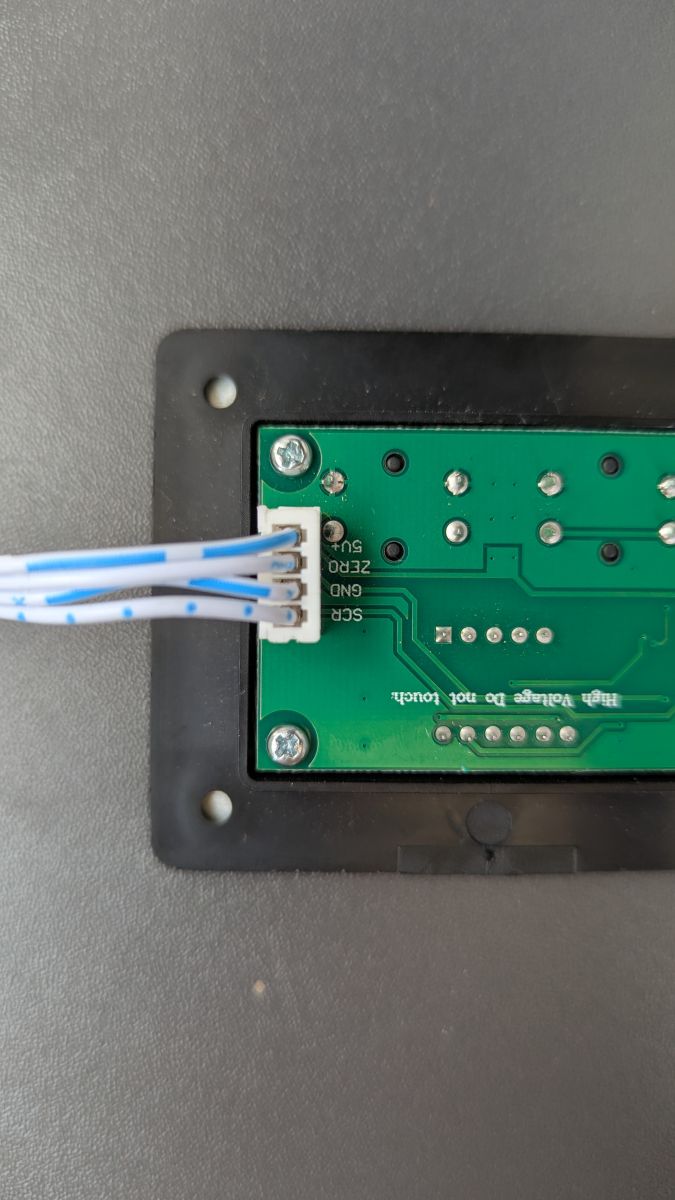

    I have bought a regulator from ali and I would like to control esp32 with it, from what I understand in the original board the zero detection in sine wave is implemented and the triac is controlled accordingly.
    Please verify if I am wrong and suggest how to solve the control by omitting the original control board.
    Maybe possibly someone has already done something similar, unfortunately I cannot find.
    Circuit board with 4-pin connector labeled 5V+, ZERO, GND, SCR .
    Power module with metal casing and control panel with display and buttons. .

    One solution could be to hook up with a microcontroller to the control buttons, as Adam Bold showed on his channel:
    https://youtu.be/OlNeXY6SopM?si=JjOQGCjEMod-0qFC
    If you want to connect directly to the 4-wire cable instead of the original controller, you would need to know the exact specifications of the signals running there and create a suitable program.
    That's just in general, because the devil is in the detail.
