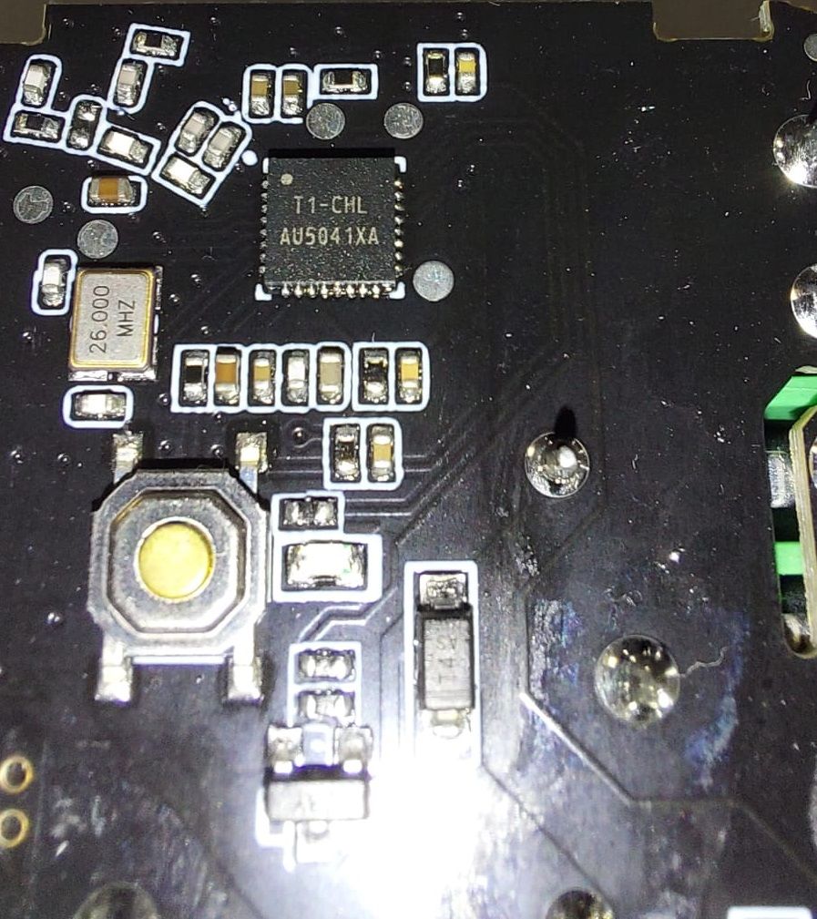

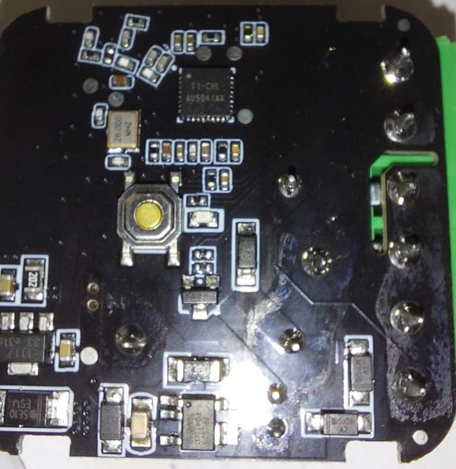

  • Timer-based PWM with hidden status channel
    #9 21692095
    omelchuk890
    Posts: 70
    Rate: 10
    The CHL at the end of the marking is confusing.
    If it is really 7238, then I think it is good, your team has implemented their support.
    Regarding the topic - I had to "hide" the channel, otherwise there is a constant sending of the status.
    Considering that the bit depth is not needed to be large, I think 100-200 is enough, and it is possible to implement this on timers.
