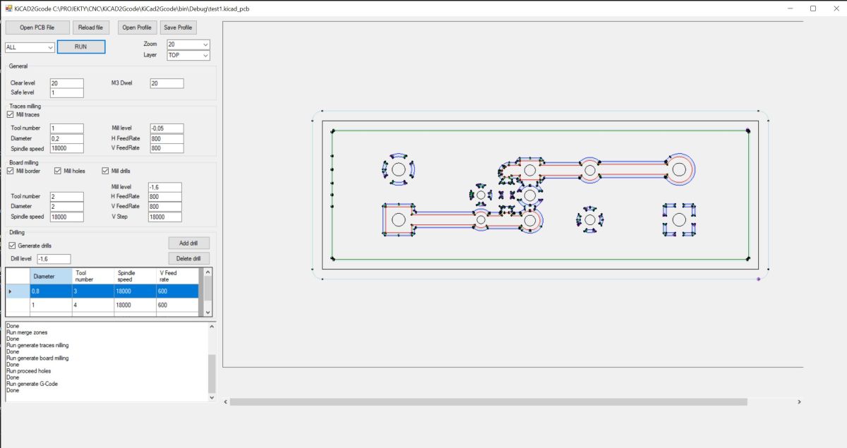

  • Hi,
    KiCAD2Gcode app window with PCB preview and milling parameters .
    The project presented this time is purely programming but I hope it fits in this section and maybe someone will find it interesting or useful in the workshop. The aim of the project was to create a convenient-to-use GCode generator for making PCBs on a CNC milling machine. I design my PCBs in KiCAD so I focused on this input format. I've previously used FreeCAD for this purpose, but the conversion time and the number of operations required effectively discouraged me - processing one PCB could take me several hours, most of which was spent waiting for FreeCAD to convert everything.
    As with previous projects, I decided to write the application in c# as a Windows Forms application using Visual Studio. The result is an application with which you can have a complete GCode generated in a few minutes.

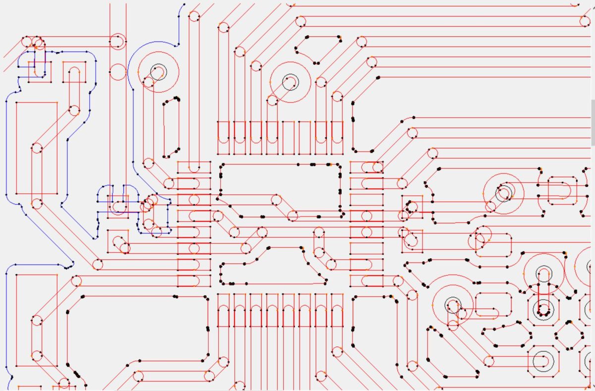

    - The next step is to merge the polygons belonging to the paths. In order to optimise execution time, only segments belonging to the same network are merged. After this step, the board looks as follows:
    PCB GCode toolpath output with drill holes and connection segments .

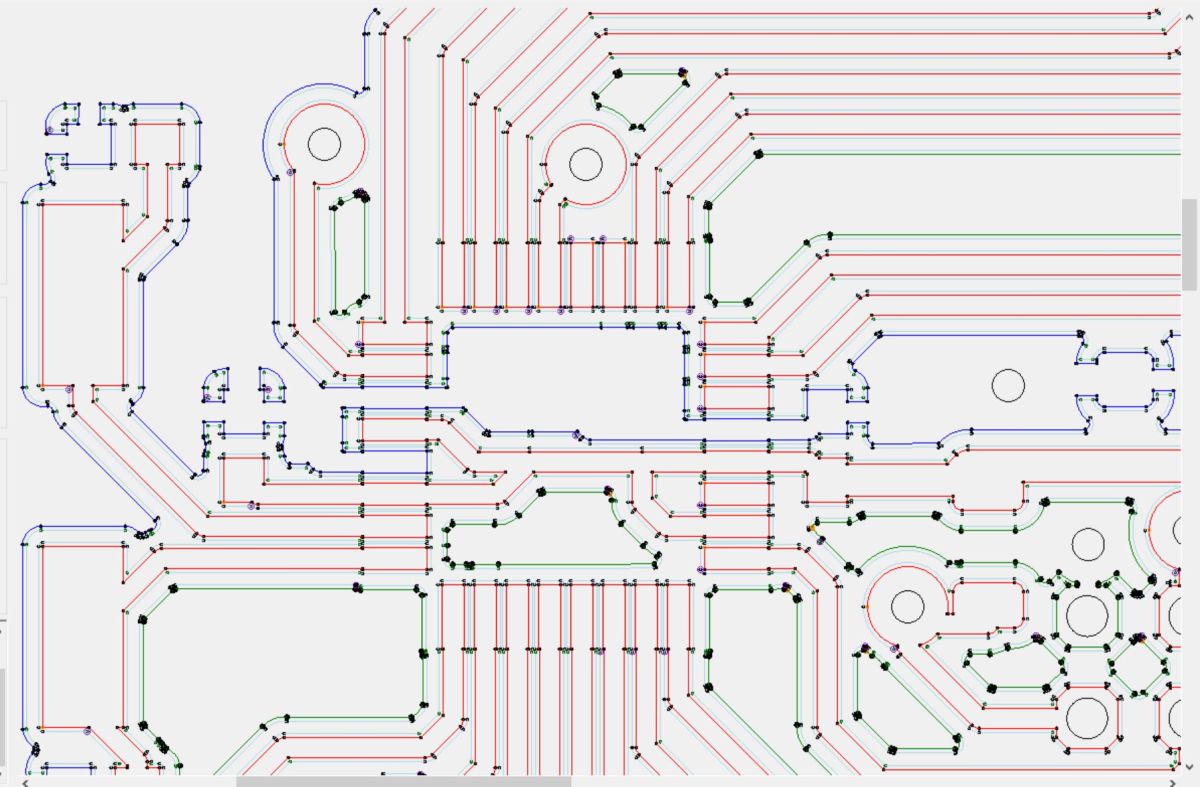

    - The final step in preparation for milling is to merge the fragments of the filled zones which are connected by paths:
    PCB track routing preview with multicolor paths and control node markers .

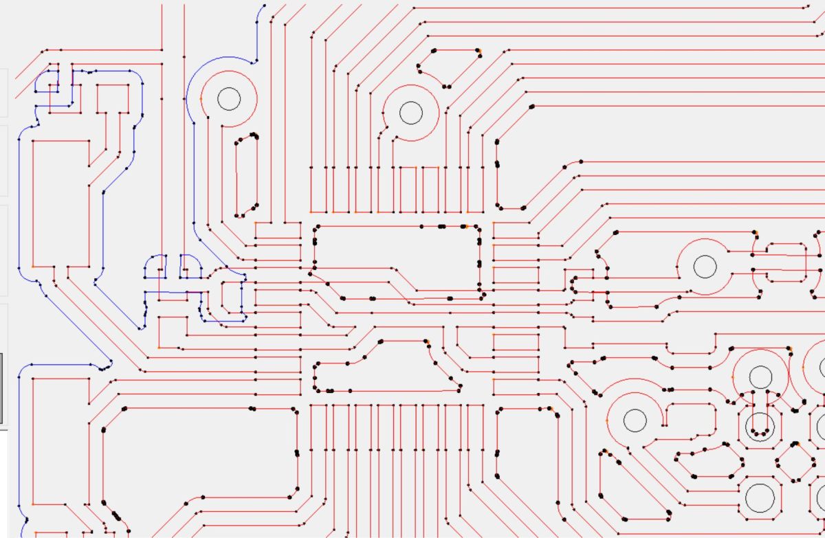

    - All polygons are now ready so this stage generates milling paths at the correct distance from the prepared polygons, separately for milling the copper and separately for milling the plate shape.
    PCB path preview with CNC machining points and multi-color trace layers .

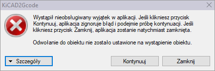

    I am testing (?) this programme, but every time a window like this appears:
    Error dialog from KiCAD2Gcode stating an unhandled exception occurred .
    Where to look for the error?

    >>21690599 .
    Hi, thanks for reporting the problem, it looks like there is a lack of support for some unusual pad shapes, you can see I didn't use such anywhere in my boards and it didn't work out for me. I didn't even know how complex pads can be defined in KICAD. :) This will of course be corrected. Have you tried loading other board designs? Alternatively, if possible, could you send some KiCAD PCB file with which there are problems so that I can reproduce it?

    And this is where I was surprised by something: In the archive in the "YES" directory there are the original "*.kicad_pcb" files from "http://mynor.org" - and they open correctly (?), while in the "NO" directory there are the same files after my cosmetic changes (I think KiCAD 8.0) and they don't open (?). At first I thought it was the fault of KiCAD version 9.0.4 which I am using, but no....
    >>21690797 .
    • pack.7z (1.61 MB) You must be logged in to download this attachment.

    Thanks for the test files. The problem with loading the files turned out to be quite simple, KiCAD 8.0 uses tabs in its files instead of the previous spaces which causes a network parsing error. I have fixed this however there is another problem which crashes the application at the segment linking stage, when I have solved this I will upload a new version.

    LechU wrote:
    I am testing (?) this program, but every time this window appears:
    I guess the author forgot about try-catch
  • Missing array-range check caused the bug

    Hi, I've been away for a while but finally found some time and improved the program, removed some bugs found in the meantime and added milling of unfilled surfaces. Version v1.4 is uploaded on github, feel free to test it ;)
    Not even a try-catch, because those are there in the important places, here a simple ifa for exceeding the array range was missing :/
