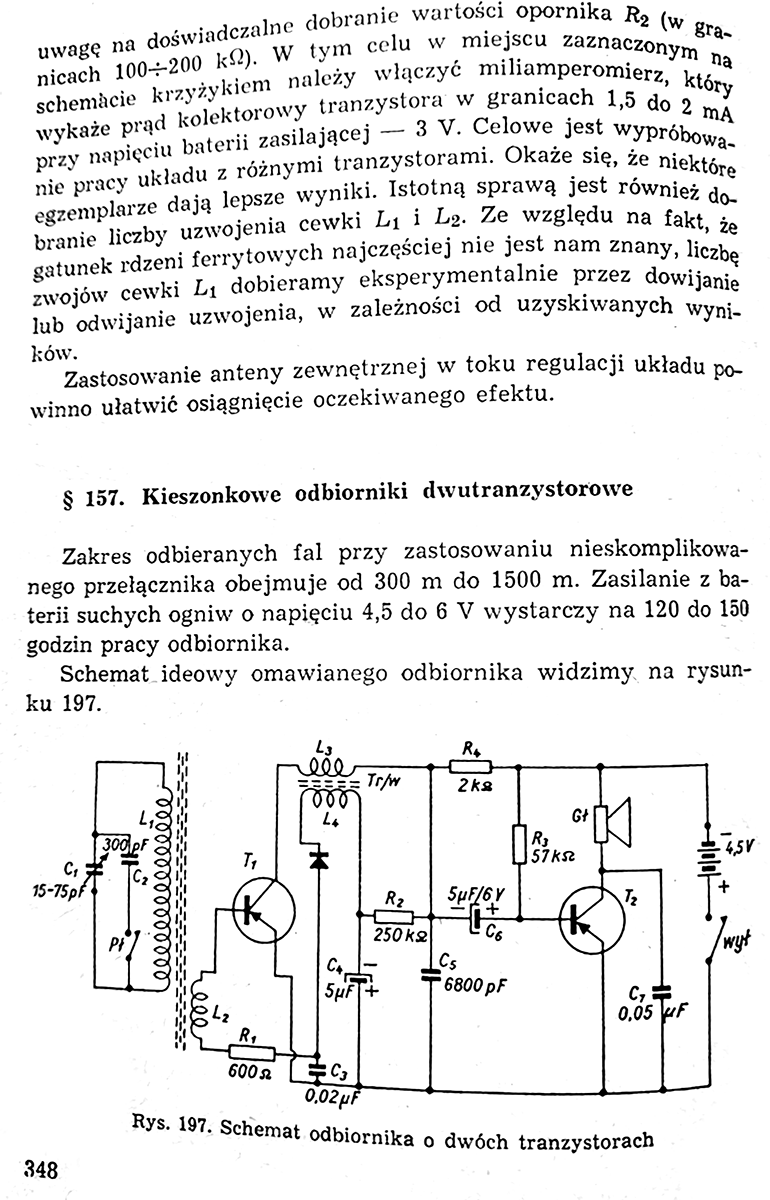

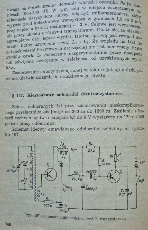

    As simple radio receivers are invariably of interest, I have decided to present a rather interesting design for the current technical realities. This is one of the first electronic circuits I had the pleasure of building, but unfortunately, for various reasons it lay unfinished for many years. Recently, looking through my electronic scrapbooks, I found that I had everything I needed to complete it.
    The schematic diagram of the radio comes from the book "Radio amateurism at school" by W. Kozak, which was recommended to me by a librarian in primary school when I was in grade 3.
    Even then, the material in it was somewhat outdated, as germanium tubes and semiconductors had been superseded by silicon for many years. In addition, the components presented in the book could no longer be obtained and the electronics (radio engineering) presented there had long since passed away. However, I managed to accumulate some germanium semiconductors by dismantling from old equipment and other sources. I started assembling the radio using a flask soldering iron, but progress stopped due to some obstacles with making inductive components.
    A scan of the radio's schematic can be seen below. Briefly, it is an AM reflex receiver, on germanium semiconductors: two PNP transistors and one blade diode.
    Book cover of Radioamatorstwo w szkole with illustration of radio and tools. Schematic diagram of a pocket AM radio with two PNP transistors. Assembly diagram of a simple radio receiver using two transistors. Table showing electrode markings and dimensions of germanium p-n-p transistors. Table showing electrode markings and dimensions of germanium p-n-p transistors.

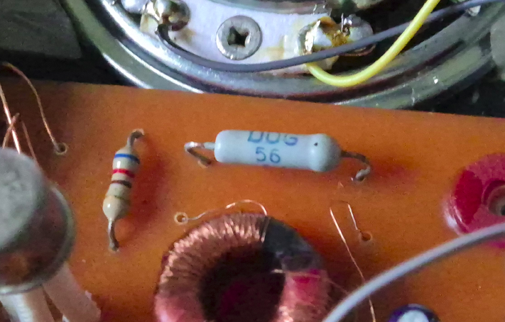

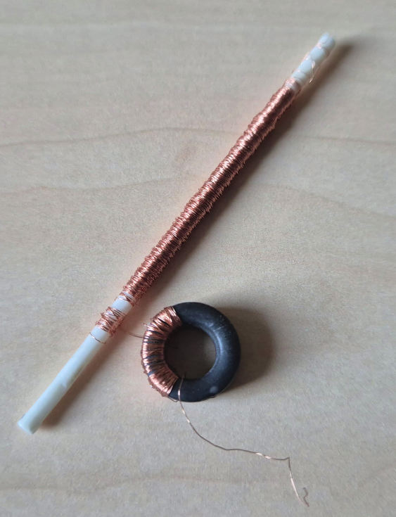

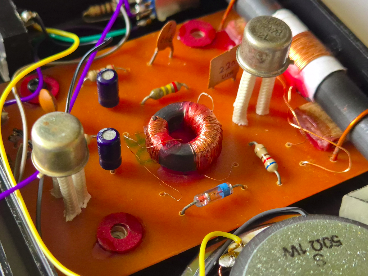

    As you can see, the reflex circuit is based on a "w. cz." transformer, which I had the most trouble with because I didn't have a suitable core and attempts to make one from ferrite rod, as described by the author, failed.
    I have now accumulated a number of cores, including toroidal, which are ideal for this purpose. The biggest challenge was winding the right number of coils, which I managed to do by using the right winding method
    Two coil cores with copper wire: one ferrite rod and one toroidal core

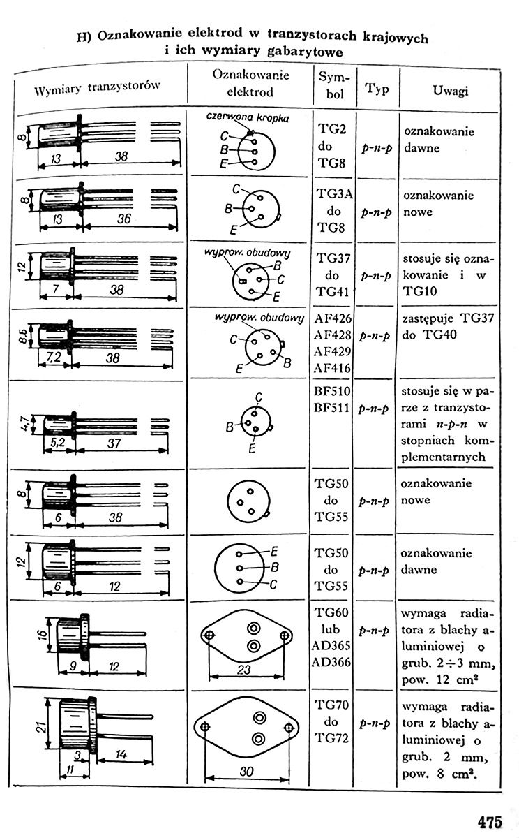

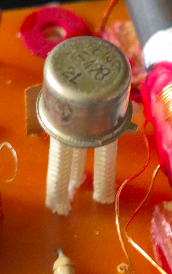

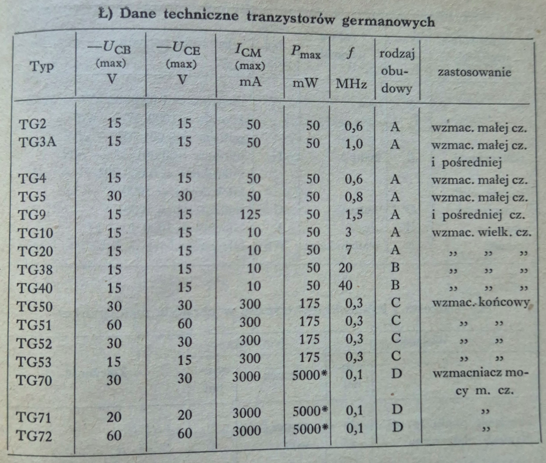

    The TG5 transistors have unfortunately been lost somewhere over the years. I used the equivalent AF428 instead of the TG5. There were tables at the end of the book where you could find out about housing types and replacements.
    The assembly of germanium semiconductors requires attention, as they are very sensitive to heat. For this reason, I left the 'legs' of the transistors as long as possible. With the diode it was a bit more fun because it turned out that different types of germanium diode give different radio effects. Domestic DOGs were a problem because the radio was agitating, there was no such problem with the Soviet diode found long ago from Rubin, which I finally left.
    AF428 germanium transistor on a circuit board with visible wires and thermal insulators Close-up of electronic components including a DOG 56 germanium diode on a circuit board Bottom view of a printed circuit board with soldered joints for an AM radio

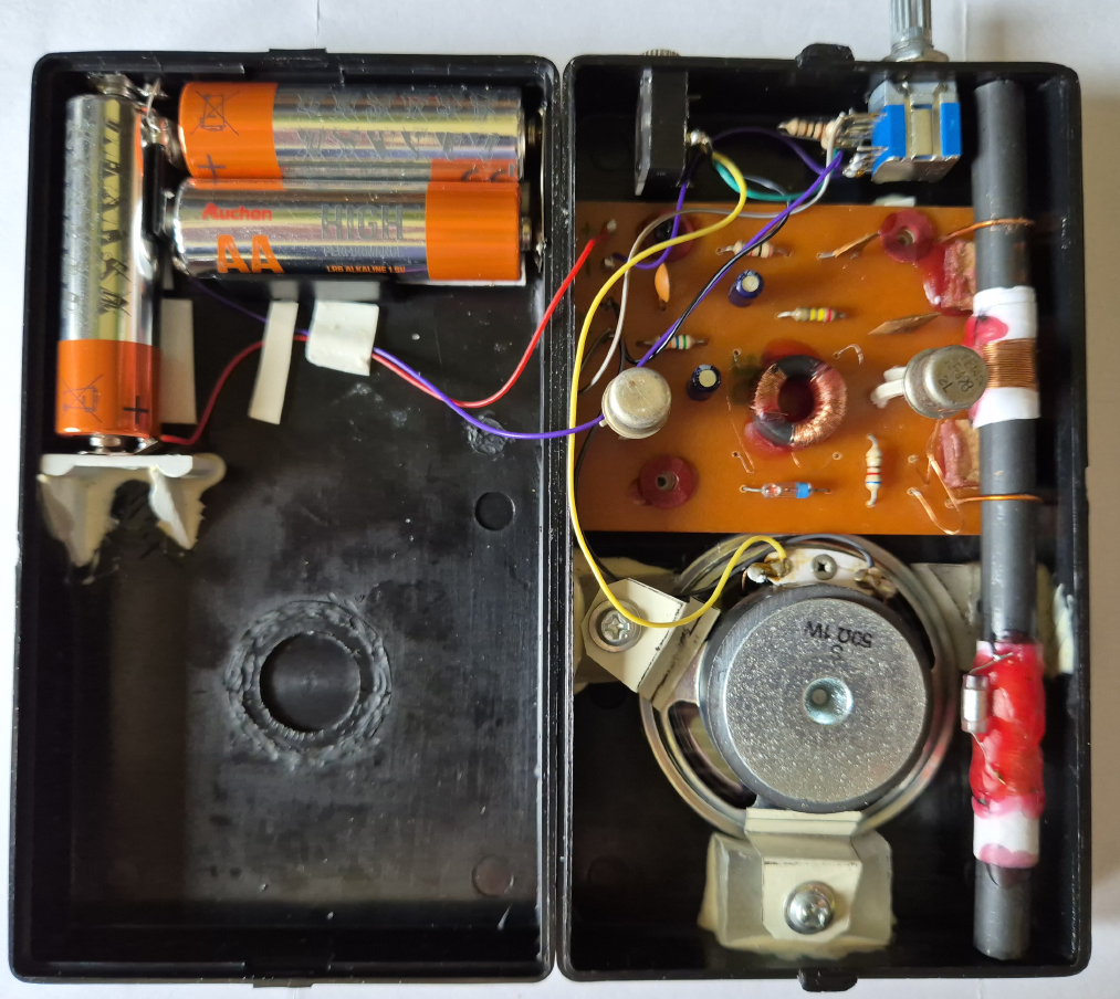

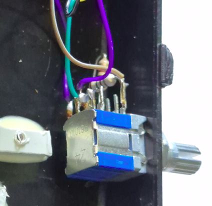

    The transformer obviously requires the coils and their ends to be properly connected (which is missing from the schematic).
    I didn't want to modify the original circuit, which is why there is no additional amplifier, remaining with a single TG50 powering either the speaker or the headphones. This is one of the simplest class A amplifiers, with a sizable DC component flowing through the driver. I used a 50 Ω high-ohm speaker and a 3.5mm stereo jack headphone socket. The headphones are connected in series, which causes them to act in counter-phase, so I reversed the polarity of one of them. While the speaker doesn't play very loudly the headphones are well driven. The power is high enough that I had to use a level control. This is a 4-position switch that switches the radio's power through 30 Ω and 100 Ω resistors.
    Close-up of a 4-position rotary switch inside a DIY radio case

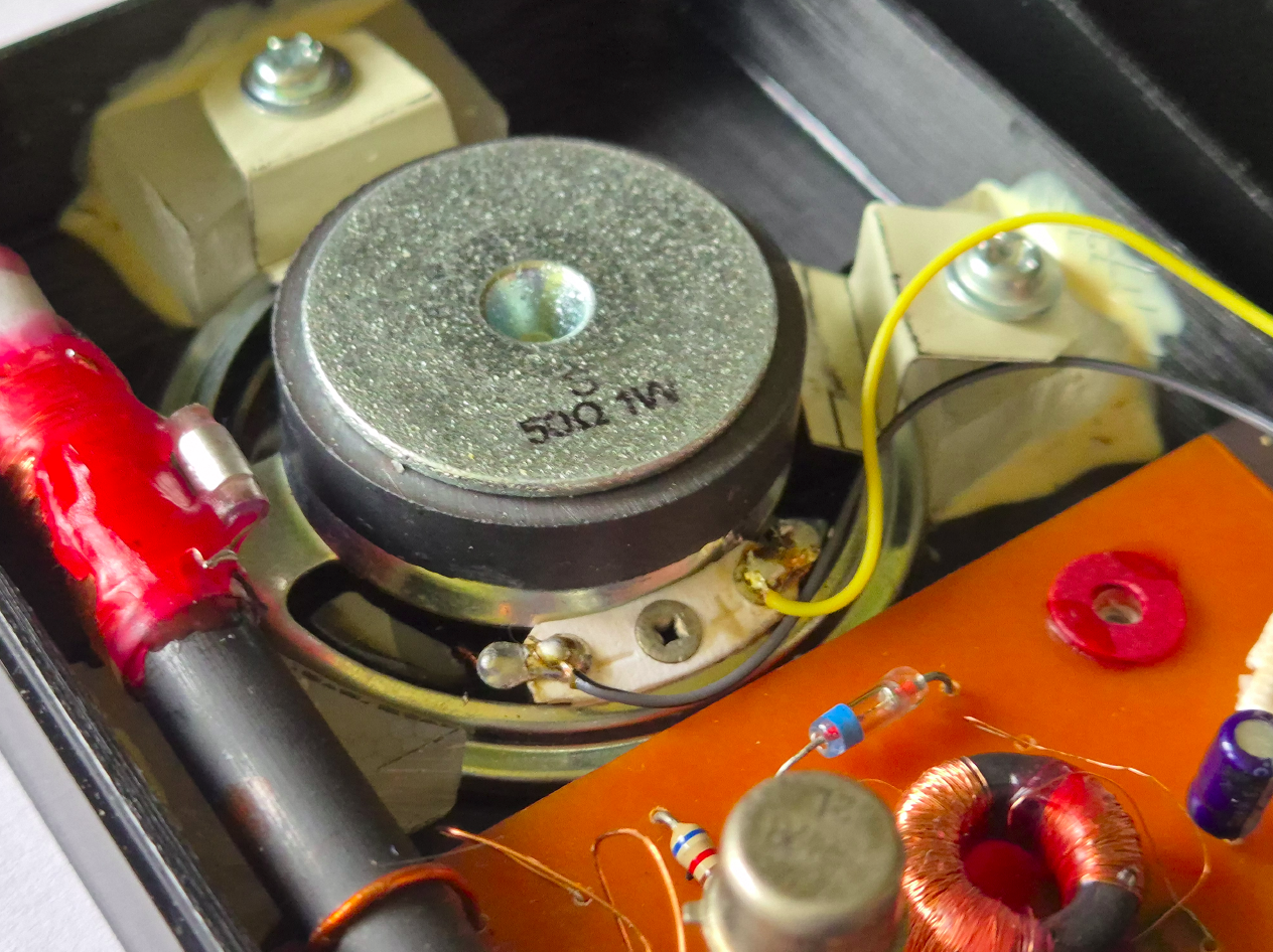

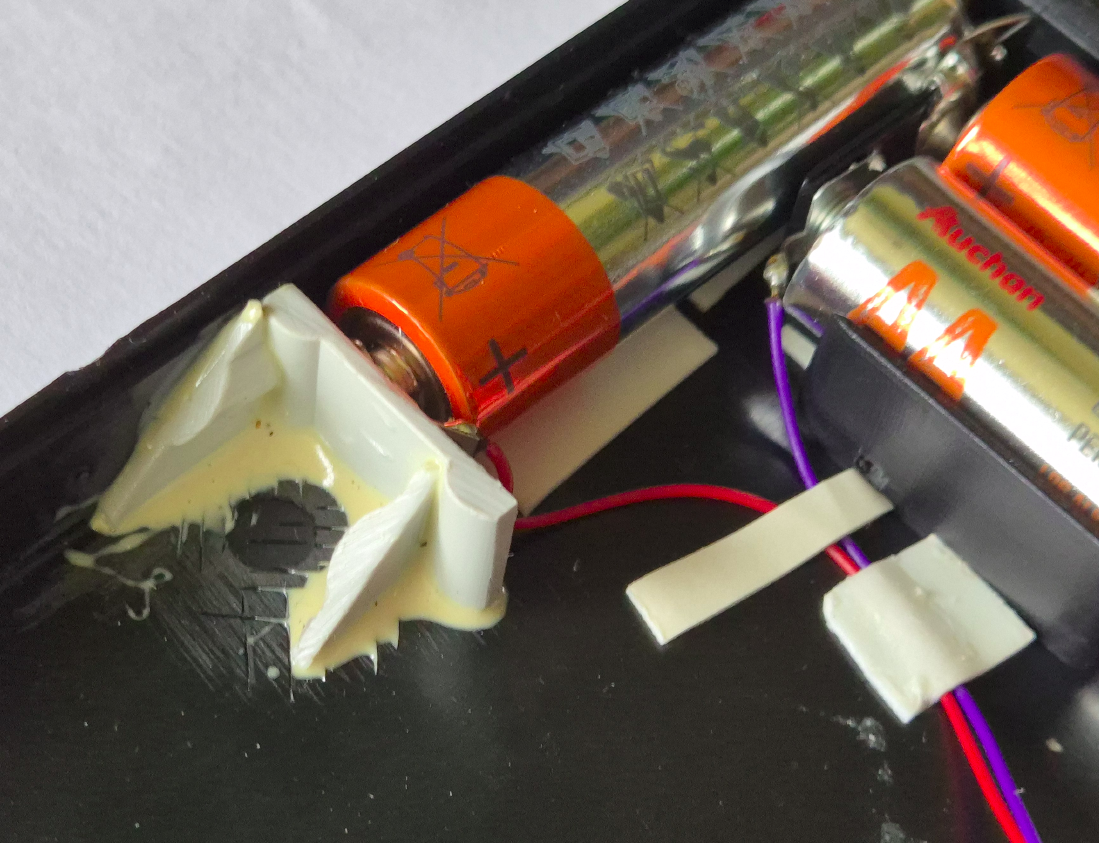

    The receiver is powered by three AA batteries in a specially machined space in the case. This configuration establishes the centre of gravity well; there is a speaker on the other side.
    Close-up of battery compartment in DIY radio with three AA batteries installed. Close-up of AM radio interior with 50 Ω speaker and electronic components. Close-up of speaker unit and plastic mounting bracket with screw inside a radio housing
    How the radio plays with the loudspeaker is presented in a video from one of this year's recent editions of 'Summer with Radio'.
    The radio is very sensitive, 300 km from the RCN transmitter in Solec Kujawski allows listening on headphones in quite good quality. This is due to the rather long ferrite antenna. Initially, when I started up, I heard nothing in the speaker except a rattling sound, which was not a good harbinger. The cause turned out to be an inductive charger running a few metres away.

    Cool project. Respect for sharing at a time when there are thousands of schemes available on the internet and only some of them work.
    acctr wrote:
    The headphones are connected in series, which causes them to operate in counter phase, so I reversed the polarity of one of them.
    I usually treat the operation of one headphone in counter-phase of a mono receiver as an additional feature rather than a disadvantage, as this introduces a pseudo surround to the received sound. Then the sound comes from different directions, rather than from the top of the head as in mono. I know this doesn't suit everyone, but it's good to know that it can still be done.

    For me it's great. For a receiver on two transistors it plays quite nicely. I think I only have the famous ASY37s left of the germanium ones.
    For winding this toroid I think elongated double-sided forks would be better.

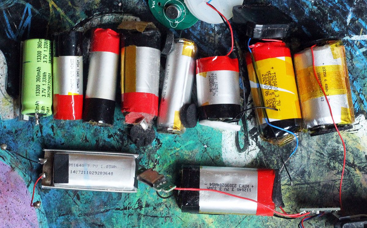

  • Li-ion battery suggestion for louder receiver output
    #4 21720834
    _ACeK_
    Posts: 198
    Help: 6
    Rate: 215

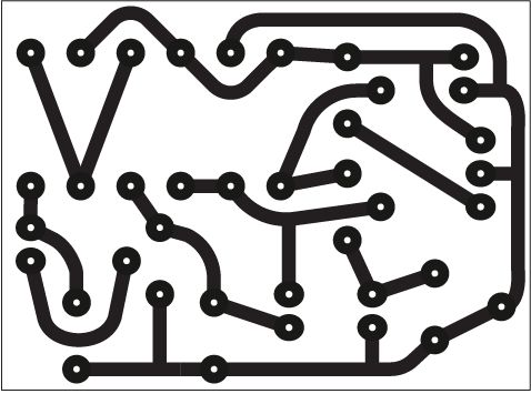

    :smile: You wrote that the description lacks information on the transformer . For that, your your description from the book is missing two pages :wink:
    :idea: You do not hold firmly to the standards of years 60 those (PCB) , then I suggest using Li-ion batteries instead of AA :idea:
    Close-up of various lithium-ion batteries on a colorful textured surface
    ✅ The advantage is that they are free from the donor after the electric cigarette. If on one 3.7V would not want to play, then you can give two in series 7.4V will probably still play louder :lol:

  • TG20 needed in the first stage

    Germanium transistors are a good bargain at the moment; when such a TG50 NOS classic is priced at under PLN10 a piece, it's a good bargain. The aforementioned book also gives the parameters of the most popular transistors of the time, and you can compare to the current ones.

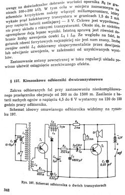

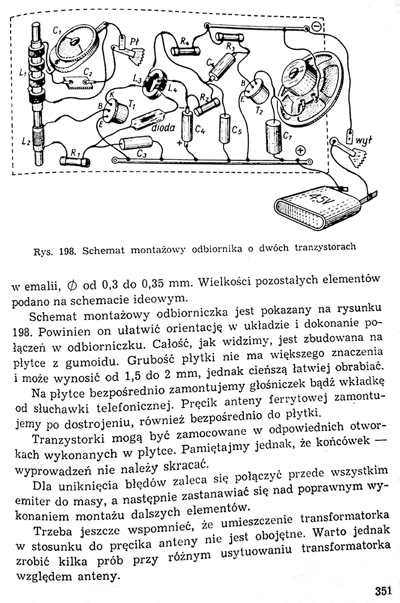

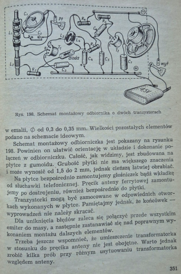

    As someone already mentioned the missing description I add it. There is a fairly detailed description of the receiver operation, number of antenna and transformer coils, etc. You will find that the transistor in the first stage is TG20 (7 MHz) and not, as I wrote, TG5 (0.8 MHz), which was in another receiver from this book and is in the same housing. The reflex circuit requires faster transistors because of the need to amplify two frequencies.
    Technical book page explaining two-transistor radio receiver circuit Book page describing construction of a high-frequency transformer Technical data table of germanium transistors TG2–TG72

    More about germanium transistors and reflex receivers
    RiK_1964-10, page 242
    https://publikacje.r-kobus.eu/TEWA/TG5.pdf
    https://publikacje.r-kobus.eu/TEWA/TG2.pdf

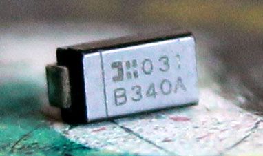

    🤔 If it would be possible, could you insert a fast diode Shockley diode :idea: :idea: for a test
    Close-up of a B340A SMD diode on a circuit board surface
    :arrow: One like the one in the picture I soldered out of a sat tuner, the conduction voltage is 0.178V 😎 I wonder if it would be better than the germanium one 🧐

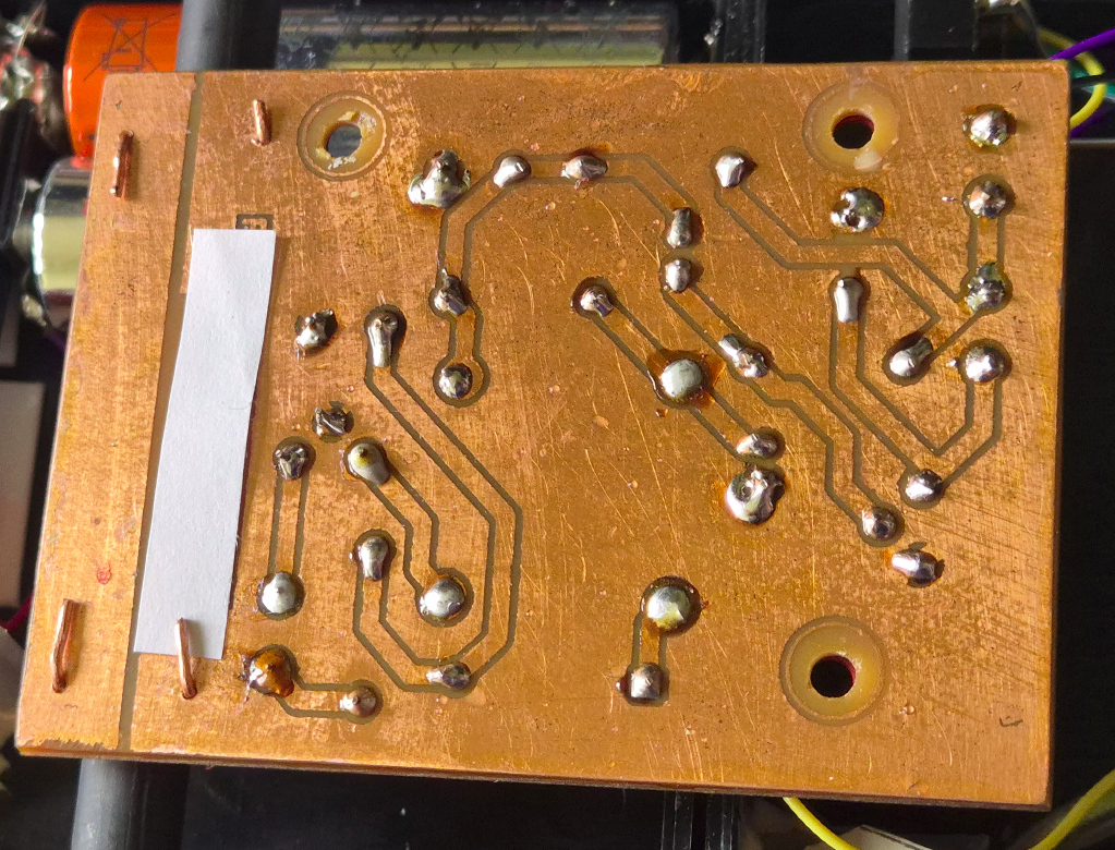

    🤔 Are all the coils wound with the same diameter wire?
    Close-up of a circuit board with coils, capacitors, and wires

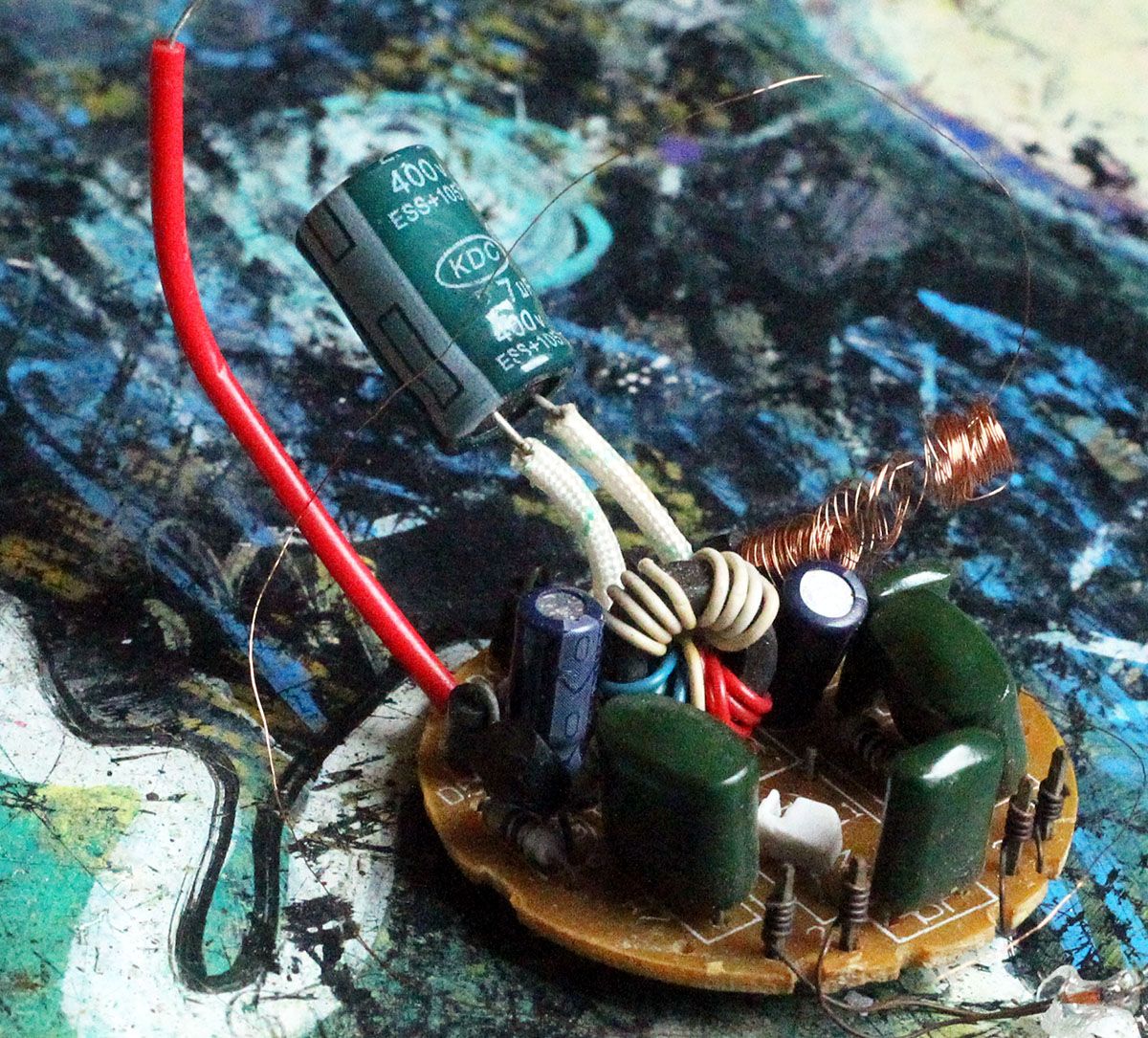

    :idea: In electronics from fluorescent lamps there are sometimes toroidal cores, are these suitable?

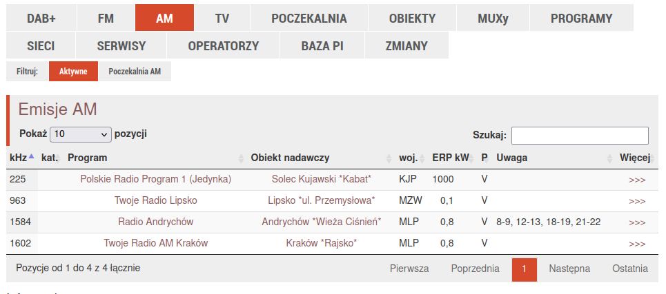

    Polish Radio Programme 1 broadcasts on AM?

    E8600 wrote:
    Program 1 of Polish radio broadcasts on AM?
    IN AM. That's amplitude modulation, not range (bandwidth). It broadcasts and is doing well, probably as one of the few stations in Poland. I was listening yesterday, PRI is doing quite well from the transmitter in Solec Kujawski;
    List of active AM broadcasts with four radio stations in Poland
  • Schottky detector works, but worse than germanium

    I've done experiments on several receivers with replacing a germanium diode with a Schottky diode (because that's more what you meant). Schottky worked in the detector, but unfortunately worse than germanium diodes (which is a pity, as they are more available). Out of luck you could use Schottky diodes, but with the knowledge that the receiver could play better.
    As for the photo of the compact fluorescent light driver, I solder a coil on a straight ferrite core, which is usually between 2 and 5mH, which is ideal for an HF blocking choke in super-reactive receivers.
    It broadcasts both on AM and FM, but is the only nationwide station broadcasting on longwave (225kHz).
  • Schottky diode suggested instead of Shockley diode

    I'm afraid these are too low voltages for a Shockley diode, unless you had a Schottky diode in mind. I've never tried it, maybe I'll test it in my spare time, although it would be easier to test on a detector receiver, which I can also present.
    Yes, almost unchanged and almost uninterrupted for almost 100 years, so that you can build working receivers according to designs from the 20,30, 50 or 60s and enjoy listening to programmes of Programme 1 of the Polish Radio S.A. in liquidation :D

    In electronics from fluorescent lamps there are sometimes toroidal cores, are they suitable?
    at least some of them will be suitable. Will all of them? I don't know. It's worth trying.

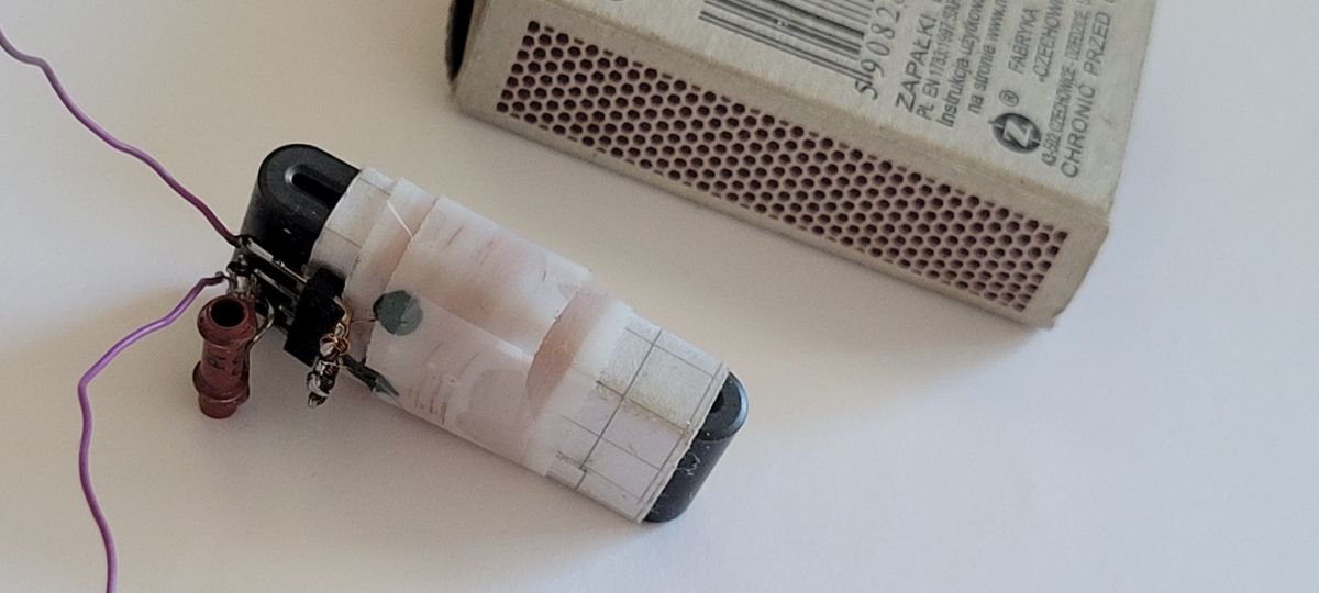

    I once did an experiment and checked if I could use another core found in "junk" instead of the usual ferrite antenna, and it turned out to be yes. I wound the coil on an anti-interference core from a data tape from a printer and surprisingly I was receiving Programme 1 PR on this. The reception was worse than on the longer ferrite antenna, but it was there.
    It depends what function it had, if it was an anti-interference choke it would mean the trafko would have more inductance, and if it was a core from an inverter it might mean it was a powder core designed for energy storage.
    Whether this would affect the coupling in the reflex circuit is hard to say, but it could be as @gps79 wrote.
    In my receiver I used a core from some telecommunications equipment where it worked in a signal transformer.

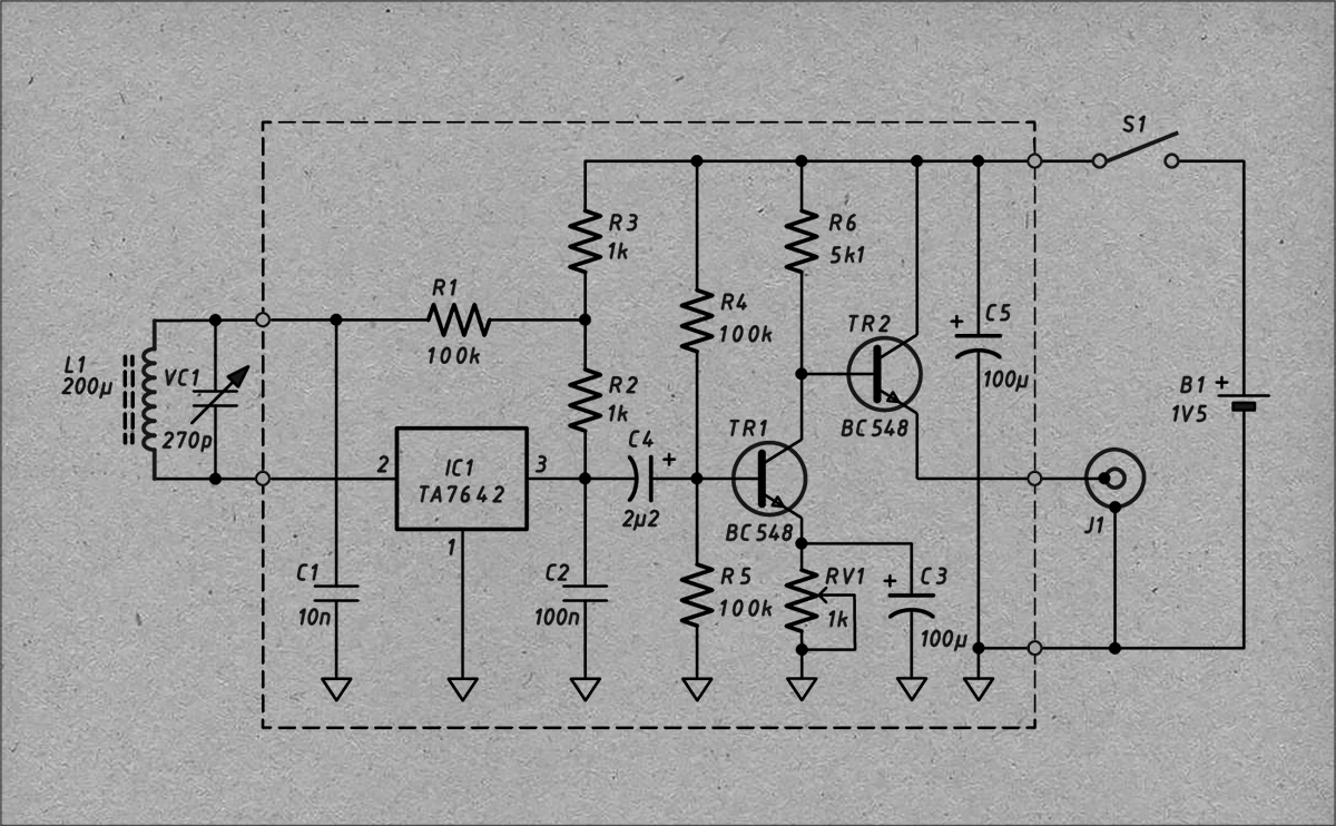

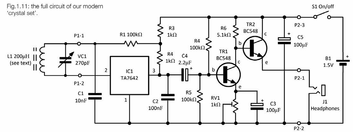

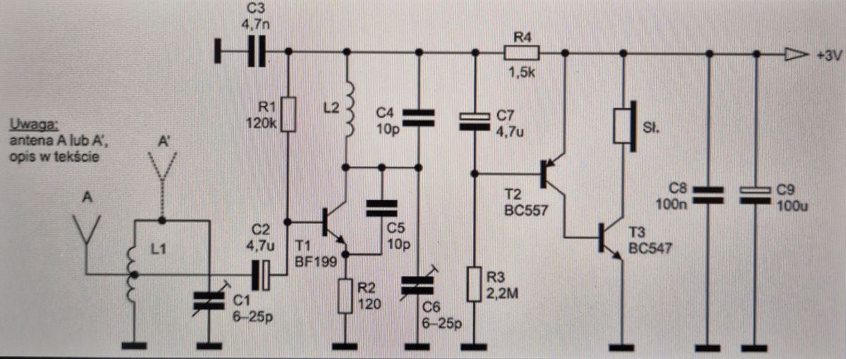

    gps79 wrote:
    On the other hand, for UKF reception you already need at least 2-3 transistors. Of course, you need to have a good tested schematic, because there are many non-working ones on the internet.
    It is also possible to do on one (not counting the ac amplifier), I did on BF214 and it played normally, another example by A. Janeczek (T2 and T3 are ac amplifiers)
    AM radio circuit diagram using BF199, BC557, and BC547 transistors
  • UKF antenna signal is far weaker than AM

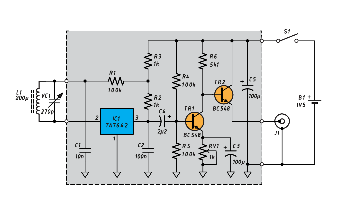

    :smile: W Practical Electronics 11 2025 ⬇️
    Cover of Practical Electronics magazine featuring radio circuits and components
    :idea: A series on new radio technologies begins 🧐 There is a description of the modern "crystal detector crystal" without diode :wink:
    Modern crystal radio circuit using TA7642 IC and BC548 transistors, no diode
    • ta7642.pdf (1.09 MB) You must be logged in to download this attachment.
    • TA7642-1.PDF (521.81 KB) You must be logged in to download this attachment.
  • #25 21723863
    acctr
    Posts: 4554
    Help: 389
    Rate: 2025
    _ACeK_ wrote:
    There is a description of a modern "crystal detector" without a diode
    You can see that a solid ferrite antenna means reception is good too.
    I recently took on a turn-of-the-century tower with LW and MW bands, without the internal ferrite antenna but with an input for an external frame antenna. Whether the reception is better, I don't know.
  • #26 21724570
    efi222
    Level 22  
    Posts: 779
    Help: 12
    Rate: 1219
    acctr wrote:
    You can see that a solid ferrite antenna means that reception is also good.
    It is also worth adding that a ferrite antenna is a directional antenna and should be positioned perpendicular to the direction of the transmitter.
  • Schottky diode forward drop measured at 1 mA
    #27 21725271
    _ACeK_
    Posts: 198
    Help: 6
    Rate: 215

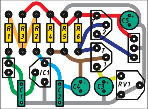

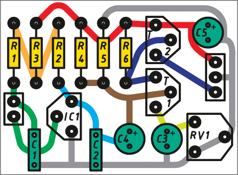

    :smile: Posted schematic above ⬆️ from Practical Electronics may someone not like it because of :arrow: © 🤔
    :oops: It's just in case I made a copy :idea: In US you're not allowed to take photos in court 👀 but no one forbids making drawings :lol:
    ✅ To satisfy all cyclists, retros, computer users there are two versions 🙃
    ⬇️ First with paper 😇
    AM radio circuit diagram with TA7642 IC and BC548 transistors
    ⬇️ Second with colour 😎
    AM radio circuit diagram with TA7642 IC, BC548 transistors and coil L1
    :idea: The radio itself is for medium wave 700 kHz to 1.6 MHz ⚠️ Coil L1 has 54 coils of wire with a diameter of 0.55 mm 🧐
    Colorful PCB layout diagram with labeled electronic components and traces
    Black PCB trace layout diagram on a white background
    :smile: PCB :evil:
    😊 Back to the diode question Schottky 🙃
    ⬇️ The one in the photo
    :idea: There is a rectifying diode 3A 40V where the drop at the junction at 3A is 500mV . Checking with a meter at current probably 1 mA has a drop of only 178 mV so I'm curious how it will behave at higher frequencies 🤔
    • pe11_pcb.pdf (82.87 KB) You must be logged in to download this attachment.
    • b330la.pdf (111.66 KB) You must be logged in to download this attachment.
