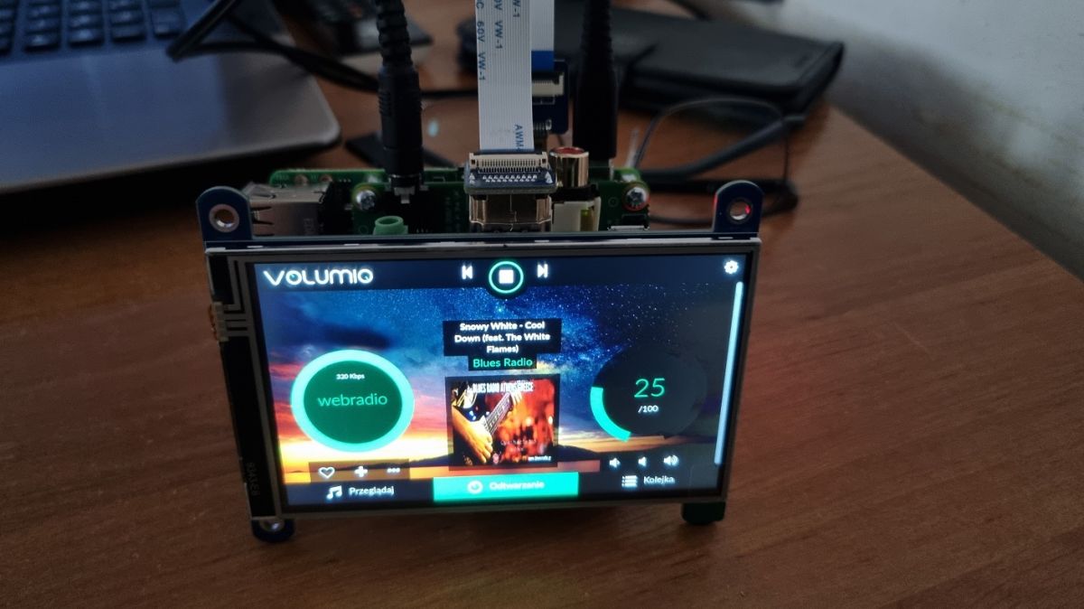

  • Waveshare touchscreen with Volumio interface playing internet radio

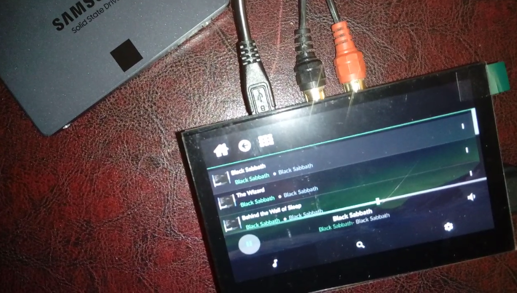

    I picked up a Volumio a couple of years ago. I wrote a bit about it in my topic on guitar amplifiers. For the project I purchased a Rasberry Pi4 B, a Hifiberry DAC2 Pro and an "official" 7-inch touchscreen display. The system that was installed was Volumio 2.917 and I hooked up an encoder and IR receiver. I was going to do the enclosure but the topic was constantly put off until I finally let it go. The Volumio was used successfully for those four years. In time Volumio 3 appeared, but in its initial development phase it lacked the plug-ins I wanted and I let the update go. The topic of Volumio was revived quite recently. I asked my colleague Radek to design an advanced power supply that could switch the Raspberry Pi on and off without fear of damaging the data on the SD card due to improper system shutdown. More on that later.
    On the occasion that I returned to the Volumio theme I decided to make myself one such player for work. Here I felt bad about packing 4B so I purchased a Pi Zero 2W. As a result of various turbulence I have two Pi4B's and two Pi Zero2W's.

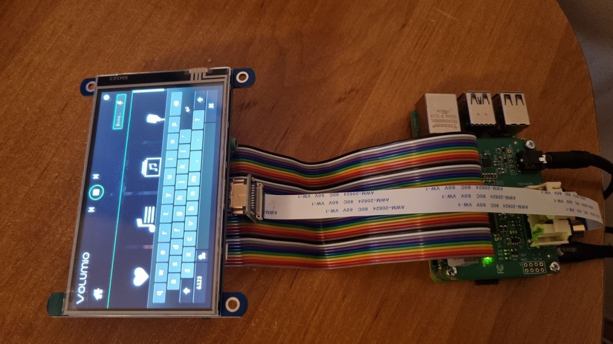

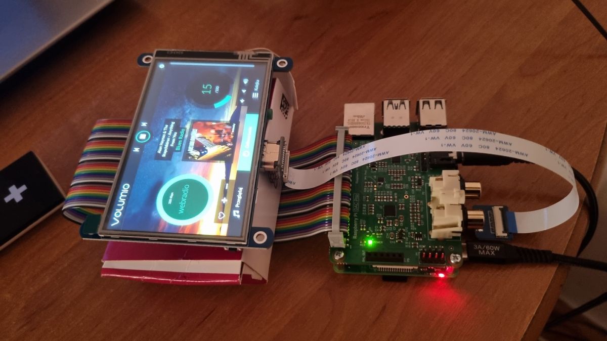

    For the 4B I purchased a 3.5inch Waweshare LCD touch panel (B) which communicated with the RPi 4B via SPI. It turned out to be a maximum failure. I passed it on to a colleague who managed it but as far as I know did not run it with Volumio. I went the other way and bought a Waveshare 16340, 4 inch, HDMI, SPI is only used for touch in it. It took a while to get it up and running but I managed. Let me just add that I know Linux poorly, but somehow managed.

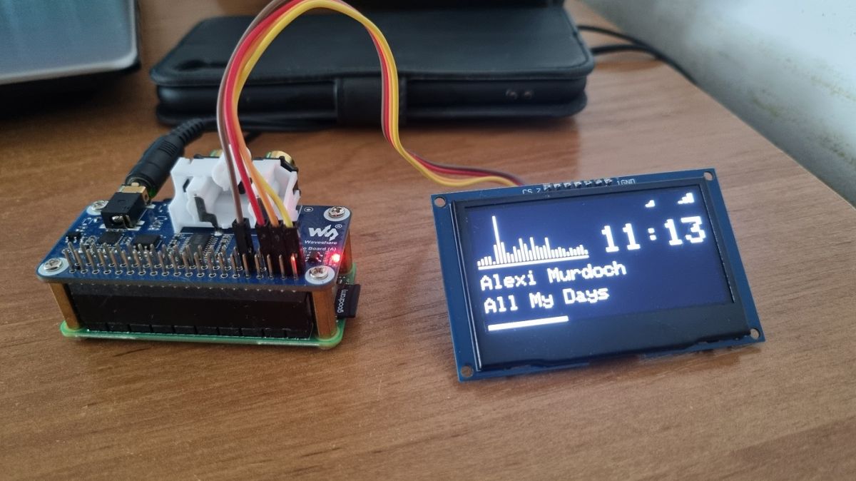

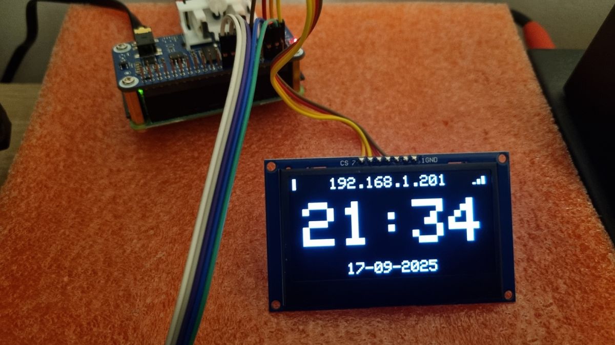

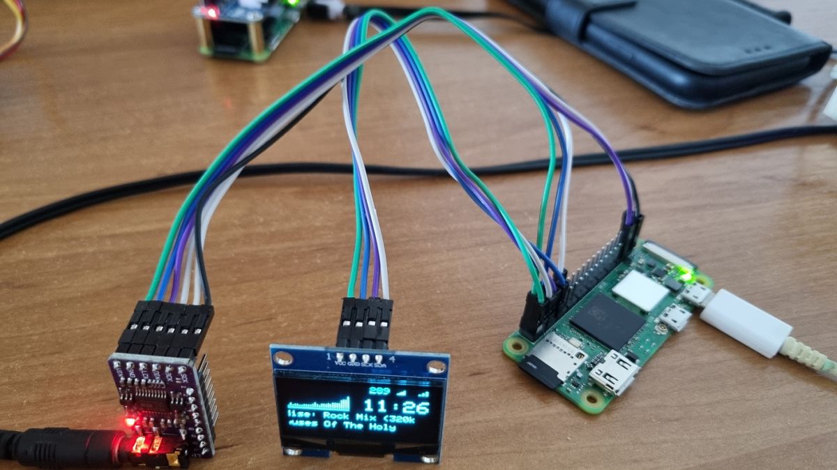

    For the Pi Zero2W I purchased OLED 1106 and 1109 displays, one of the 1106s I accidentally crashed so it flew into the rubbish.

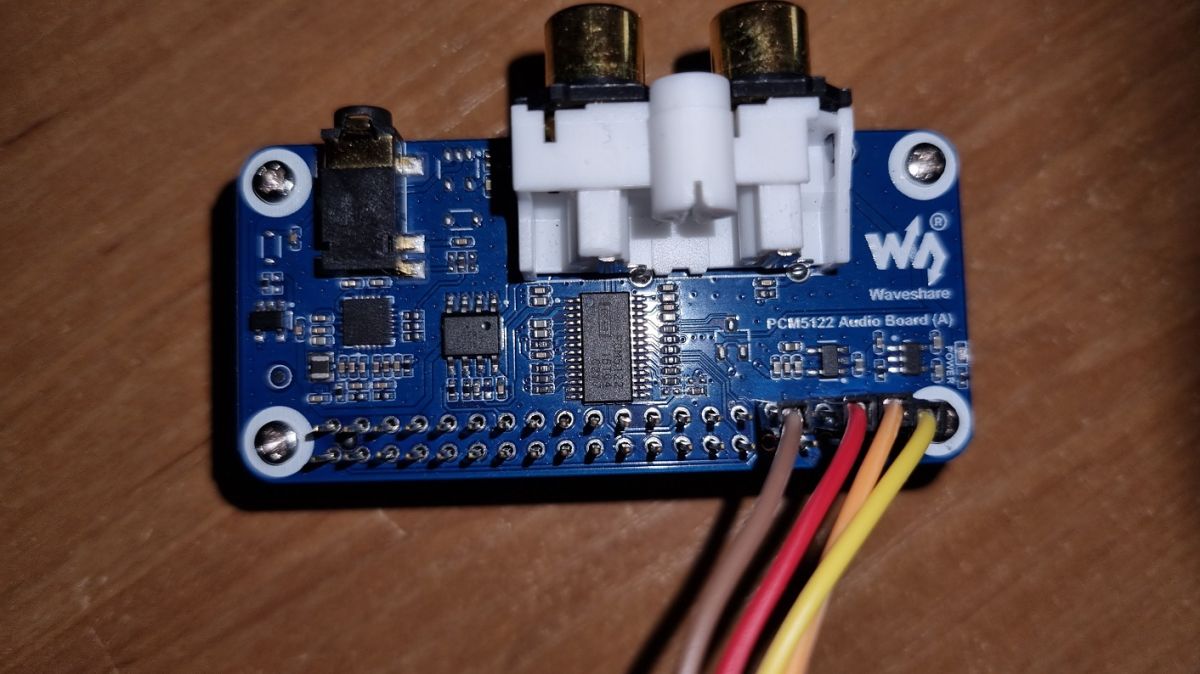

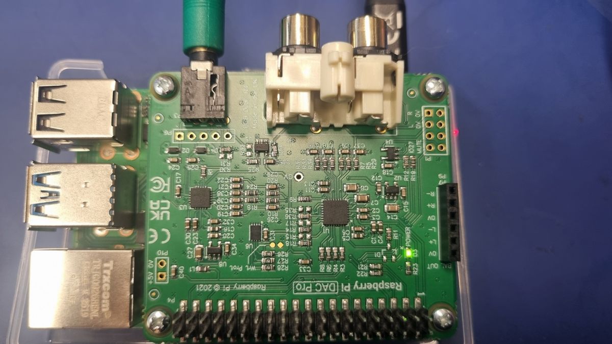

    A few words about the DACs. Given the lack of sound on the headphone output of the Hifiberry DAC2 Pro I decided not to buy a dac from that brand. For the small Pi zero2W I bought a Waveshare DAC based on the PCM 5122 from majfrends matching the size of the PI Zero2W, for the large PI 4B I bought two DACs. The first is an IQaudio DAC PLUS and the second is an IQaudio DAC Pro based on the 5242 DACs. All three cards/dACs work without any problems with Volumio, each exposing sound to the headphone jack without any software combinations. In addition, as a test, I connected a small DAC based on the 5102, which you can buy on their portals for 6PLN and on ours for 15PLN. It worked without any problem, I set it up in Volumio as a Hifiberry DAC PLUS.
    I should add that I am not constructing any audiophile equipment here, just utility equipment.
    Now a bit about the Volumio versions. On RPi4B ver1.3 I had version 2.917 installed, the new PI4B I have is ver1.5 and does not allow Volumio 2.917 to be installed.
    So I started installing newer versions and it turns out that the most stable in my case for both versions of Pi4B is 3.832. Earlier versions, except 2.917 were throwing an error installing the touchpad plugin.
    For Pi Zero2W, the best version turned out to be Voumio 3.251. Ver. 3.832 did run on the small PI, but the GPIO Buttons and GPIO Control plugins did not work properly. Some strange states were appearing on the GPIO. Changing to the 3.251 brought an immediate solution. I will be using GPIO control on both the 4B and 2W and this simply has to work if only because the two GPIO signals will work with the power supply.

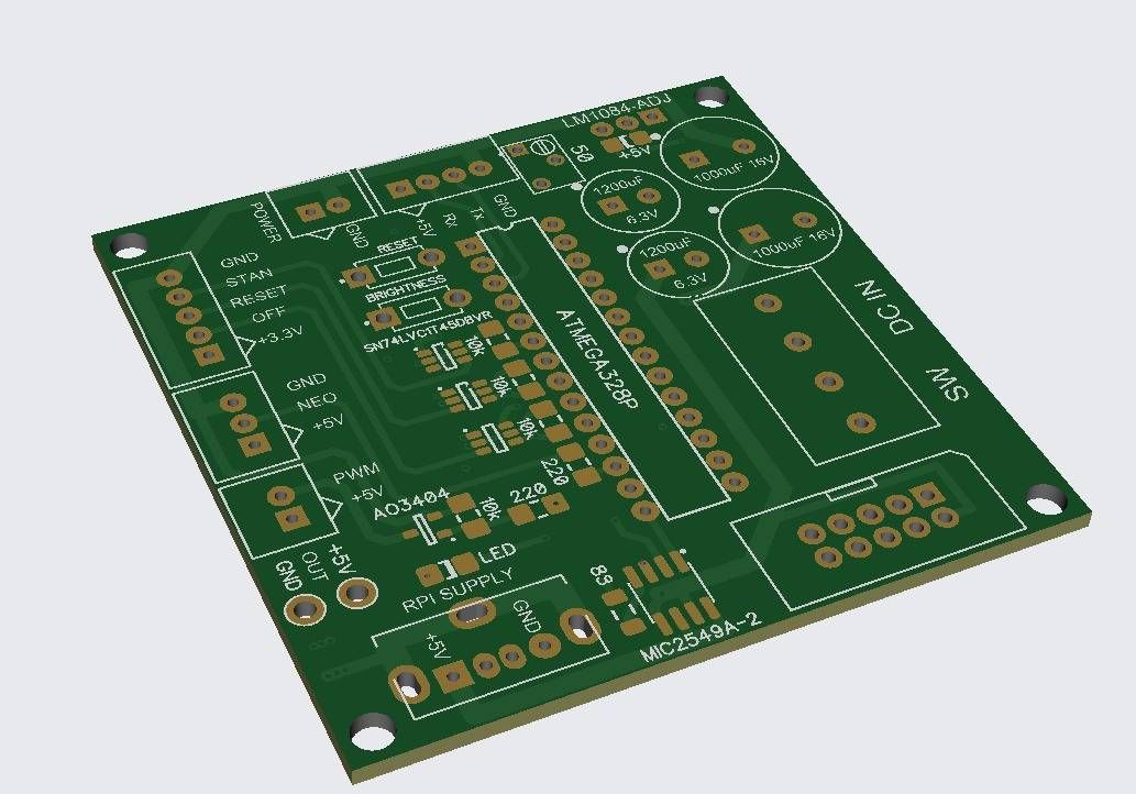

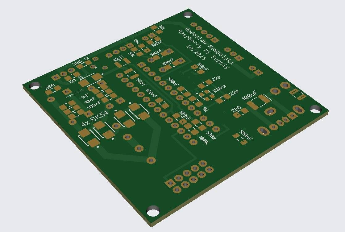

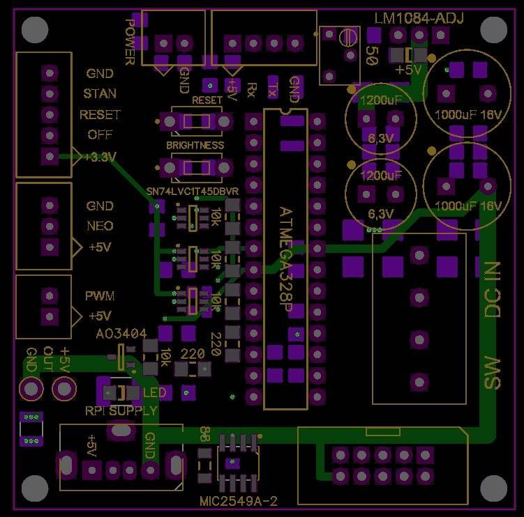

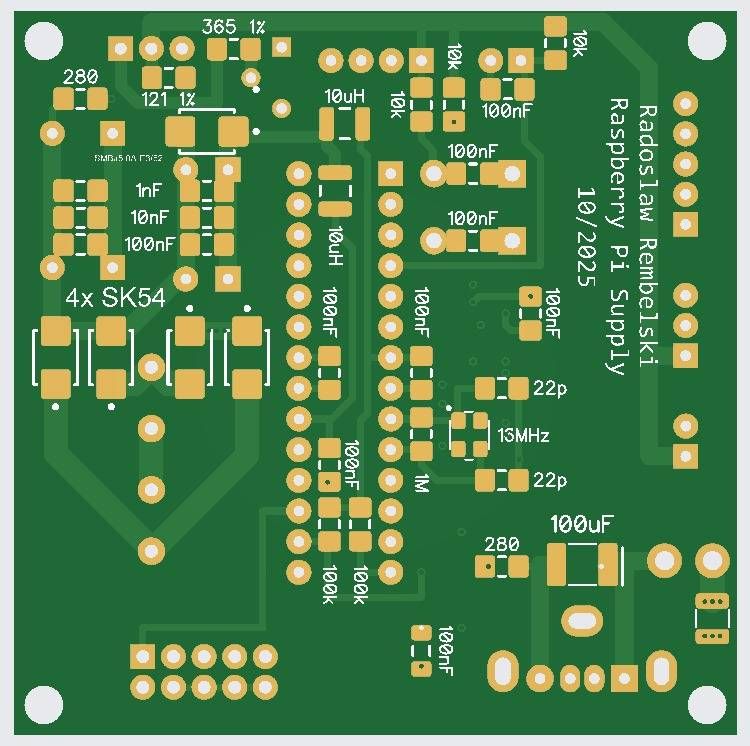

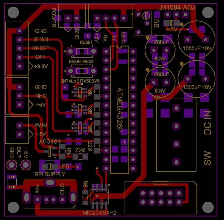

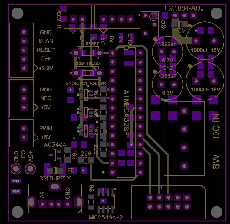

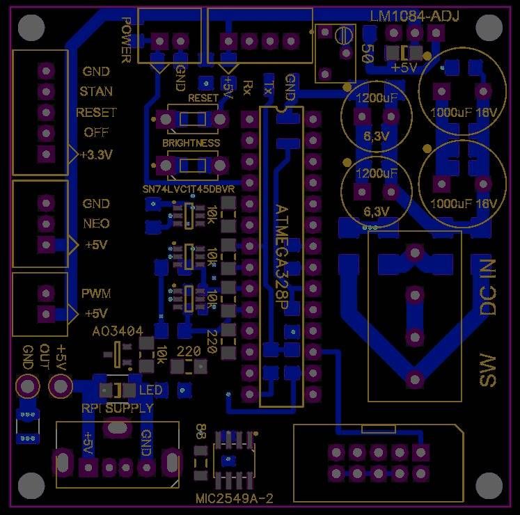

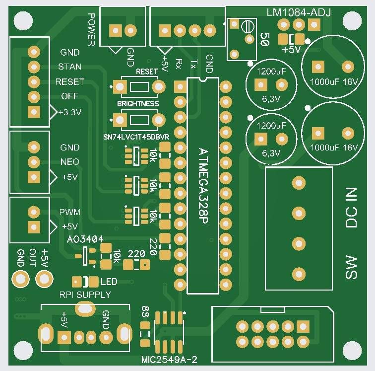

    Now a bit about the power supply, I'll quote myself from the tube topic:
    "Radek sent drawings of the board. They are already ordered. The atmega board is nearing completion as far as I know. I have ordered all the components for the power supply. Assembly is a matter of 2-3 weeks.
    Why is the power supply so complicated? The whole thing is that I wanted a few more features, Radek added a few more from himself, and it got complicated.
    The principle is simple: pressing the on/off button is to turn on the power to the RPi, during startup is to turn on the backlighting of the buttons and volume knob and to make things more difficult, I proposed to control the LEDs with PWM waveform from 0 to 100%. Pressing the on/off button again will switch off the RPi but this is to be done according to a certain procedure. First, the power supply controller issues a 1sec signal to the GPIO of the RPi responsible for turning off the Volumio, On the next GPIO the Volumio activity signal is issued and its state changes when the system is shut down. The power supply observes this state and when it changes it adds a few more seconds and then shuts down the RPI power supply. Why does it work this way? Because the Raspberry is still calculating something for 5-6 seconds and switching it off at this point could cause a problem with the program. Of course the PWM control works in the opposite direction, i.e. from 100 to 0% and the leds are supposed to fade nicely.
    For proper operation you need GPIO control and this can be achieved by installing two Volumio plugins : GPIO Control and GPIO Buttons.
    The stabiliser function is performed by the LM1084-5V or ADJ version. It has enough reserve current to pull the RPi 4B.
    Radek suggested to use RGB programmable diodes to get proper colour, on my request he made brightness control :D . In the larger Volumio project you can use RGB diodes , in smaller projects on monochrome oleds you can use PWM output.
    As far as I know Radek has designed to switch on the RPi using a powerswitch with current measurement and the overload state is to be signalled by a change of backlight colour.
    We will see how this works in practice."

    OLED display showing time and IP address, connected to Raspberry Pi

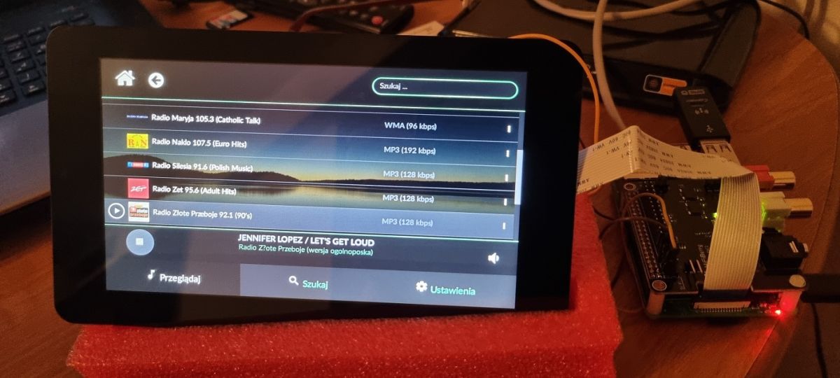

    I was getting tired of waiting for Volumio to shut down and manually switching off the power. It had to be solved somehow in the end.
    The power supply boards are ready, they should be in the country in a few days. I have ordered myself another waveshare DAC in the PI Zero size from majfrends. It's a wonder that this version is not available in Poland. Pi zero2W, a DAC like the one in the picture plus Volumio ver. 3.251, possibly with a 1.3" oled and you can have a nice little player for a little money. Power consumption at start-up is up to 500mA, during operation up to 300mA - measured.
    Waveshare PCM5122 audio board with connected wires on a wooden surface

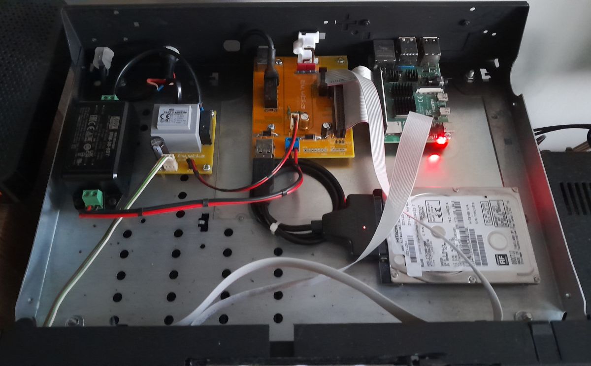

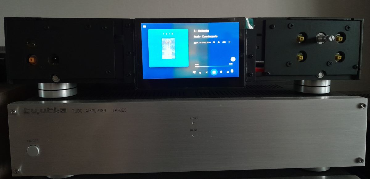

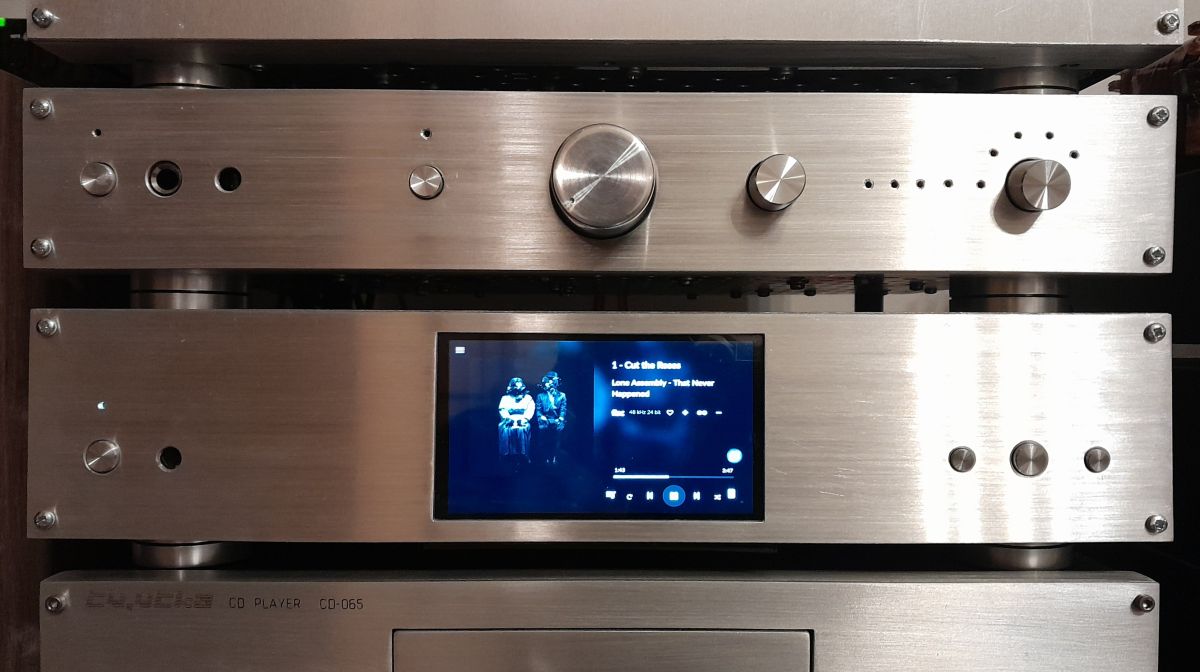

    To be honest, I've been getting together for a few years now to put together a player on RPi and Volumio.
    I've reworked various options in the meantime, but it's finally final. And, in fact, it's nearing completion; all that's left is the finishing work on the front panel.
    I reworked various displays, but eventually came to the conclusion that it was best to go for one with a DSI interface. I decided to make the DAC my own with a PCM5102 chip (cheap, but quite good). Using the plug-ins, it is easy to make extra buttons/encoders, and most importantly, system shutdown. As for the power supply, I decided on an inverter that powers the RPi module, and a small linear power supply that powers the DAC and standby circuit.
    These are the heavily working pictures of my outtakes:
    Inside of a custom case with Raspberry Pi, HDD, and DIY audio electronics
    Audio panel with Volumio touchscreen on Raspberry Pi mounted on tube amplifier
  • Single 5 V LM1084 supply for Pi4B

    I went for a single power supply.The LM1084 powers the standby circuit and via the powerswitch will feed power to the RPI. The mentioned LM 1084 has a maximum current of 5A. The Rpi with dac and display consumes 950mA at start-up and afterwards 750- to 850mA. To this you have to add the current of the leds but still the reserve is large. I had the idea of using a Tracopower inverter ( from a demob) but the output current of those available was too low or the input voltage from 18V upwards. The idea is for the circuit to be powered from an AC or DC supply of 12-16V. I made a power supply for the Pi4B on a 1084 some time ago and it works perfectly so in the power supply design such a stabiliser was used. Radek has designed a board for the 1084ADJ version and there is room on the pcb for a precision potentiometer and some additional resistors. I will use the 1084-5V in mine and omit these components.

    I am very familiar with the LM1084 circuit.
    Originally I also thought about powering the whole RPi from a linear power supply. However, in the end I chose the option with an inverter for the RPI and a linear power supply for the DAC and standby circuit. Of course, the inverter does not work during standby, it is switched on for the active time of the device.

    At my place the Volumio is actually just waiting for a case. System version 2 somethingtam (can't remember because I installed it a few months ago) on RPi2+ with HiFiBerry DAC and Waveshare 4.3" touchscreen display on DSI. I've been looking for solutions with system shutdown, but I think I'll end the topic - waiting a while with manual power off after closing the system from the menu satisfies me, as I like simple solutions.
    Waveshare 4.3 touchscreen with Volumio interface and audio cables connected

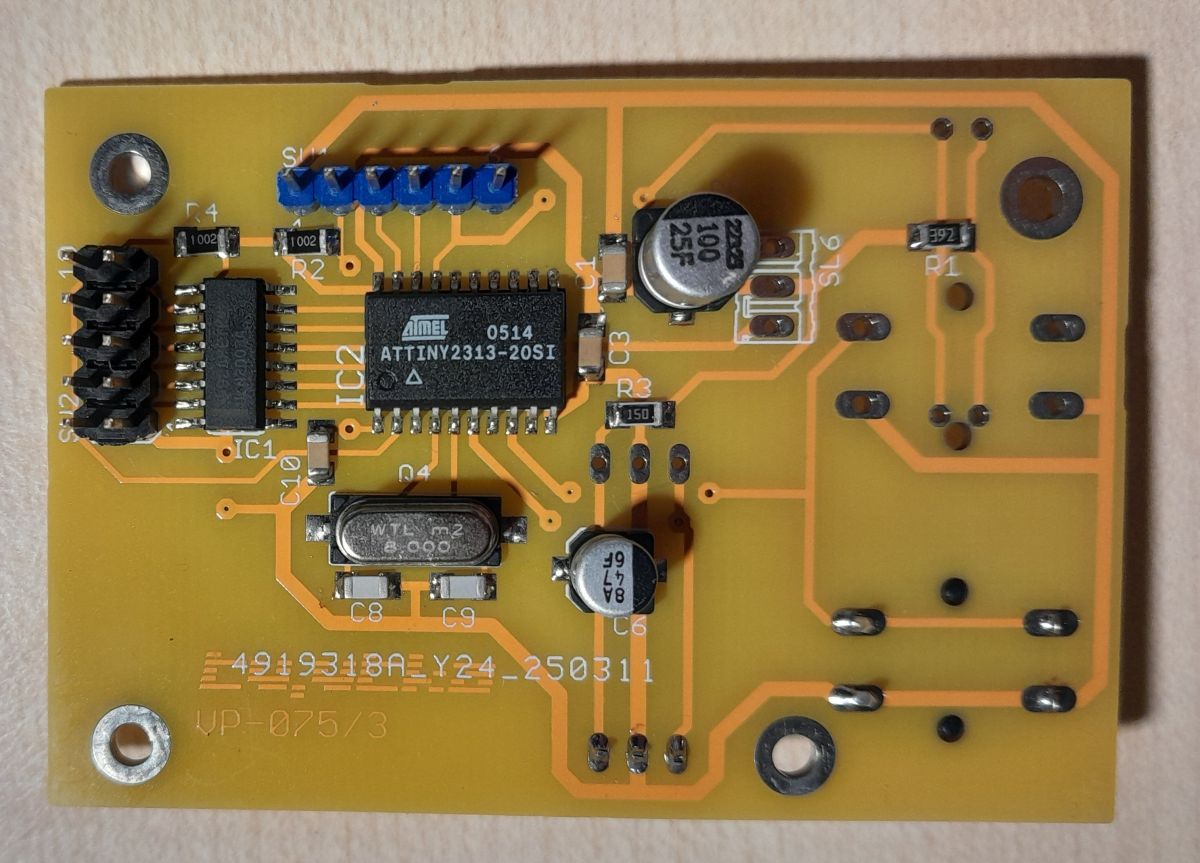

  • Simple delayed power cutoff after Volumio shutdown

    After the system shutdown command, Volumio shuts down quite quickly; it seems to shut down in a few seconds at most. So all you need is a simple circuit that shuts down the power supply after such a time from the shutdown command.
    I seem to additionally check for the presence of +5V on the raspberry's USB connector.

    And do you think it's different with me?
    I additionally (just to be sure) check for the presence of +5V on the USB A connectors, so as not to cut power too early.

  • Attiny delays power cut after Raspberry shutdown

    In my case, the Attiny sends the shutdown command, waits for the USB connectors to lose voltage, additionally waits a few more seconds and only shuts down the power to the Raspberry. This is, in my opinion, a safer method than just delaying after sending the shutdown command.

    In my case, Volumio puts out a high state on the GPIO pin from the moment Volumio itself starts up until it shuts down, Atmega observes the state on this GPIO and adds a few seconds until the power is removed. I will check how the power supply on the USB is related to this and at what point it is disconnected.
    I had a display 7 before but found it not very practical in my case.

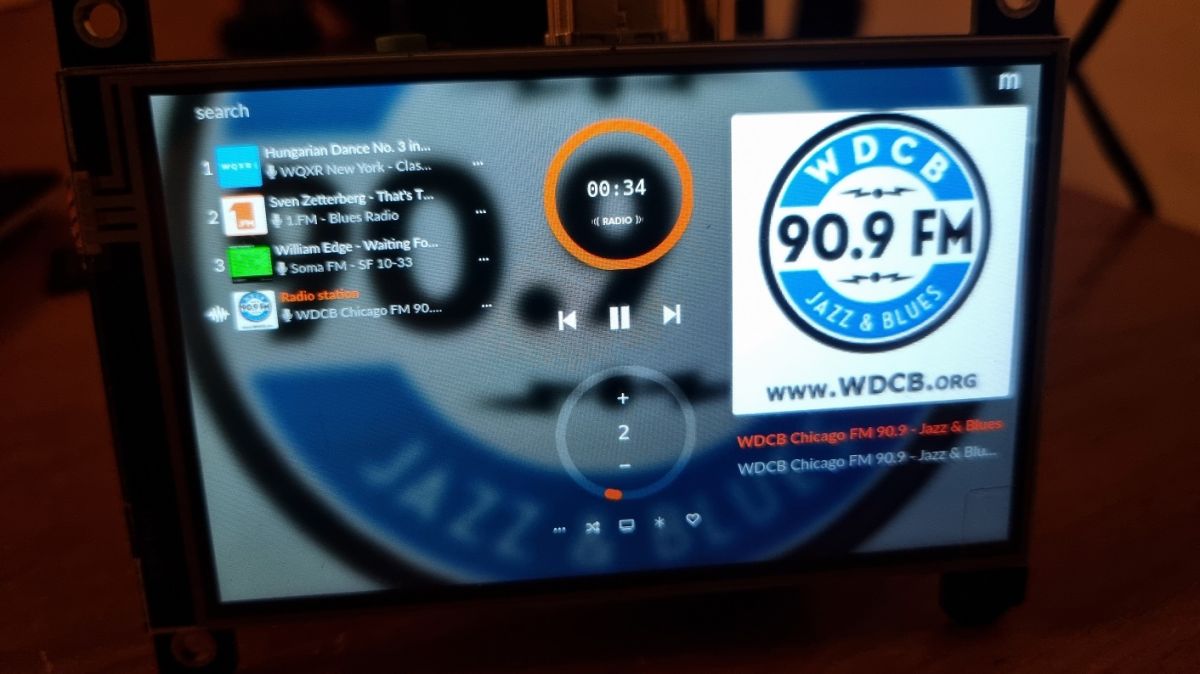

    I've downloaded the Moode image, I'll try to get it running on the Pi4B tomorrow. From what I recall I ran Moode a couple of years ago but can't remember why I let go of further attempts.
  • Moode lacks SPI touch support and station search
    #29 21712326
    slawekscorp
    Posts: 302
    Rate: 104
    Waveshare display showing Moode Audio interface with WDCB 90.9 FM radio station
    I installed Moode a while ago. I'm unlikely to go for this software. First thing: I couldn't get the touchpad to work in the Waveshare display where the touch is on SPI, the second thing is a very strange search for radio stations and these are the stations I'm mainly concerned with. I went into some search option but either I don't know how to search for stations by genre or it's not possible. Perhaps the search engine itself is not able to search for a certain type of music, which is trivial in Volumio. Perhaps this is why I gave up on Moode a few years ago. I'm not saying it's bad software, it just doesn't meet my expectations.
