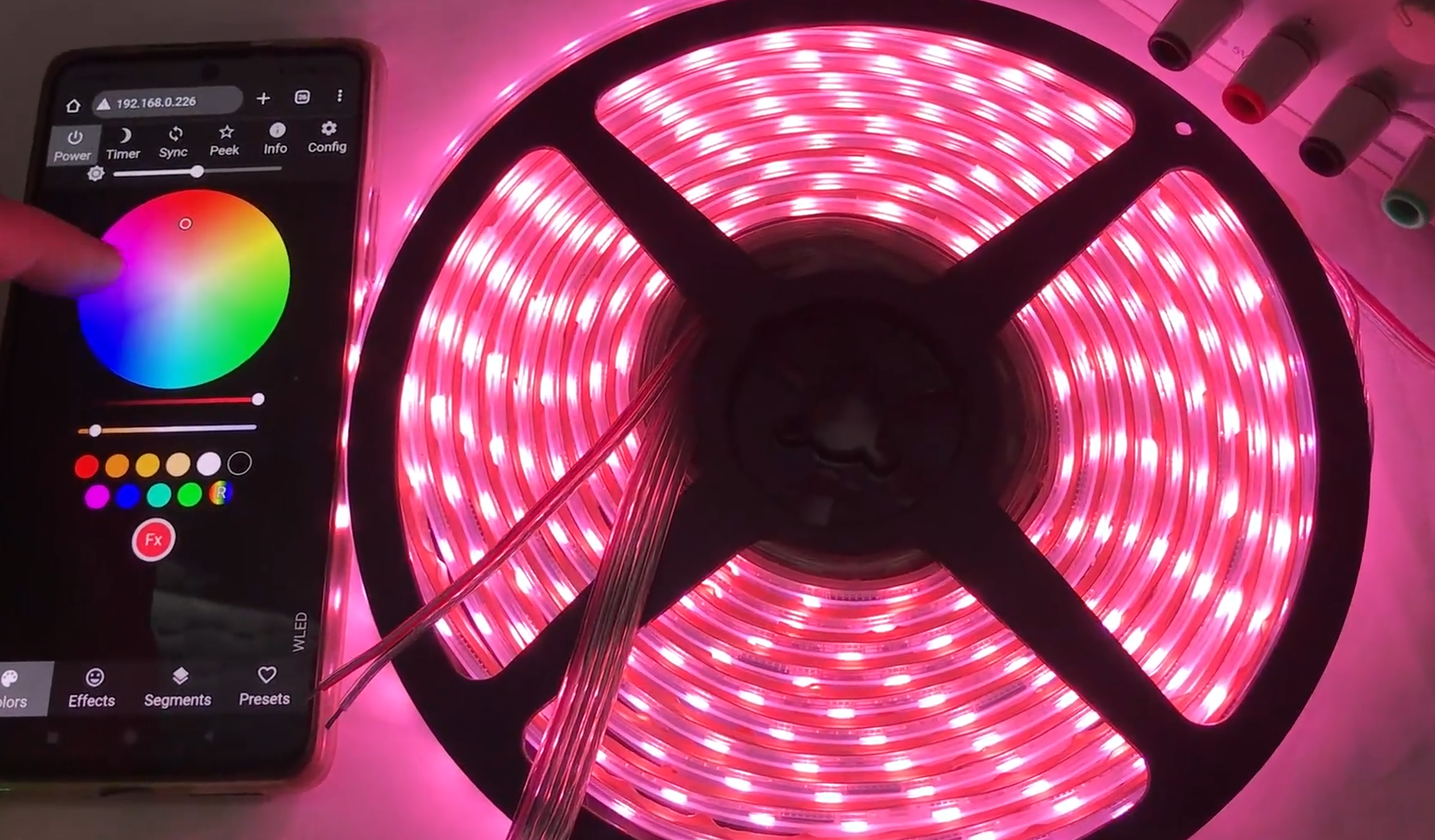

  • Phone controlling an RGBW LED strip on a reel, glowing pink .
    Here I show how to run an RGBW LED strip with DMX512 based on firmware WLED on a board with built-in RS485 support.
    DMX512 is a communication protocol used primarily in stage lighting that allows multiple devices, including coloured LED strips, to be controlled over a single RS485 bus.
    WLED is open source firmware for ESP8266 and ESP32 microcontrollers that enables control of addressable LED strips (WS2812, SK6812, APA102, etc.) and integration with popular automation systems and protocols such as MQTT, HTTP or Art-Net/DMX. With WLED, various lighting effects can be easily created and operated from the microcontroller.

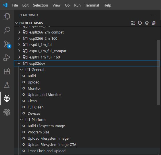

    Basic WLED compilation .
    We start the adventure by learning the basics of WLED compilation. It's basically all described on their official website:
    https://kno.wled.ge/advanced/compiling-wled/
    There are also recommendations for DMX on the same page, but unfortunately they are very incomplete.
    https://kno.wled.ge/interfaces/dmx-output/
    We download the repository from Github, execute npm install , and then open the project in PlatformIO (an extension from Visual Code). We already have the configurations ready there - I selected esp32dev . 'Build' operations etc. should already be working:
    PlatformIO view with esp32dev project expanded and compile tasks listed .
    Compilation and DMX support fixes .
    It is time to modify the esp32dev settings. This configuration is defined in platformio.ini . There I have added DMX support to build_flags:
    -D WLED_ENABLE_DMX
    The -D switch simply adds #define WLED_ENABLE_DMX 1 to the build. Unfortunately, however, an error was issued on compilation:
    usermods/audioreactive/audio_reactive.cpp:10:4: error: #error This audio reactive usermod is not compatible with DMX Out. #error This audio reactive usermod is not compatible with DMX Out. ^~~~~
    I had to additionally remove the line with:
    custom_usermods = audioreactive
    from the same configuration section.

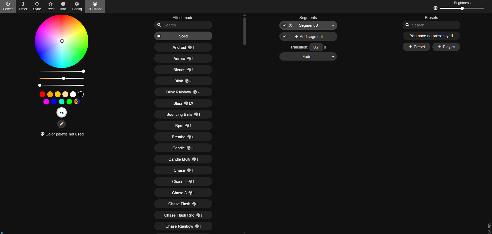

    Configuration of WLED after uploading to ESP .
    After uploading I had to pair the ESP with my WiFi. WLED creates its AP - the password is wled1234. The configuration page has an IP of 4.3.2.1. There you can enter our SSID and password for the device to join our network.
    WLED interface with color picker, light effects list, and LED segment controls .

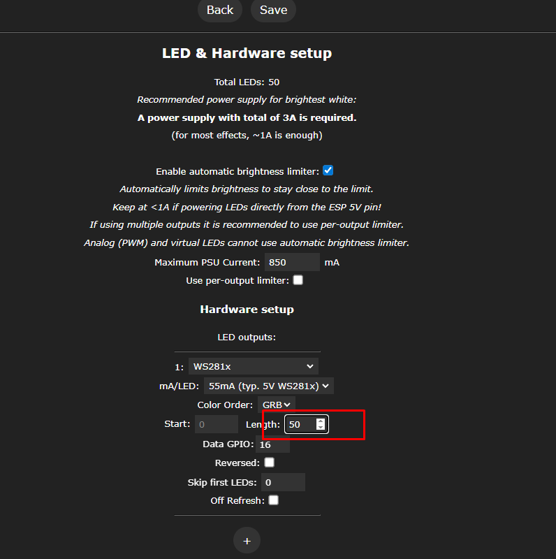

    Then in Config->LED Preferences you need to set the number of pixels. I know, it's quite strange because here are the settings for WS2812 and similar, but that's how it works at the moment.
    WLED LED setup screen showing LED strip length set to 50, highlighted with red border .
    What's more, the bar doesn't work stably for me when I set 50 LEDs here - I've set 40 for now.

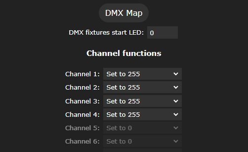

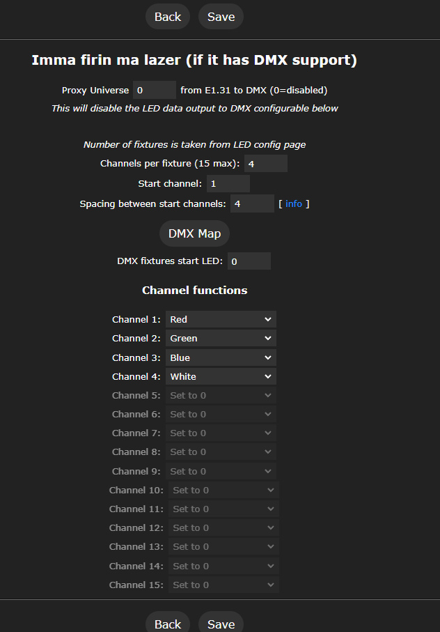

    Next we configure the DMX in Config->DMX Output. Next:
    - channels per fixtures - channels per pixel, here 4, RGBW
    - spacing between start channels - spacing between pixels, also 4
    - start channel - initial channel - 1
    - additionally we set the roles of the channels - successively RGBW
    As in the screenshot:
    WLED DMX settings interface with RGBW channel setup and DMX Map configuration .
    By the way, funny headline - "Imma firin ma lazer". Someone has a sense of humour.

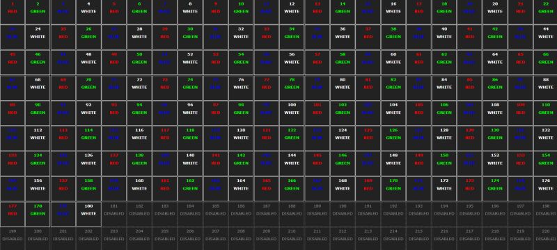

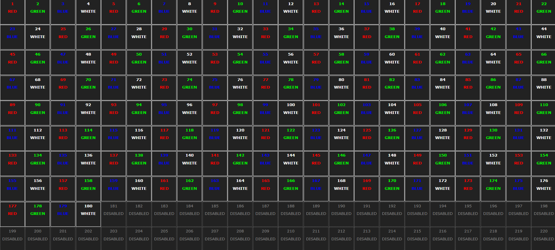

    We save and you can check the mapping by pressing the DMX Map button:
    DMX RGBW channel map showing color assignments in four-channel sections .
    From now on the WLED should be able to control the strip with DMX .

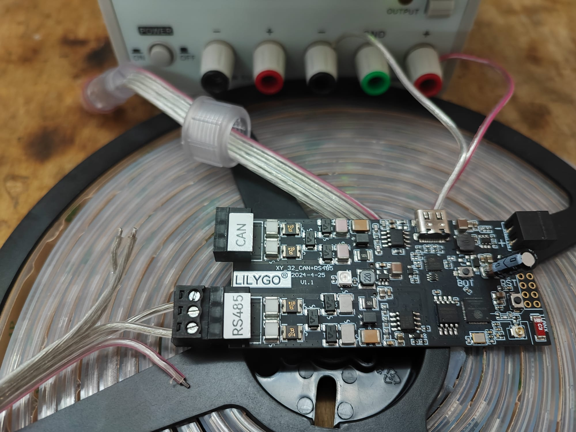

    Connecting the strip to LilyGO .
    Let me remind you of the connection - basically as in the previous topic . Required:
    - a separate power supply, here 24 V DC, according to the strip documentation
    - RS485 from LilyGO (no common ground needed)
    LilyGO T-CAN485 board connected to RGBW LED strip and lab power supply .

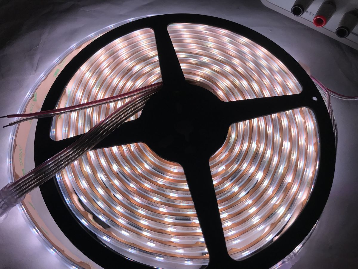

    Results .
    I have shown the results in the videos. The WLED can both animate the bar with a single colour (kind of like a single pixel), and of course it is also able to control individual pixels (here: sections) of the bar:

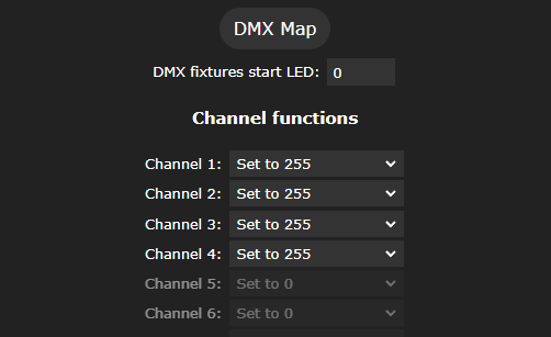

    Finally, I still checked the power consumption of the whole strip as a test. I forced all channels to 255 (full brightness) in the DMX settings:
    Screenshot of DMX Map with channels 1–4 set to 255 in the WLED interface .
    The result:
    Power supply display showing 1.85 A and 23.6 V with control knobs .
    Illuminated RGBW LED strip coiled on a reel and prepared for wiring. .
    It appears that the full brightness of this strip is 43.66 watts.
