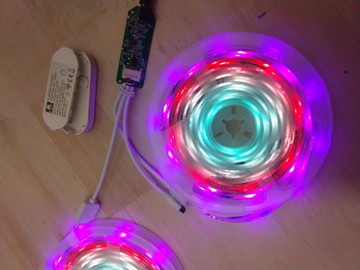

    LSC Smart Digital RGBIC LED strip lighting up in various colors, next to exposed electronic circuit boards.

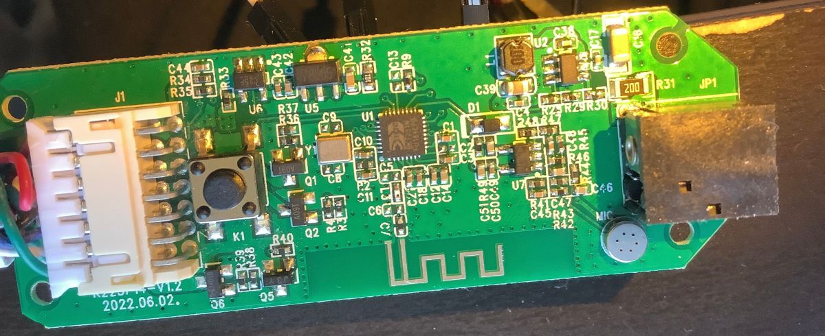

    I flashed the RGBIC LED Strip "LSC Smart Digital LED Strip 2x5m", part no. 3008407 from Action via tuya-cloudcutter to Openbeken. The board-name is "K225P14-V1.2 2022.06.02".
    Circuit board with electronic components, including a connector, microphone, and an integrated circuit.
    On the sticker of the board box one can read: "6125000200 JH H22922 ... RGB 2700K-6500K Wi-Fi:2.4GHz-802.11b/g/n"
    Here are my settings:
