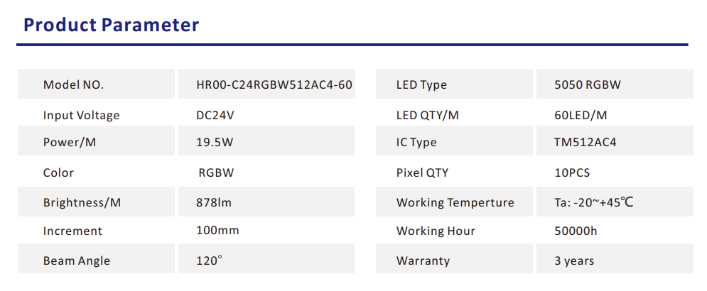

    Here I will present an individually addressable RGBW LED strip (red, green, blue and white) based on the TM512C4 chip and operating on 24V. I will show here how its DMX512 communication protocol works and how it can be simply controlled from an RS485 ESP32. I will use the ESP32 LilyGO T-CAN485 board for the demonstration, as it makes things a bit easier and already has a built-in UART->RS485 transceiver.
    Technical specifications of HR00-C24RGBW512AC4-60 RGBW LED strip displayed in a table .

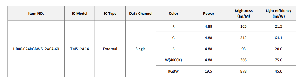

    Let's start with the parameters of the tape. The tape has 60 SMD5050 LEDs per metre and is available in sections of 5 metres. There are four colours - in addition to the standard RGB, we also have 4000K white (neutral daylight) which allows for a variety of natural effects. The full model of the tape is HR00-C24RGBW512AC4-60.
    RGBW LED strip with TM512AC4 IC and labeled signal lines .
    The controller used is an external chip and there is one for every six LEDs here, so we cannot control them completely individually.
    LED RGBW TM512AC4 strip specification table: power, brightness, light efficiency .

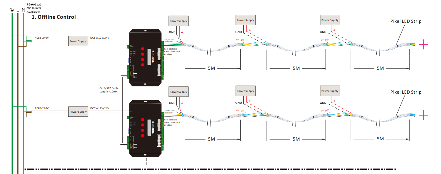

    The manufacturer suggests dedicated K-8000C controllers for this, but we will figure something out ourselves:
    Wiring diagram of 24V RGBW LED strip with K-8000C controller in offline mode .

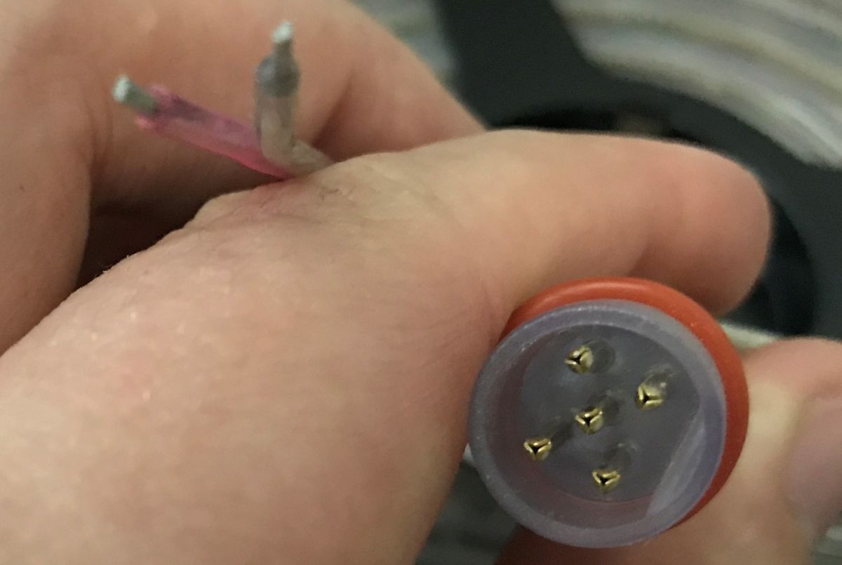

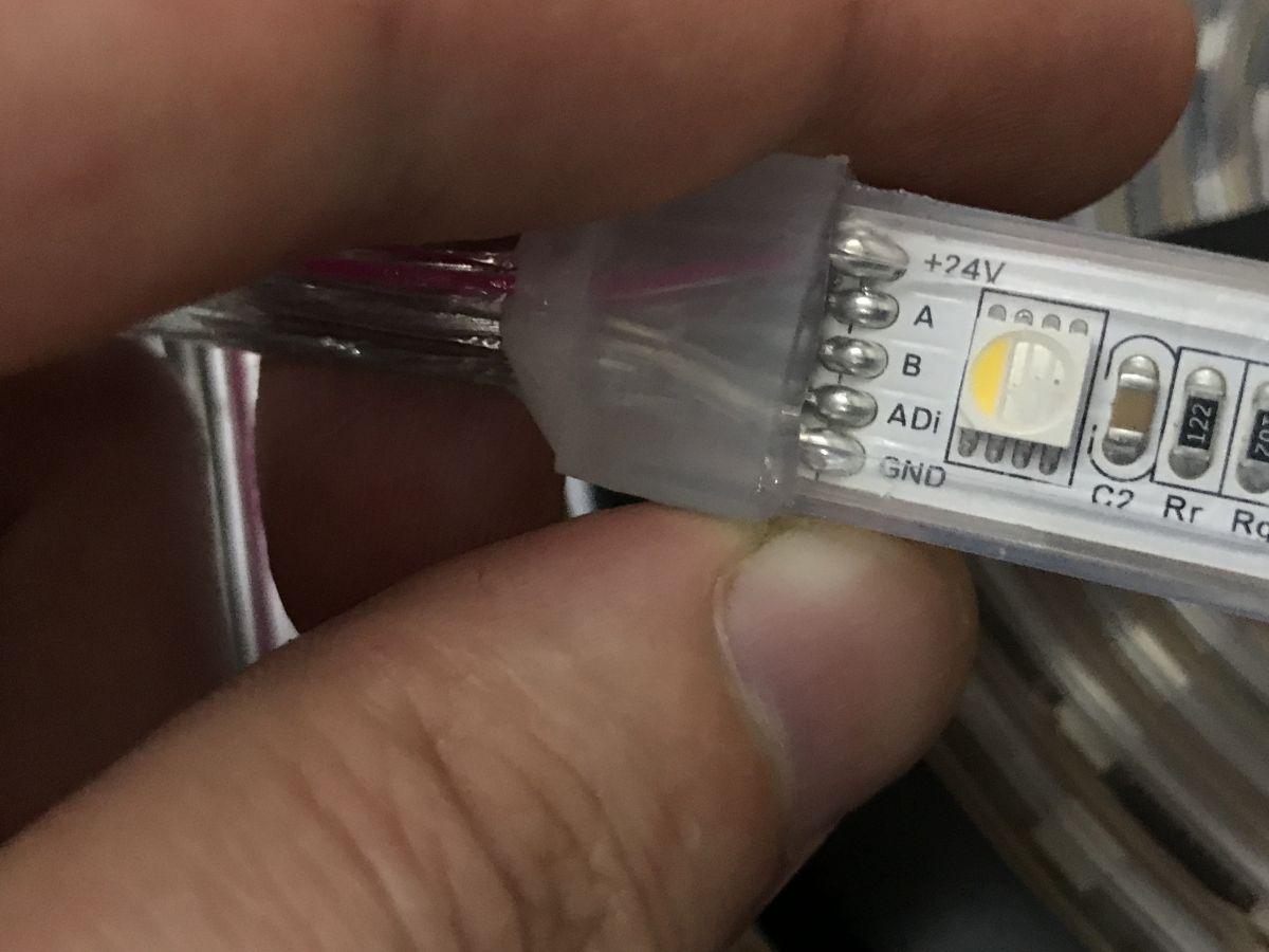

    6-pin LED RGBW strip connector held in hand .
    Here we have 5 lines, consecutively:
    - +24V - power supply
    - ADi - used for addressing
    - A - RS485 lines
    - B - RS485 lines
    - GND - ground
    The power supply is additionally led out. The tapes end with plugs for easy installation.

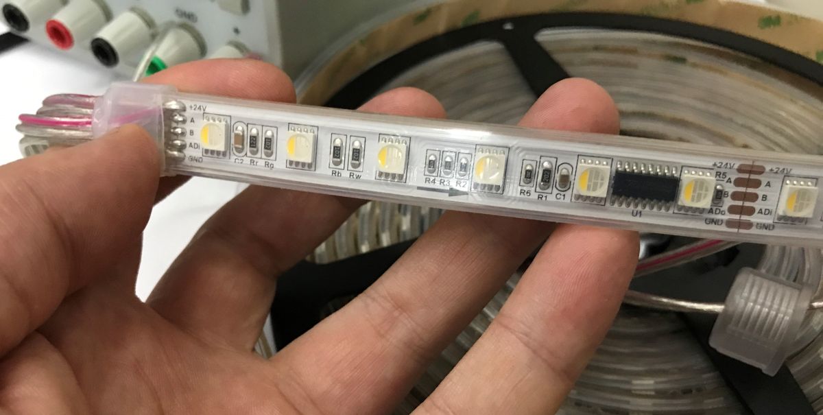

    Close-up of LED strip connector with labeled lines: +24V, A, B, ADi, GND .
    The tape is divided into fragments - one IC for six diodes:
    Close-up of 24V RGBW LED strip with LEDs, resistors, and TM512C4 controller visible .

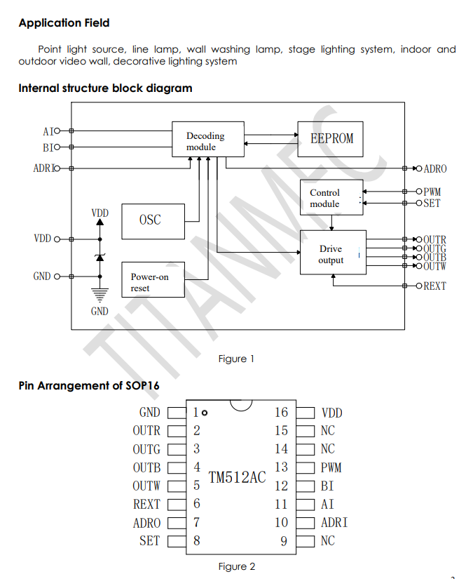

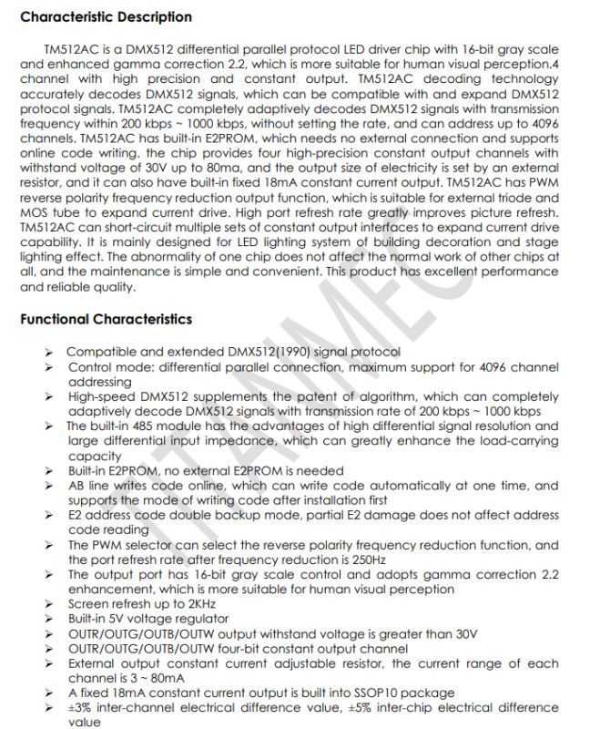

    This chip is the TM512:
    Block diagram of TM512AC chip and SOP16 pinout layout .

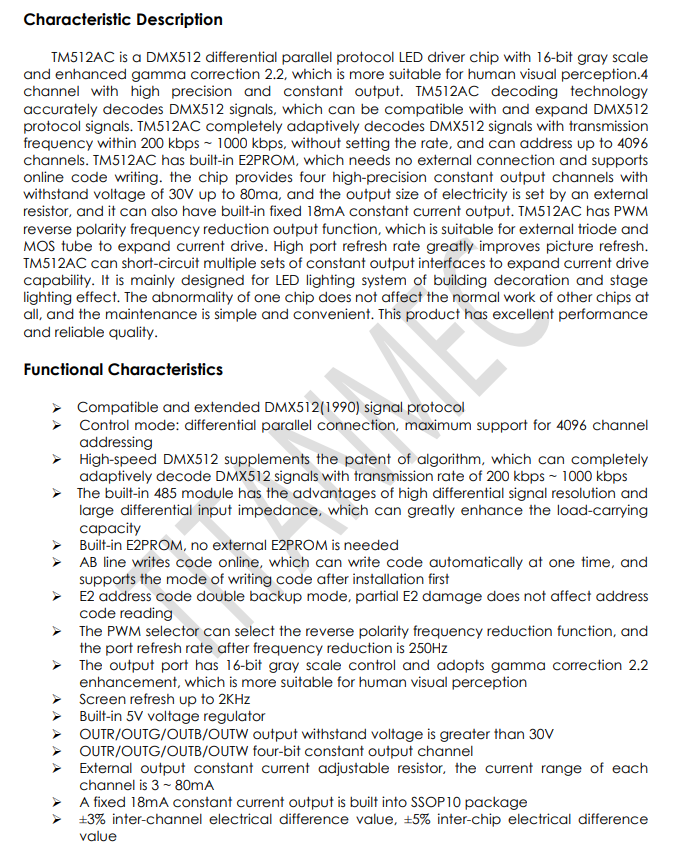

    The TM512 is a DMX512 precision LED driver with 16-bit greyscale, gamma correction and adaptive decoding of up to 4096 channels, supporting DC and PWM modes for controlling external transistors. It is designed for LED lighting and animated stage effects
    TM512AC datasheet excerpt showing DMX512 LED driver features and functions .
    DMX512 is a popular protocol used in stage lighting that defines a fixed baud rate and a data packet of 512 channels. DMX512 may seem quite mysterious, but it basically boils down to sending individual values via RS485, i.e. via a UART + RS485 transceiver providing the appropriate levels. RS485 is a serial transmission standard that allows data to be sent over longer distances and under more difficult conditions than a regular UART. It allows operation in differential mode, meaning that the signal is transmitted as a voltage difference between two lines (A and B), which significantly increases noise immunity. Simply connect a suitable converter to the UART and you have RS485 - for example, the MAX485:

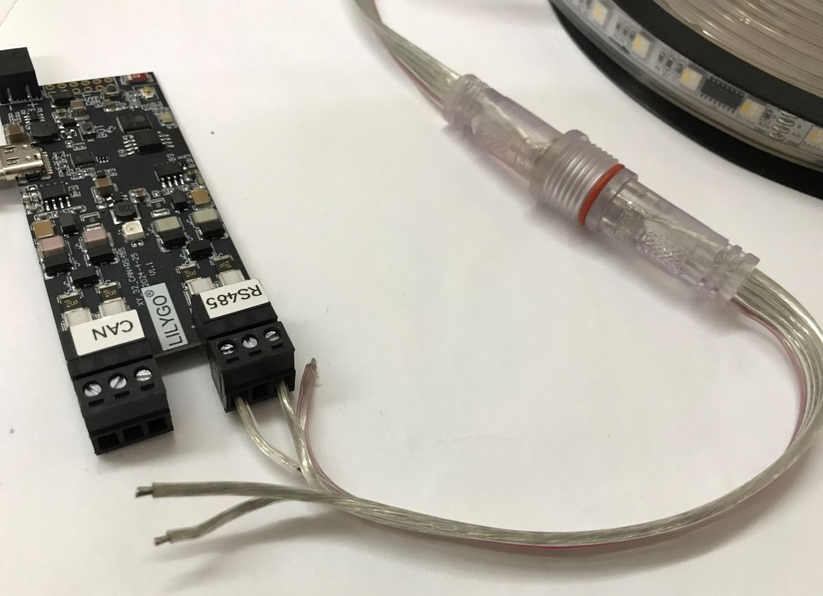

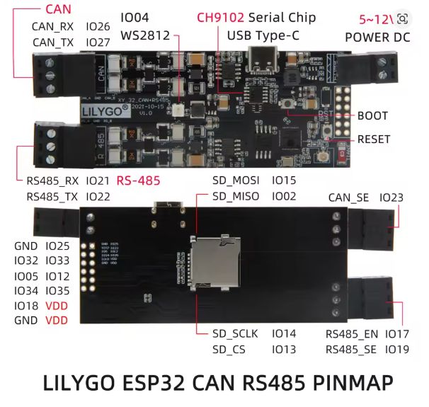

    You can also use a ready-made one - for example the ESP32 LilyGo T-CAN485 module:
    LilyGO ESP32 board with CAN, RS485 and labeled functional pin layout .
    RS485 from the code level is handled just like the UART - you simply need to initialise the port, set the baud and you are ready to send bytes.

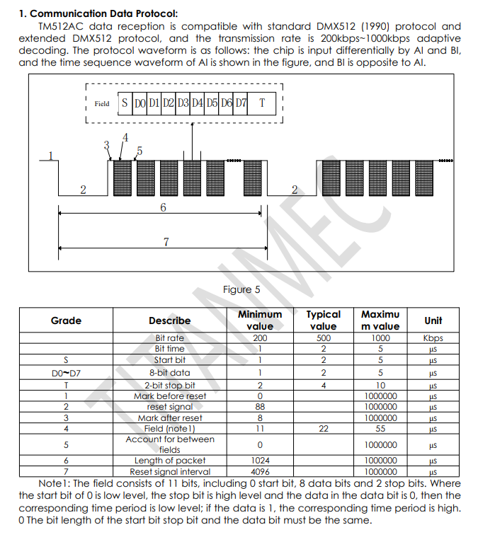

    Now the question - how to send these bytes ? This is described in the 'Communication Protocol' section of the TM512 data note:
    DMX512 signal waveform diagram with bit structure and protocol timing table. .
    The transfer rate (baud) is 250,000 bits per second. 513 bytes are sent (almost as in the name - DMX512), with the first byte not used. Usually one byte is per channel, so in the case of an RGBW strip we have 4 bytes per receiver. In this way, up to 128 such pixels can be handled.
    In addition, DMX requires a proper packet start procedure, only then is the data sent. The default state of the line (idle) is high, then we set the low state to at least 88µs, then the high state to 8 µs and start the transfer. We will realise the start condition "manually" by operating on the pins, and the data sending will be performed for us by the Serial object.

    Time to test. Finally, I'll discuss the connection - 24V for power and RS485 for lines A and B. There is no need for a common ground as RS485 is a differential signal.
    ESP32 LilyGO T-CAN485 board connected to RS485 wire and RGBW LED strip.

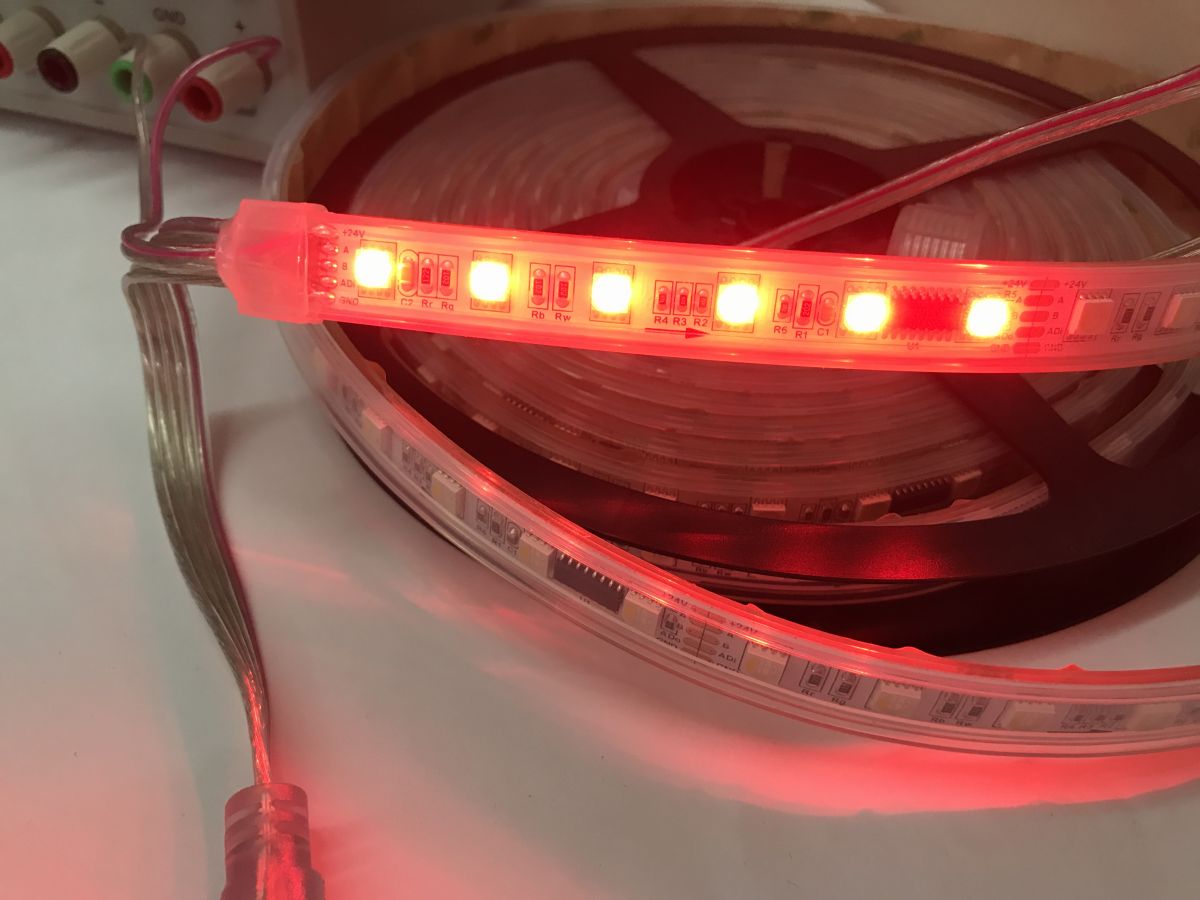

    Red:
    Code: C / C++
    Illuminated red section of an RGBW LED strip with visible integrated circuit .

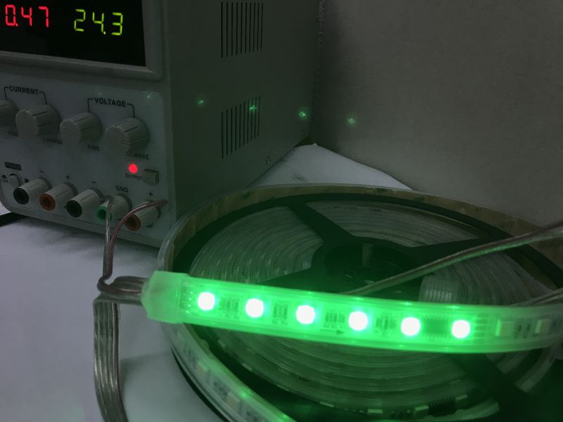

    Green:
    Code: C / C++
    RGBW LED strip connected to a lab power supply, glowing green .
    And so on. Green - dark:

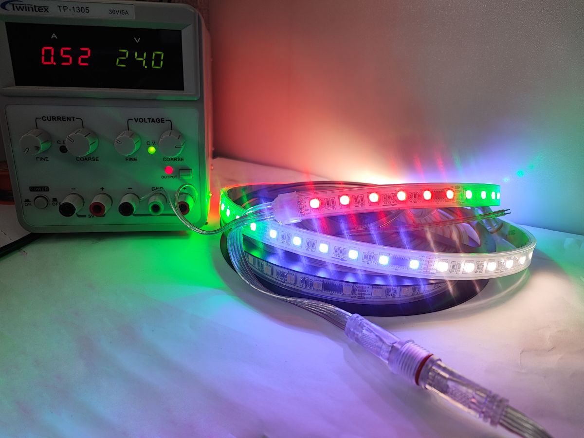

    Various colours:
    TP-1305 power supply and connected RGBW LED strip with active colors .

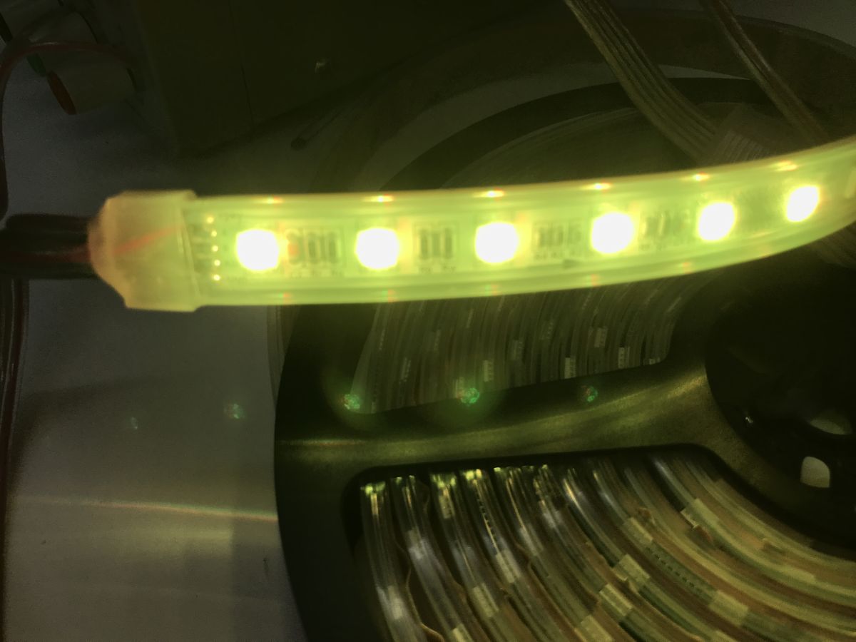

    Now let's check the colour combinations. Yellow (red + green):
    Code: C / C++
    Close-up of RGBW LED strip segment glowing yellow inside silicone casing .

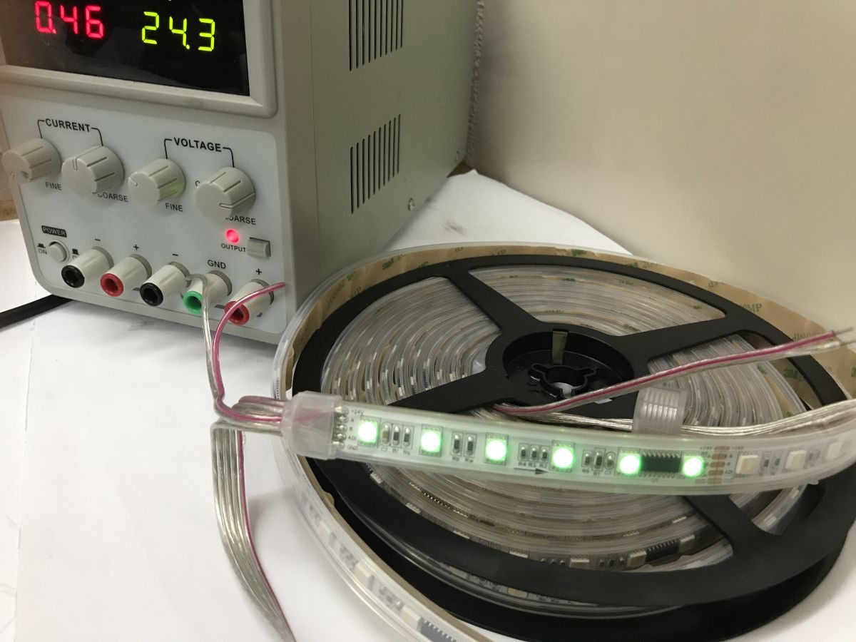

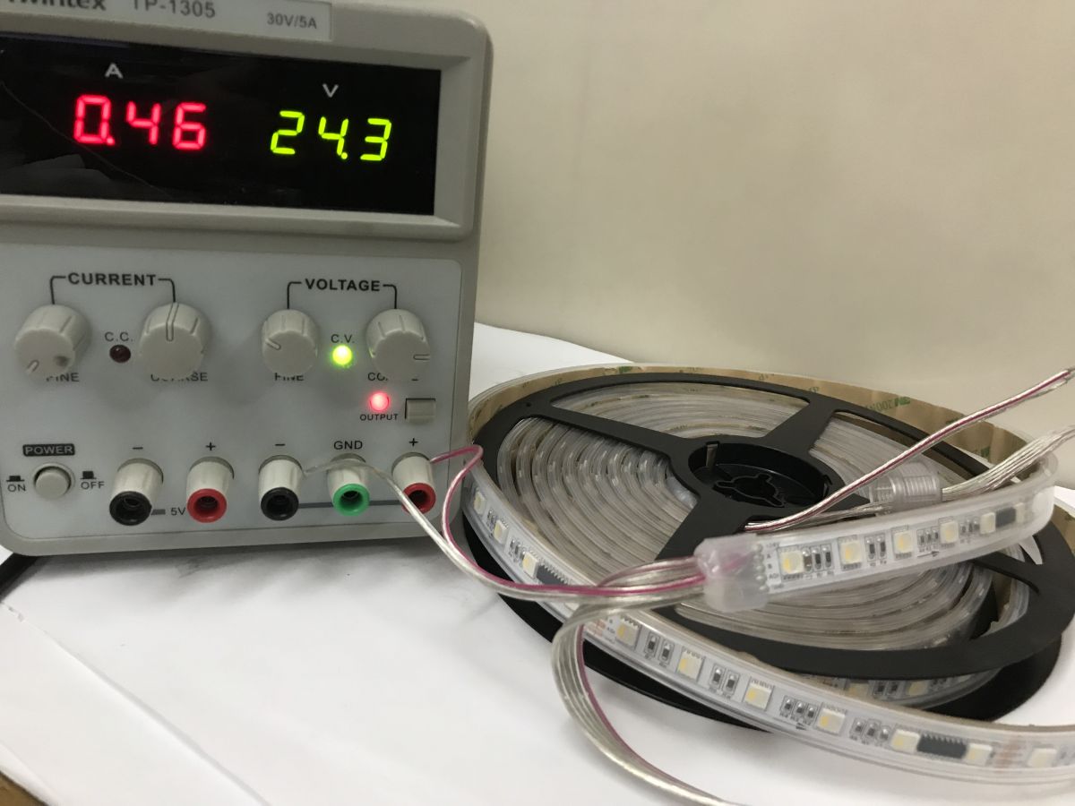

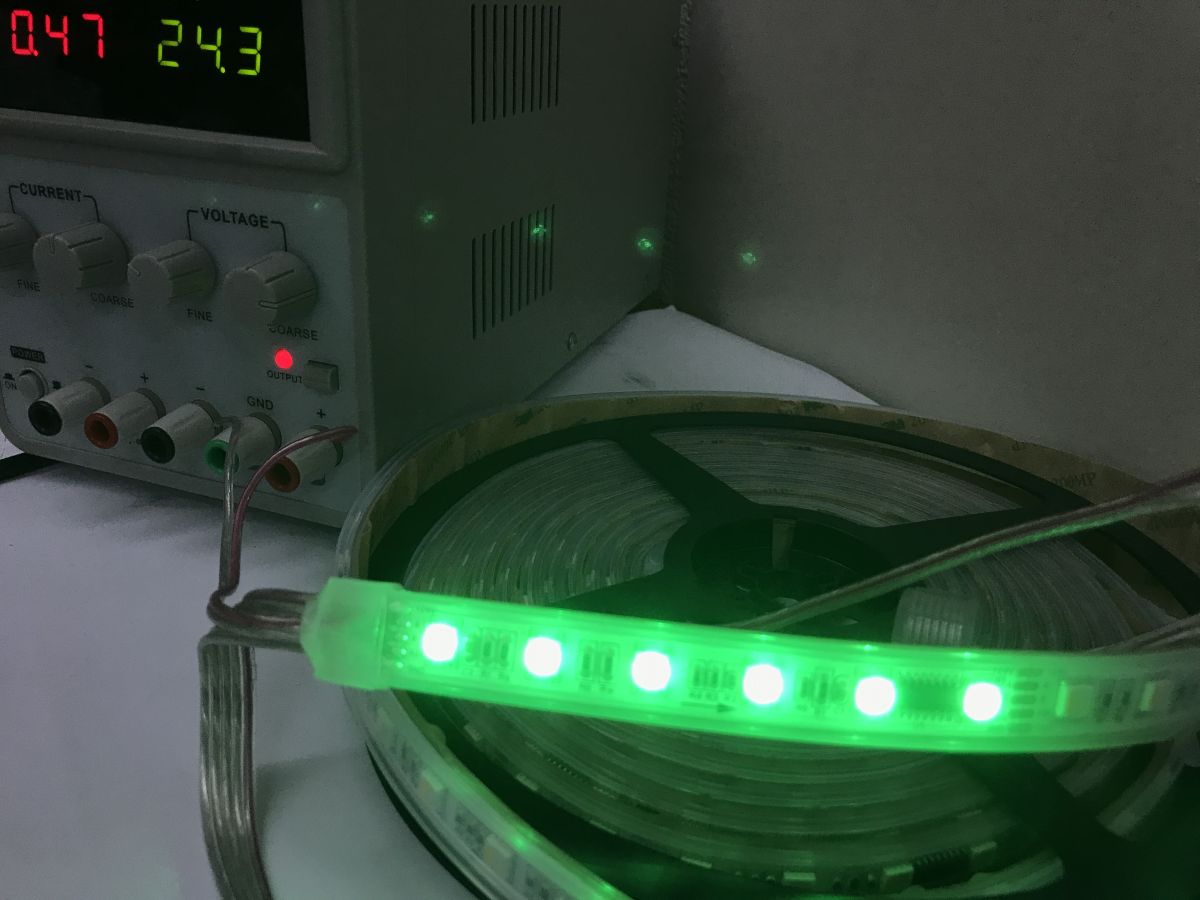

    Let's examine the current consumption for a five-metre section of this strip.
    All pixels off - 0.46A at 24.3V:
    Power supply showing 0.46A and 24.3V with a connected RGBW LED strip on a spool .

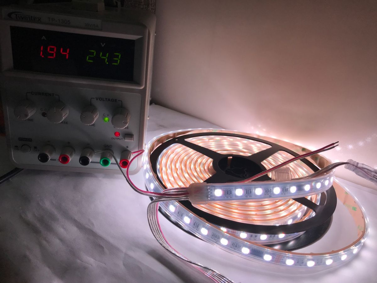

    All lit - 1.94A at 24.3V:
    Lab power supply with connected white-glowing LED strip and visible wiring .
    The conclusion imposes itself. 12W standby (!!!) and 48W during operation. That is, 36W light and 12W burned out.... on just what? It appears to be on the TM512AC power supply. You also need a resistor divider for this, on which a bit of power is lost:

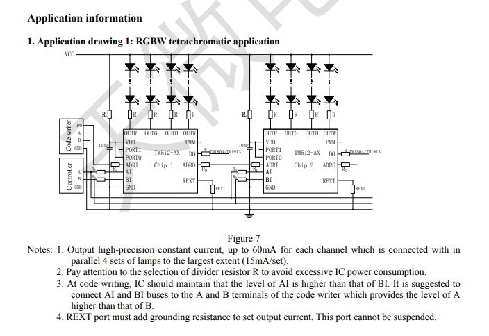

    RGBW application schematic with two TM512AC4 chips and LED wiring .
    I haven't analysed this in any depth though. It definitely looks like the target circuit needs to detect the belt off and disconnect the VDD....
