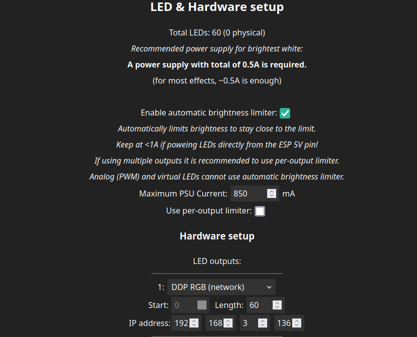

    I used the software WLED flashed on a cheap ESP (D1Mini coming with an ESP8266 in my case) to control a RGBIC LED strip, flashed with openbeken, wirelessly using the DDP protocol.
    After flashing the ESP and configuring the Wifi settings the only thing to do is to add a LED device via DDP Protocol
    Screenshot of LED and hardware configuration settings in the software.
    On the OpenBeken device the ddp driver has to be installed:
    startdriver ddp
    and that's it!
