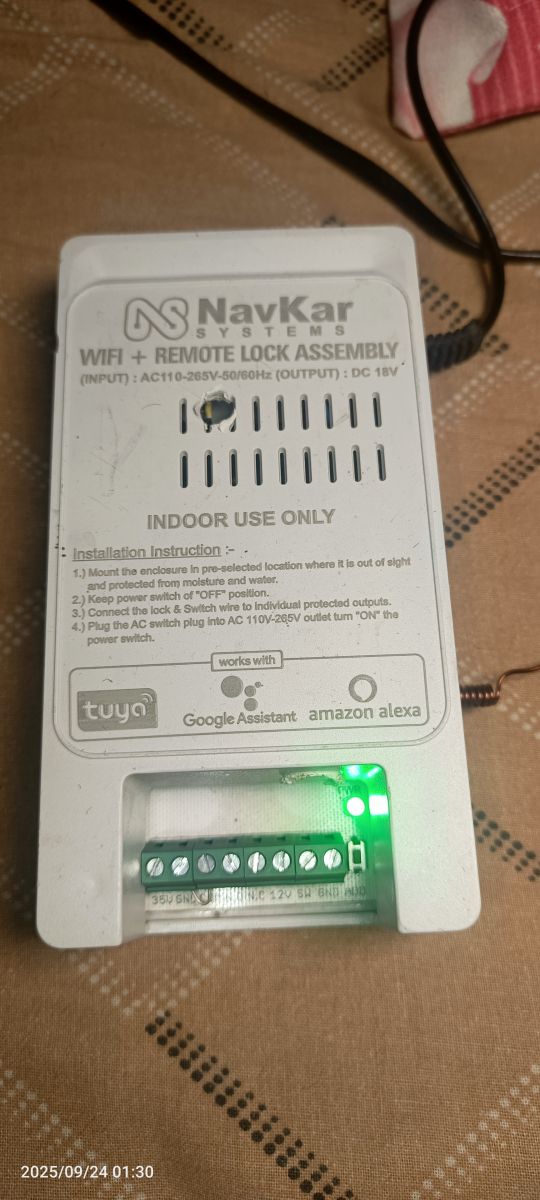

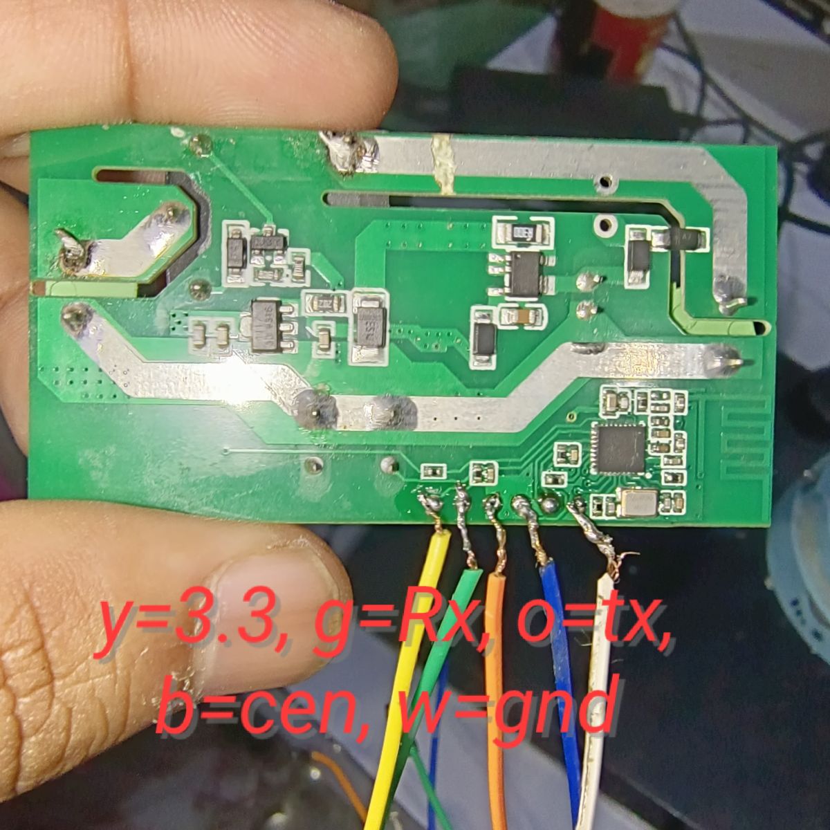

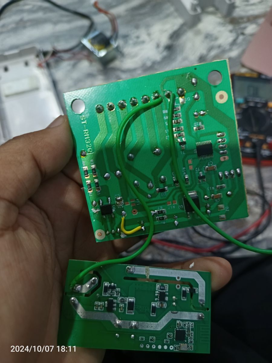

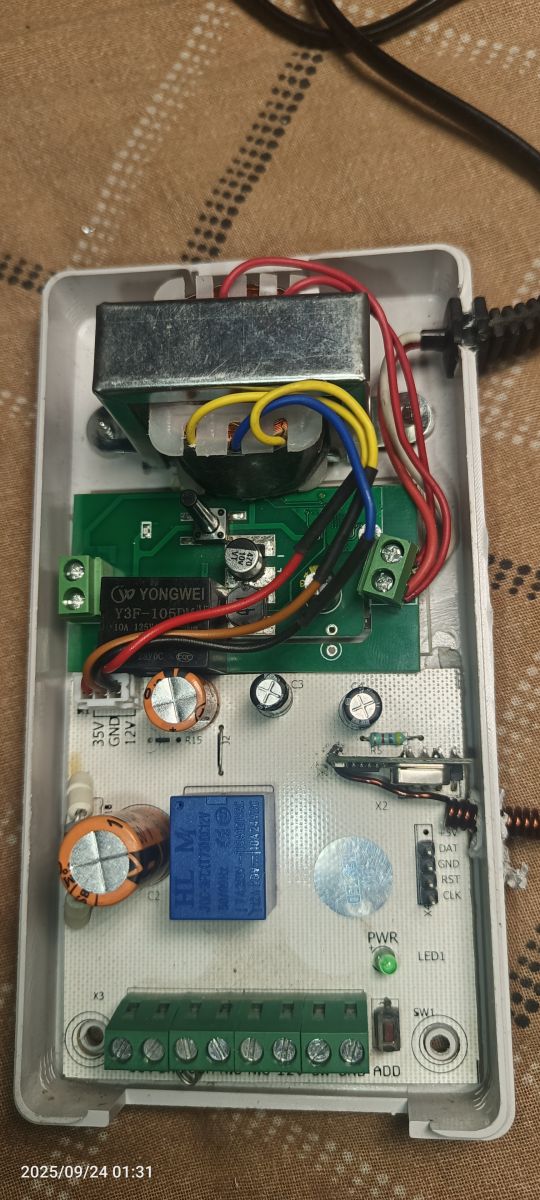

    Navkar Wifi + Remote Lock Assembly,
    This is a door lock system using BK7231N , I flashed openbeken and applied the config extracted from the tuya firmware, Everything works as expected now, thanks to Mr p.kaczmarek2 for his help,

    Switch is toggled by webinterface sott button mapped at pin6 and physical button mapped at pin23.

    I can see a problem. You have used:
    Channel7
    But your relay is on channel 1, and pin 7. There is a difference between pin and channel. Try using correct channel index.

    Thanks , You are genius, where can I read more about pin and channels , any docs available clearing basic concepts.
    Now it works as expected, Thanks a lot.....
