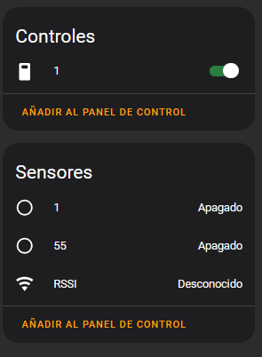

    On Home assistant after a reboot, they seems to be fine:
    Screenshot of control panel displaying controls and sensor information.
    The relay (marked as 1) is working fine, but the magnet sensor (55) is not working at all
    Any help?

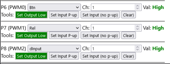

    This are the pins used:
    Screenshot of a device configuration with highlighted pins P6, P7, and P8, all set to High value. Screenshot of pin P26 configuration for a Tuya device.

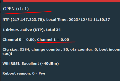

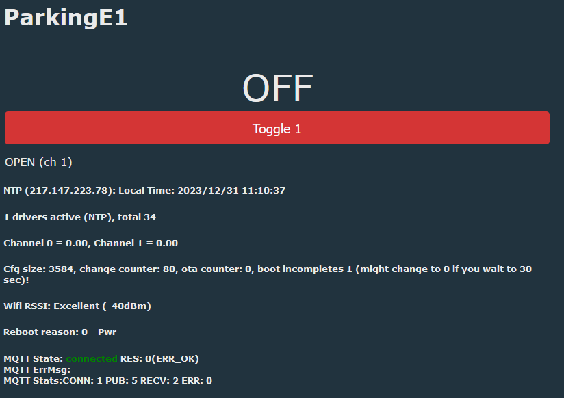

    Now no reaction at all, but I can't see displayed anywhere, nor it's not published to HA
    Screenshot of ParkingE1 interface showing status OFF.

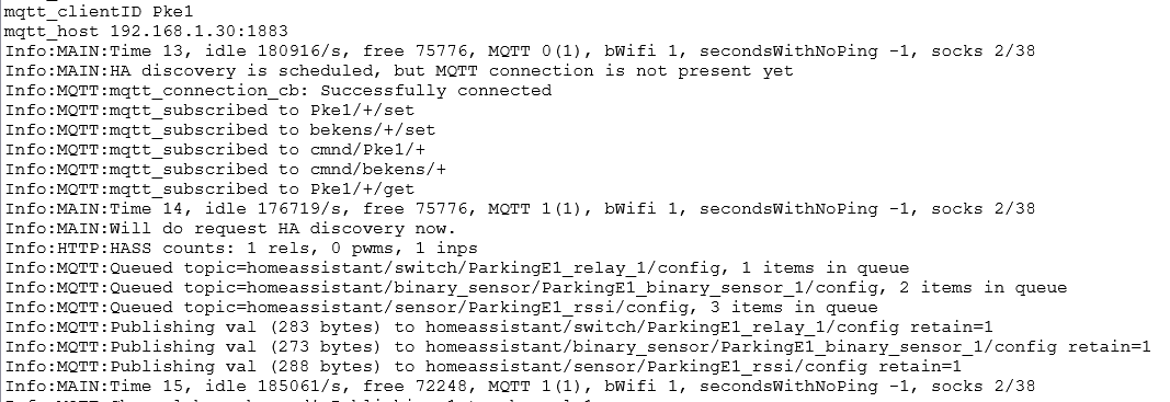

    It seems it's sending the binary sensor, but it's not:
    Screenshot of MQTT connection logs showing configuration attempts and Home Assistant discovery.

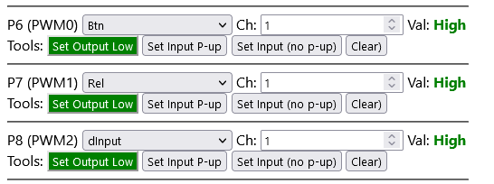

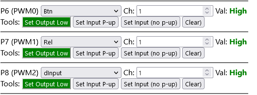

    Are you really sure that there is no change on P8?
    On this screenshot, P8 is high:
    Screenshot of a configuration panel with three ports P6, P7, P8 set to high values.
    On this screenshot, it's low:
    Screenshot of a control panel showing the Open status for channel 1.
    I will ask again - is the WWW panel showing "Open" all the time? Even if you "close the door"?
    If you are really sure that it's showing "Open" all the time, then you may consider changing dInput role to,, for example, dInput_noPullUp, etc, to check various pull up options.

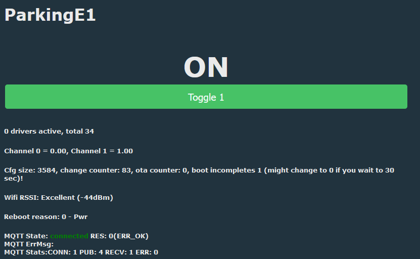

    I just reset everything and now:
    Control panel interface showing ON status.
    Only shows Toggle (relay) (pin7)
    Screenshot of the configuration panel with pin settings for P6, P7, and P8, all set to high.
    All 3 pins are high, if I change the relay value, all 3 changes to LOW, but together, it's like P8 and P7 were linked somehow.
    Added after 5 [minutes]:

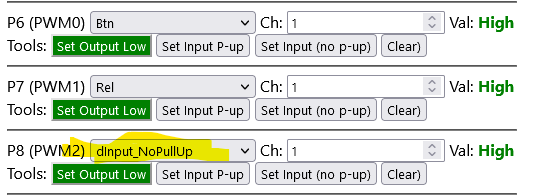

    If I change P8 this way
    Screenshot of pin configuration for P6, P7, and P8 with settings and High values.
    When I use the magnet with this config, the relay is reacting, I mean, if I move the magnet to the hall sensor and moving it away the relay reacts and opens/closes.
    But I don't want that xD, I only want to show the status of the magnet sensor.

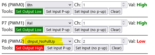

    So you configured P8 correctly now. This means P8 should be dInput with no pull up (see role name).
    The values are linked because you assigned them all to channel 1.
    If you want to separate P8 from relay, change P8 channel to let's say, channel 2, and keep relay at channel 1.
    Then they will be split. Please try.
  • #10 20884753
    calcu
    Posts: 15
    Ok, Finally!
    With this config:
    Control panel showing configuration of ports P6, P7, and P8 with high and low values.
    It's finally working!
