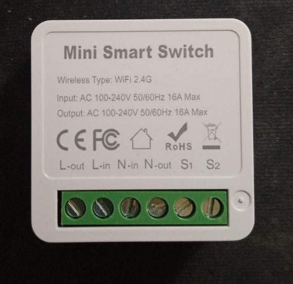

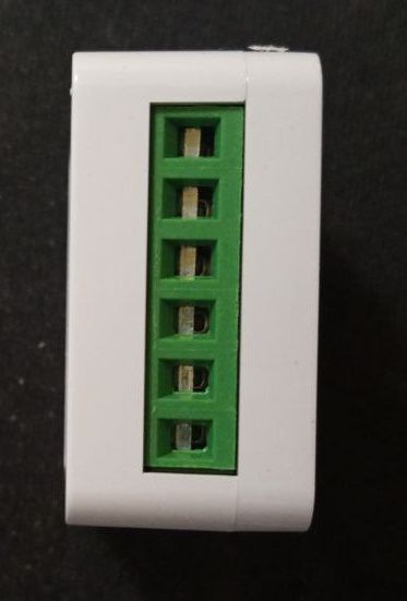

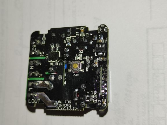

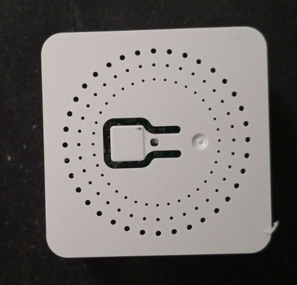

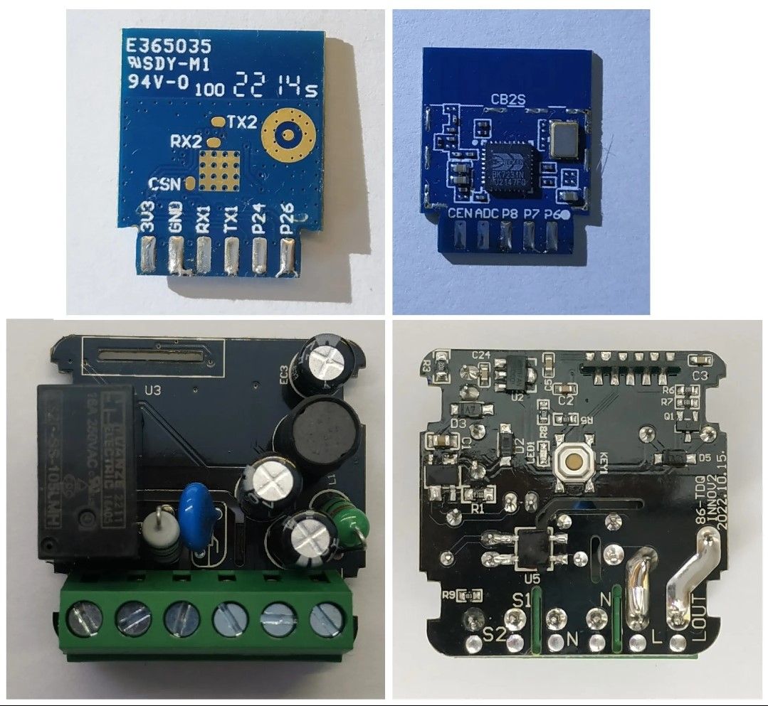

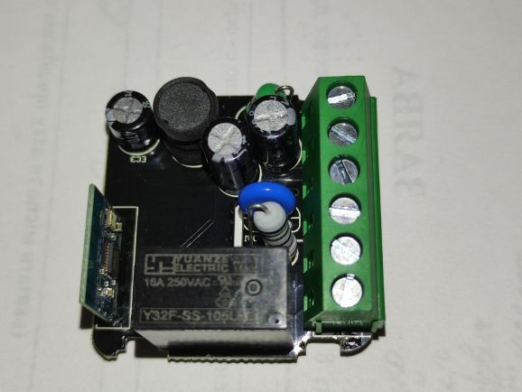

  • Teardown covers a generic AliExpress Wi‑Fi smart switch based on BK7231N and a CB2S module, sold in Tuya as "Latched hidden Switch Single pro."
  • Flashing uses tuya-cloudcutter with the `aubess-16a-mini-smart-switch` profile and `OpenBK7231N_UG_1.15.517.bin`.
  • The switch is described as simple to flash, and the post includes a configuration section for the OpenBK7231N firmware.
  • Hi! Here is a teardown of a r generic smart switch from aliexpress.
    On Tuya app is named: Latched hidden Switch Single pro
    Bought From:
    https://it.aliexpress.com/item/1005004152926240.html
    Pictures:
    [BK7231N][CB2S] Generic Wifi Smart Switch [BK7231N][CB2S] Generic Wifi Smart Switch [BK7231N][CB2S] Generic Wifi Smart Switch [BK7231N][CB2S] Generic Wifi Smart Switch [BK7231N][CB2S] Generic Wifi Smart Switch [BK7231N][CB2S] Generic Wifi Smart Switch
    Flashing:
    Is simple to flash with tuya-cloudcutter:
    sudo ./tuya-cloudcutter.sh -p aubess-16a-mini-smart-switch -fOpenBK7231N_UG_1.15.517.bin

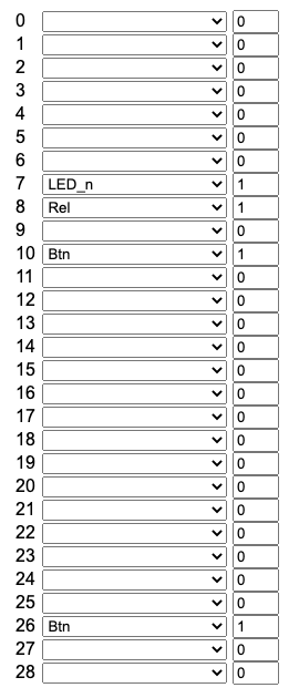

    Thank you, can you provide the pins configuration for that device?
  • #3 20465807
    giovannij600
    Posts: 16

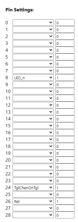

    I'm trying to find it, but using the configuration like this
    only relay work.
    S1 and S2 and push button not work
  • #4 20465815
    Posts: 14764
    Rate: 12898
    Well, you have either to look at the board and check traces with multimeter to see where things are connected, or just try pin roles one by one... you can also search for similar devices on our template list. https://openbekeniot.github.io/webapp/devicesList.html
  • #5 20466792
    giovannij600
    Posts: 16
    I find it, I put it on post
    Thanks
  • #6 20466798
    Posts: 14764
    Rate: 12898
    You can also copy JSON template from the Launch Web Application in obk firmware.
  • #7 20466832
    giovannij600
    Posts: 16
    Ok I get it, where I have to copy?
  • #8 20467175
    Posts: 14764
    Rate: 12898
    Copy from Web Application and paste here in the post, make sure to use syntax = json tag here on the forum.
  • #9 20467540
    giovannij600
    Posts: 16
    Ok I put it on first post

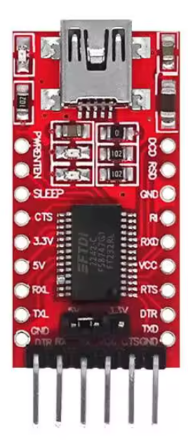

  • USB-to-pin flasher compatibility for OpenBK flashing
    #12 21726283
    mcgyver83
    >>21725548 Ok, probably I miss a lot of knowledge about OBK.
    I used a couple of device with Tasmota and they have a web gui interface.
    You suggest to add something manually to autoexec.bat, so I think OBK is a little bit less user friendly I suppose.
    I will try, first I need to understand / find guide how to flash.
    I flashed 2 sonoff using a usb to pin board, I hope is something similar :)
    I used this board to flash sonoff. Is it ok for OpenBK?
    USB to UART converter module with FTDI chip and micro USB port
  • #13 21727453
    Posts: 14764
    Rate: 12898
    This may be ok, as long as you power WiFi module from external LDO, not from 3.3V pin on this board.
  • #14 21728142
    mcgyver83
    Ops :)
    I miss that.
    I though I need to connect TX,RX,Gnd, 3,3v from my USB board to pins on the blue board shown in first post.
