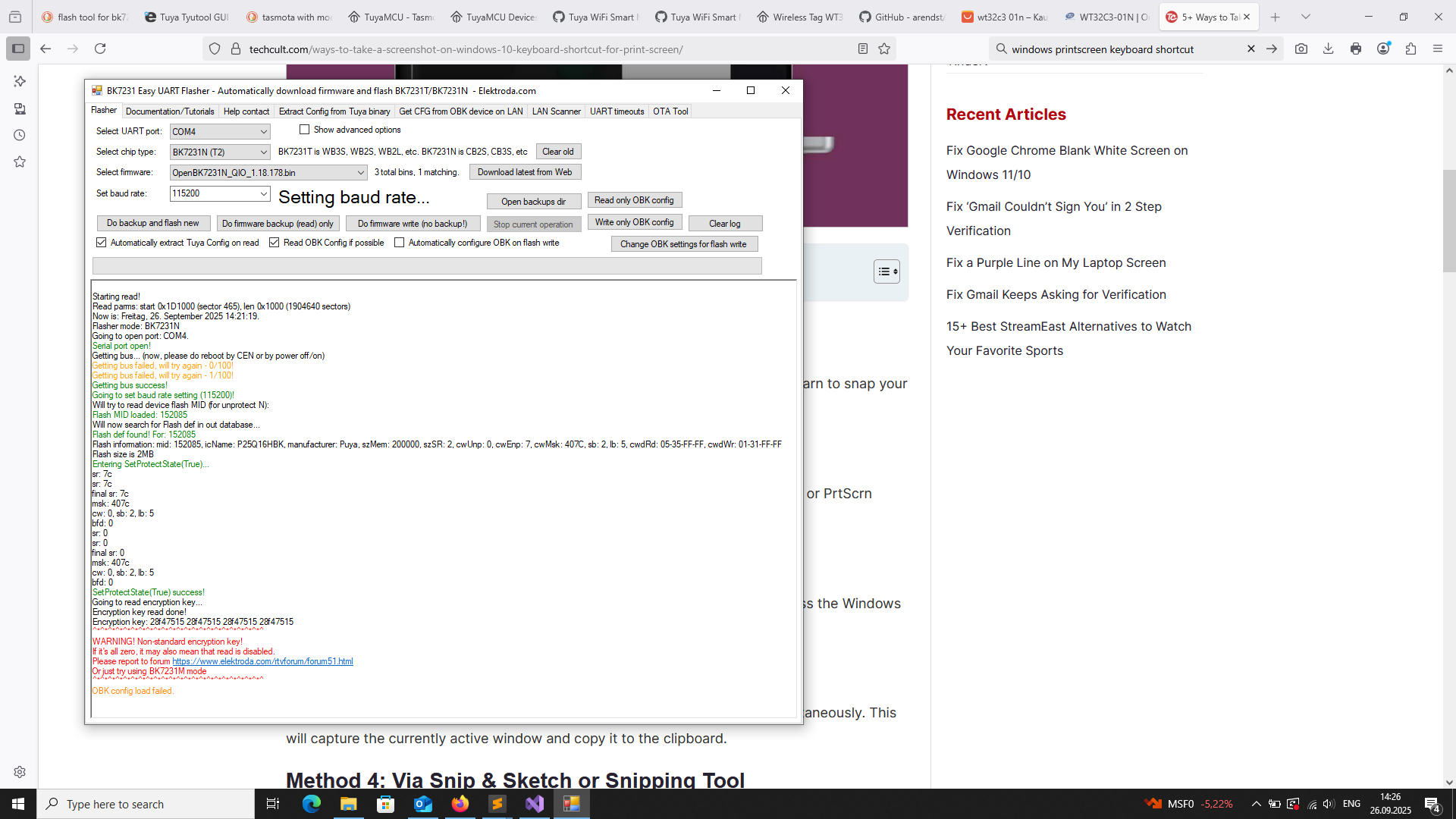

    I was not able to flash this device nor reading the firmware or config data. I always get an error about encryption keys being zero. I'll try to add the screenshot from another computer.
    AI: What is the exact brand and model of the device you're trying to flash?
    Bk7231N
    AI: Which flashing tool or software (and version) are you using for this process?
    Bk7231Flasher
    Added after 6 [minutes]:
    Screenshot of BK7231 Flasher software showing OBK configuration load failure error

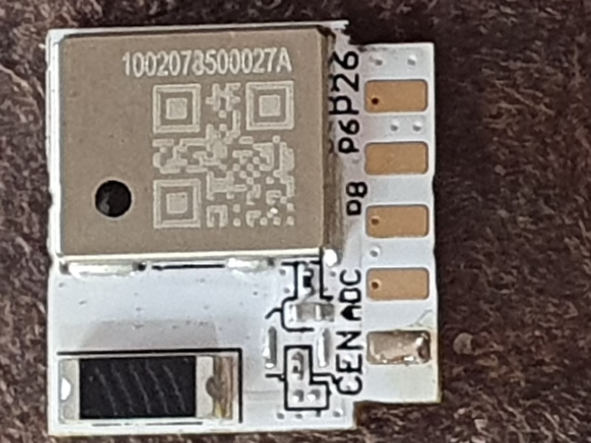

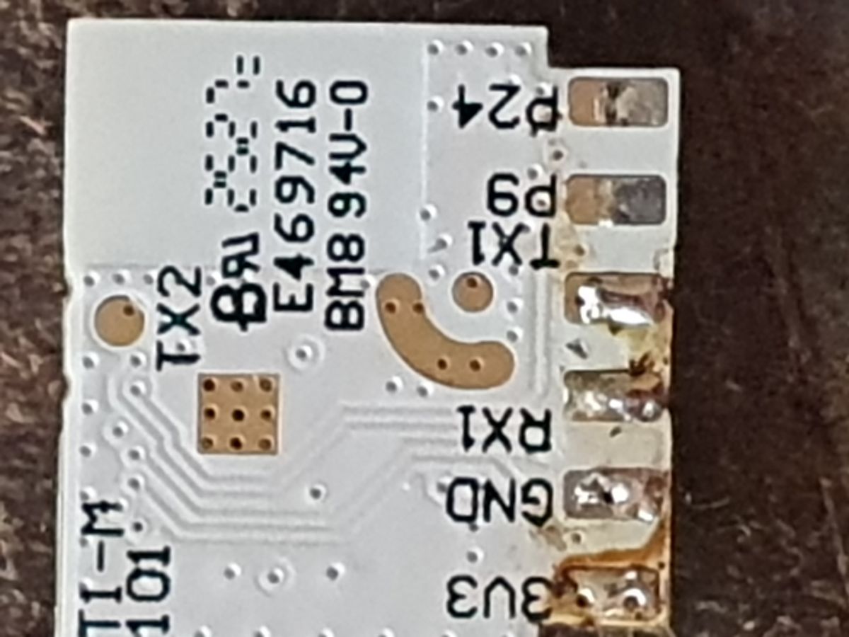

    This is a T1-M module - BK7238, not BK7231N.
    Additionally, when flashing - check "show advanced options" and "overwrite bootloader", or ota updates won't work.
