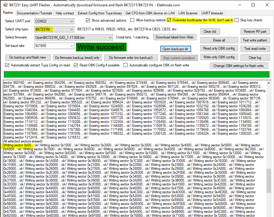

    Here I will show you how to flash BK7231M chips (or BL2028N) with our open source, Tasmota-style firmware. BK7231M/BL2028N are very similiar to BK7231N, and the only difference in the encryption key stored in efuse.
    eFUSE Definition Table for BL2028N
    Tuya BK7231N seems to be using always the following key: 510fb093 a3cbeadc 5993a17e c7adeb03.
    There are, however, also some BK7231M or BL2028N devices that are using other key, namely: 00000000 00000000 00000000 00000000. Note that not all BL2028N are using the "all zero" keys, only some of them.
    In their case, for the firmware to work, you must flash a proper version (compiled with correct key).
    You can do it easily with out flasher (version 1.3 or later):
    To know your key, just run Do firmware backup (read) only. In older versions, it will just print the key:
    User interface of BK7231 Easy UART Flasher for BK7231N firmware updating.
    In new versions, if you are using BK7231N mode and key is not as expected, it will show error:
    BK7231 Easy UART Flasher application interface for flashing BK7231N/BK7231T chips.
    So, the solution is simple - but just remember to make 2MB backup first!.
    Just set the BK7231M role:
    Screenshot of the flasher tool for BK7231 chips with a dropdown menu of chip types.
    Then get latest build from web:
    Screenshot of the automatic firmware download tool.
    And then, finally, flash it to your BK7231M/similiar in BK7231M mode.
    BK7231M firmware flashing tool interface with write success message.
    The flasher is configured in such a way that even for QIO, it will leave old M-style bootloader, and only append OBK to it.
    Now you can also do two more things:
    - do restore RF (if your MAC ends with 00 00 , and most likely it will):
    BK7231 GUI Flash Tool interface in operation
    - configure your WiFi without using AP mode, in the flasher (this is also optional):
    Screenshot of flasher software for BK7231M/BL2028N chips
    It should flash correctly, and OBK should boot:

    yes, thanks. 1.3.2 appears to have resolved the issue of Easy Flasher quitting unexpectedly when trying the 'Restore RF part' function in M-type chip mode.
    Also, the overwrite bootloader advanced option in M-type mode also works where previously it would not overwrite bootloader.
    Screenshot of the Easy UART Flasher program showing a successful write message.

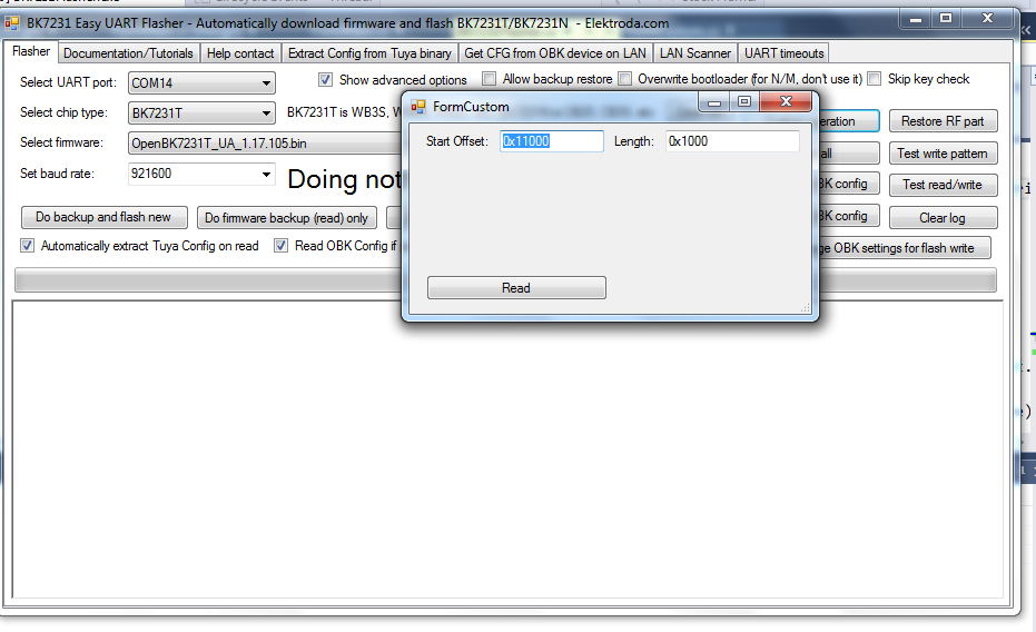

    Posts: 14795
    Rate: 12945
    Sure, would something like that work for you?
    Screenshot of BK7231 Easy UART Flasher program for downloading and flashing firmware with an open settings window.

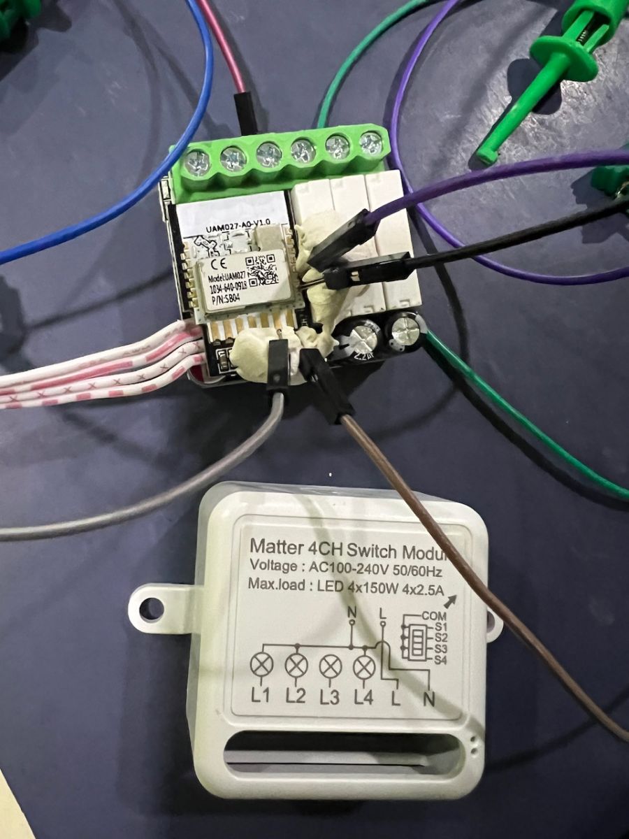

    Hi, I’ve flashed another one of the matter relay module with cbu following your instructions (no rf restore yet)
    But when I plugged it to the main, there’s no access point.
    What am i missing here?
    Here are the firmware dumps btw, doesn't look like it could retrieve obk config for both
    readResult..._3gang.bin (2 MB)You must be logged in to download this attachment.
    readResult..._4gang.bin (2 MB)You must be logged in to download this attachment.
  • RT-Thread bootloader boots OpenBeken but no AP
    #10 21126765
    Posts: 5236
    Help: 449
    Rate: 918
    these Beken-based Matter devices are different.

    @divadiow just to clarify after some flashing acrobatics, you could get it to boot up and connected to wifi? Just that it can’t show the AP?
    Should be the same one you’ve purchased before from aliexpress
    Just found this amazing item on AliExpress. Check it out! MYR22.69 56% Off | 1/4 Gang Matter WIFI Smart Switch Module Automation Relay Smart Breaker Voice Control Apple Home Siri Alexa Google smarttings
    https://a.aliexpress.com/_oEKFOgI
    3 gang - cb3s with pin headers
    4 gang - cbu with pin headers
    2 gang - still shipping but looking at the review it’s cb3s
    Matter 4CH switch module connected with wires.
  • #12 21126863
    Posts: 5236
    Help: 449
    Rate: 918
    oh interesting. I didn't know some come with a CBU. Yes, mine is CB3S.

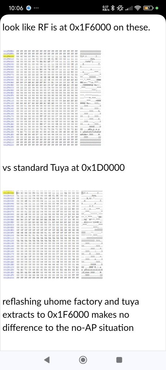

    Have you tried restoring or transplanting RF partition from, for example, the working OBK BK7231M device?
    Yes. I have tried restoring RF from normal Tuya device and the one from factory from this device. Both to usual RF address and I think to the different address the factory fw has RF. I'm away from home at the moment but will do it all again to confirm.
    it seems we've got first user that flashed BK7231M with our guide and reported it to our forum!
    This is cool
    What id really like to do is sit and try to make a map of the partition layout for these uHome firmwares. There's probably somewhere online that has it actually, surely.
    So if the RF partition is at a different address, what does that mean for OBK? Does OBK need to know what that address is?
    Added after 4 [minutes]:
    Ah. I've already posted about it Comparison of RF partition layout between Tuya and uHome devices.
    Added after 25 [minutes]:
    Oh. And the uHome device coeff is different but I haven't got OBK to boot flashing to 0x11000 with a build using uHome coeff
    "-the coeff key is 4862379A 8612784B 85C5E258 75754528 but reads as 00000000 00000000 00000000 00000000 (presumably because efuse read-out is disallowed- something of note for others reporting 0s in Easy Flasher)"

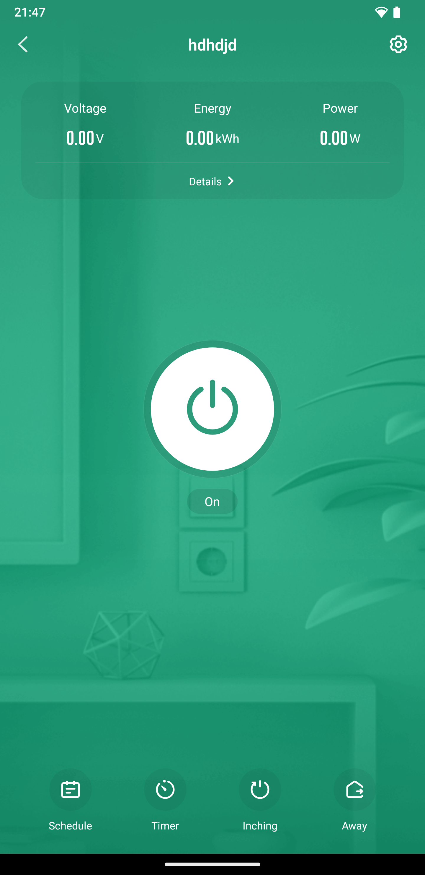

    I have flashed your dump of that LSPA9 clone/BSD33 to a 4mb SparkleIoT XH-CB2S/BK7231M module from a Matter device - the same as can be seen here https://www.elektroda.com/rtvforum/topic4086986.html
    The key in the efuse on my module really is 000000, rather than because read-out is disallowed, and so your dump boots and I get the same boot log

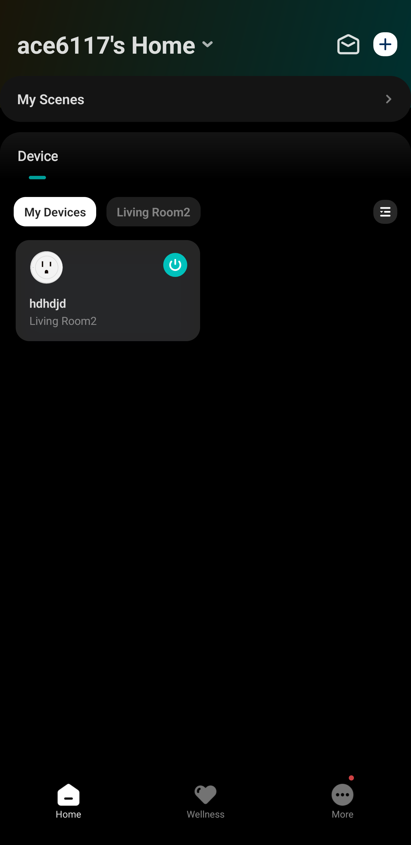

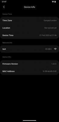

    I notice in the boot there's mention of a company called VeSync who have a Play Store app https://play.google.com/store/apps/details?id=com.etekcity.vesyncplatform
    Screenshot of the VeSync app on Google Play.
    I've never heard of this company or seen their name in a boot log before. Going further, the VeSync finds the device and pairs it successfully.
    Energy management app interface displaying voltage, energy, and power information. Device information screen on a mobile phone. Mobile app interface for managing smart home devices, displaying a screen with a list of devices.
    VeSync_BSD33_BSDOG02_Plug_1.0.0.1.bin

How can custom read/write by offset help with dumping partitions or flashing back factory RF data on non-Tuya Beken devices?
It lets you work around unknown or nonstandard partition maps. The thread proposes custom commands to write N bytes at offset X, skip custom parts of a file, and define separate source and destination ranges. That is useful for experiments such as dumping a factory RF block or flashing it back to a specific address when standard full-image flashing is too coarse. [#21110874]
