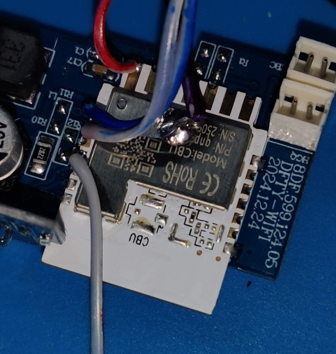

    C8478C428848C8478C428848C8478C428848C8478C428848 Hi,
    I have ordered from AliExpress 2 breakers:
    aliexpress.com/item/1005008706471373.html
    Inside - module CBU, that in past I updated it with BK7231N mode.
    Now, I cannot update it; the program said:
    Going to read encryption key...
    Encryption key read done!
    Encryption key: 00ef7800 00ef7800 00ef7800 00ef7800
    WARNING! Non-standard encryption key!
    If it's all zero, it may also mean that read is disabled.
    Please report to forum https://www.elektroda.com/rtvforum/forum51.html
    Or just try using BK7231M mode
    The 2 modules have different key values.
    I can write it with "Skip check key" on; the CRC check is passES, but the module does not come up after that.
    Same happens when I write it using BK7231M mode.
    The module boots when I use BK7238.
    It can operate, but the MAC address stays the same for both devices - C8478C428848, and it is not possible to change it from WEB - the device gets stuck, and after reboot it has the same MAC.
    Attached original CBU's image
    Is it possible to add support for this? Or at least a way to change MAC address?

    dgel27
    Posts: 19
    Yes, it's CBU. At least PCB and shield markings. Maybe they changed the chip, if it's pin-to-pin compatible...
    It was also strange for me,
    Close-up of WiFi module with soldered wires and visible PCB markings
    I have used CBU before...
    Thanks!
