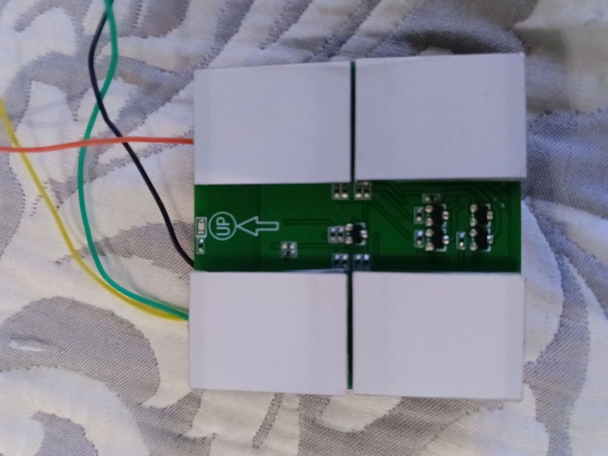

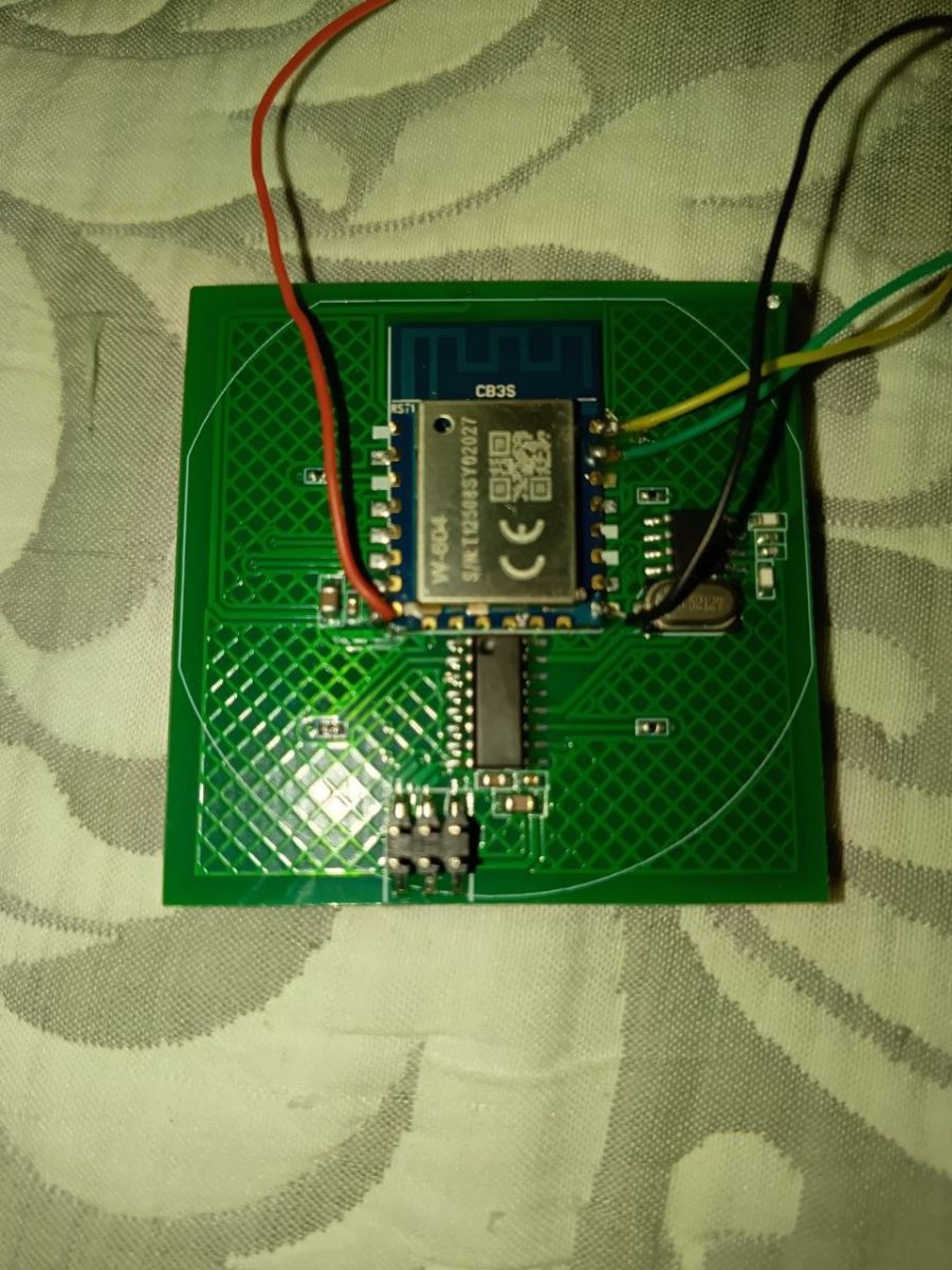

    Hello. Yesterday I received a 4-key switch from AliExpress with firmware 1.1.9.
    I'm trying to flash it, but so far I'm having trouble.
    Four white touch buttons on a green PCB with multicolored wires attached
    CB3S wireless module with wires on a green PCB placed on patterned fabric

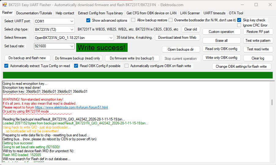

    When trying to flash the firmware, an error occurs:
    Starting flash new (no backup)!
    Now is: 28 января 2026 г. 16:33:52.
    Flasher mode: BK7231N
    Going to open port: COM11.
    Serial port open!
    Getting bus success!
    Going to set baud rate setting (921600)!
    Flash MID loaded: 152085
    Flash def found! For: 152085
    Flash information: mid: 152085, icName: P25Q16HBK, manufacturer: Puya, szMem: 200000, szSR: 2, cwUnp: 0, cwEnp: 7, cwMsk: 407C, sb: 2, lb: 5, cwdRd: 05-35-FF-FF, cwdWr: 01-31-FF-FF
    Flash size is 2MB
    sr: 0
    sr: 0
    final sr: 0
    msk: 407c
    cw: 0, sb: 2, lb: 5
    bfd: 0
    Going to read encryption key...
    Encryption key read done!
    Encryption key: 39dd6c01 39dd6c01 39dd6c01 39dd6c01
    WARNING! Non-standard encryption key!
    If it's all zero, it may also mean that read is disabled.
    Please report to forum https://www.elektroda.com/rtvforum/forum51.html
    Or just try using BK7231M mode
    If I check the Skip key check box in the program, the firmware flashes without a problem, but after rebooting the module, the WiFi network doesn't appear and the device doesn't work.
    BK7231 Easy UART Flasher program screen with Write success! message
    If I flash a backup made before the factory firmware, the device works fine. I've attached the backup I made.

    Considering all 4 keys are repeating, this is a BK7238 chip, not BK7231N.
    Mislabeled T1-3S?
    Config extraction:
    - Button (channel 1) on P26
    - Relay (channel 3) on P24
    - Relay (channel 4) on P9
    - Backlit IO pin on P11
    - WiFi LED on P20
    - Button (channel 4) on P8
    - Button (channel 3) on P10
    - Relay (channel 2) on P6
    - Button (channel 2) on P22
    - Relay (channel 1) on P23
    Device seems to be using T1-3S module, which is using BK7238.
    And the Tuya section starts at 2052096 (0x1F5000), which is a default T1/XR806 and some T34/BK7231N offset.
