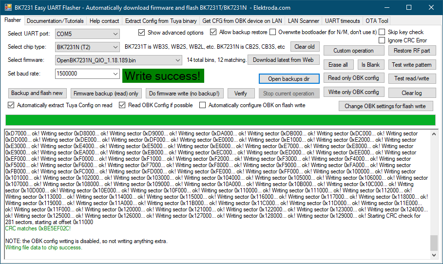

    Hi
    This is how the Flasher software was setup:
    Screenshot of BK7231 Easy UART Flasher showing “Write success!” message
    Here are the logs of the firmware flashing:
    Starting flash new (no backup)!
    Now is: Montag, 13. Oktober 2025 08:17:30.
    Flasher mode: BK7231N
    Going to open port: COM5.
    Serial port open!
    Getting bus success!
    Going to set baud rate setting (1500000)!
    Flash MID loaded: 1560EB
    Flash def found! For: 1560EB
    Flash information: mid: 1560EB, icName: TH25Q16HB, manufacturer: TH, szMem: 200000, szSR: 2, cwUnp: 0, cwEnp: 7, cwMsk: 407C, sb: 2, lb: 5, cwdRd: 05-35-FF-FF, cwdWr: 01-FF-FF-FF
    Flash size is 2MB
    sr: 0
    sr: 0
    final sr: 0
    msk: 407c
    cw: 0, sb: 2, lb: 5
    bfd: 0
    Going to read encryption key...
    Encryption key read done!
    Encryption key: 510fb093 a3cbeadc 5993a17e c7adeb03
    Reading file firmwares/OpenBK7231N_QIO_1.18.189.bin...
    Loaded 1220464 bytes from firmwares/OpenBK7231N_QIO_1.18.189.bin...
    Using hack to write QIO - just skip bootloader...
    ... so bootloader will not be overwritten!
    Preparing to write data file to chip - resetting bus and baud...
    Flash size is 2MB
    sr: 0
    sr: 0
    final sr: 0
    msk: 407c
    cw: 0, sb: 2, lb: 5
    bfd: 0
    Going to do erase, start 69632, sec count 281!
    Erasing sector 69632... ok! Erasing sector 73728... ok! Erasing sector 1216512... ok!....<removed>
    All selected sectors erased!
    Writing sector 0x11000... ok! Writing sector 0x12000... ok! Writing sector 0x13000...<removed>
    Starting CRC check for 281 sectors, starting at offset 0x11000
    CRC matches 0xBE5EF02C!
    NOTE: the OBK config writing is disabled, so not writing anything extra.
    Writing file data to chip successs.
  • Requesting TX2 log from the module back port

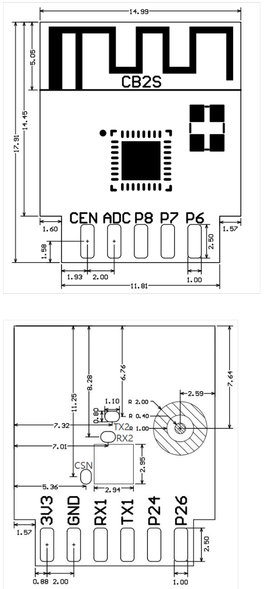

    Are you able to get a log from Tx2 pin?
    There is 101 ways you can make this operation wrong and there is no way for us to figure out how to help without more information, pictures of the setup, something....
    Try to get the log from log port on the back of the module, see TX2 on the picture, be extremely careful and power the device on the bench not from mains power supply for testing!!!

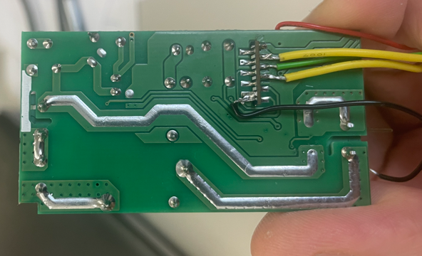

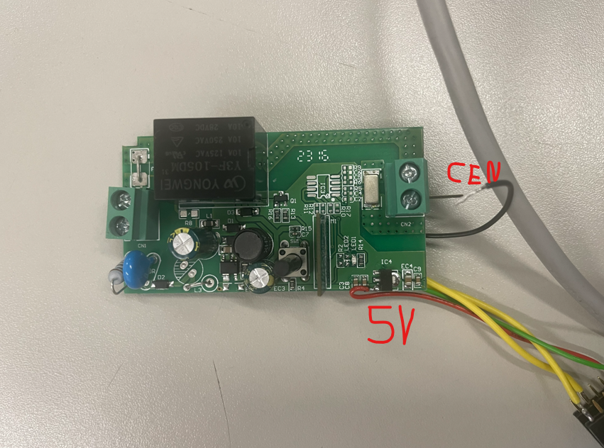

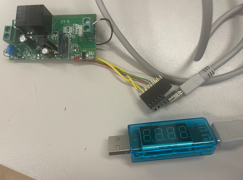

    >>21719334 Thanks for the help! Here are some images of the setup I used:
    PCB with relay and wires connected to a USB meter with LED display
    PCB with connected wires labeled CEN and 5V
    Green PCB with several colored wires soldered at one edge
    The adapter I used is this one: https://www.compel.ru/item-pdf/cb37a42a4d51a0ea78da7d18c05d219f/pn/chip45~littleusb.pdf
    It uses CP2102, 3.3V RX/TX, and the 5V is coming from VBUS (direct 5V from PC) on the adapter to the 5V on the unit, given 3.3V to the BK chip.
    I tried also one other USB/serial converter with FTDI232 chip (being careful with 3.3V/5V).
    I have checked CEN, it is not shorted to earth, I tried to read from TX2 when I reset with CEN, but I only get garbage, I tried at 115200 baud (tried other speeds as well).
    I can read from the device, and what I read looks plausible, so it seems I can read/write, but it will not start. The blue device in the image is to measure USB power draw, never above 200mA, usually 100mA or less.

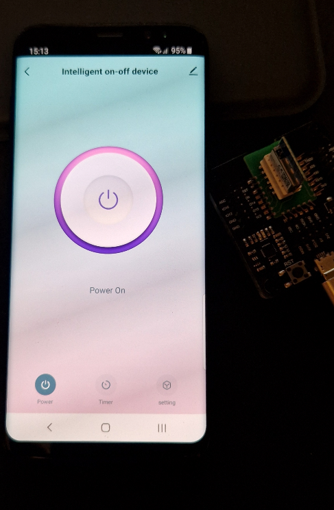

    Your backup is working fine for me om my test module
    Phone screen with control app and adjacent electronic module
    There is something you are missing and I can't figure out what it is.
