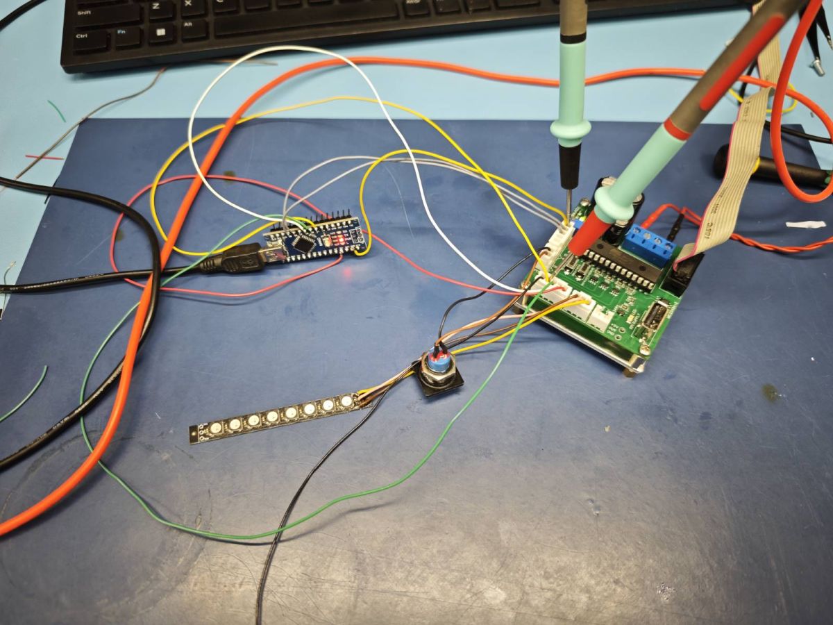

    Trial layout made, effect as expected. Works as it should. Composition: 4 AND gates ( it is possible to do less but there was nothing to do with them,in the IC there are four), one D flip-flop 4013, one OR gate ( or NOR, will come out in the wash) and NE555. The D flipper in the 4013 does not require an additional NOT gate from the NE 555 output to cancel it.
    While the cmos work fine at 3.3V the NE 555 only started at 4.5V. I have purchased TLC555CDR cmos which work from 2V. Tomorrow I'm going to test the TLC 555 at 3.3V (if it passes). The plan is to use three ICs in the SMD version and a single OR gate in a SOT 23 package. What remains to be done is to control the P-mosfet, check the circuit with the RPi and put the whole thing on the PCB.
    Test circuit with digital multimeter and prototyping board with measurement probes connected.

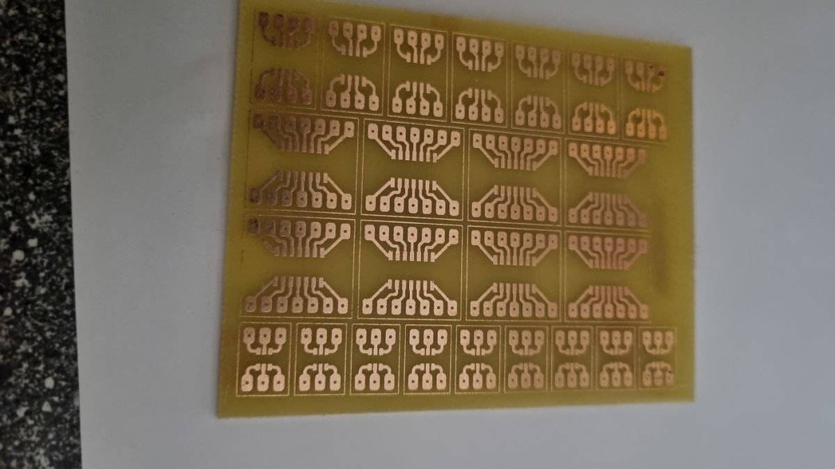

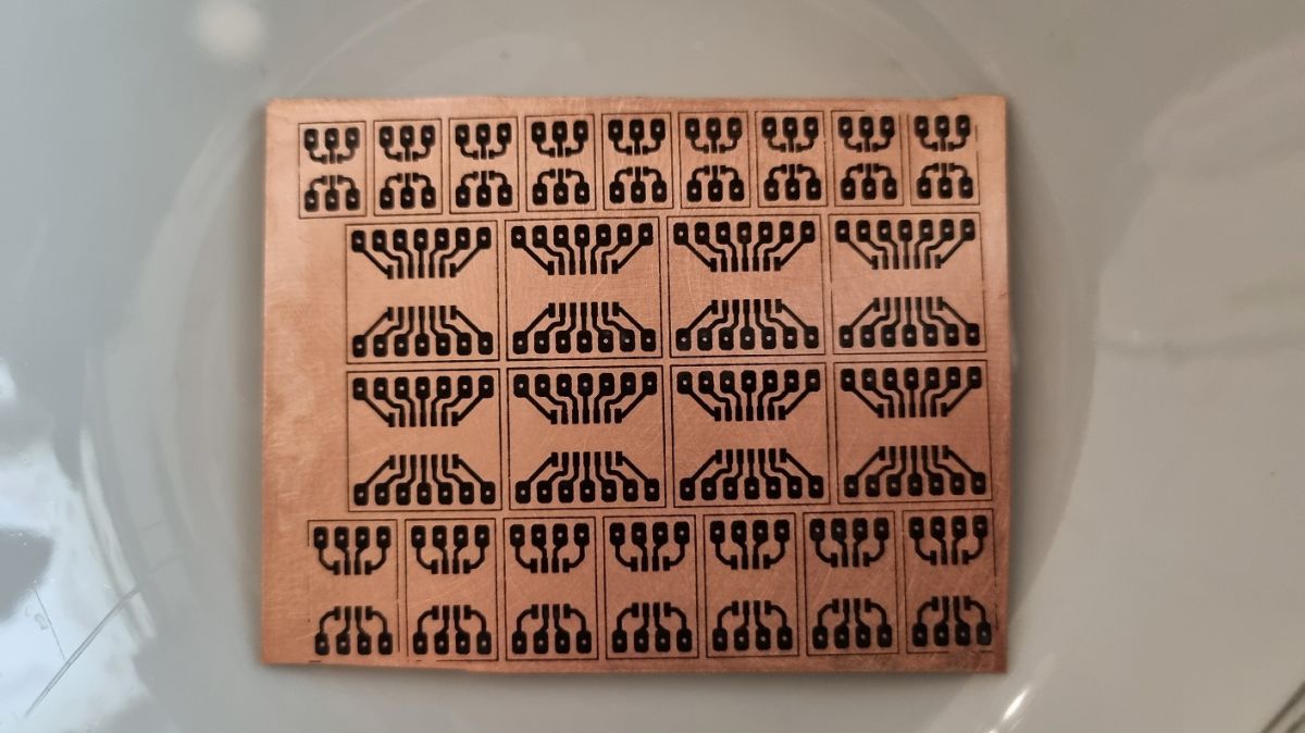

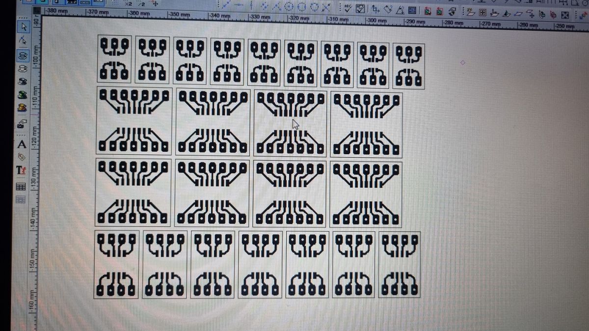

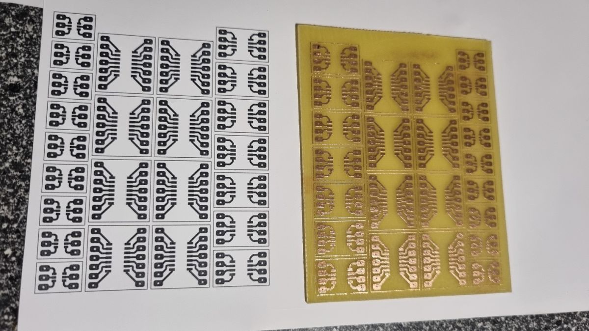

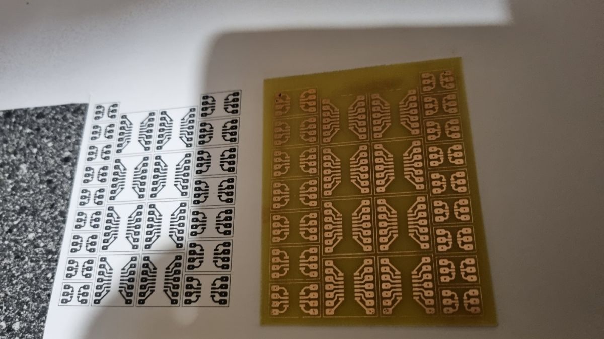

    My trial project requires some SMD components so I designed myself SMD/THT adapters. In CAD, of course...
    I etched the two boards. Method as always, chalk paper, laser and etching. I mastered this method a long time ago and it comes out 100%.
    Radek let me know that the power supply boards will be in tomorrow but the assembly won't be until Wednesday unless there are more important things to do.

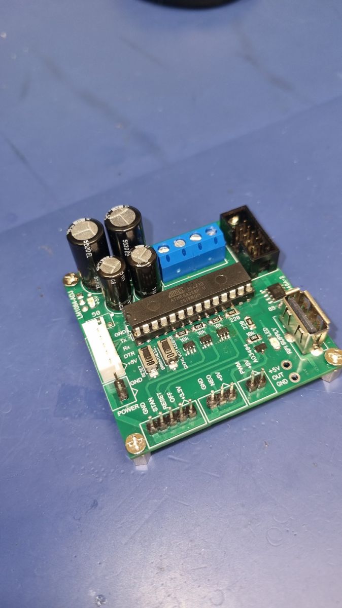

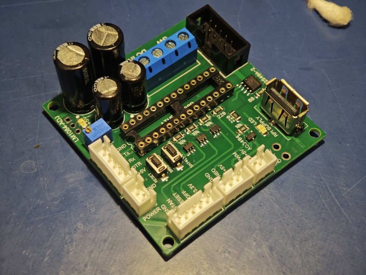

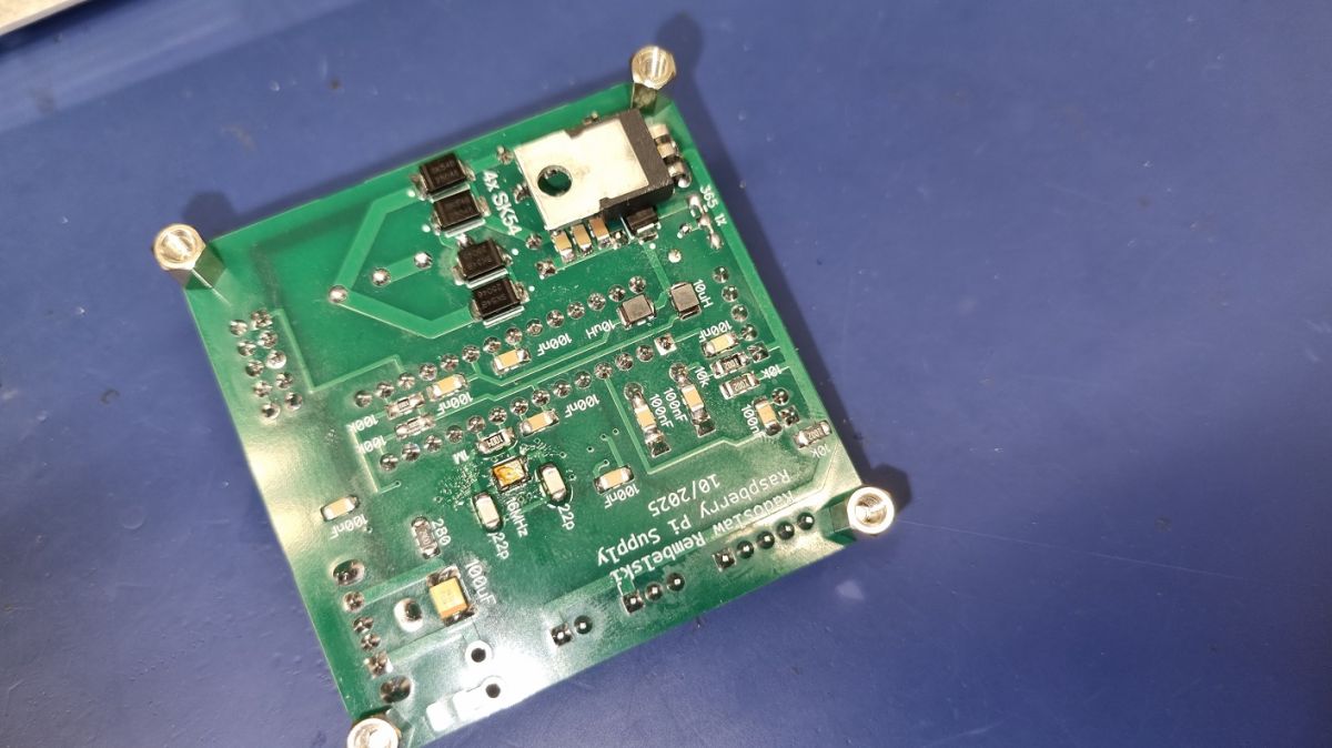

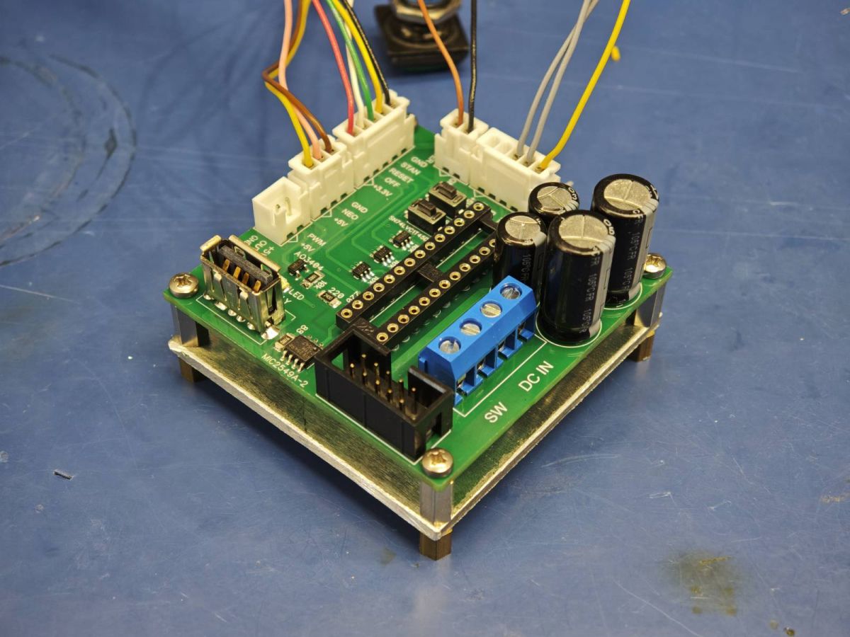

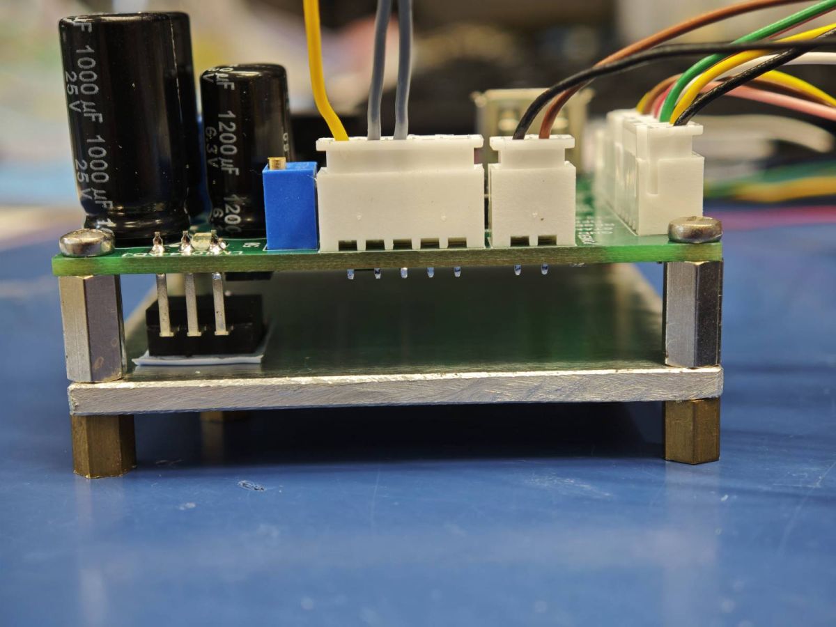

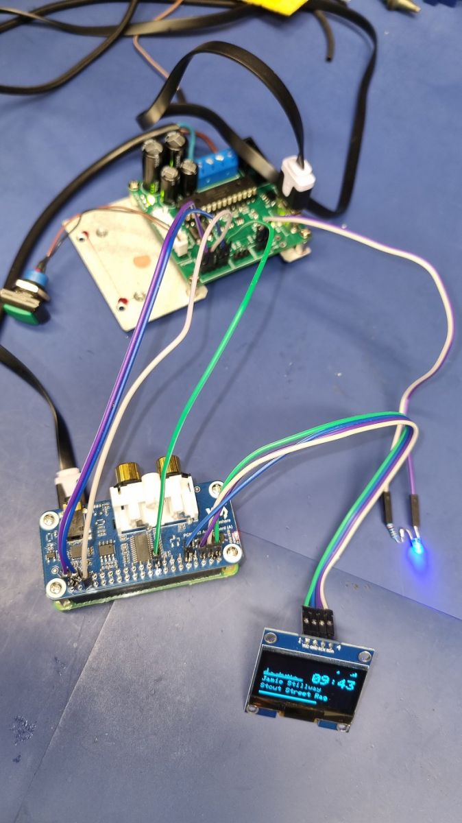

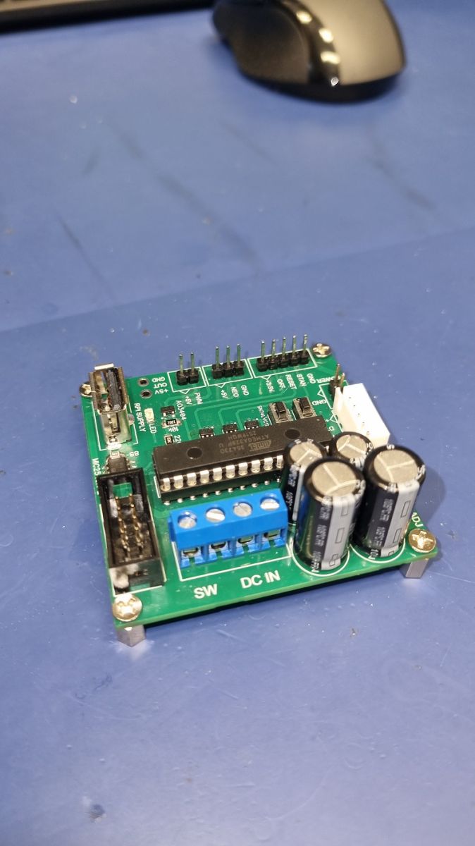

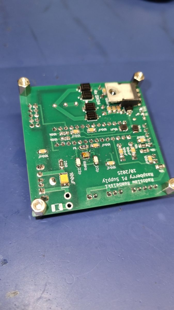

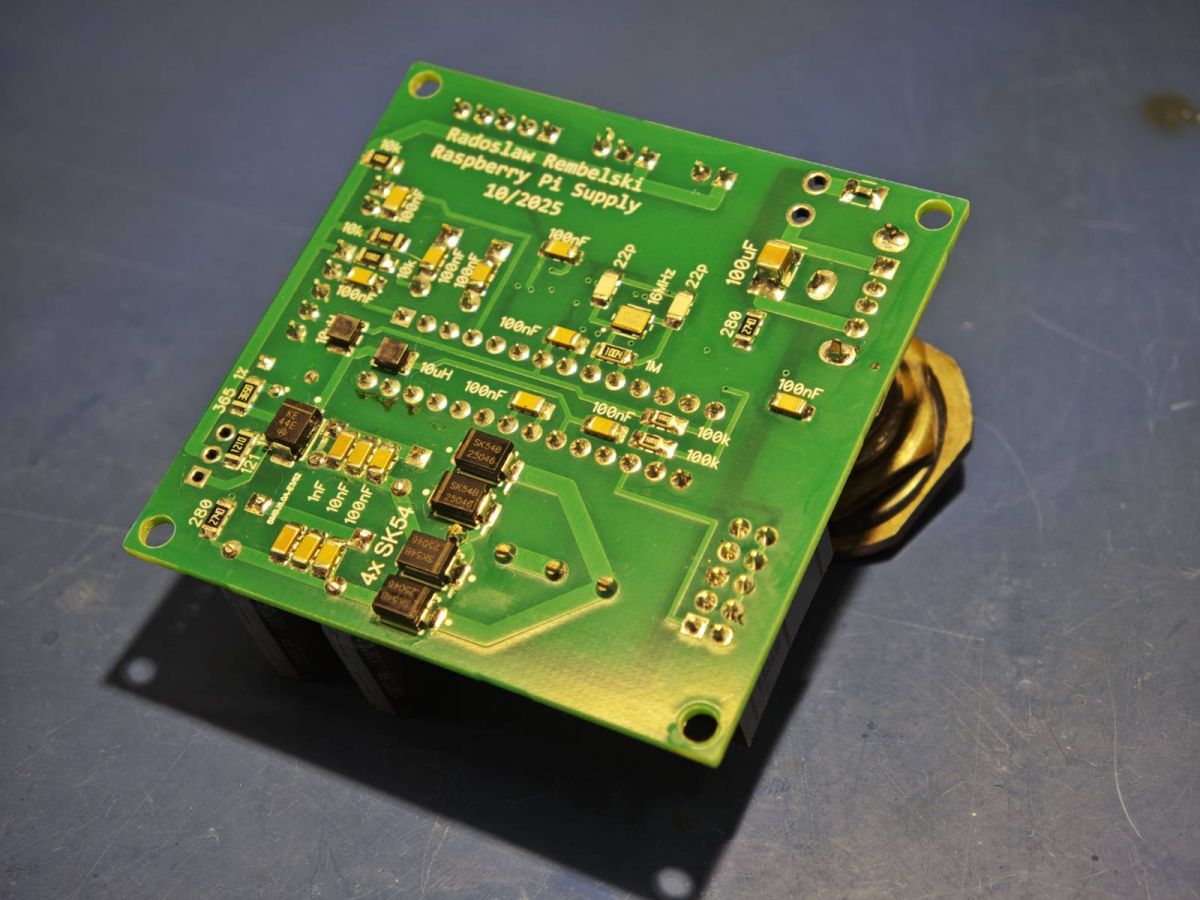

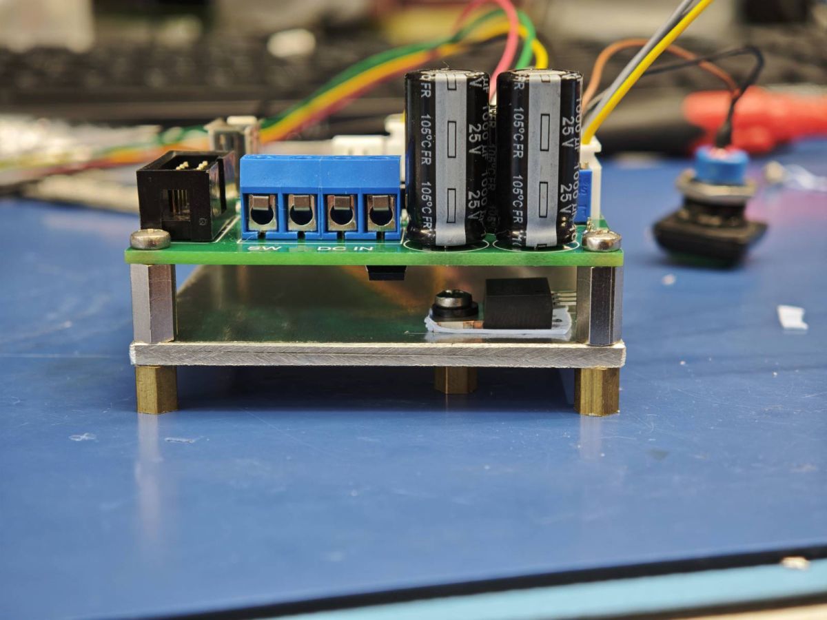

    There hasn't been an update for a long time but one that there was no time to play around with the hobby and two that Radek had to fine-tune the programme.
    In general, everything worked as it should. The power supply performs all the functions it was supposed to. A few timing parameters needed correction including the shutdown delay time and the Volumio closing pulse time.
    Radek did a good job. Here official thanks to him for doing the design and the software :thank you ! :)
    The pictures show the soldered board and the first, trial connection of the little Pi Zero 2. There is, of course, RGB and PWM diode control. The RGB can be dimmed and brightened to several degrees using a button on the board, and the light colour can be achieved in principle by changing the parameters in the software.
    If I can find some time, I may connect the large Pi4B to the power supply later today, but I don't expect any problems. The 5V stabiliser will be under the board, but screwed to a metal case.
    There are traces of flux on the board, the quartz resisted soldering so it looks battered. I don't want to replace it with a nice one. It works.

    Radek version:
    Assembled PCB with various electronic components on a blue work surface
    Soldered electronic PCB with components and connectors on blue surface
    Close-up of a prototype PCB with capacitors, connectors, and wiring
    Front view of soldered PCB with capacitors and multiple wire connectors
    Soldered green PCB with connected wires and mounted capacitors.
    Soldered prototype board with connected wires and measurement probes
