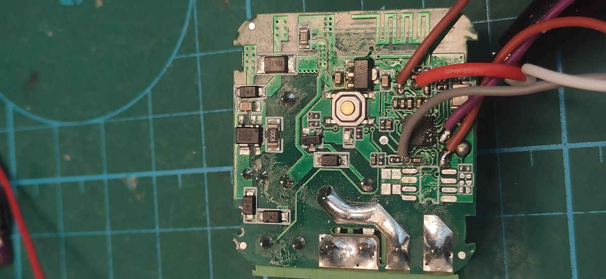

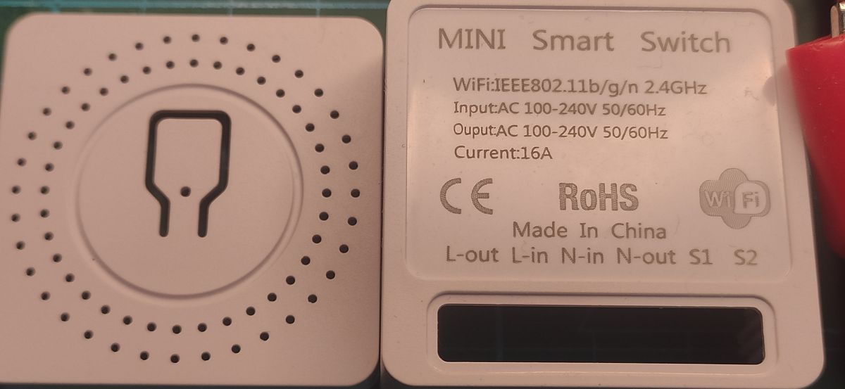

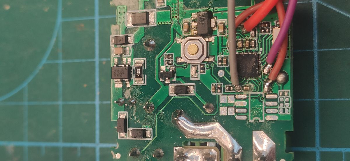

    Hi guys. I have flashed successfully newest fw via BK7231Easy. It has bk7231N and bp2525 AC/DC stepdown converter. FW runs OK. I can reach Wi-Fi and configure. But not able to find proper config. Only thing which works is turning diode on P26 as rel. I am not able to find the way how to switch electromagnetic relay on board (in other words not able find out proper config for this board). I didn't find any board with my layout. I think I do something wrong, but not sure what. I am new in this stuff so there is high probability that I am missing something :) Any guesses? thanks

    Two possibilities: The WebApp has an "GPIO Doctor" allowing you to set pins high/low, so you can test, which pin will "click" the relay - But for me it quite often crashes.
    My suggestion:
    Go to config page and define some e.g. 5 pins "AlwaysHigh". If after "Save" it "clicks" - the relay switched by one of these pins, try setting pin by pin to "AlwaysLow" to find which one actually switched the relay.
    If it doesn't "click", try next 5 and so on.
    If you don't find it this way, it might be the seldom case of an "Relay_n" (switched on with "Low").
    If you din't find it up to now, all pins are now "AlwaysHigh", so you start the search the other way - setting 5 to "AlwaysLow", if this switches, find the correct one by setting to "AlwaysHigh" one by one.
    Good luck
    Added after 42 [minutes]:
    Or, even simpler, get config from your backup:
    Using Easy UART Flasher will give:
    - Pair/Toggle All Button on P23
    - WiFi LED on P26
    - TglChannelToggle (channel 1) on P6
    - Relay (channel 1) on P7
    Device seems to be using CB2S module, which is using BK7231N.

    will also show pin for relay 1 is 7: "rl1_pin:7,"

    >>21709698 I tried all of this before my post. BUT recently found that, relay will work only if powered by AC. I did my attempts from plugged external laboratory power supply. Now it works as expected. But nevertheless thanks for your help.
  • #4 21709778
    jozefbadatel
    Device must be powered from ac through bp2525 to get relay working.
