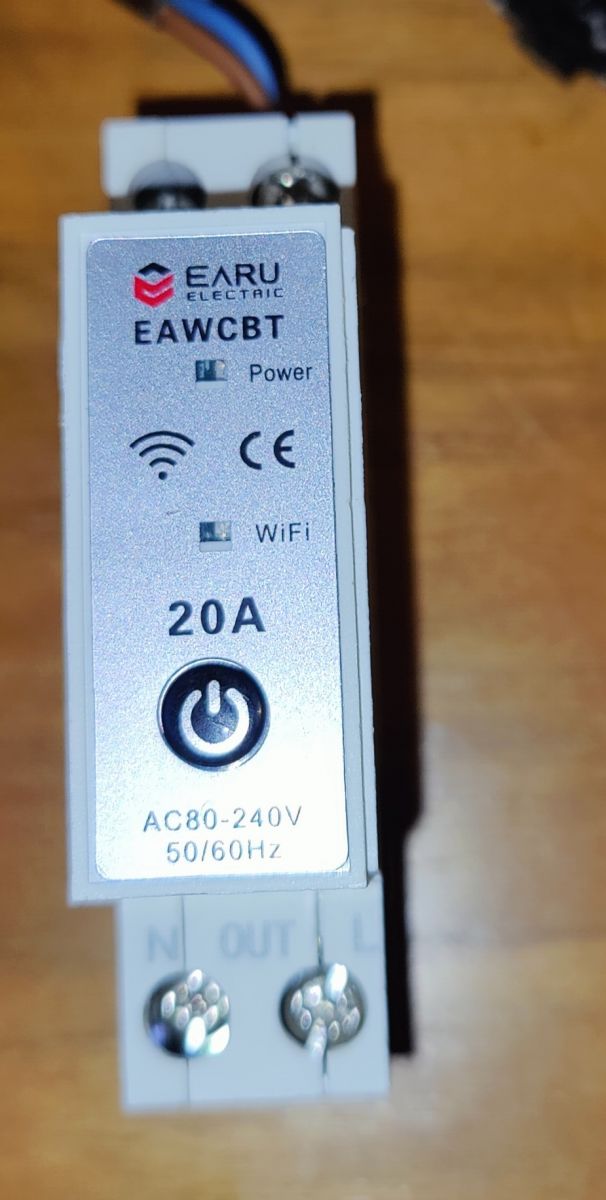

    EARU Wifi Relay model EAWCBT support.
    Hi guys,
    I recently bought on Aliexpress some cheap WiFi Relay, and wanted to use OpenBK on it.
    This model is not yet in device database, but I managed to make it working with openBK.
    This is the device : EARU EAWCBT Wi-Fi relay with connectors and labels.

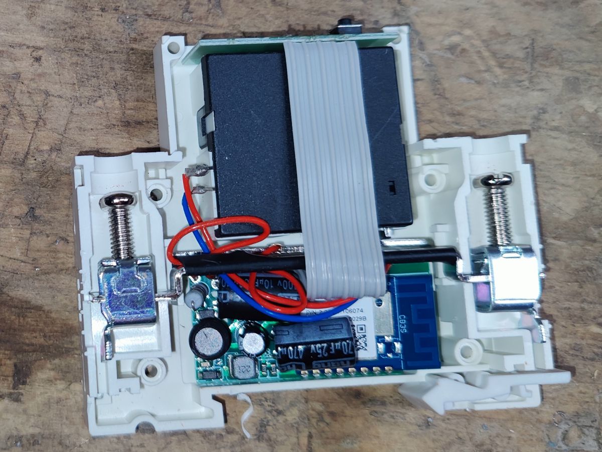

    I quickly opened it up, by drilling on existing rivets. They can be replaced with some screws later.
    Inside, it is a CBS3 chip (BK7231N) with a relay activated by a bridge.
    Interior of an opened EARU Wi-Fi relay model EAWCBT with visible electronic components.

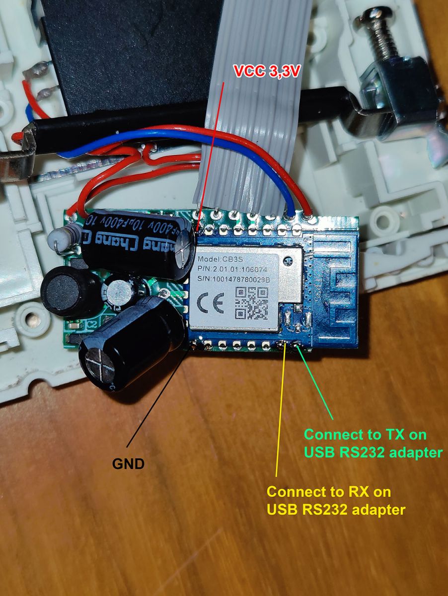

    I use this datasheet to find correct pinout : CB3S datasheet and BK7231 GUI Flash tool to flash it.
    Here is the correct pins to use when updating device:
    Interior of a device with CB3S chip and cable connection labels.
    It worked flawlessly :)

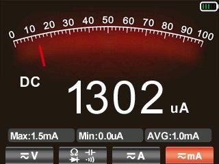

    First of all, I tried measuring consumption, and then I read your comment about PowerSave, it changed everything!
    ANENG AOS02 electrical meter and TONGOU relay on a wooden table.
    ConsumptionRelay activation
    Normal7mA28mA
    PowerSave 1
    1.3mA8.7mA
    Meter reading at 1302 microamps.
    1.3mA, this is excellent! Day consumption is (0.0013x230)*24 = 7.2 Watt!
    I was amazed it can change consumption like this!

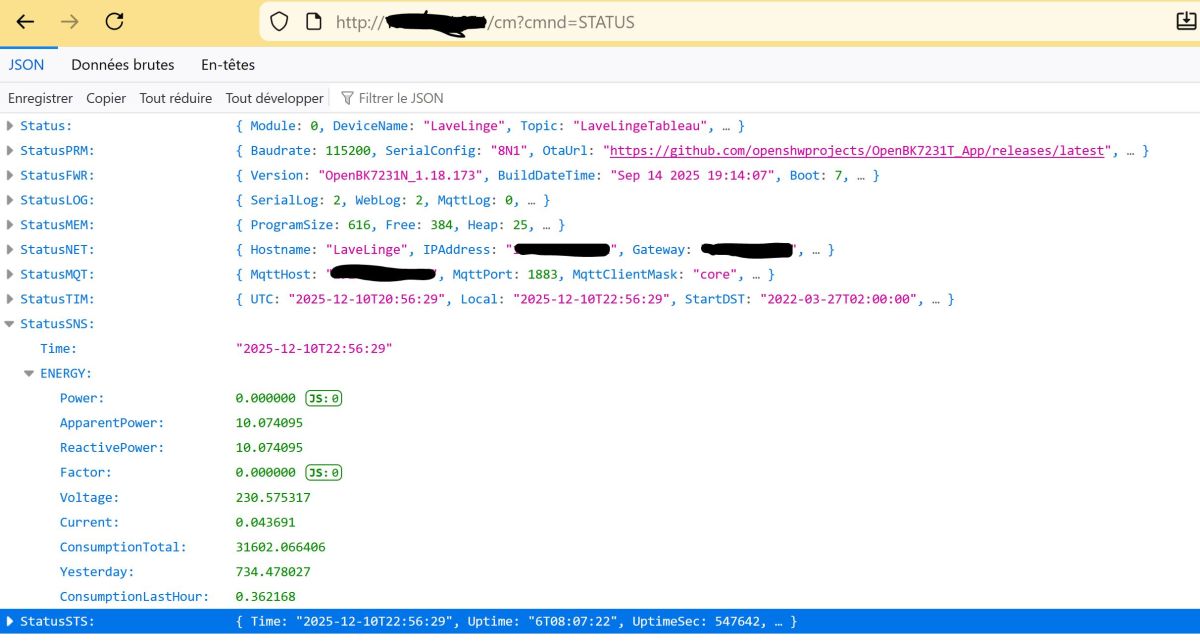

    #7 21777373
    earurelay
    Posts: 11
    >>21777226
    Hi,
    Power measurement is not available on this particular relay model.
    For other model, such as Earu EAKCB-T-M, reading is available with HTTP GET.
    I use it with RedNode to read wattage value.
    This is an example of device answer with command: cm?cmnd=STATUS
    Screenshot of a JSON panel showing status data from an IoT device using OpenBK7231N
    You can see voltage, frequency, power, ...
    But only for relay with metering function available.
    Hope this helps
