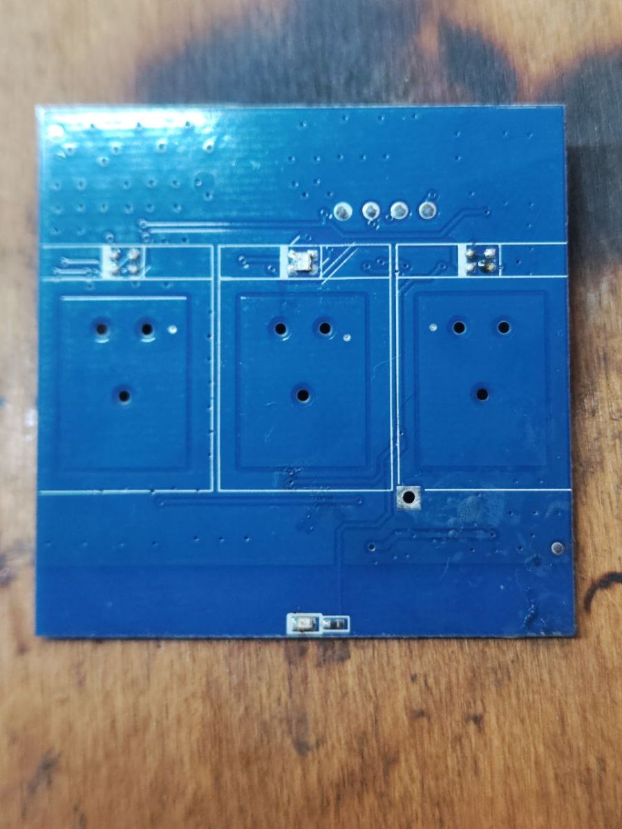

    Hello everyone! Had some issues with 1-gang light switch, bought here, (not AD's), which based on T34 chip.
    When I used BK7231 GUI Flash Tool for backup original FW - got an error that flasher cannot get configuration from FW, then i checked lastRawDecryptedStrings.bin via Notepad , got this list
    Spoiler:

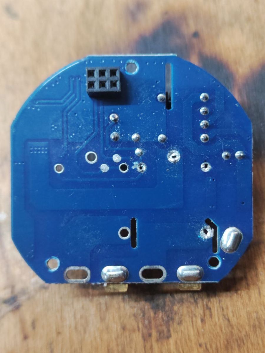

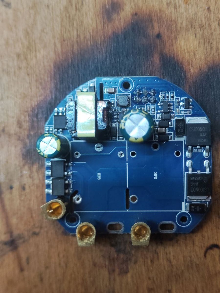

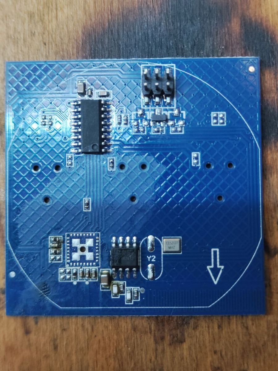

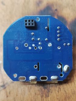

    Right after flashing Openbeken i tried to configure switch via template which is posted under spoiler - we have the issue when we touch button - state of it changes successfully, but relay didnt react at all. Maybe i had some errors in configuring of this one? Will be really appreciate if somebody can help me to figure out whats going on there.
    Photos of this board under next spoiler (on photos relay and T34 are desoldered just in case):
    Spoiler:
    Blue PCB with mounted integrated circuits, connectors, and a quartz crystal.
    A blue printed circuit board (PCB) with visible tracks and mounting holes lies on a wooden surface.
    Round printed circuit board with electronic components on a wooden surface.
    Blue PCB with visible traces and solder points, lying on a wooden surface.
    Please LMK if you need additional info (photos/files/etc)
    Thanks and have a great day!

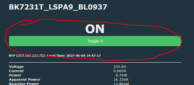

    On OBK main panel, there is a button, right?
    This button:
    Screenshot of a web page showing a large green button labeled “Toggle 0” with “ON” above it, circled in red.
    1. Do you have that Web Page button visible? Yes/No
    2. If you touch and release touch button on switch (physical one), does Web Page button state change (green to red, red to green)? Yes/No
    3. If you click Web Page button, does Relay state change?

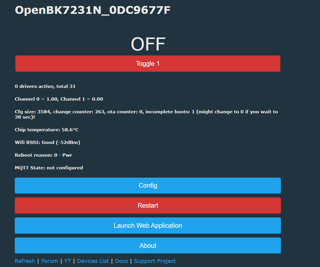

    >>21570019
    OpenBK7231N device control panel with OFF status and red Toggle 1 button.
    OpenBK7231N web panel with a green Toggle 1 button and ON status displayed.
    1. Yes
    2. State changes thru physical button and via button in web page as well
    3. Relay is completely silent, nothing happened.

    1. Relay pin is incorrect - use GPIO doctor from web app to find which pin toggles relay. Backup your template from web app first!
    2. Did you desolder T34? Maybe there is a cold solder joint for relay and signal does not go out.
  • #10 21570032
    uid1123444
    Posts: 9
    >>21570028
    1. To be honest, I tried to use GPIO Doctor, tried every combination of pin/assignment/channel type, don't even understand, but nothing, maybe there is some mistake from my side.
    2. Yes, cause there is no such other option in my case for flashing of T34 without desoldering :(

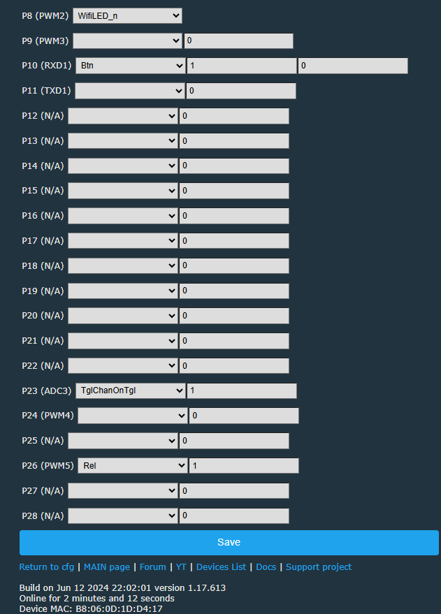

    #11 21570043
    Posts: 5216
    Help: 448
    Rate: 917
    just to add that the Tuya dump the user sent me has the same schema as my T34 here https://www.elektroda.com/rtvforum/topic4036975-60.html#21117908
    It seems to be physically similar with longer PCB
    I have dug out that device and this is my working template
    Screenshot of a device configuration interface with pin settings and dropdown menus.
    I've not had it toggle itself off/on yet
  • #12 21570051
    uid1123444
    Posts: 9
    divadiow wrote:
    "pins": {
    "8": "WifiLED_n;0",
    "10": "Btn;1",
    "23": "TglChanOnTgl;1",
    "26": "Rel;1"
    If we're using this code - when we touch physical button - it changes for a while, right after - changes to Off by itself.
    But relay is still silent anyway.
  • TglChanOnTgl is wrong for touch buttons

    TglChanOnTgl will change on each state change, so it won't work good for touch button. It will toggle first when you begin to touch, and then it will toggle when you lift finger. It's 100% normal. Do not use TglChanOnTgl for touch buttons. It's for old-style bistable switches where they have two states.
  • #14 21570113
    uid1123444
    Posts: 9
    >>21570110
    Tomorrow will try to resolder T34. Will keep you updated, guys
  • #15 21570117
    Posts: 5216
    Help: 448
    Rate: 917
    >>21570110
    oh! so
    instead?
    which does work for me..

    Update: looks like was an issue with soldering of T34. Now - when we touch physical button - relay is working, but switch is going to reboot :) Will continue investigation.
    @divadiow @p.kaczmarek2 sorry for taking your time guys, looks like its my fault, but i appreciate your time and help! Thanks a lot!
  • #17 21573749
    uid1123444
    Posts: 9
    Soldering issues, PIN #15 wasn`t soldered as needed.
