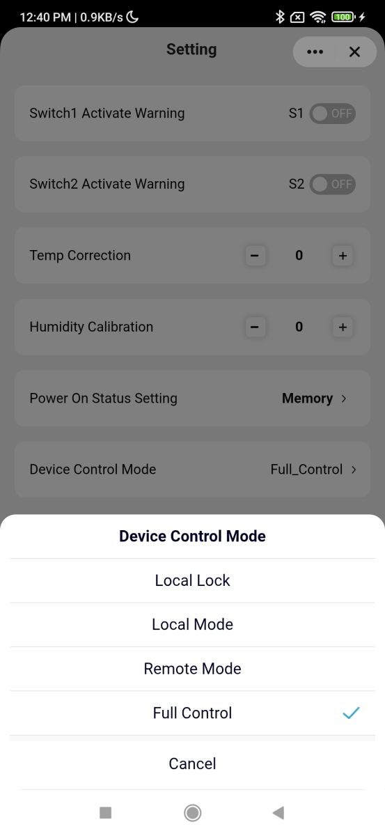

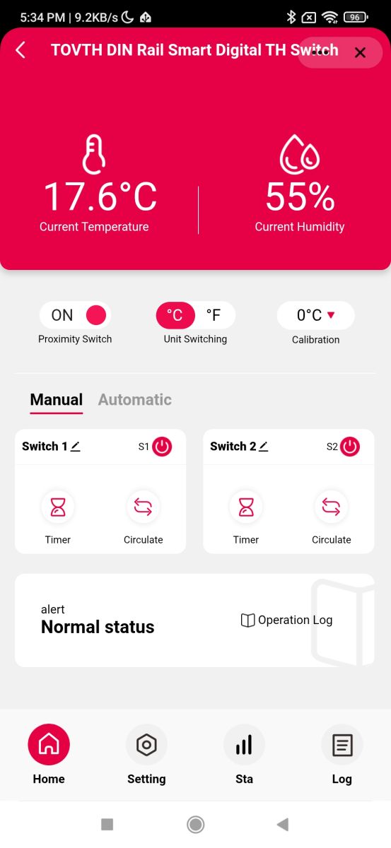

    Usage

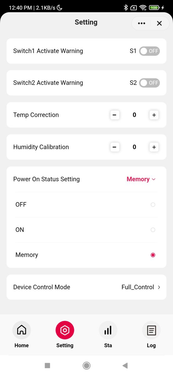

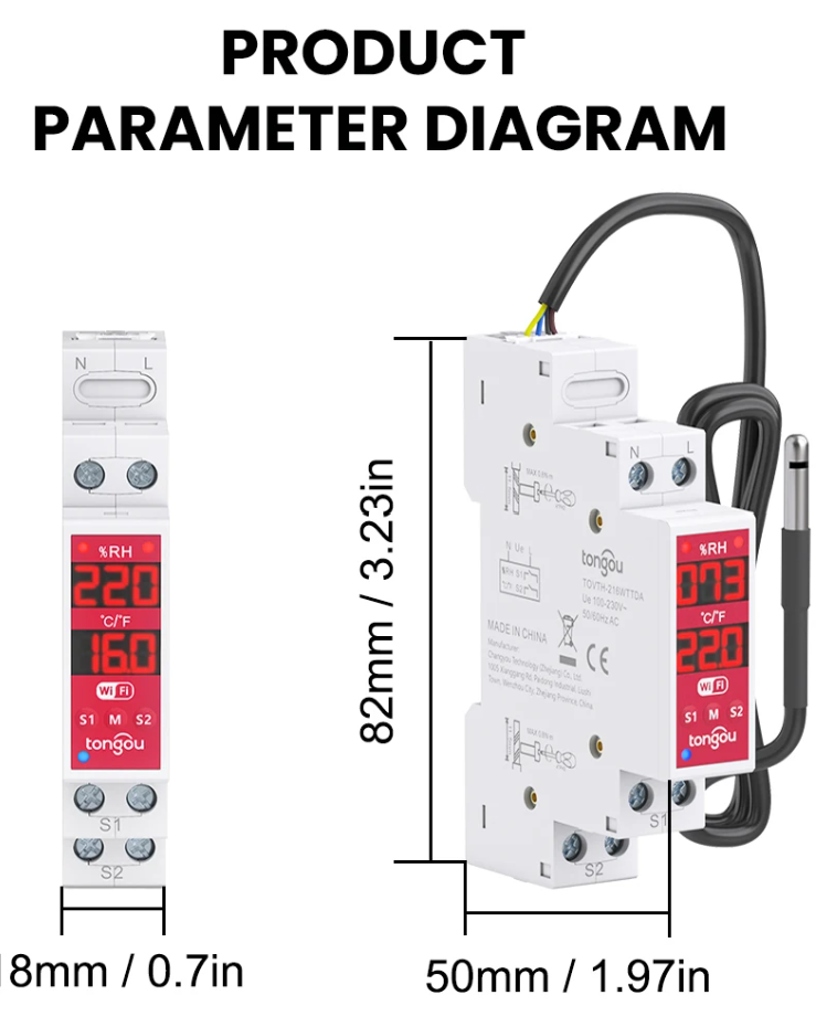

    The relays can be programmed on the MCU or remotely controlled via TUYA App based on temperature or humidity.
    TUYA app settings screen with relay, temperature, and humidity configurationTUYA app screen showing 17.6°C temperature and 55% humidity readingsTUYA app screen showing relay settings and device control mode options
    Purchased from the Tongou store https://www.aliexpress.com/item/1005009707659555.html
    Tongou relay dimension diagram with display and probe, 82x50x18 mm

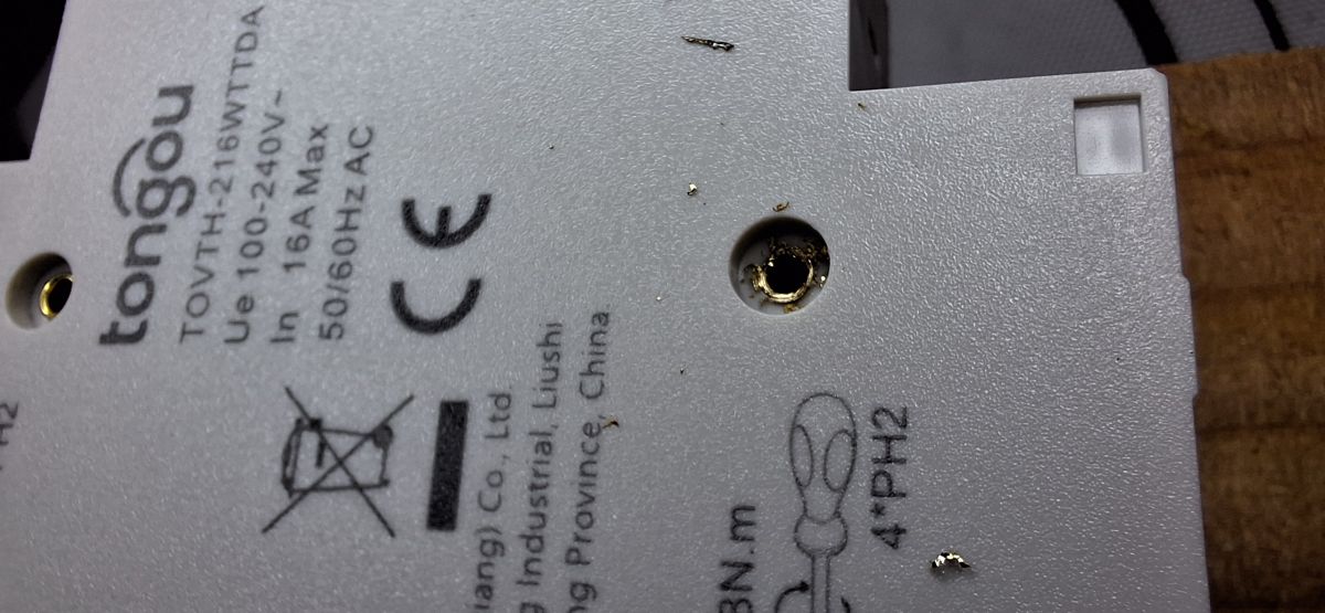

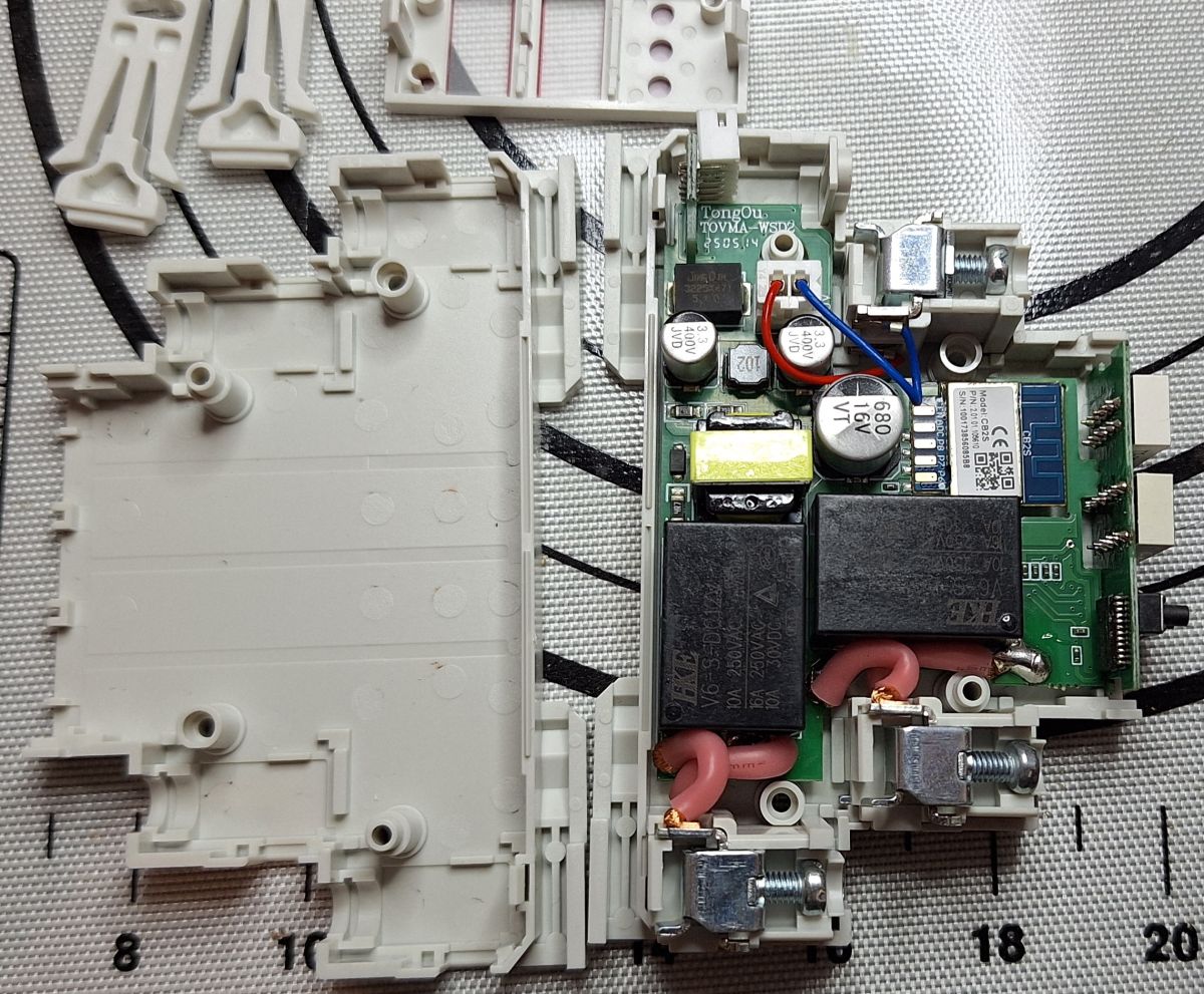

    Opening

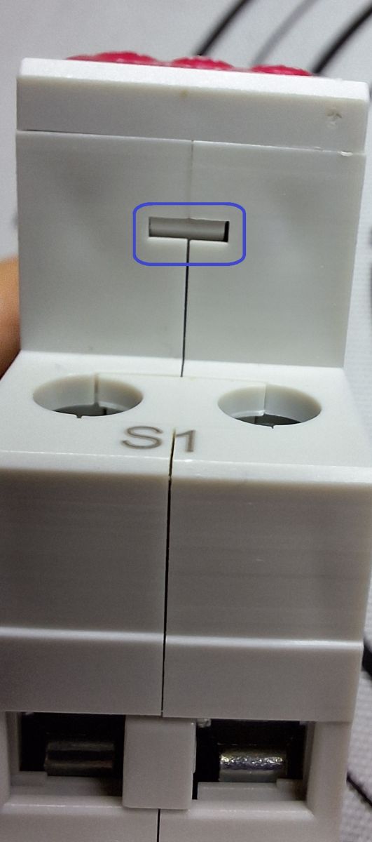

    Like most MCBs, the rivets/ferrules must be drilled out on one side and pushed through
    Close-up of the back of a Tongou electrical device with markings and mounting hole.

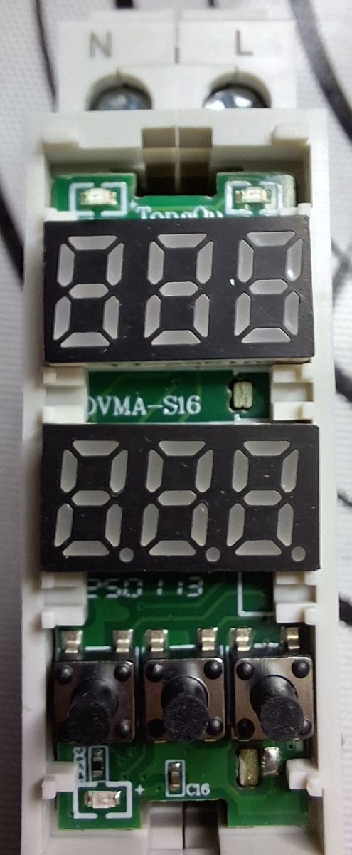

    the faceplate is clipped in on the top and bottom, it will slide out with some gentle prying. The rest of the device will open after this
    Close-up of an electrical terminal block labeled S1 with two wire insertion pointsElectronic module with dual LED displays and three push buttons

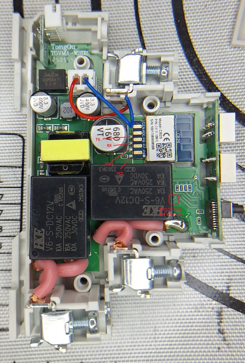

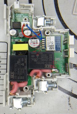

    Inside
    Which reveals the CB2S chip and a pair of relays quite tightly packed. There is limited space near the CB2S chip and difficult to get to the VCC, GND, TX, and RX which are on the back of the chip.
    Disassembled electronic module with PCB, relays, and screw terminals visible
    Interior of a smart relay module with visible electronic components

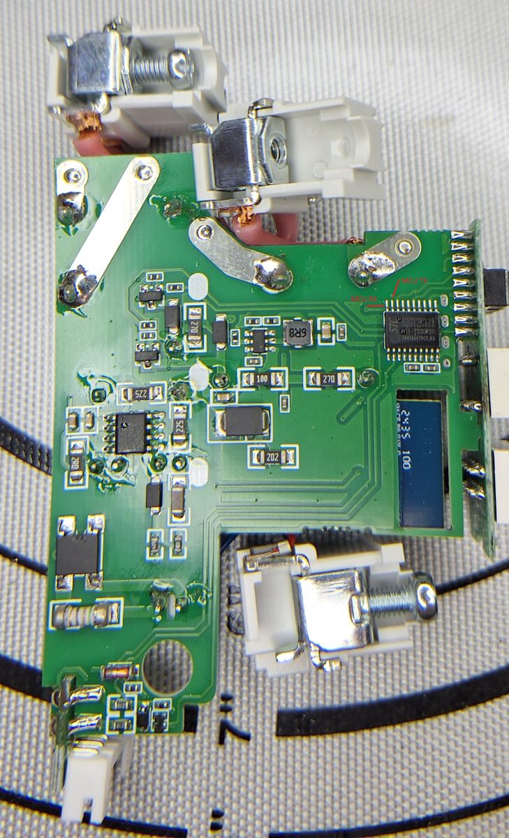

    On the back side is the MCU. The RX and TX traces are again difficult to get to. The MCU's TX (which needs to be disconnected for flashing) isn't visible on the back, and is passed on a VIA hole underneath the MCU.
    PCB with electronic SMD components and four DB9 connectors.

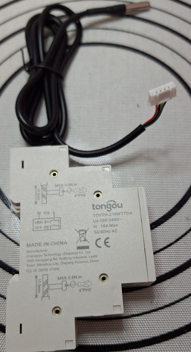

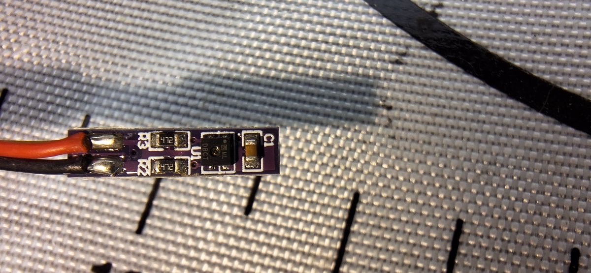

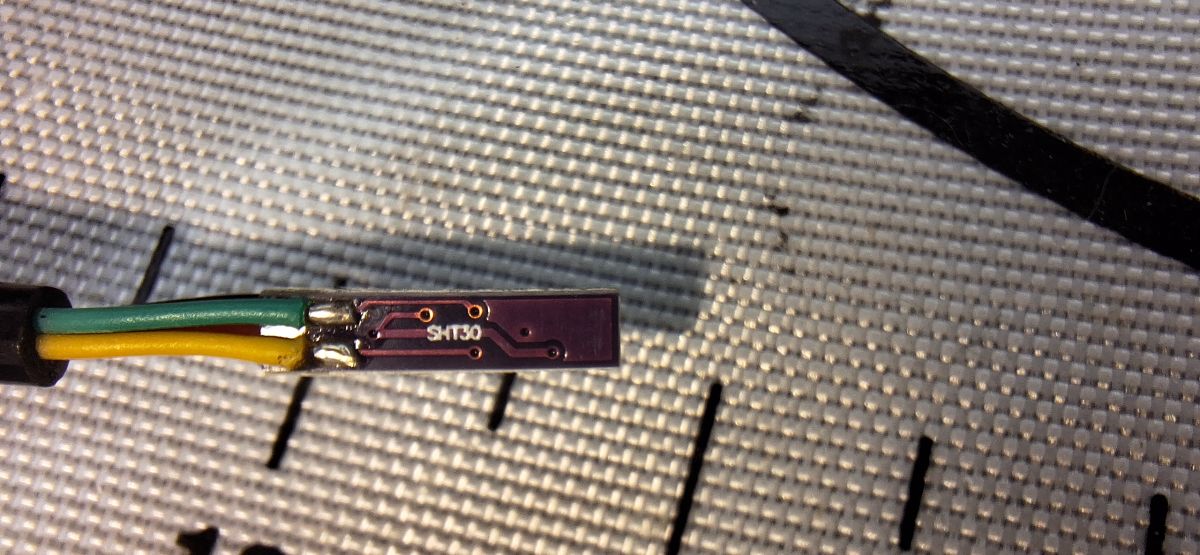

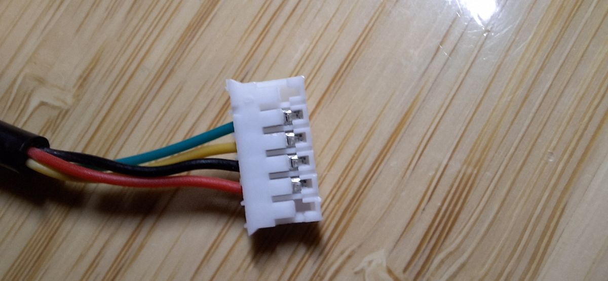

    Temperature and Humidity Sensor SHT30
    The SHT30 digital temp and humidity sensor attaches via a 6 pin JST 2mm socket on a 1m cable @ 3v.  The SHT30 only requires 4 wires for a I2C connection, but the JST connector is 6 pins.

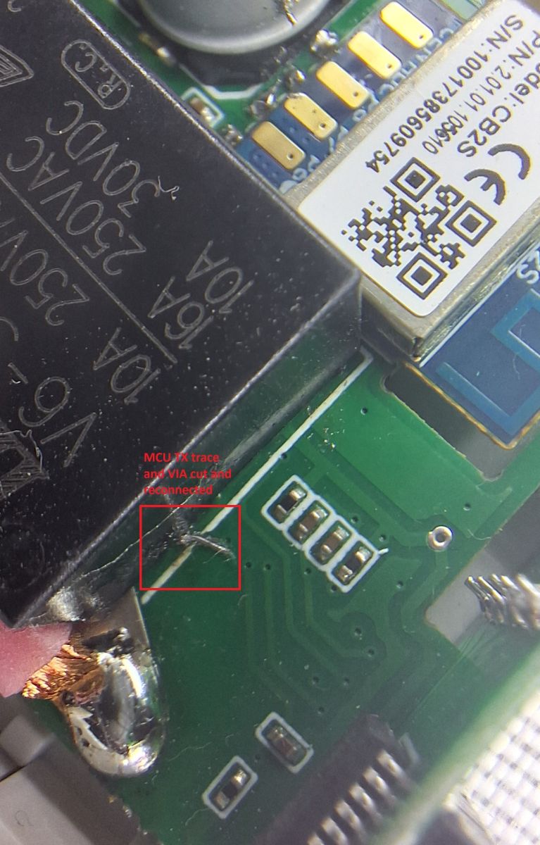

    Disconnecting MCU and flashing
    There are a few options to disconnect the MCU from the CB2S for flashing.
    1. Lift the CB2S - Lifting the chip is usually my preferred method, but it's about 1.5mm space around the tuya chip and other components like the capacitor and relay. I abandoned this method as other components started melting
    2. Lift the TX pin on the MCU. This would probably work fine, but because I can't see how close the TX VIA underneath the MCU is, I decided not to risk it.
    3. the trace traverses underneath the relay, and the only decent opportunity is about 3mm past the relay. Still not a great option, but I did it with two of these without issue.
    Gently scratch the circuit board to reveal the copper trace before the MCU TX VIA. Cut the trace 1mm before the VIA to leave yourself enough room to solder the cut later.
    Close-up of a PCB with highlighted repaired MCU TX trace near CB2S module
    With the MCU disconnected, you can backup and flash the BK7231N as normal with OpenBeken.

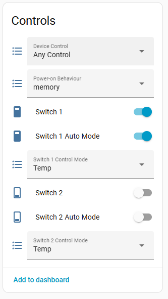

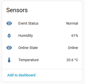

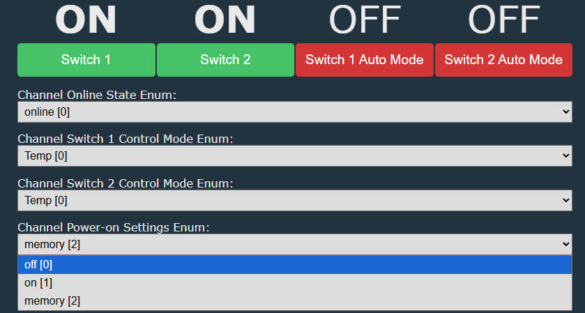

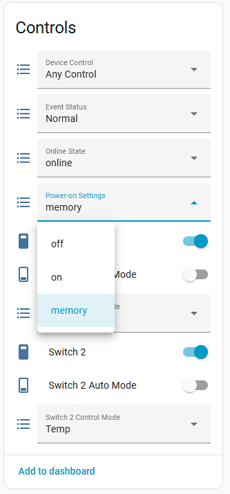

    with this config and enum support, the obk and home assistant look like this:
    [CB2S] How to Flash Custom Firmware on Tongou TOVTH-216WTTDA MCB with BK7231N CB2S? [CB2S] How to Flash Custom Firmware on Tongou TOVTH-216WTTDA MCB with BK7231N CB2S? [CB2S] How to Flash Custom Firmware on Tongou TOVTH-216WTTDA MCB with BK7231N CB2S?
    Some points to note:
    1. the MCU controls the relays unless DPID 121 enum is set to 2 or 3. In these modes, openbeken can control the relays
    2. the physical MCU programming is painful and documentation isn't especially clear.
    3. programming the MCU via dpid's is slightly easier. See MCU configuration heading below
    4. DPID 7 for cycling on-off patterns via the MCU is defined by a STR type.  OBK doesn't currently support String channel types. The could be done with TuyaMCU commands, but I personally don't require this so I did not invest time into it... I control the relays from MQTT so I don't need the MCU doing this.
    5. tuyaMCU enums can be passed to homeassistant with SetChannelType Enum if the latest built from PR

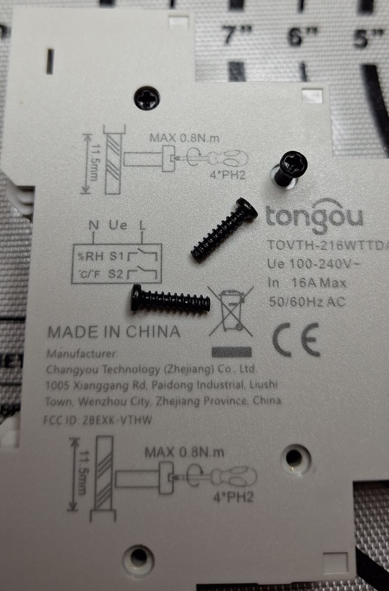

    As described in the Tongou MCB smart meter and relay teardown, you can either add new ferrules or use screws. I prefer the M2.5 x 10mm screws since they are easy and repeatable and don't require any special tooling.
    Close-up of Tongou electrical device housing with three black screws

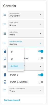

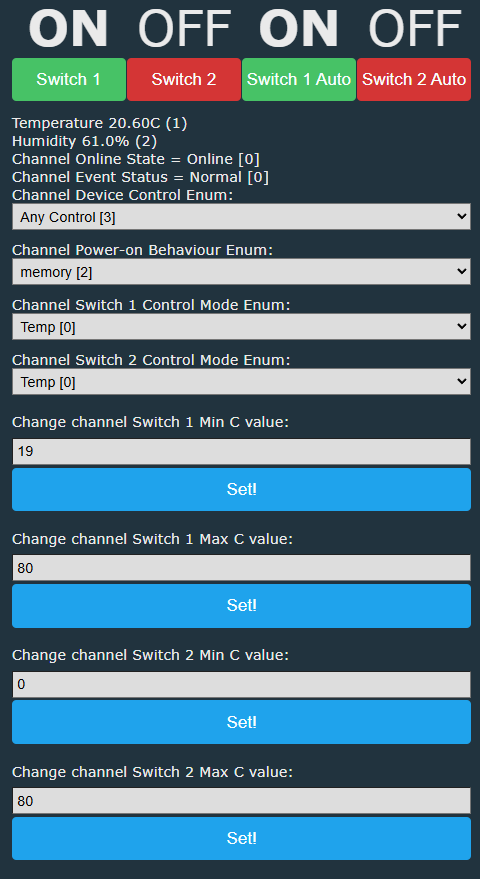

    I noticed your previous work on cmd_newEnums.c. So I expanded on this by adding a ChType_Enum and HA discovery and submitted Pull Request 1130. Please have a look - my first PR with OBK, so hoping I followed your conventions well enough. Happy to discuss what adjustments are required to get this into main branch.
    This PR allows for defining a tuyaMCU enum as a channel Enum on this device like so.
    SetChannelType 50 Enum
    SetChannelLabel 50 "Device Control"
    SetChannelEnum 50 "0:Buttons Locked" "1:Device control" "2:Remote Control" "3:Any Control"
    linkTuyaMCUOutputToChannel 121 enum 50
    The Enum channels then appear as select boxes on the OBK
    Control panel with switch buttons and dropdown setting menus
    After HA Discovery, the Enum channels appear like this:
    Device control panel with dropdown for Power-on Settings and multiple toggle switches
    stonacek wrote:
    I suspect this feature would blow out the size of autoexec.bat files and subsequently impact OTA updates.
    Regarding my earlier comment about the impact of Enums size of the autoexec.bat... it is certainly still is a concern, especially for the resources available for CB2S. I subsequently found that even on the main branch, before adding Enums to an already large autoexec.bat, the HA discovery already consumes the all the heap and reboots the device. Adding a ChType_Enums certainly doesn't help the situation (appears to consume an extra 1k from the heap on this device), but I don't think it is as big of an impact as I originally suspected.

    #10 21719563
    stonacek
    Posts: 23
    Rate: 7
    Can you do autoexecbatexamples update as well
    done
    only need opinion on whether to have it enabled by default of via config
    My biased opinion is on by default. The global g_enums stay uninitialized until the SetChannelLabel command, so almost no heap usage when not used. Total binary increase of less than 0.3%. Many TuyaMCU dpids have Channel Enums and I think this could be used in many places where Enums weren't available before (I am going through all my TuyaMCU commands on other devices and applying it).
  • #11 21719776
    Posts: 14767
    Rate: 12906
    One nitpick - it seems you didn't add autoexec.bat source, only added manually changed a file that is usually autogenerated.
    No new file here:
    https://github.com/openshwprojects/OpenBK7231T_App/tree/main/docs/autoexecs
    No new entry here:
    https://github.com/openshwprojects/OpenBK7231T_App/blob/main/docs/json/autoexecExamples.json
  • #12 21719874
    stonacek
    Posts: 23
    Rate: 7
    >>21719776
    ah yeah, I didn't see that particular .md was autogenerated. probably should have realised that while I was removing all the unrelated changes after running getcommands.js. Raised a new PR for the corrections
    thanks for merging into main!
  • Asking sensor type and whether humidity probe can be omitted
    #13 21781146
    mirek_mgj
    Posts: 131
    Rate: 80
    I would like to use this "switch" as a heater temperature controller for a water boiler and the humidity meter does not interest me. I have one DIN box free and I think it should work. I haven't found a manual that describes the type of sensor (I need a 3m length).
    And here is my question - does anyone know what type of sensor it is (e.g. NTC 10K) ???, and if I do not connect the second sensor (humidity) - so that it does not display the value, only the temperature?
    Greetings Mirek
  • #14 21781703
    stonacek
    Posts: 23
    Rate: 7
    >>21781146
    I updated the original post with pictures of the SHT30 temperature and humidity sensor. It's an all-in-one sensor and I2C-connected, so decoupling the humidity is not an option. Though, it is a 6-pin PH 2 mm JST connector, so you could extend it by another meter or so before you start hitting I2C limits and need an I2C booster.
