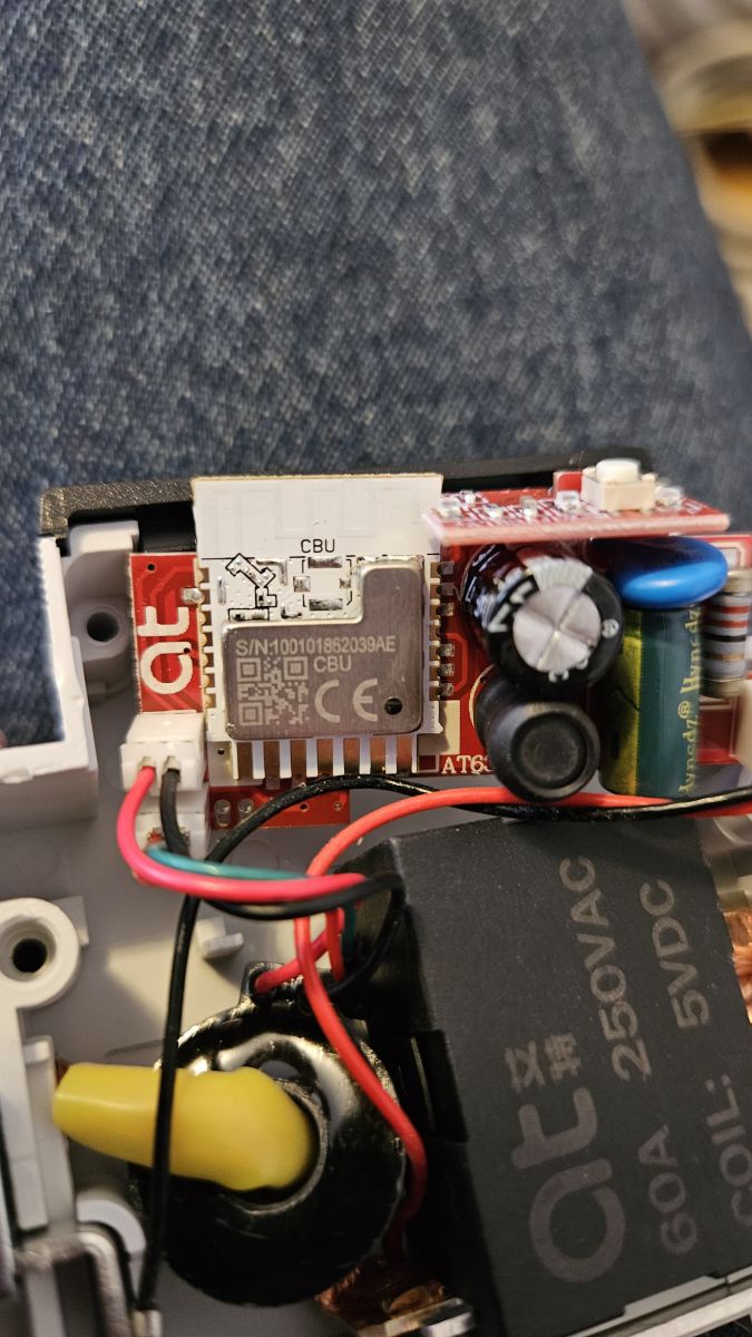

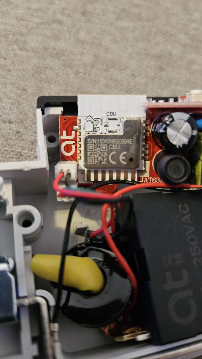

    Picture of the inside:
    Flashing New Tongou TO-Q-SY1-JWT Device: DIN Rail Switch and Meter, BK7231 template script Flashing New Tongou TO-Q-SY1-JWT Device: DIN Rail Switch and Meter, BK7231 template script ]
    All Pins of the BK7231N are reachable.
    Just flashed it via serial and made the attached config.
    All LEDs, Relay, and Meter are fully functional. [

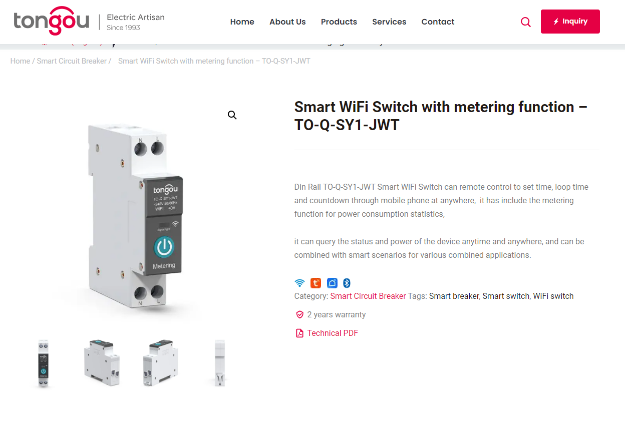

    Thank you, just for the clarity, I will add here some screenshot from device seller's page:
    Here is template within post:
    And here's device manual:
    TO-Q-SY1-M..ual.pdf (1.55 MB)You must be logged in to download this attachment.
