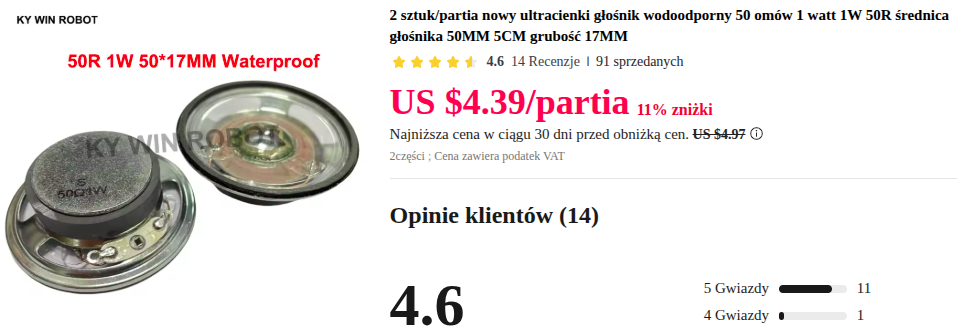

    bartosz9991 wrote:
    on what core did you make this w.h. transformer and from where did you get the wykoom loudspeaker?
    I dismantled the core from some telecom or control device (so called electro scrap, from a previous era, with TTL circuits) where it was used in the input transformer, when I find this board I will upload a photo of it, now I don't have it at hand.
    Speaker from aliexpress, at a lower price than the photo below
    Two waterproof 50R 1W speakers, 50 mm diameter and 17 mm thick, KY WIN ROBOT brand
