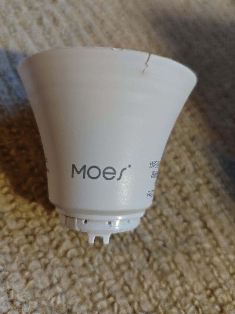

    Unlike the uHome UAMxxx Matter devices with Beken modules and different efuse/coeff keys, this Moes Tuya Matter bulb appears to be a lot easier to convert to OpenBeken.
    https://www.aliexpress.com/item/1005006924194407.html

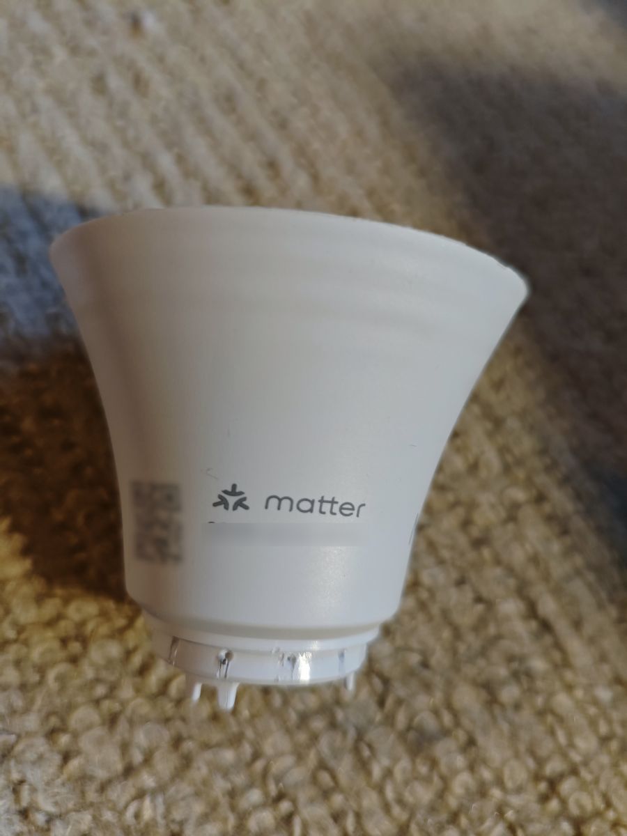

    Moes Tuya Matter smart bulb with WiFi and voice control.

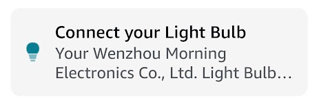

    Inside is a CBLC5 module which when independently powered presented itself to Alexa as
    Connect light bulb message from Wenzhou Morning Electronics Co., Ltd. device

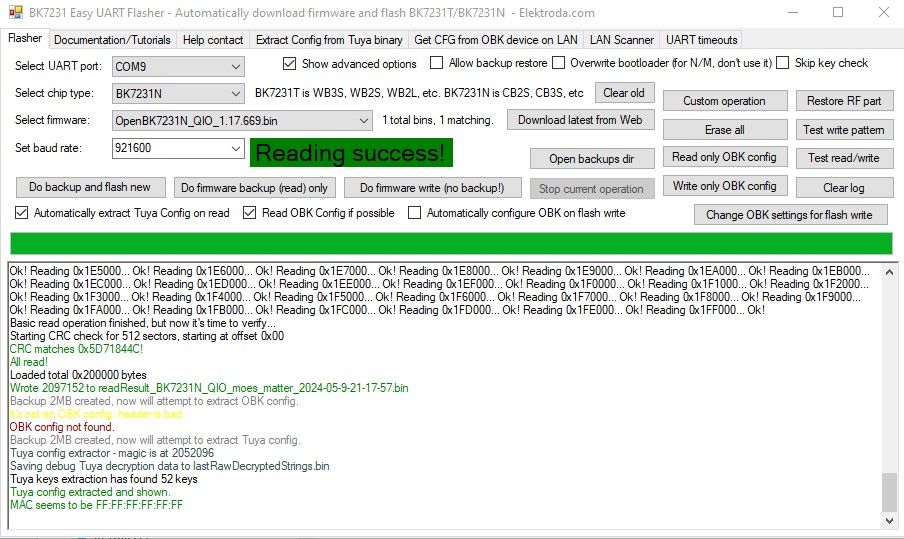

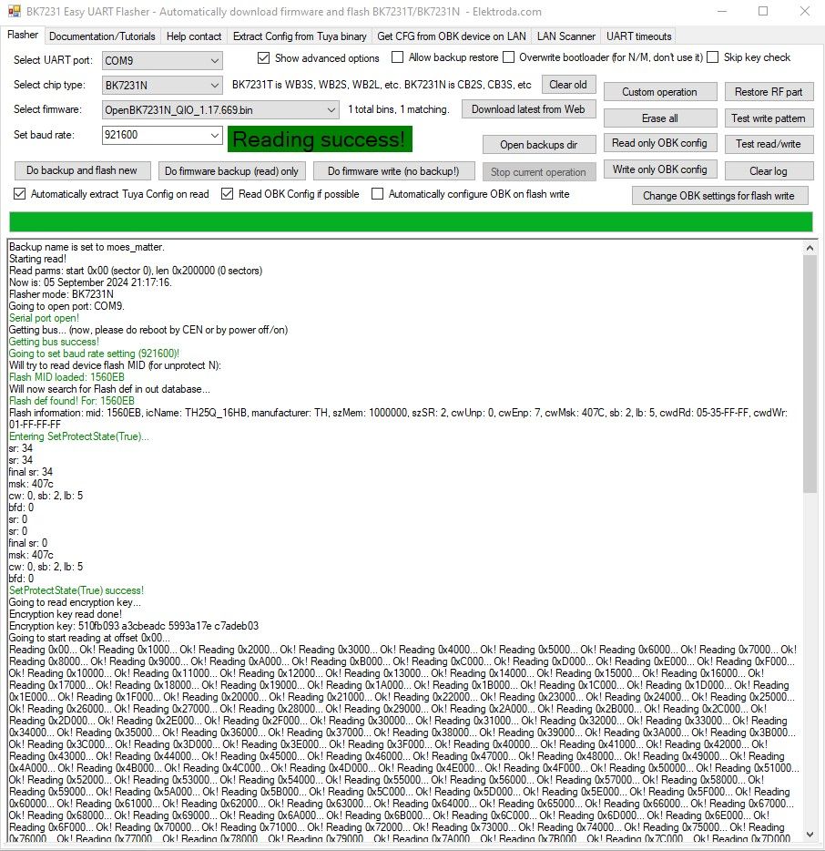

    And Easy Flasher backup. Yes, it uses the standard Tuya key 510fb093 a3cbeadc 5993a17e c7adeb03
    BK7231 Easy UART Flasher interface with successful flash data reading. BK7231 Easy UART Flasher software successfully reading data
    EF even extracted some config
    This was a little worrying at the end of the backup though
    Is it like the uHomes with its network info in a different location?

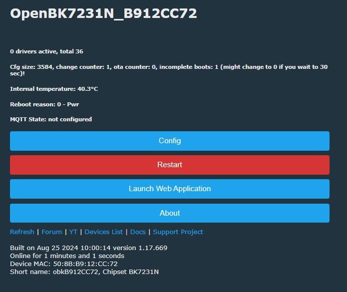

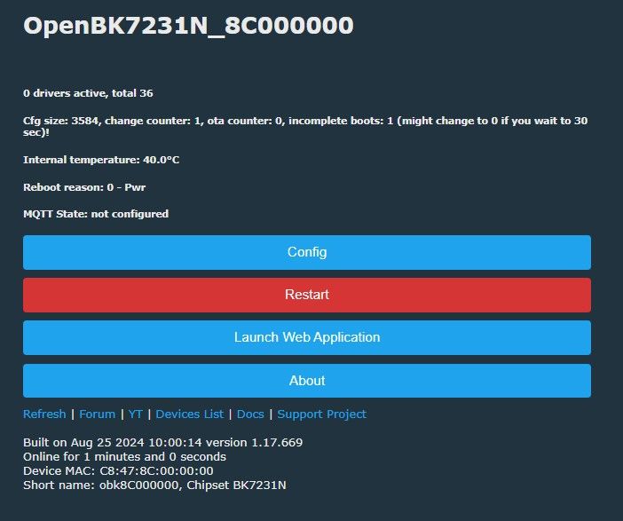

    Flashing OpenBeken was successful but the AP name broadcast was suspiciously generic. PC connected to it and it was accessible
    OpenBK7231N user interface with configuration and restart buttons.
    This OBK flash was with the "overwite bootloader (for N/M)" unchecked. I wanted to see if BL 2.0 was OK booting OpenBeken. It was
    Next up, overwrite the BL with standard BK7231N_1.0.1. Boots into OBK fine, but same mac issue

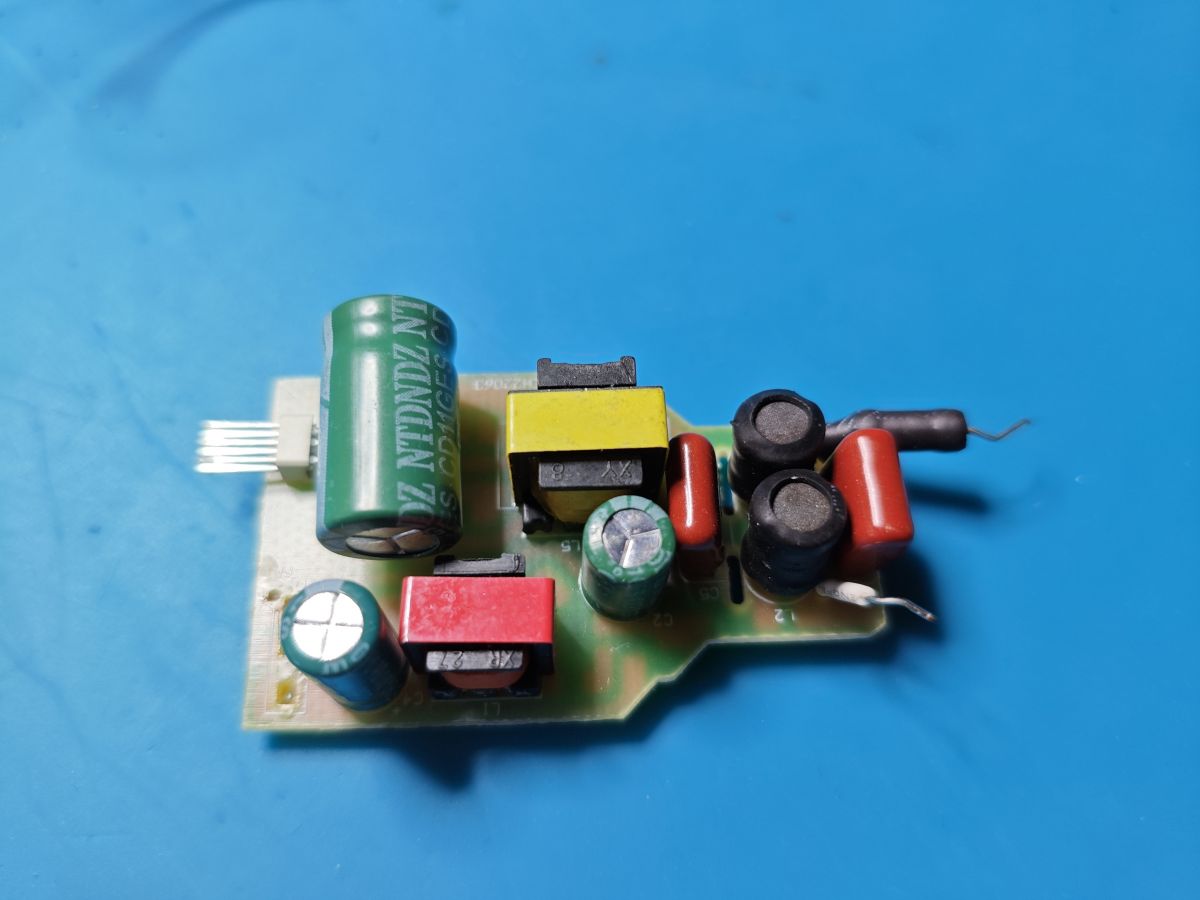

    For the moment, the module is still unsoldered in case more flashing is needed, so not a working finished, proven device conversion yet.

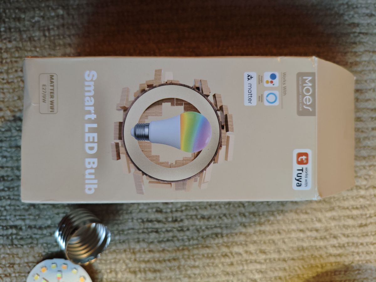

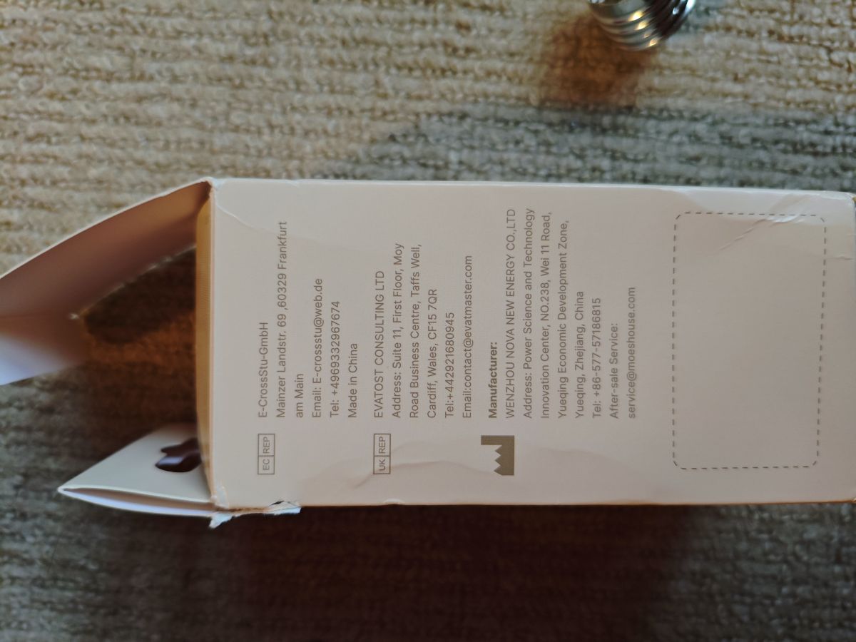

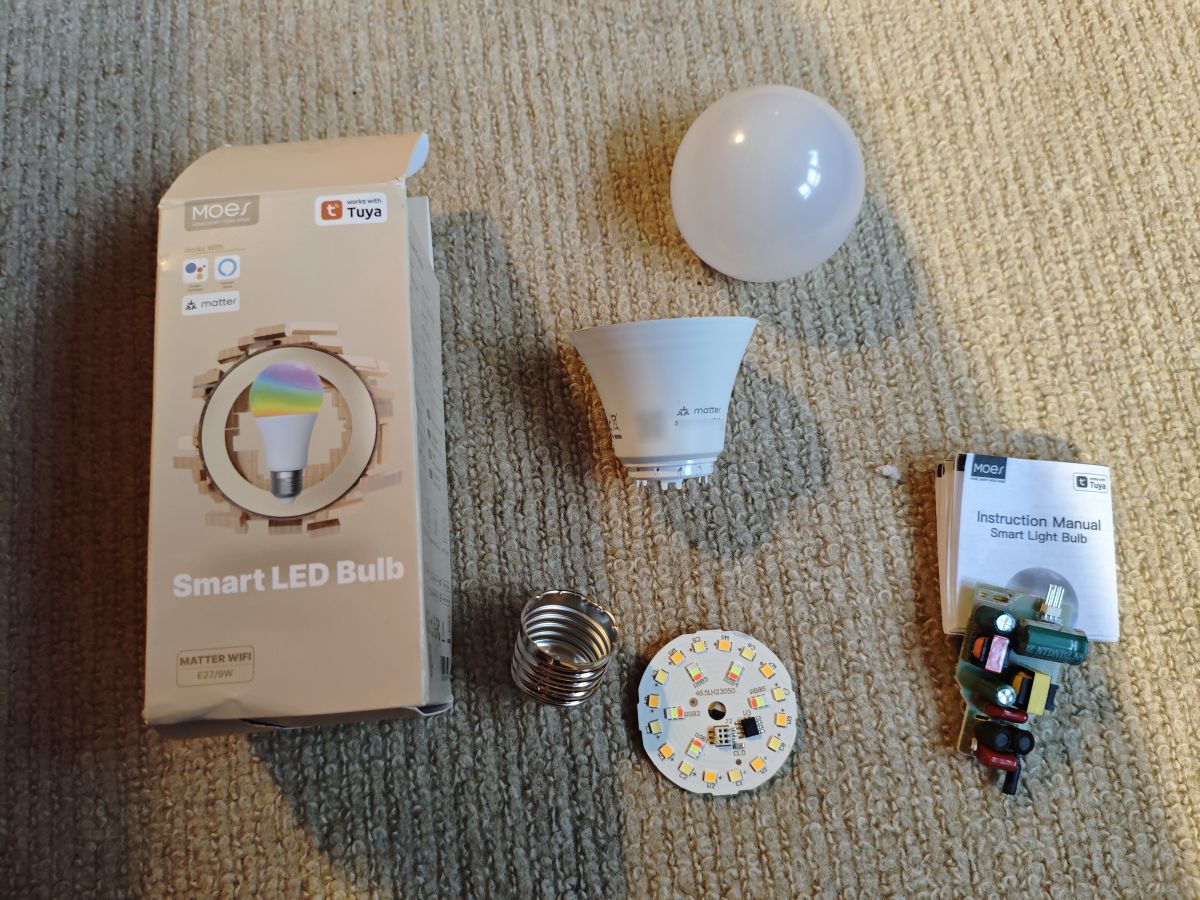

    hmm. no date code on the PCB I can see.
    Image of an electrical product box on a carpet, showing the manufacturer's contact information. Energy label of MOES bulb with class F. LED bulb box with product specifications on the sides. Box of Moes Smart LED Bulb with Matter and Tuya logos. Parts of Moes Smart LED Bulb with packaging and manual. Image of a printed circuit board (PCB) with various electronic components on a blue background. Round circuit board with arranged LEDs and electronic components. A white light bulb with the Matter logo on a beige carpet background. Moes light bulb with a crack on the top section of the casing. WiFi 9W LED bulb with technical specifications on the casing. Close-up of a printed circuit board (PCB) with various electronic components. Printed circuit board with multicolored electronic components. Circuit board with colorful electronic components on a blue background.
    I see 2023 dates in the log firmware compiled at Oct 26 2023 16:39:00

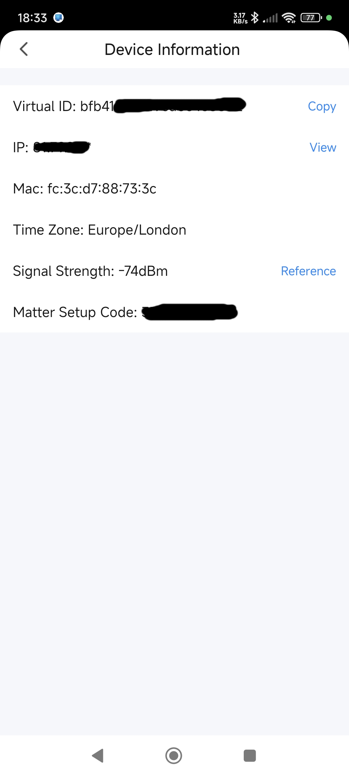

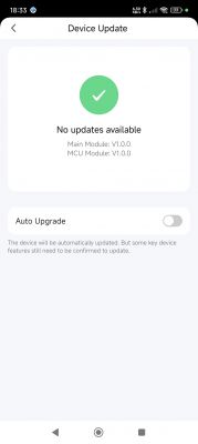

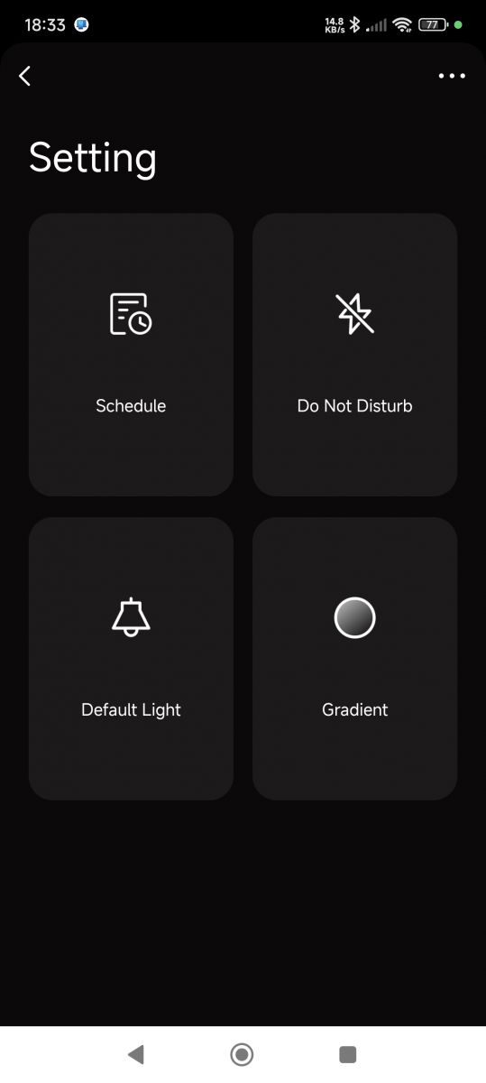

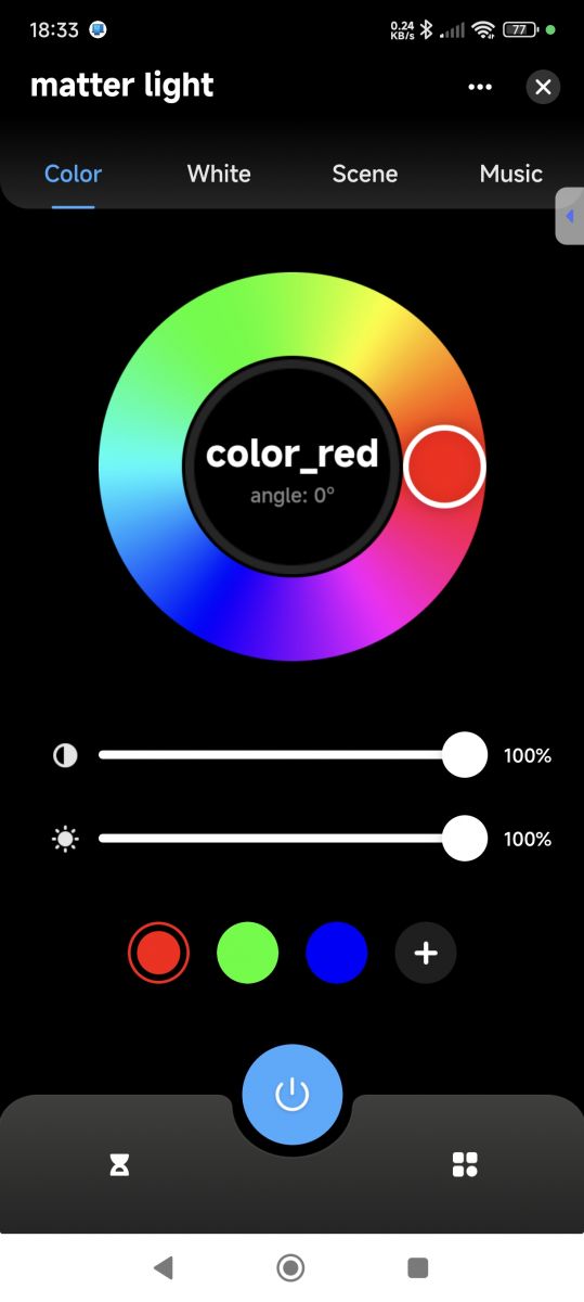

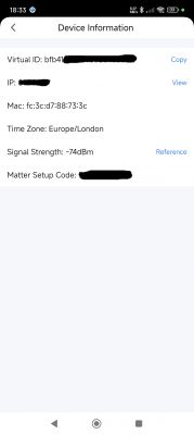

    I've flashed the backup to a CB3S and it boots and broadcasts as if the original bulb. I've paired it to the Tuya app
    Smartphone displaying a lighting control app with a colorful wheel. App settings screen with four options: Schedule, Do Not Disturb, Default Light, and Gradient. Device update screen showing no available updates and an auto upgrade toggle. Screen showing device information with IP and MAC addresses and signal strength.

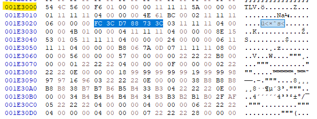

    not found the network partition start yet
    Added after 8 [minutes]:
    other tools show this is the content of the storage area
    Added after 1 [hours] 55 [minutes]:
    Screenshot displaying hexadecimal data from memory at address mac 0x1E3000.
    mac. 0x1E3000

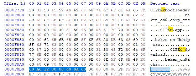

  • Reading BL partition addresses from bootloader markers
    #5 21217939
    Posts: 5222
    Help: 449
    Rate: 918
    well that sounds like a cool idea!
    one step at a time, but if you wanted to extend detected info, the BL/APP/OTA partition addresses could also be read from the BL after location of 01PEbootloader, 01PEapp and 01PEdownload.
    OK so, BL and APP always seem to the same but OTA has varied.
    bootloader has 0 start
    00 00 01 00 -> 0x10000 length
    Screenshot of a hex editor showing a data string with a highlighted segment in yellow.
    app partition 00 00 01 00 -> 0x10000 start
    Screenshot of a hex editor showing binary data and text fragments.
    00 87 10 00 -> 0x108700 length
    Screenshot showing binary data with address and app identifier.
    download partition 00 A0 12 00 -> 0x12A000 start
    Screenshot of a hex editor with a highlighted segment 00 A0 12 00.
    00 60 0A 00 -> 0xA6000 length
    Snippet of code from a hex editor with a highlighted set of bytes.

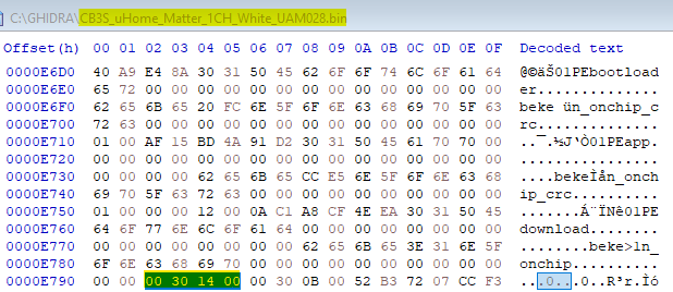

    to demonstrate that further, here is the OTA/download start address for the uHome firmwares on which I've been flashing RBLs to 0x143000
    Screenshot displayed from Ghidra, showing the binary file content with offsets and decoded text.

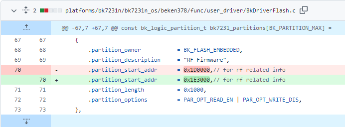

    and now the correct mac address with modified BkDriverFlash.c
    1.17.669 vs 1340_merge_c9033419dbae
    UART to 1340_merge_c9033419dbae from full factory Matter reflash to CB3S.
    Screen displaying device software details with MAC and chipset. ---> Screenshot with device version and parameter information.
    Code snippet showing change of partition start address in BkDriverFlash.c file.

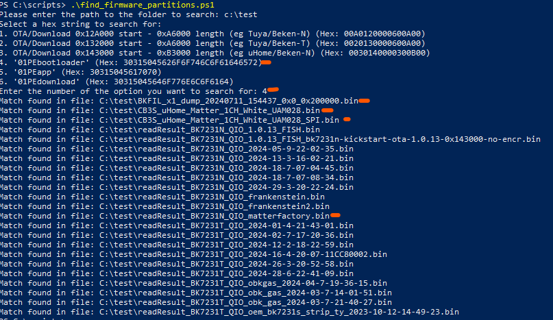

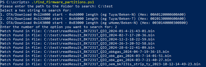

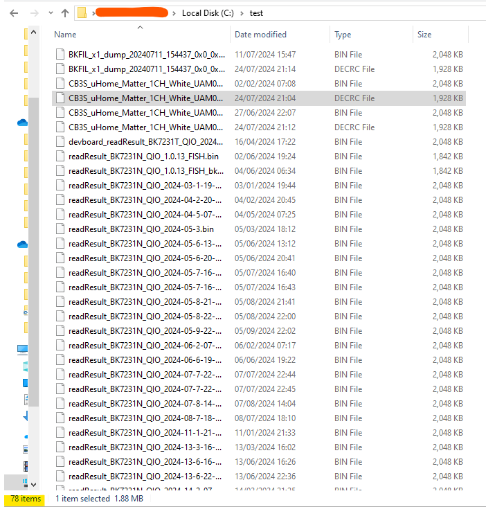

    I made a little script to find strings in all .bin files in a specified folder. Just trying it out on a collection of all my bin files
    eg
    Screenshot of search script results for strings in .bin files.
    and this one for "PEbootloader". It should have detected more but when you open some bin files in HxD there's the odd wrong character in the middle of the decoded text, even though the backup can be flashed back to device and works 🤷🏼‍♂
    Script searching hex sequences in binary files
    View of a binary file in HxD editor with a highlighted hex sequence.
    Screenshot of a file explorer showing a list of .bin and .DECRC files in a test folder.
    Dunno, good idea or not? I don't know how you'd programmatically find the correct byes that are the start and length addresses if theyre not always at the same offset.

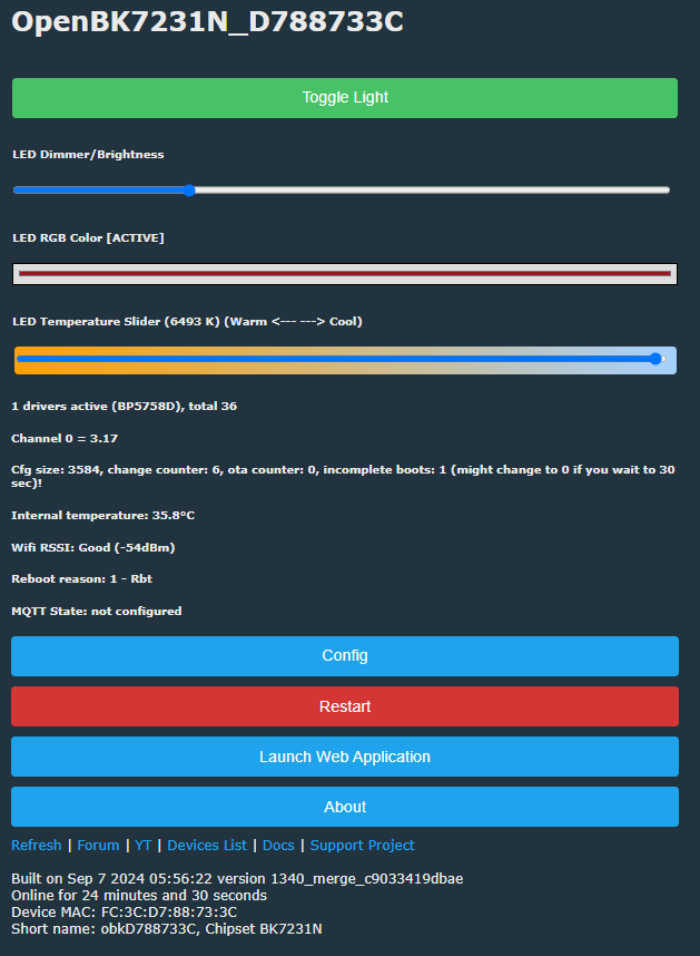

    I flashed the CBLC5 back to 100% factory then did OBK again. Module soldered back into PCB and the bulb reconstructed. I appear to have a working Moes RGBCW E27 wifi bulb that was a Matter device. It's working with bootloader BK7231N_2.0.0
    https://github.com/OpenBekenIOT/webapp/pull/1...mits/22a3abf3889f29a50fc079e7dc308201331d21d3
    Added after 9 [minutes]:
    Screenshot of OpenBK7231N control panel with sliders for brightness, RGB color, and LED temperature.
