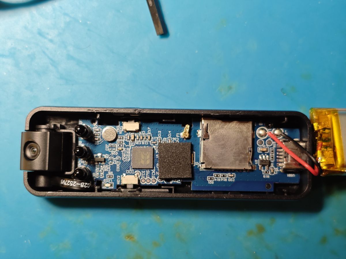

    How insecure these cheap cams are became real a few months ago when I went into one of the apps (one of the FTYCamPro, YsxLite types, can't remember which) to find I was viewing someone else's live cam! It was of a bedroom and someone walked past the doorway. Another session and I saw some kitchen cabinets.
    I'm hopeful one day a working alternative firmware can be developed to replace stock entirely.

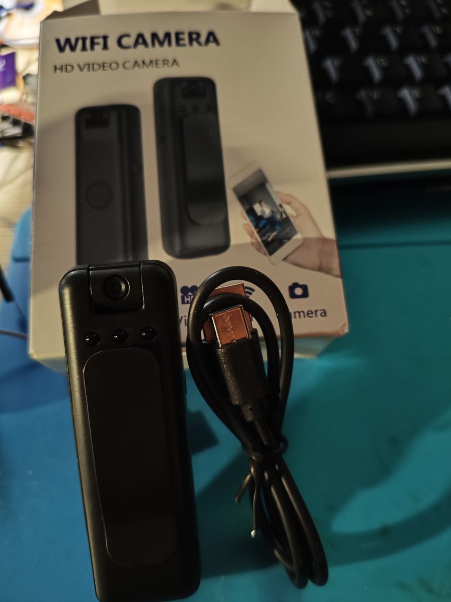

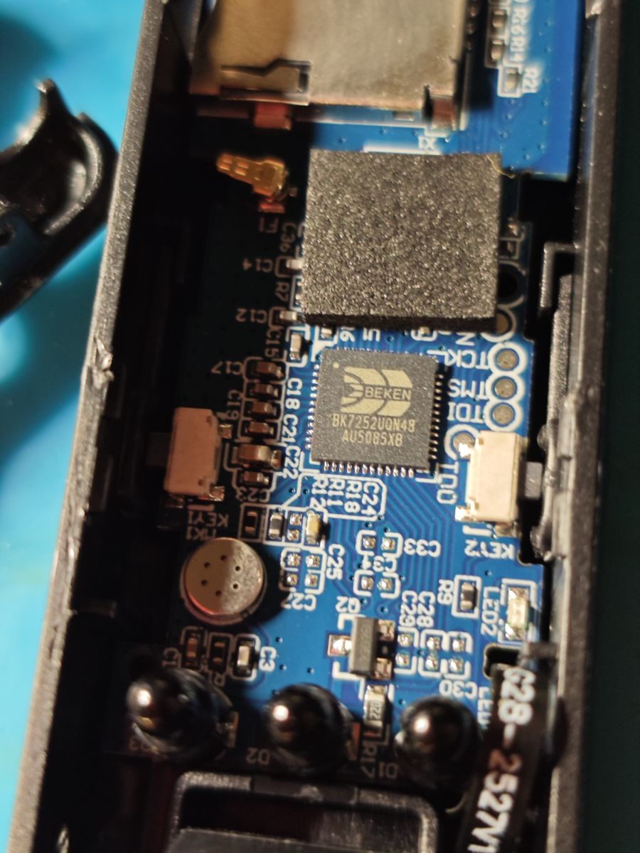

    On the subject of Linklemo, An interesting device arrived today with a BK7252UQN48 inside. I imagine it'll be a similar story to the other XCThings based cams
    Mini WiFi camera, USB cable, and packaging with device illustrationDisassembled small camera interior with circuit board and microSD slotClose-up of circuit board with BEKEN BK7252 chip and small microphone component

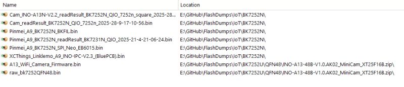

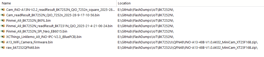

    Added after 17 [minutes]:
    all dumps containing 'xcthings'
    List of BIN files and folders related to BK7252N and A13 devices

    Paver3109
    Just looked for the "shared secret" found in the `INO-IPC-A9-V2.4` in those firmware dumps, it appears that:
    - `Cam_INO-A13N-V2.2_readResult_BK7252N_QIO_7252n_square_2025-28-9-17-39-25.bin`
    - `Cam_readResult_BK7252N_QIO_7252n_2025-28-9-17-10-56.bin`
    - `INO-A13-48B-V1.0.AK02_MiniCam_XT25F16B/raw_bk7252QFN48.bin` -> definitely using the same encryption scheme (verified using ghidra)
    all contain the same secret A2r0...
    This is not the case of:
    - `Naxclow_MiniCam_A11-A9_B-V2.7_240426.bin`
    - `BK7252-A9-20211124.bin`
    - `INO-A13-48B-V1.0.AK02_MiniCam_XT25F16B/A13_WiFi_Camera_Firmware.bin`

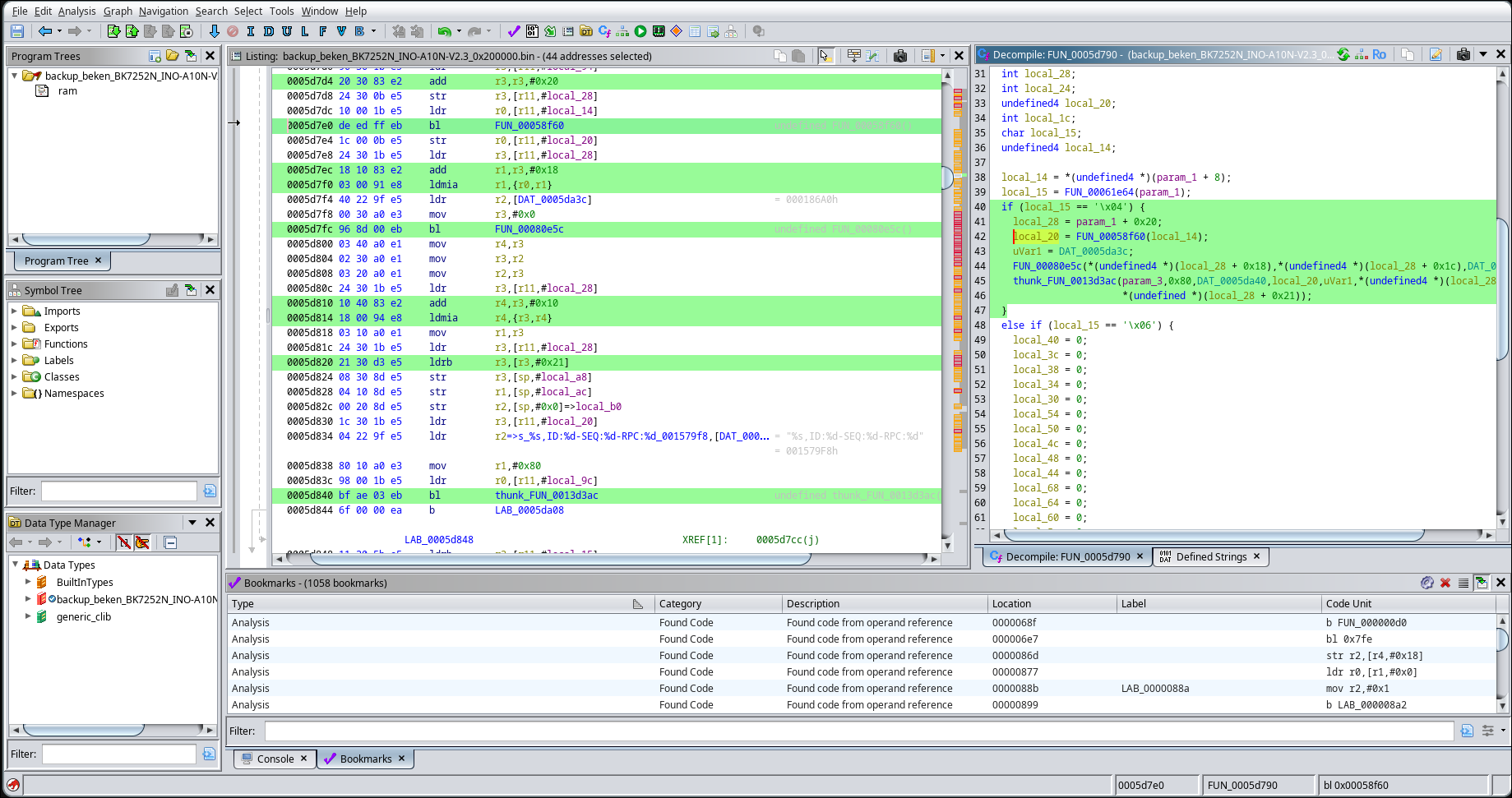

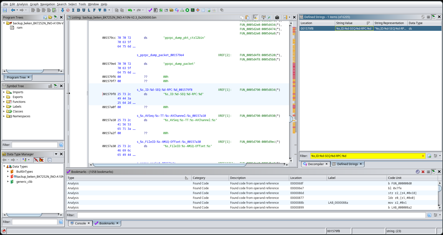

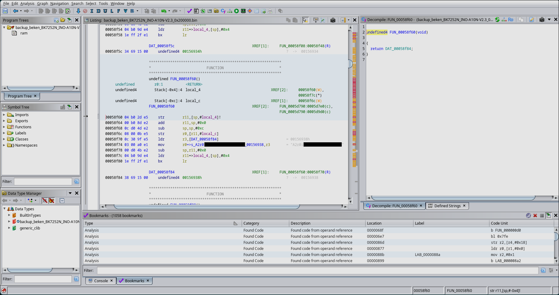

    Paver3109
    >>21721547 Your device, INO-A10N-V2.3, uses the same secret and encryption scheme.
  • #106 21723294
    Laloshifrin
    Posts: 32
    Can you share a ghidra screenshot regarding the implied function(s)? I can't find it :(. I use Ghidra 11.4.1 and Java 21.0.8 but there's no referencing function to this text "%s,ID:%d-SEQ:%d-RPC:%d" actually found.
  • #107 21724228
    Paver3109
    >>21723294
    Sure, here you go! I'm using Ghidra 11.0.3.
    Screenshot of binary analysis software showing assembly code and string references.
    Screenshot of Ghidra reverse engineering tool showing assembly code and decompiled C code
    IDA Pro interface showing ARM disassembly, decompiled C code, and symbol tree.
  • Uncrc.py fixes decryption of non-CRC partitions
    #108 21724462
    Laloshifrin
    Posts: 32
    Great! Thanks a lot! My problem was I was using ltchiptool to decrc but it didn't work correctly when it reached partitions without CRC. Using uncrc.py works better and now there's the referencing function and my Ghidra listing and decompile are as yours. Secret key is there! :). Now I'll take a ride on github.com/fusetim/insecurity-camera-tools and try to decrypt some packets i captured. Thanks again!!! :)
