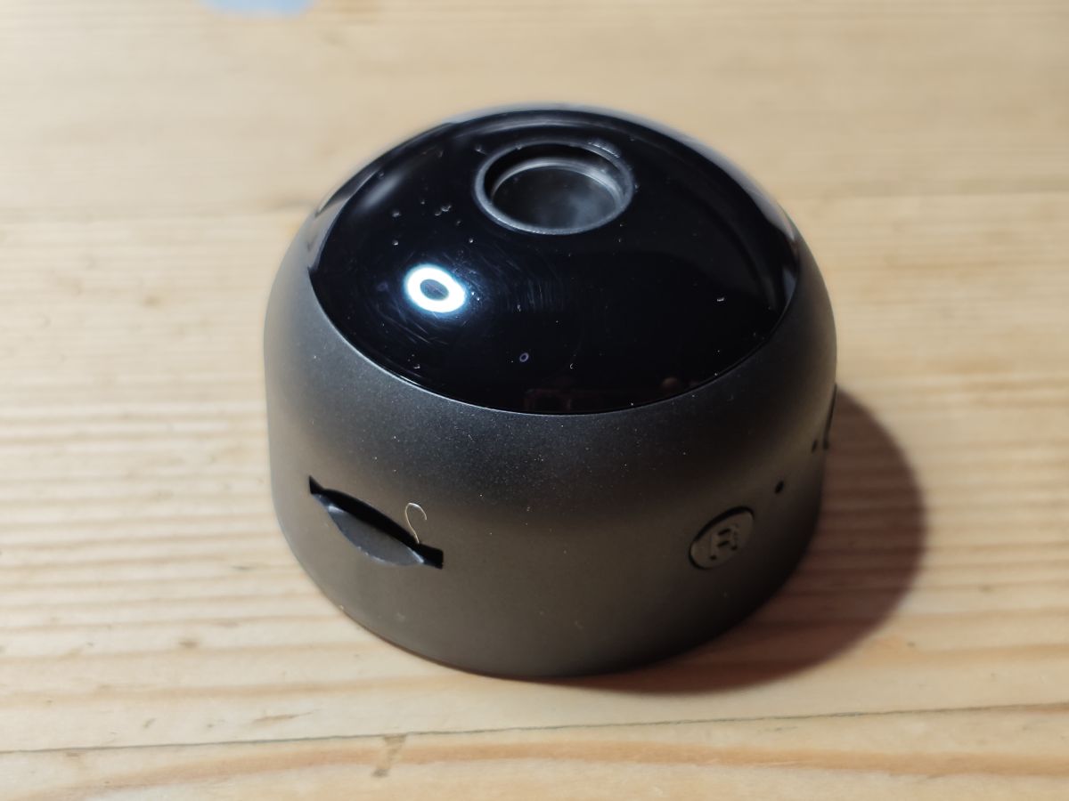

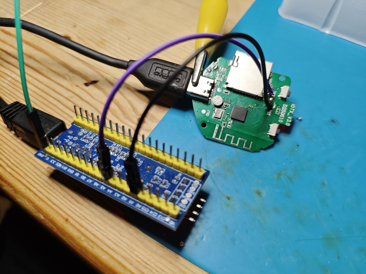

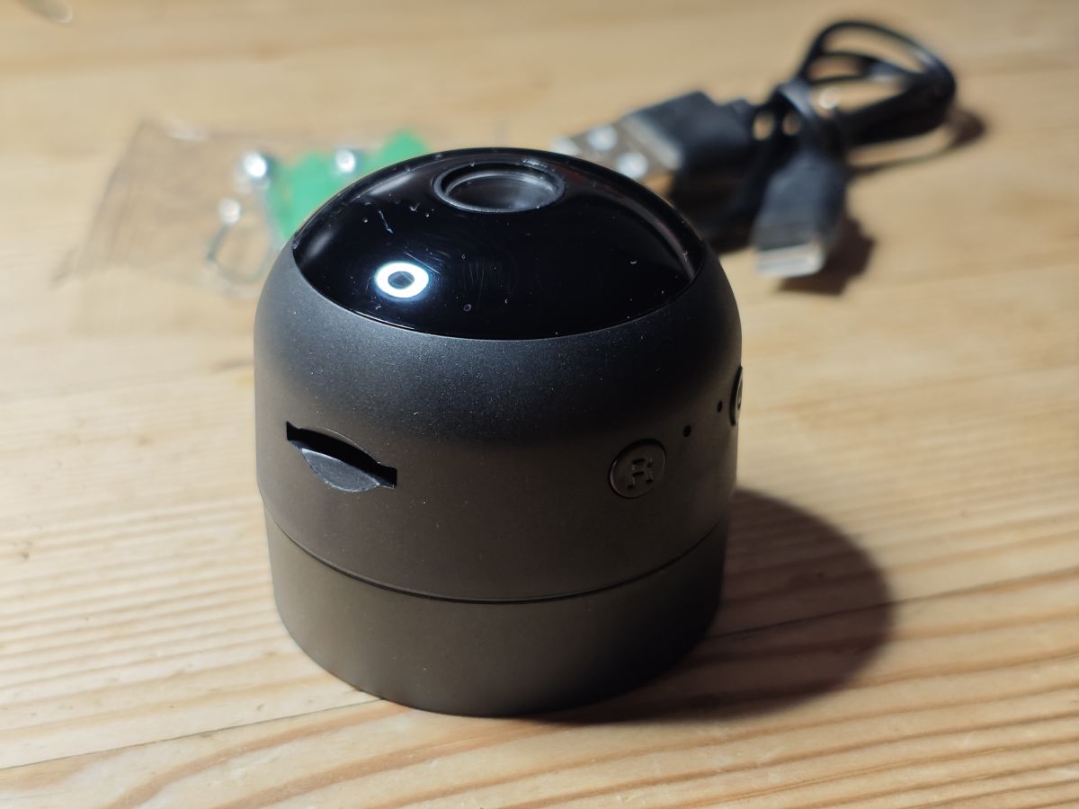

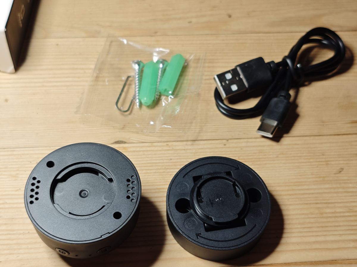

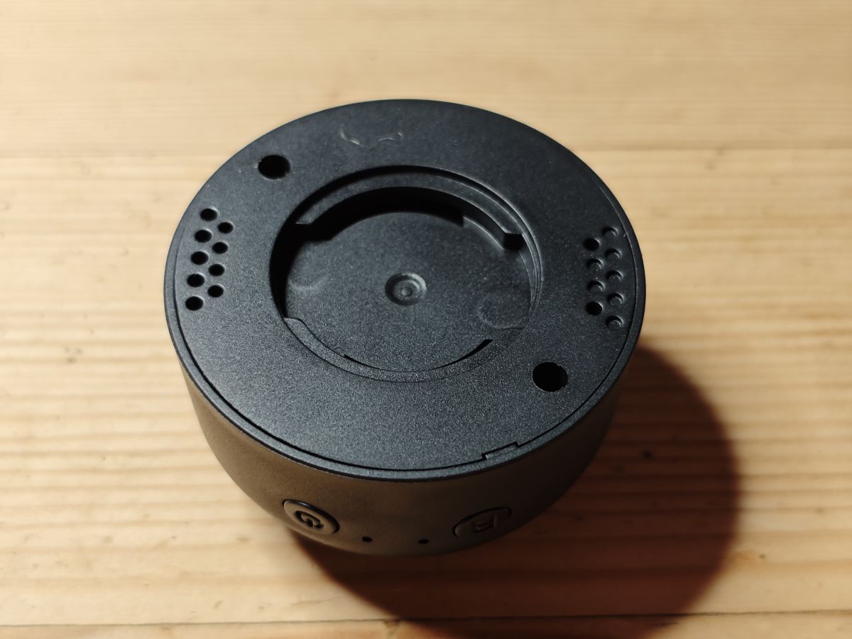

    Yet another mini cam from Ali Express.
    Kebidumei HD 1080P WiFi Camera infrared Night Vision Camera 360°Rotatable Home Security Protection Surveillance Cam Baby Monitor
    S2 WiFi camera shown with smartphone screen and monitoring feature labels
    https://www.aliexpress.com/item/1005010058192379.html
    Box with WiFi HD device label lying on a wooden surface White box labeled WiFi Camera HD Video with certification symbols at the bottom. WiFi HD camera box with feature icons and the text “Model” Shipping label with barcode and description of HD 1080P WiFi security camera Z-IOT CAM package contents: manual, cable, wrapped camera and mounting parts Black dome security camera on wooden surface with round lens on top Two black mounting bases with USB-C cable and wall plugs on wooden surface Black plastic device base or mount top view on wooden surface Black rotating camera on wooden table with ports visible and cable in background Two black screws on a wooden surface beside a black plastic component Interior of electronic device showing battery and circuit board Disassembled camera showing internal housing and circuit board Inside of a small electronic device with a PCB, USB-C port, and microSD slot Disassembled camera with exposed PCB, lens, and battery on wooden surface Camera module with lens mounted on a green printed circuit board Printed circuit board with SMD components and connected lithium-polymer battery Wide-angle camera module with black lens on blue background Small 3.7V 200 mAh lithium polymer battery with technical markings

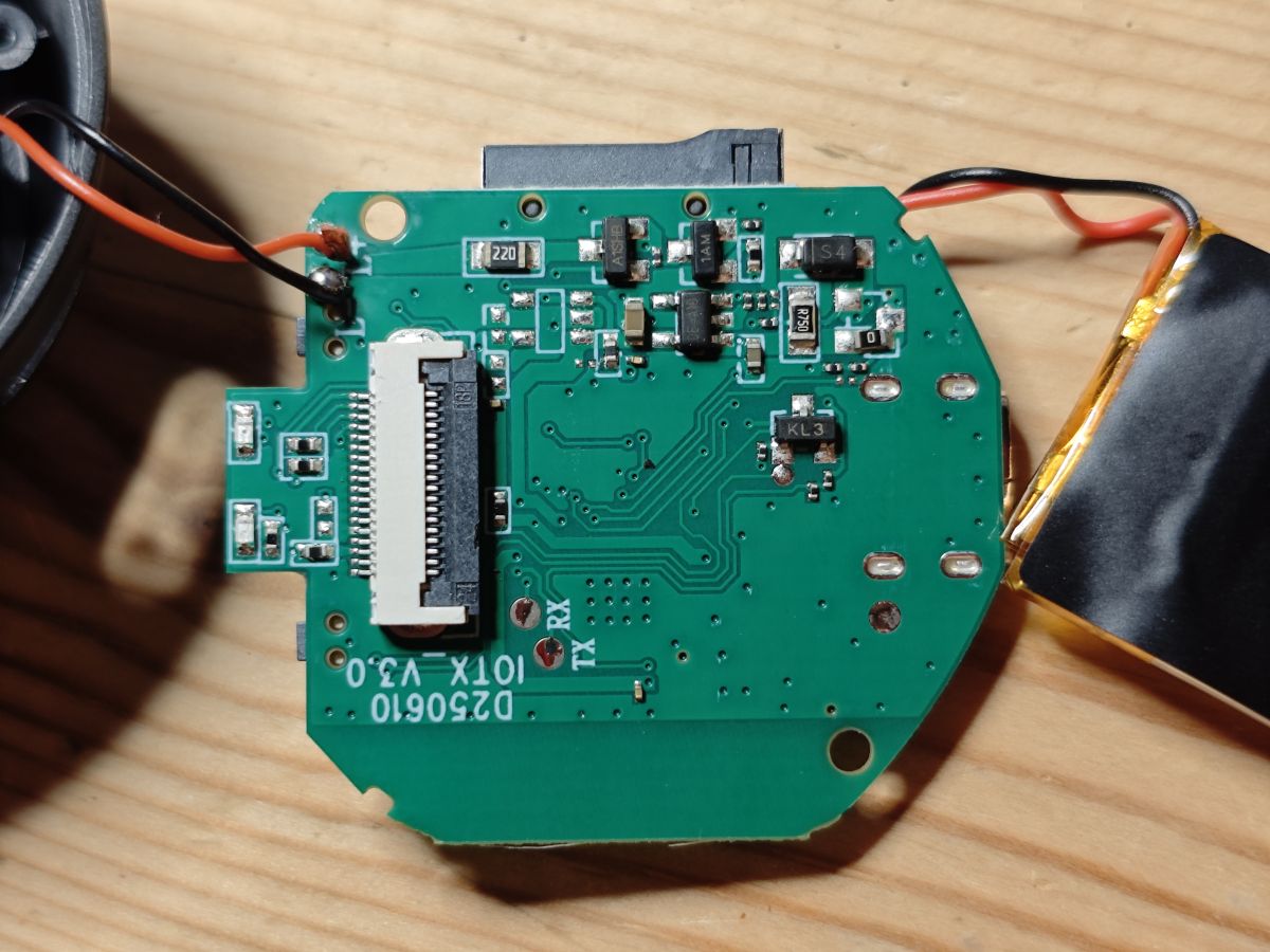

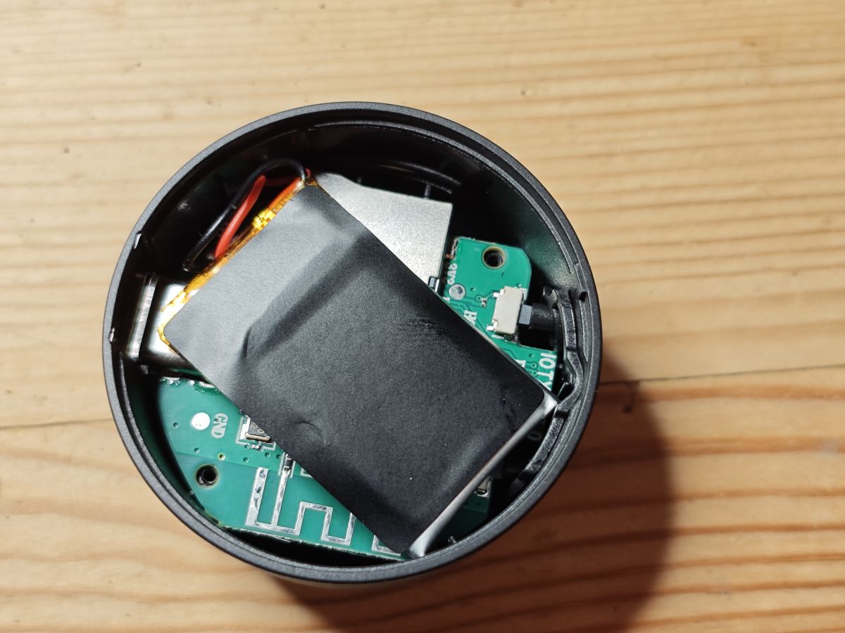

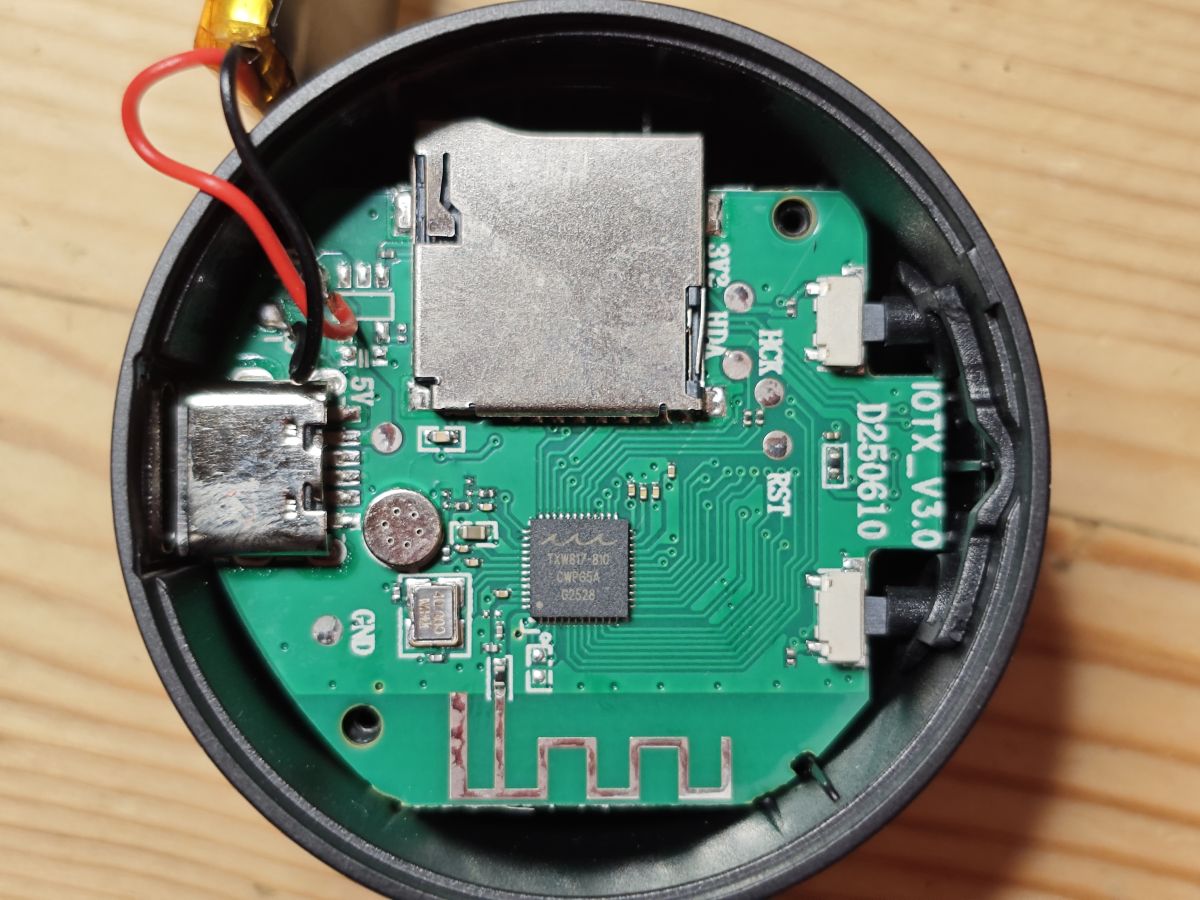

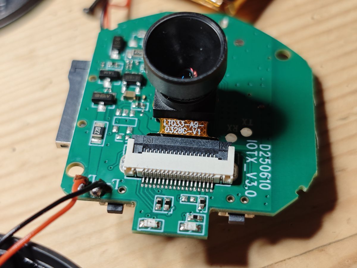

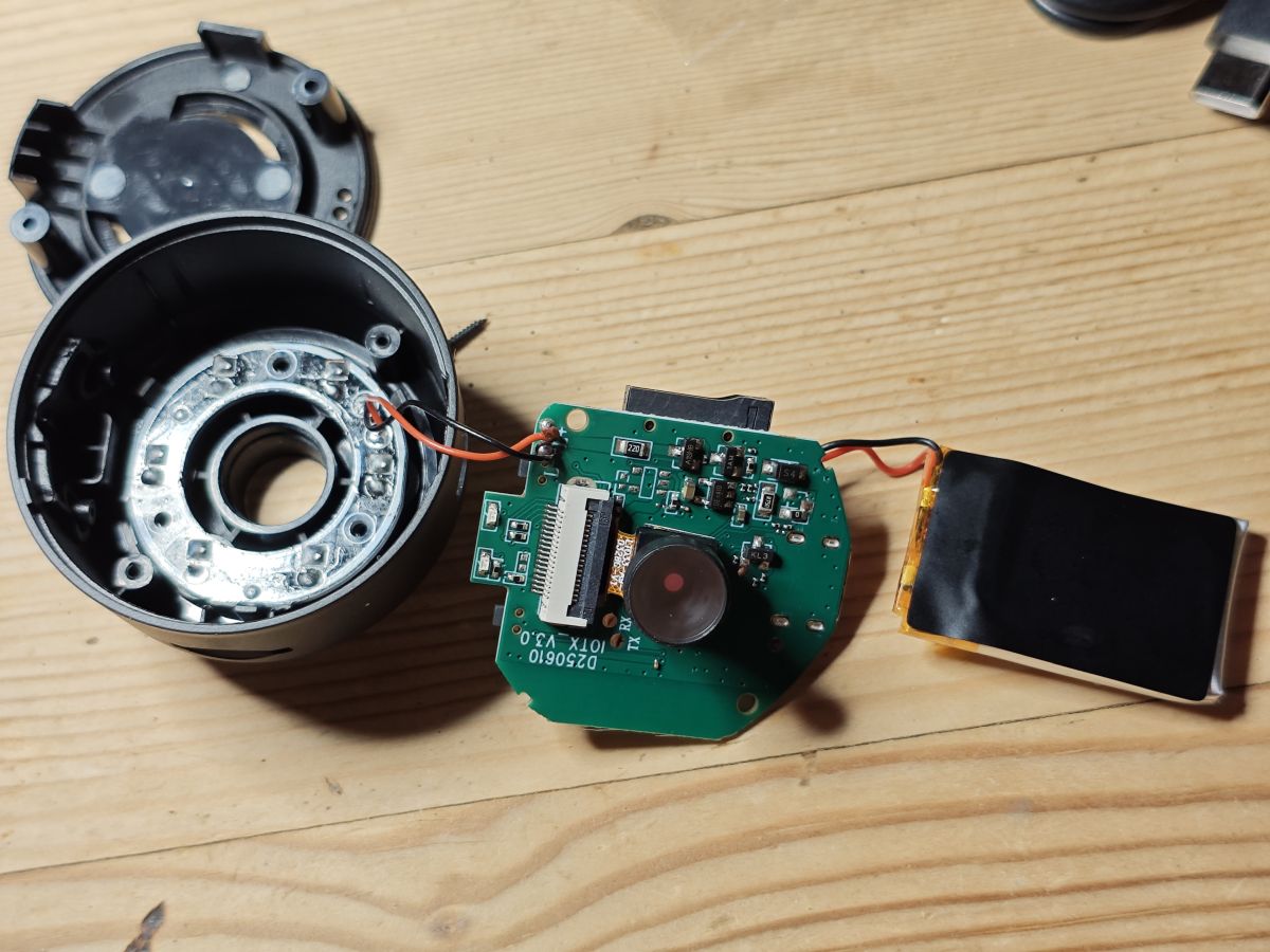

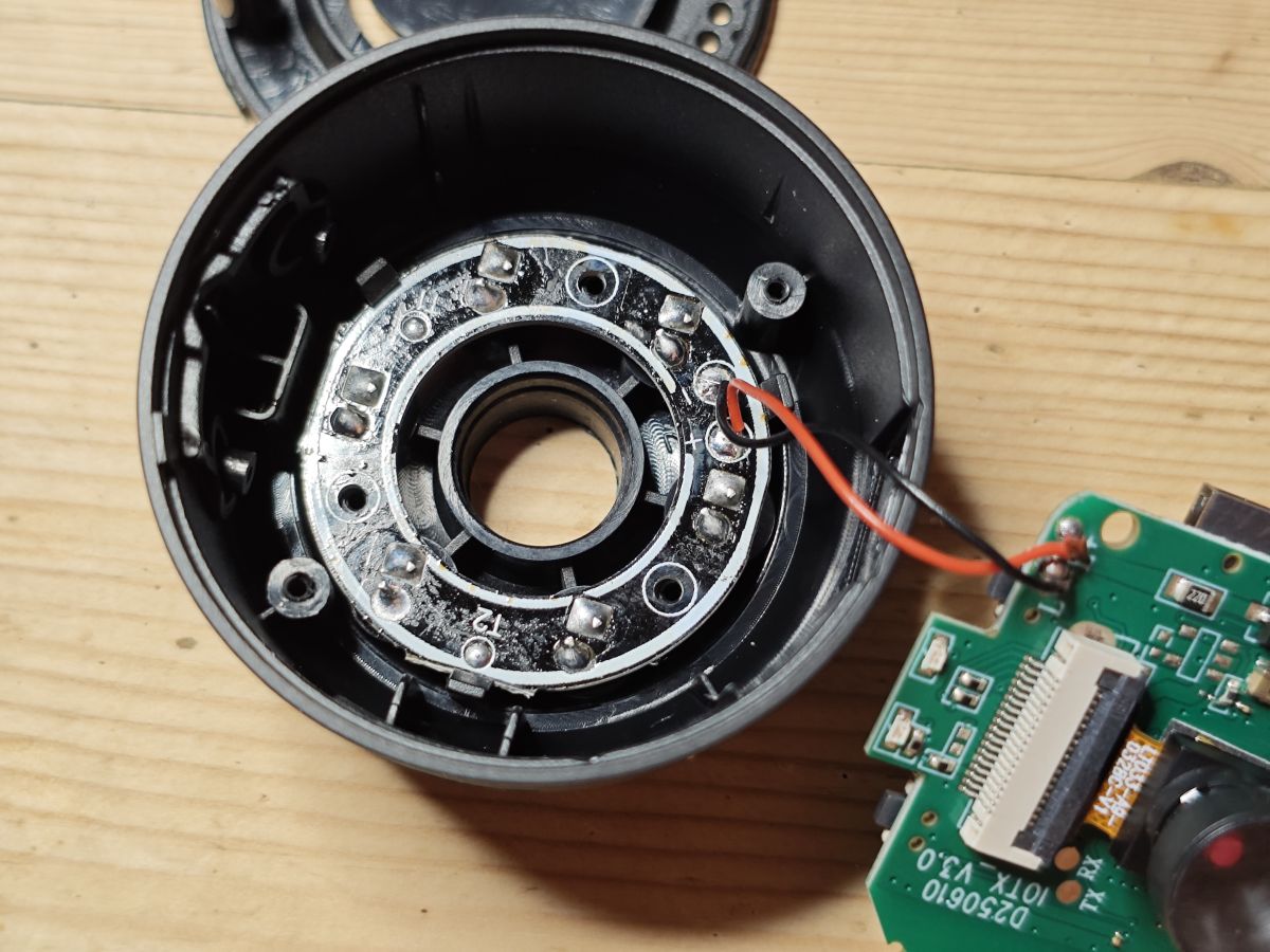

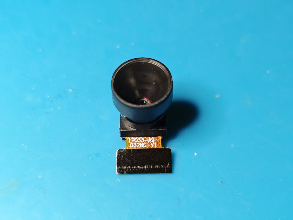

    GalaxyCore GC0328C 640x480 sensor
    at 115200 baud from RX pad
    As with this X5, RST pad = PA10 and HCK = PA9.

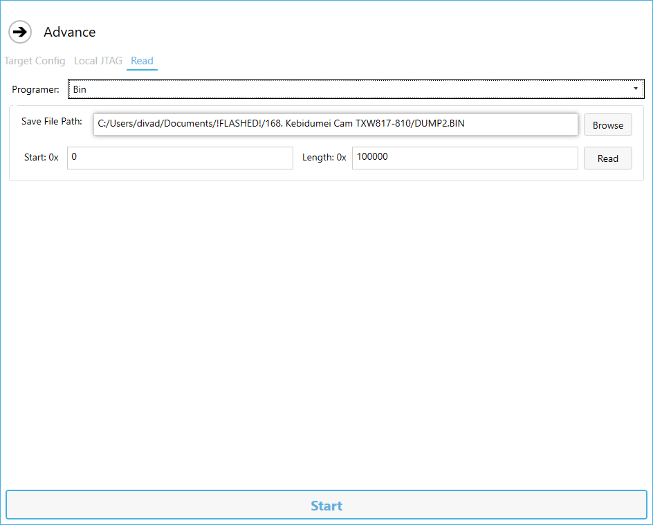

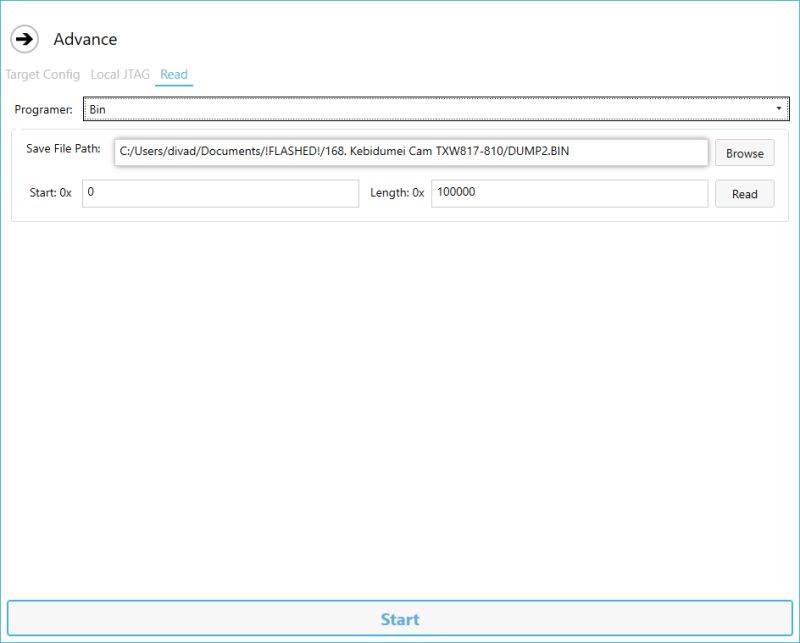

    Dump with C-SKY Programmer and converted STM32 Blue Pill.
    STM32TXW817PCB Pad
    A1PA10RST
    A5PA9HCK
    Development board with jumper wires connected to a green PCB with microUSB port
    Memory reading tool screen showing BIN file path and read range configuration

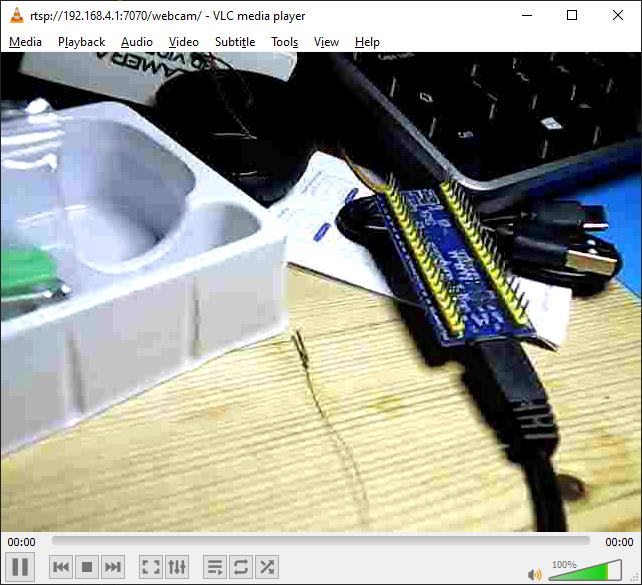

    OpenTXW81X flashed. GC0328C detect automatically on run of 'txwcam' driver
    SDK-default of PC02 for sensor SCL and PC03 for SDA.
    startdriver i2c + scani2c soft (with SoftSDA/SoftSCL assigned):
    RTSP

    Factory firmware dump: https://github.com/openshwprojects/FlashDumps/pull/46
  • Identified pairing AP and firmware version on green PCB variant

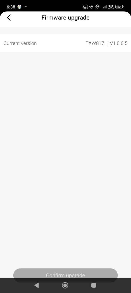

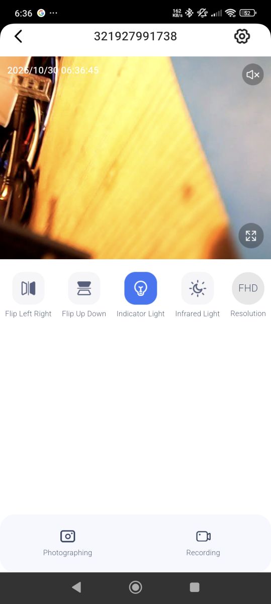

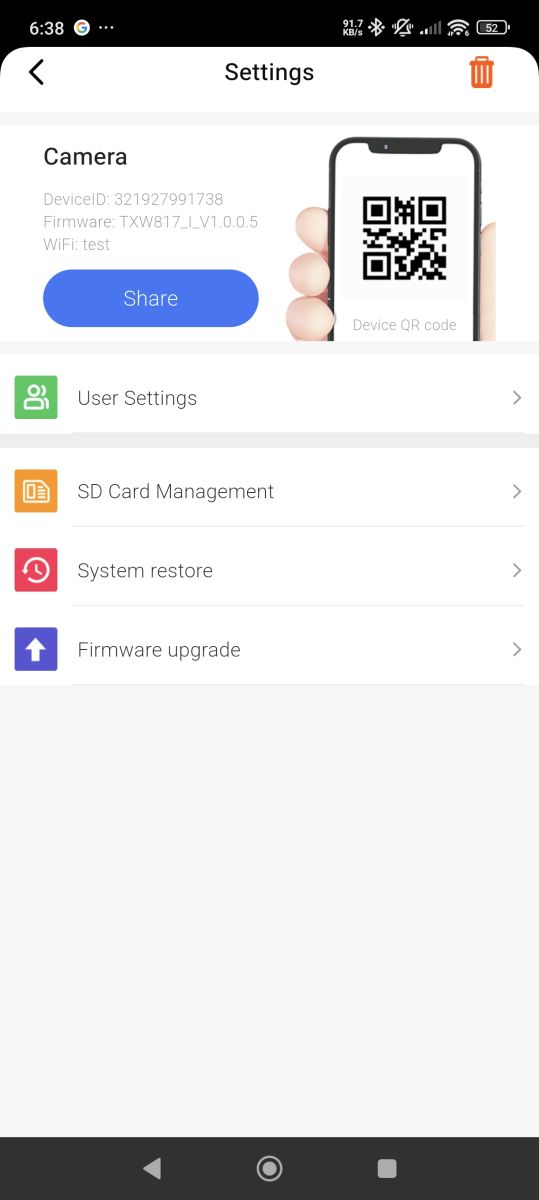

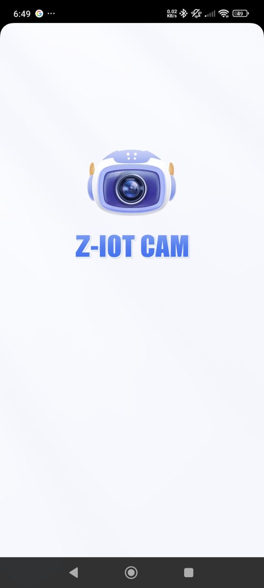

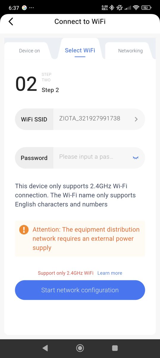

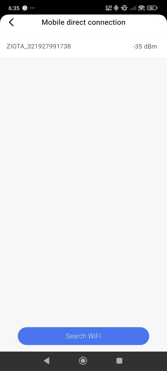

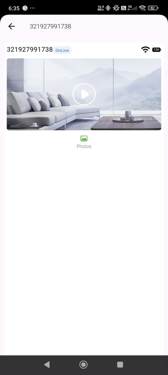

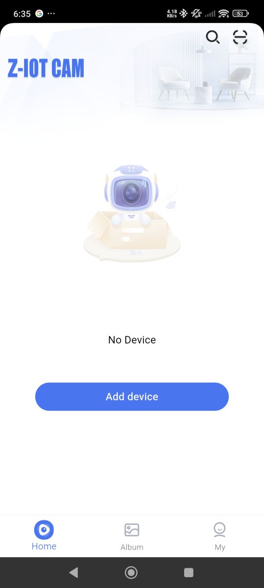

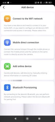

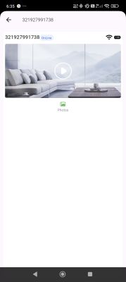

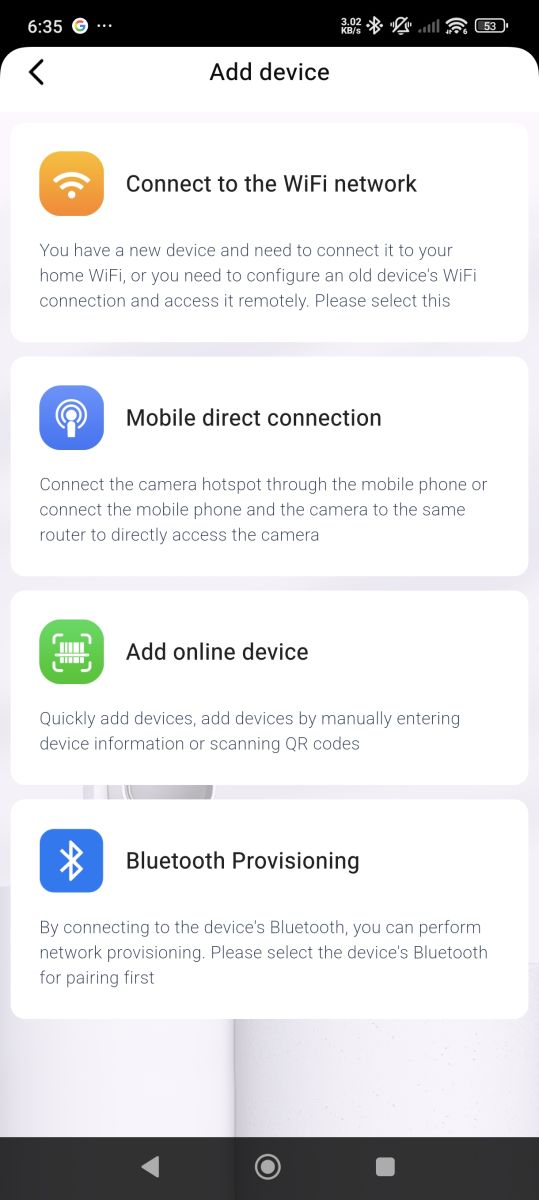

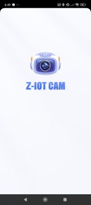

    Z-IOT CAM app https://play.google.com/store/apps/details?id=com.flu.flutter_wifi_camera
    in pairing mode device broadcasts AP "ZIOTA_321927991738" which the phone should be joined to.

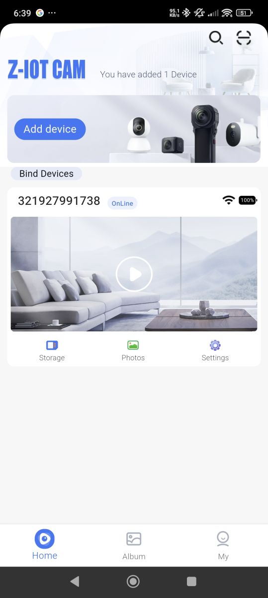

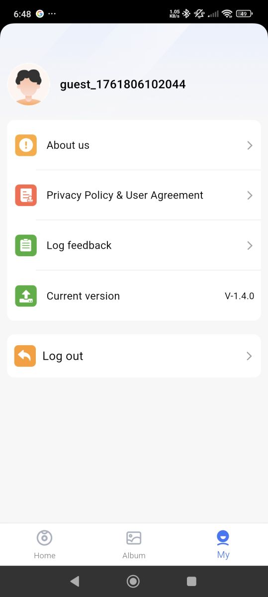

    Z-IOT CAM app splash screen with stylized camera icon Z-IOT CAM app screen showing No Device message and Add device button App screen showing options to add a device via WiFi, direct, online, or Bluetooth Wi-Fi configuration screen showing SSID input and password field App screen showing Wi-Fi named ZIOTA with signal strength of -35 dBm Screenshot of an app showing a camera view of a modern living room Distorted camera view showing wires and a wooden surface. Camera settings screen with QR code sharing and system management options visible. Firmware update screen showing current version TXW817_I_V1.0.0.5 Camera app interface with bright light in the preview image Z-IOT CAM app screen with one online device and a camera preview of a living room. Guest user profile screen in a mobile app showing settings options

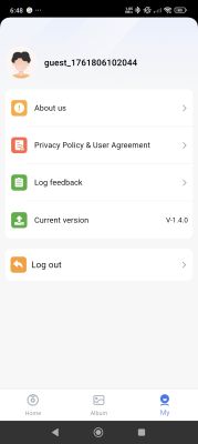

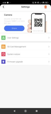

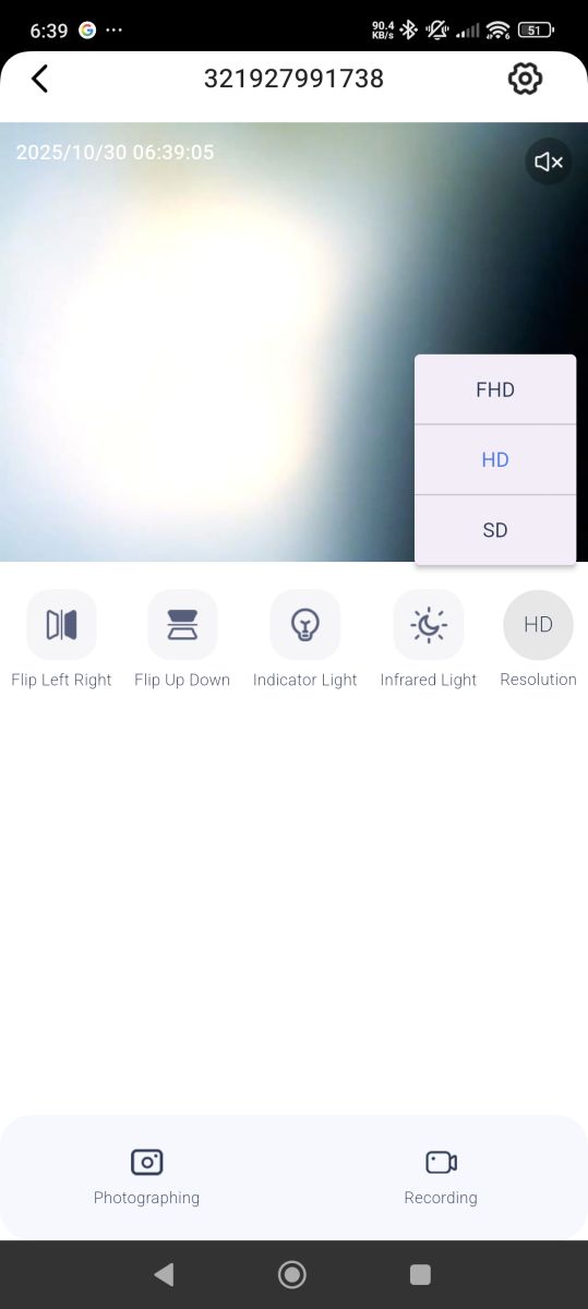

    after pairing with home wifi the "Firmware Upgrade" menu is visible in settings. No updates available for mine. Version currently TXW817_I_1.0.0.5

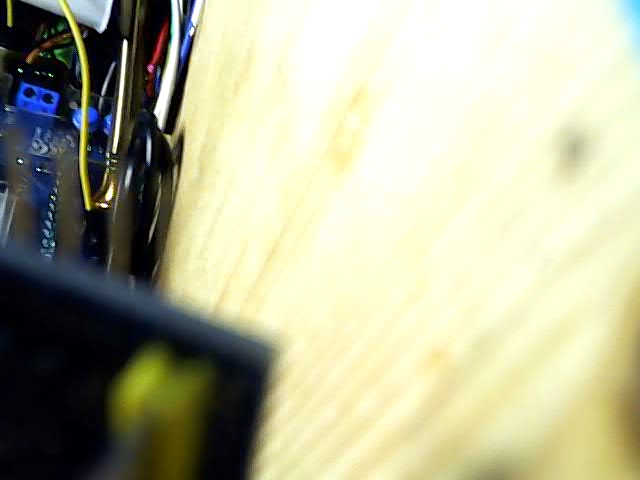

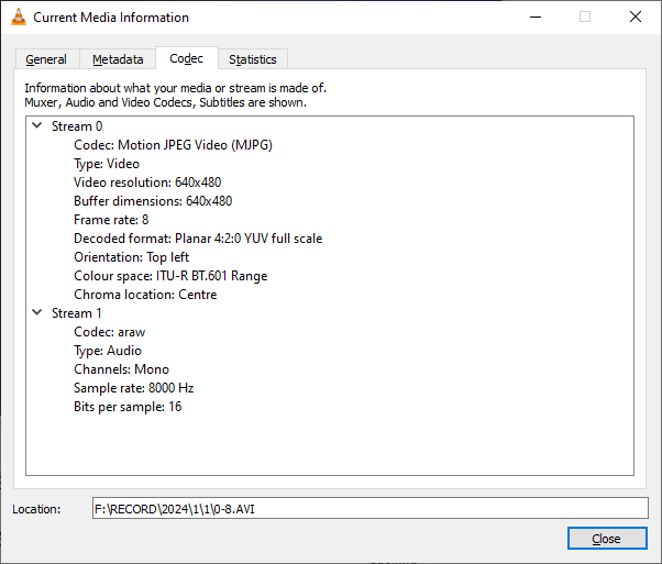

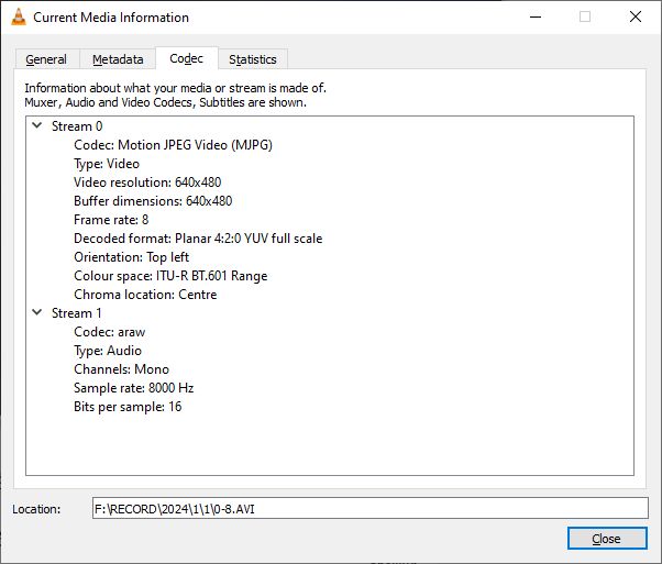

    recording video to SD card
    VLC window showing codec information for an AVI video file
    sample pic and vid attached
    PCB is actually a version of this other Z-IOT CAM device Z-IOT IOT_V1.2 D250609 A9 Cam - Blue PCB with SuperPix SP0828 Sensor, Taixin TXW817 but with different silkscreen markings and a green PCB. Different fw version.
