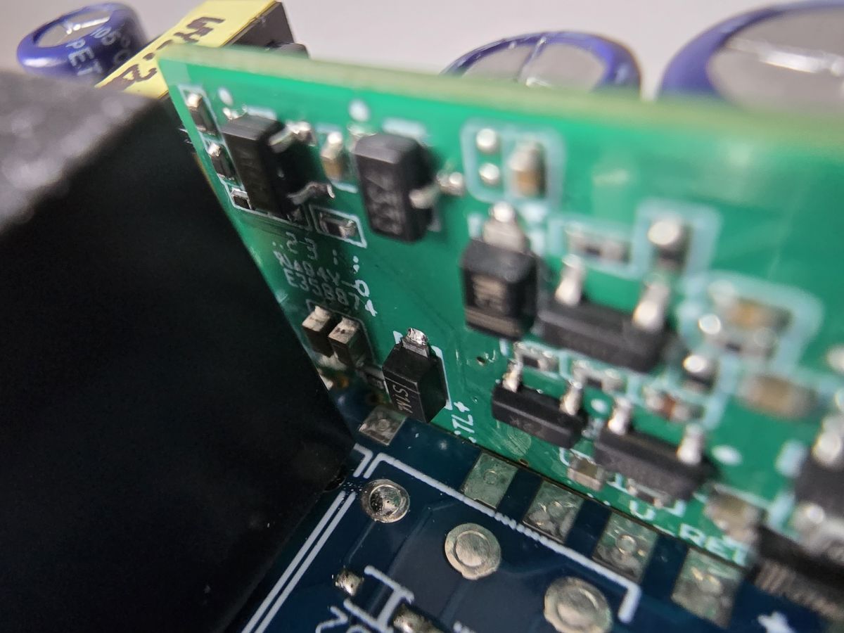

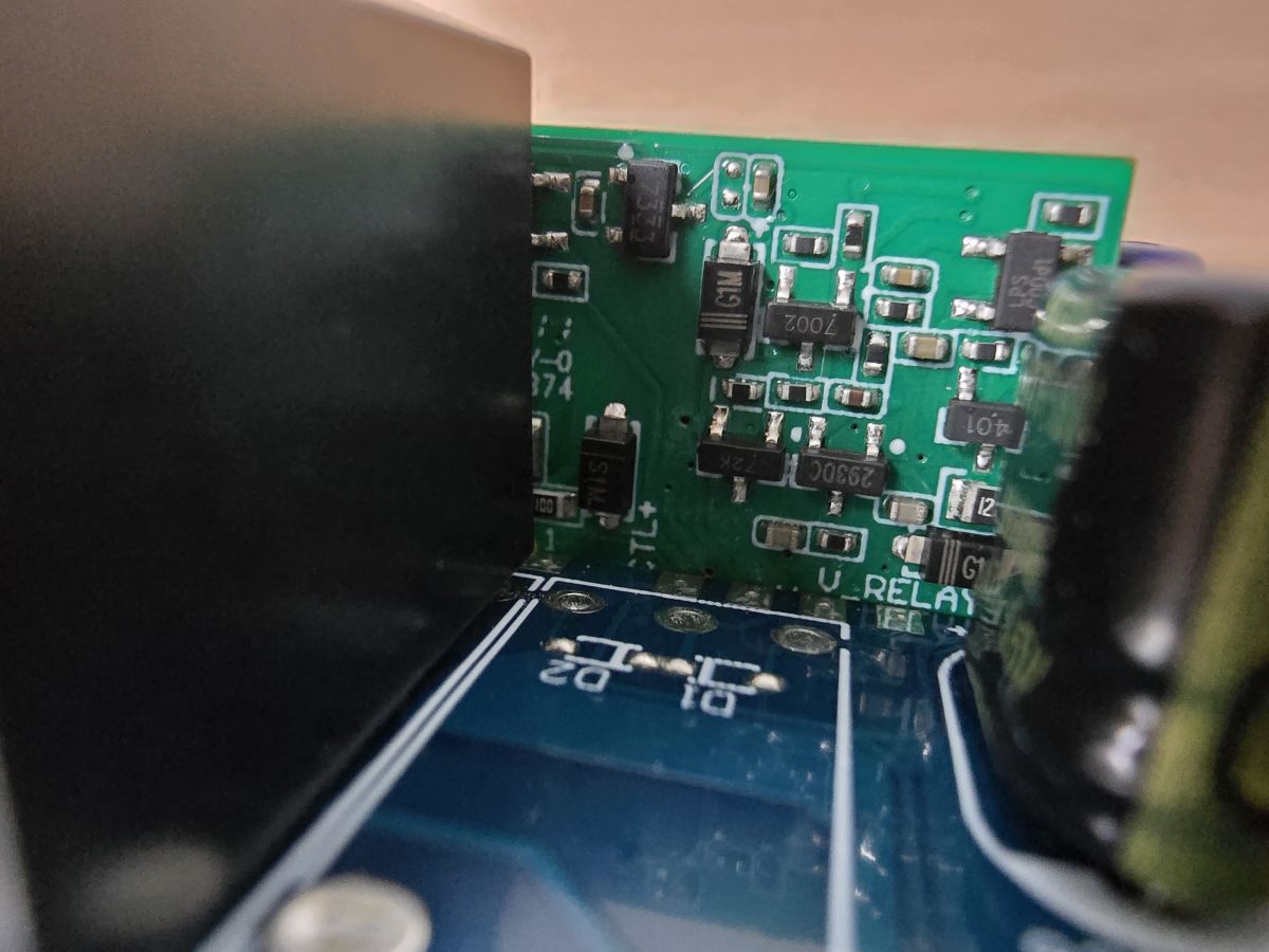

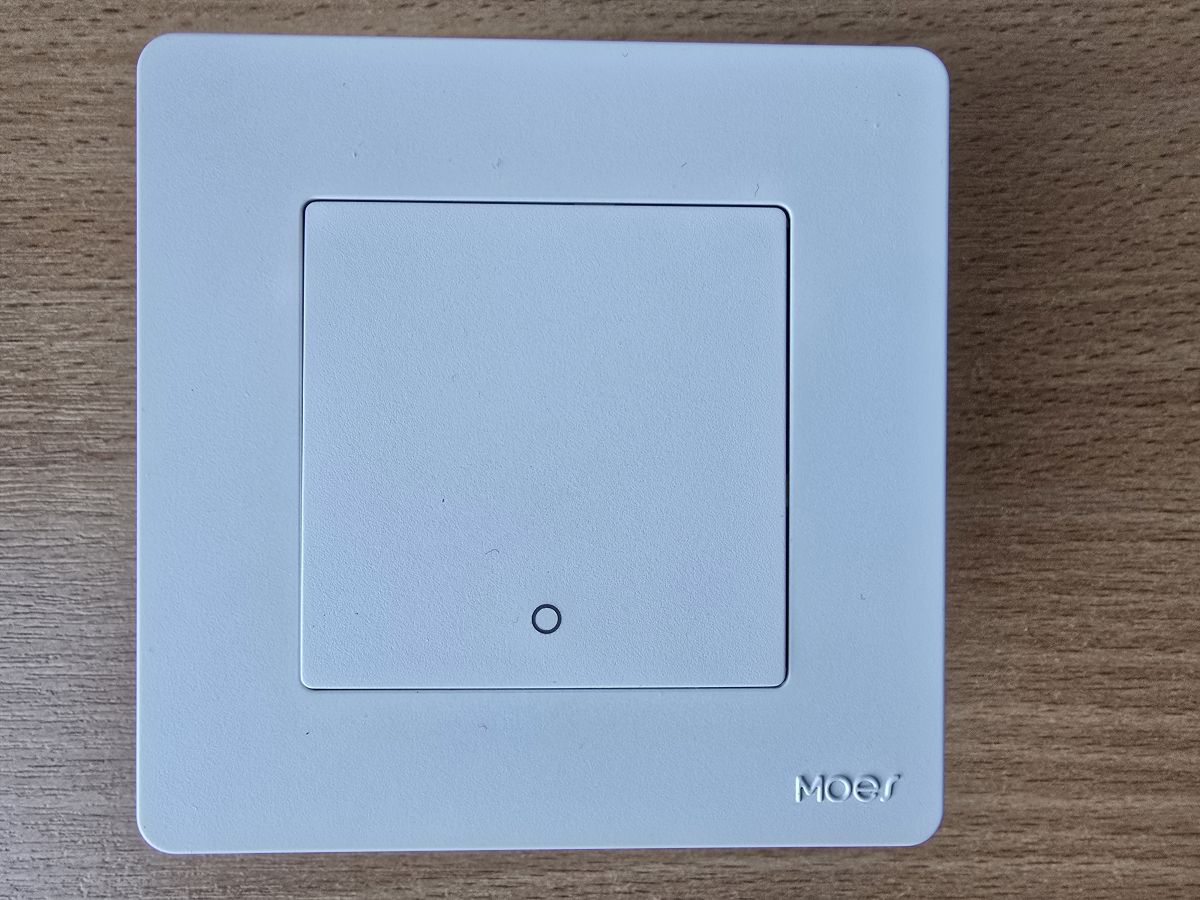

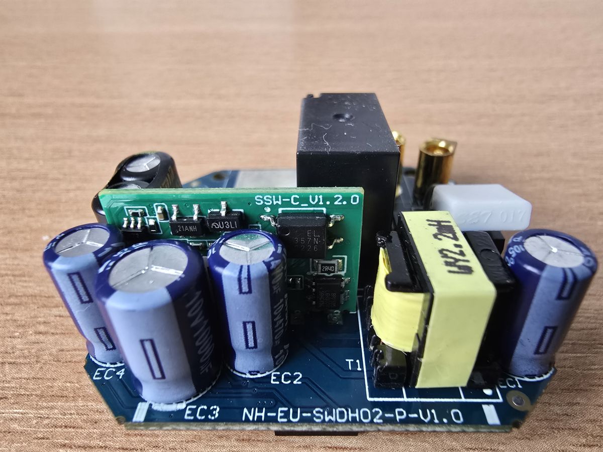

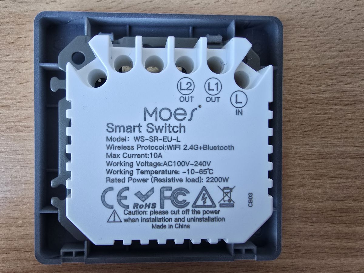

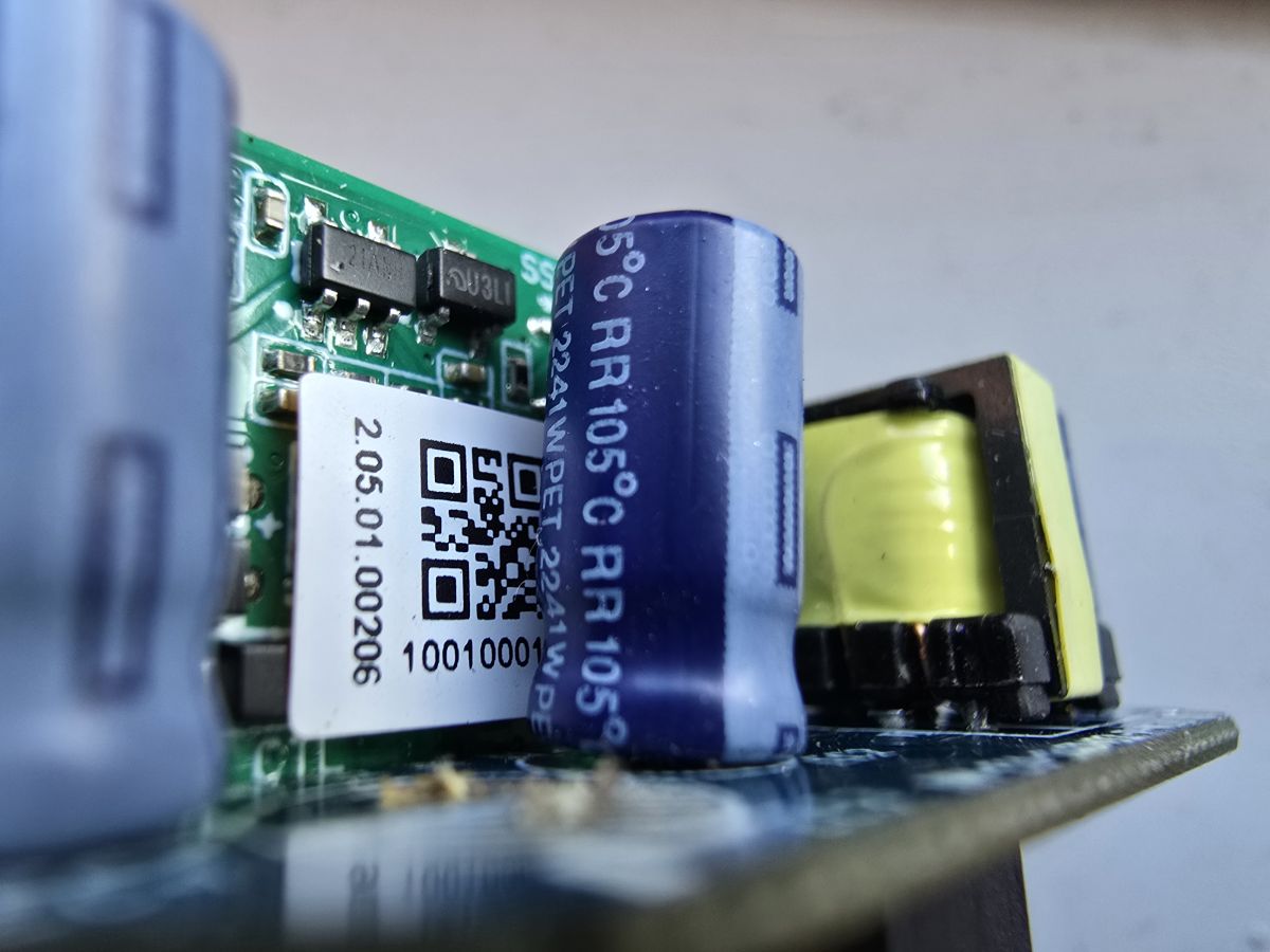

    I bought MOES Wi-Fi light switch from AliExpress (https://aliexpress.com/item/1005008574435831.html). But I'm not sure what chip it has.
    Model: WS-SR-EU-L
    White, square light switch on a wooden surface. Moes smart switch with technical specifications. Printed circuit board with various components on a wooden surface. A printed circuit board with various electronic components. Close-up of an electronic module with visible PCBs and SMD components. Close-up of an electronic circuit with components on a printed circuit board.
    Can anyone please help me to identify chip? Is this chip supported by OpenBK7231T_App (https://github.com/openshwprojects/OpenBK7231T_App)
    I cannot find anything similar in the elektroda.com forum. Any help or link to any documentation or article will be helpful.

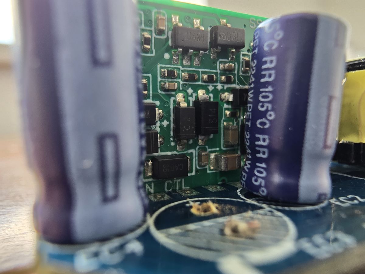

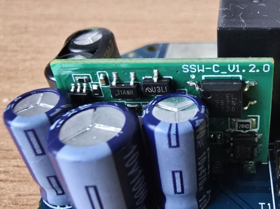

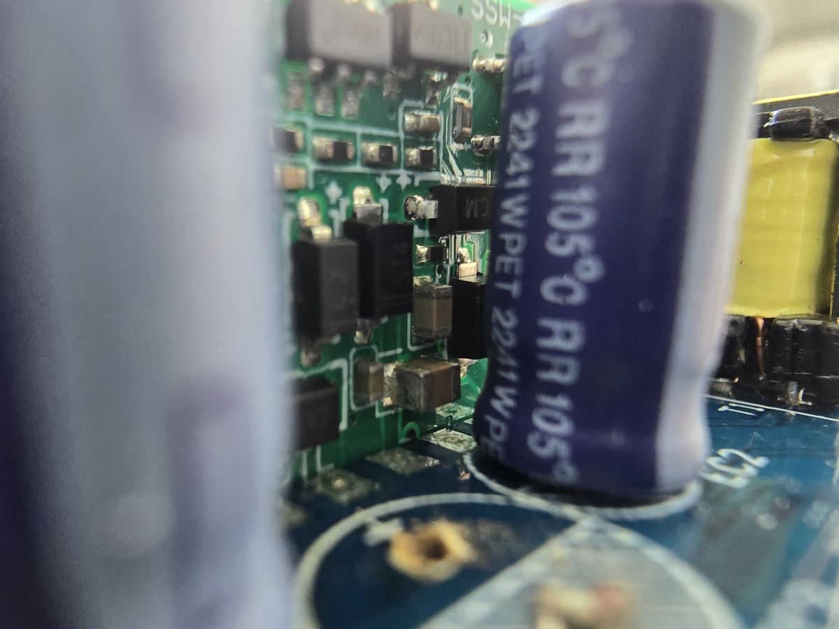

    Can't say I recognise that module, nor can I find reference to it anywhere else. Are you able to spy anything beyond those capacitors?
    Circuit board with capacitors and integrated circuits
    Are you planning on removing the module for a better look?

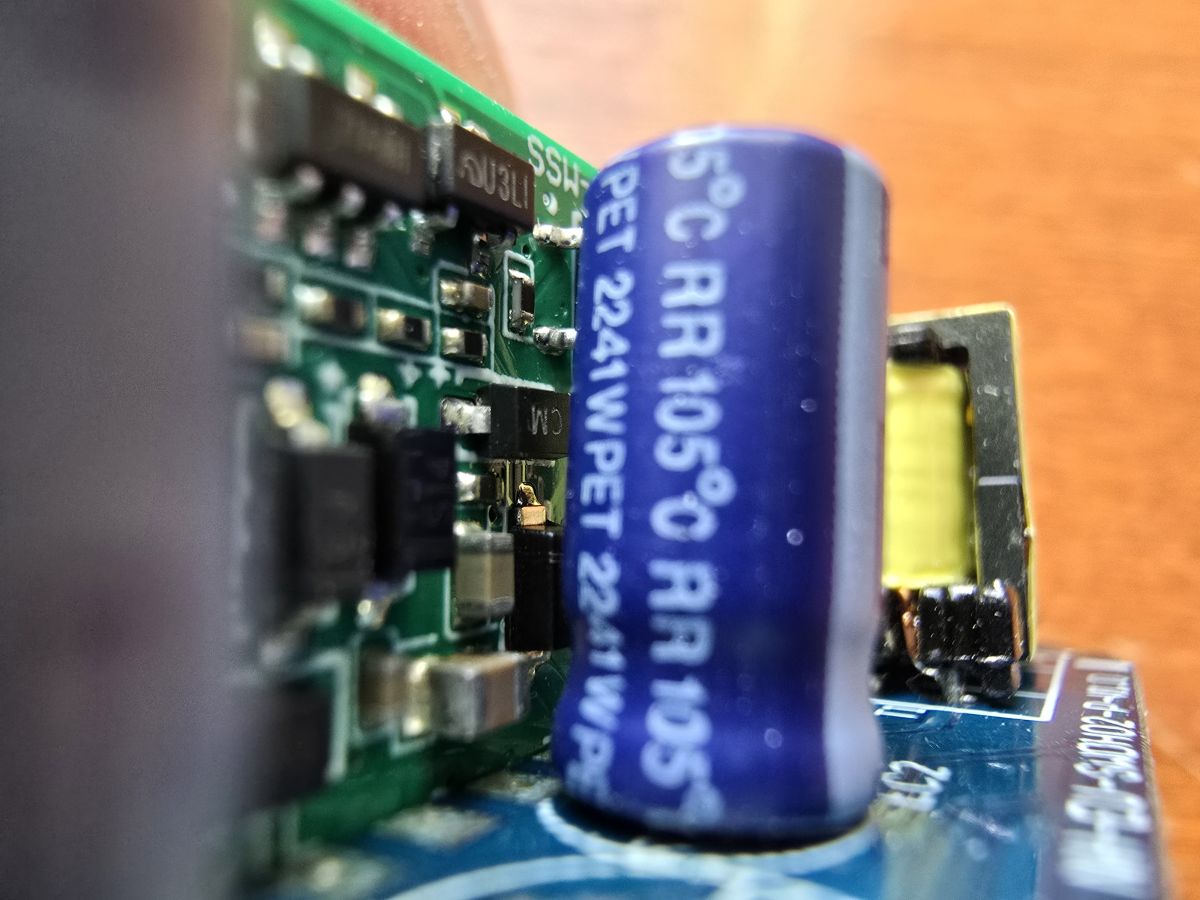

  • #3 21509162
    viuvasas
    Posts: 6
    I unsoldered one capacitor.
    Close-up of a circuit board with an unsoldered capacitor.Close-up of a circuit board with visible capacitors and electronic components.

    Please remove the QR code sticker to reveal main chip

    I removed the QR code sticker.

    oh! I was expecting a proper MCU behind there. um.
    Added after 3 [minutes]:
    I'm confused. Where's the MCU? What's doing wifi and broadcasting for app pairing? Did you confirm it discoverable before taking it apart?

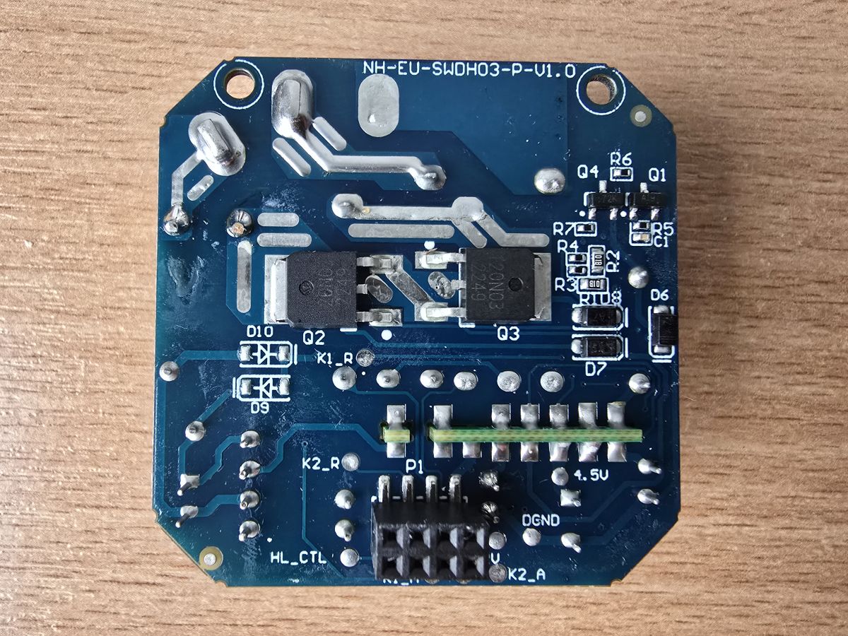

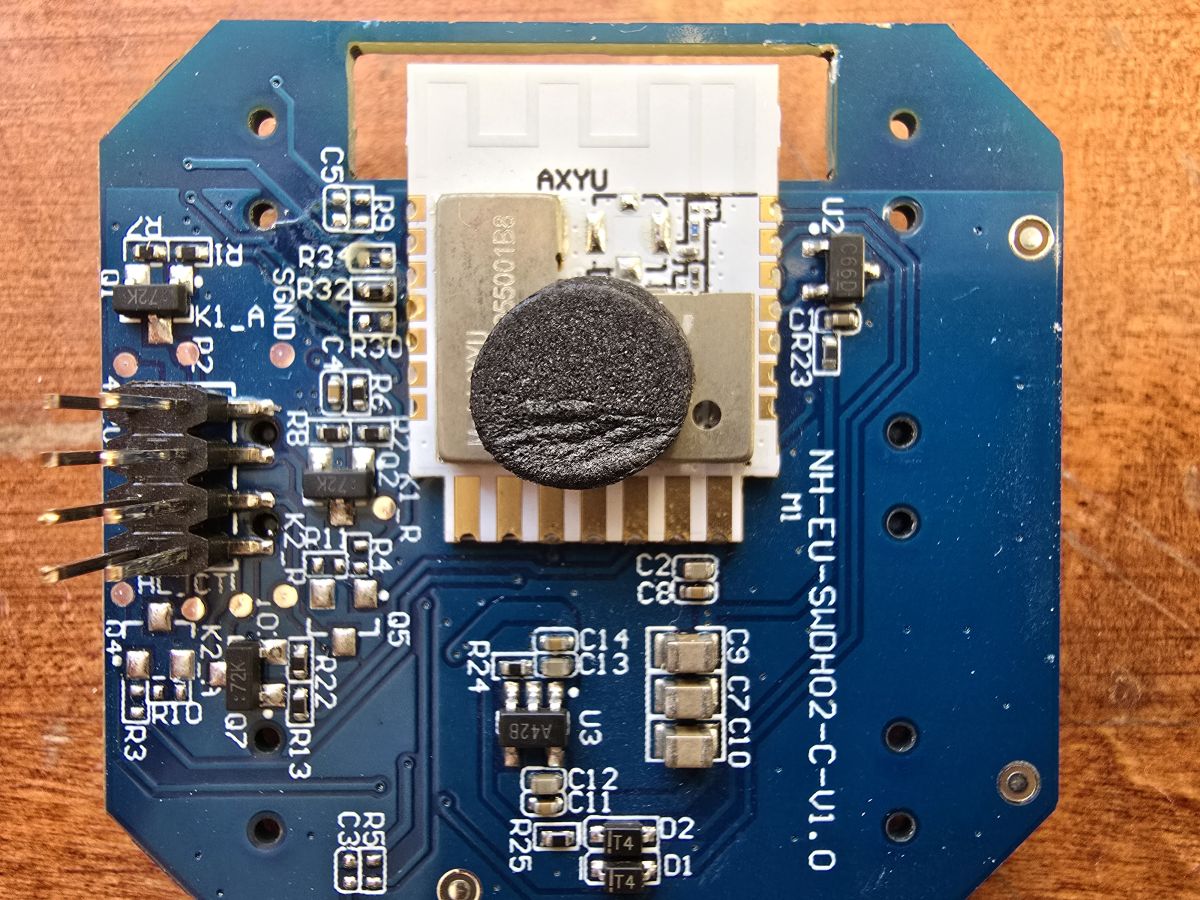

  • #7 21509286
    miegapele
    Posts: 173
    Help: 15
    Rate: 29
    Wifi chip is usually on the pcb which connects to that 8 pin header. Please show that one.

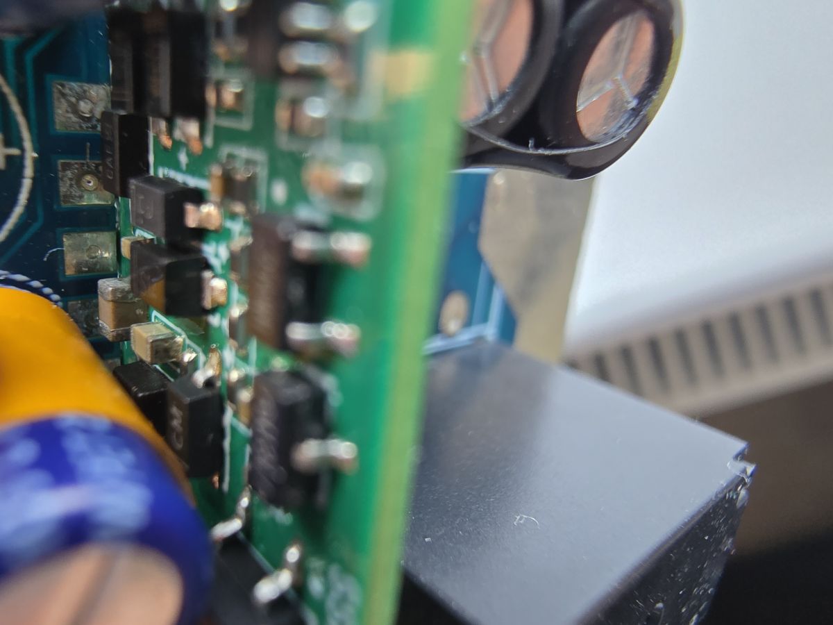

  • #8 21509328
    viuvasas
    Posts: 6
    Finally, I found a Wi-Fi chip. It is AXYU. As I understand, it is supported by OpenBK7231T_App?

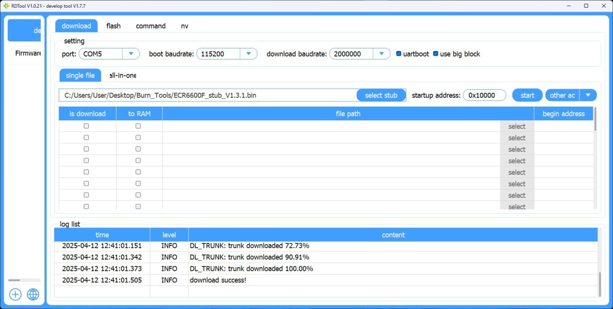

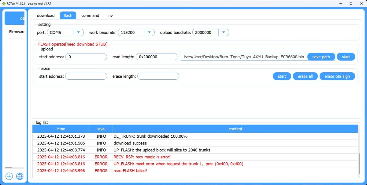

    I have problems to back up the firmware using guide (https://www.elektroda.com/rtvforum/topic4111822.html). The 'download' step is success. However, during 'flash' step I'm getting error:
    RECV_RSP: recv magic is error!
    UP_FLASH: meet error when request the trunk 1, pos: (0x400, 0x400)
    read FLASH failed!
    I tried to set read length of 0x400000 and 0x200000. The same error.

  • #11 21516807
    Posts: 5220
    Help: 449
    Rate: 918
    Not sure I've encountered this error before. Tried standard things like lowering baud? Are your wires short and soldered?
  • #12 21517418
    viuvasas
    Posts: 6
    I attempted to re-solder the RX and TX wires, but ran into issues during the 'flash' step while trying to back up the firmware. So, I decided to skip the backup and proceed with flashing the OpenECR6600 firmware instead. The flashing was successful, and I was able to connect to the Wi-Fi network. Next, I'll work on configuring the pins.
