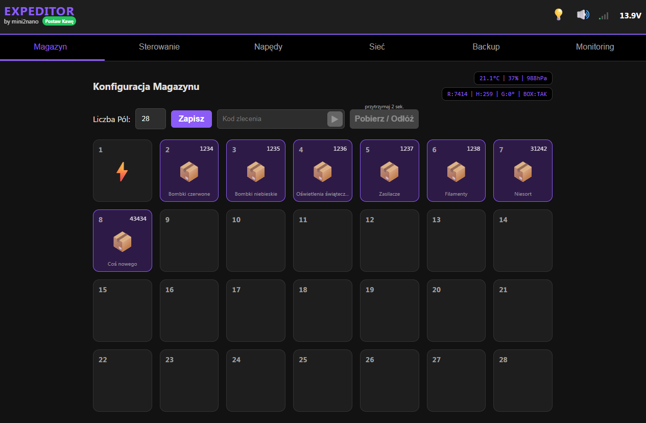

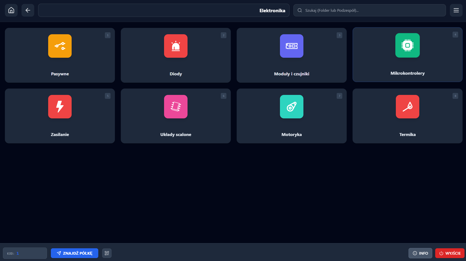

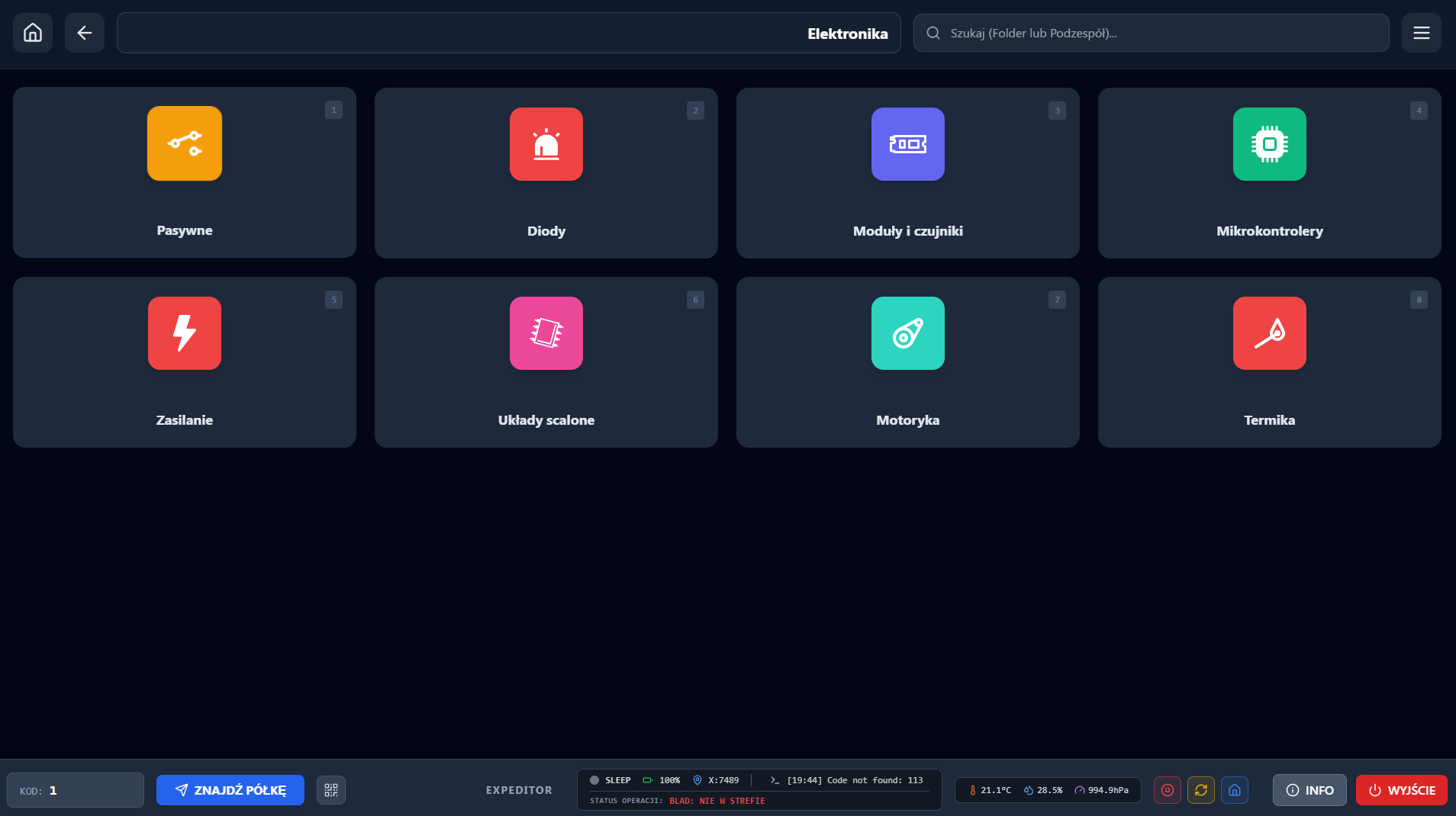

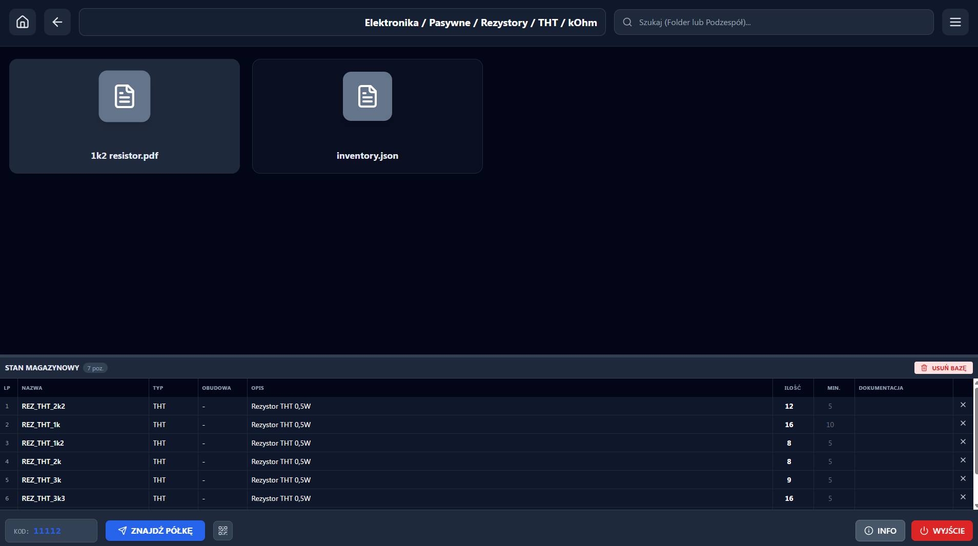

    After much agonising, I can finally say that the next version of the programme made available on my disk V1.5.0 has been successfully created.
    https://drive.google.com/drive/folders/1hnoxh2GpS30uNQiNsFQavRU_DW0FagfV?usp=sharing
    DIY Kiosk - how to build your own electronics storage for components?
    Key changes include:
    -Adding the possibility to build databases in each directory.
    -Creating a database is done by right-clicking on an empty field of any location.
    -Export of the entire project database to a single file in the database ROOT (.csv)
    -I added the possibility to also search the database in the search field with the location shown (Highlight field).
    -I have added a large collection of project icons and catalogue colours from React Icons.
    -The corresponding location is called up both via the "Find Shelf" button as well as the keyboard key above TAB - i.e. "`".
    -Opening directories with the right-click is as possible.
    -A few minor visual and programmatic improvements have also been added.
    I have not noticed any bugs so far, however I am open to comments...

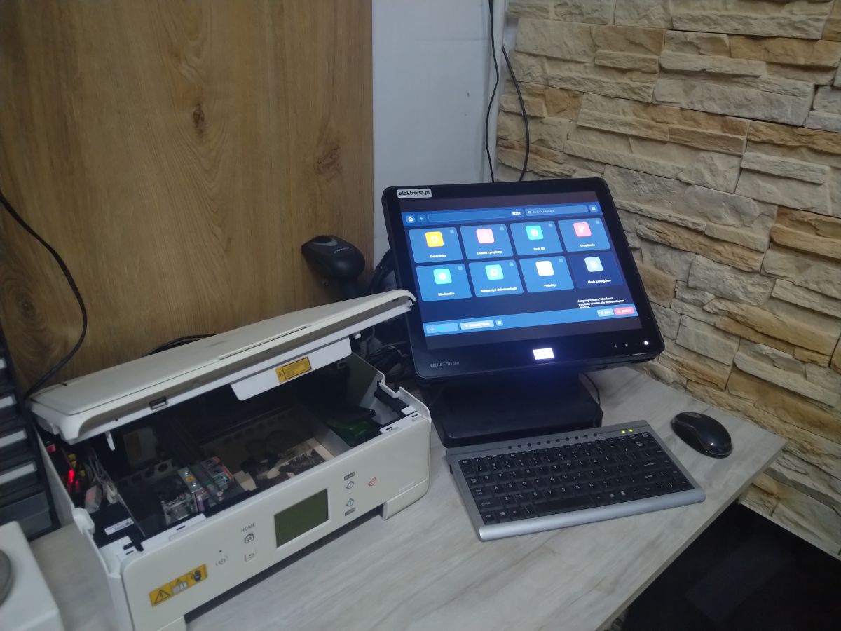

    Touchscreen monitor with running system on a desk next to a modified printer.
    Touchscreen and electronic device mounted on a metal wall.

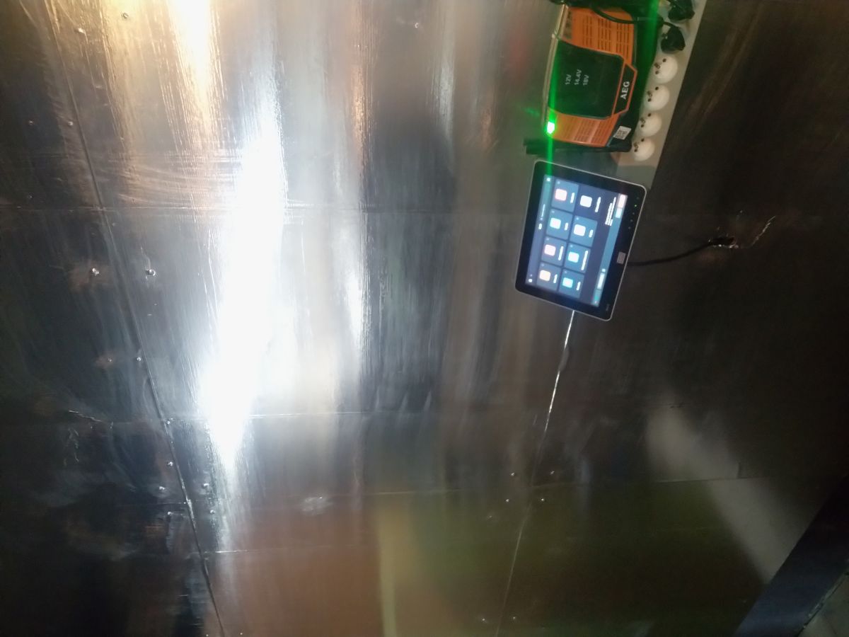

    In the workshop and garage I have a programme running on a computer previously used in catering with two touchscreen monitors which I hauled off for next to nothing. At rest the whole thing consumes about 8W.
    Accessing the network database due to a small .json without images etc. works expressly on all devices in the network location.
    Added after 11 [minutes]:

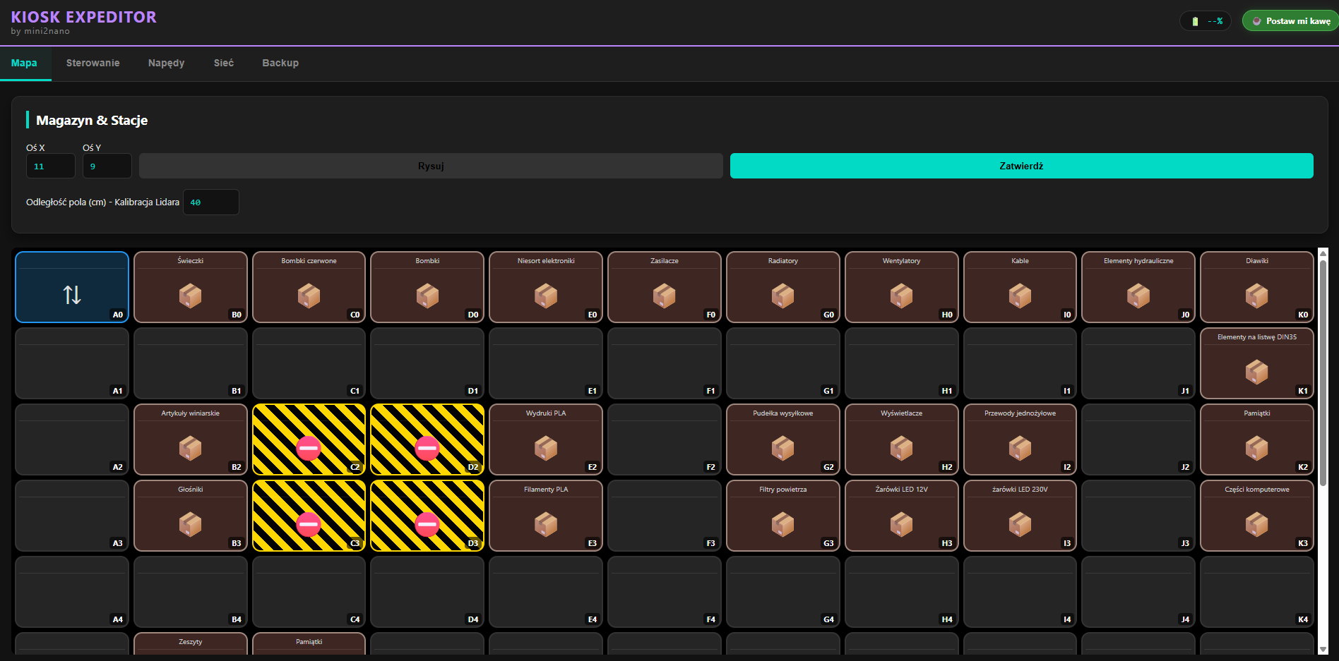

    #41 21818757
    dgproject
    Posts: 183
    Rate: 272
    zdolnyadam wrote:
    And this mode ""Manchattan"" is what it is based on because google.co.uk does not return any meaningful results...?
    Manchattan mode is used to guide the robot along the shortest possible route through empty spaces without infringing on occupied fields in a little shortcut.
    In my case, along the cavity track.
    Warehouse map view with a grid of cells, labeled goods positions, and marked obstacles.
    In my example, the robot is standing on position A0 (top left corner).
    Wanting to retrieve goods from, for example, E3, it will first go one field forward to A1, change direction with the appropriate sequence and go to F1, then F3 and, controlling the safety barrier around it, it will invade the dedicated space, retrieve the box and return to the deposition field.
    A bit convoluted but doable.
    I'm currently struggling with a method of determining position and it's more likely to fall back on a single point lidar looking behind me.(Must look over obstacles on the wall to determine distance)

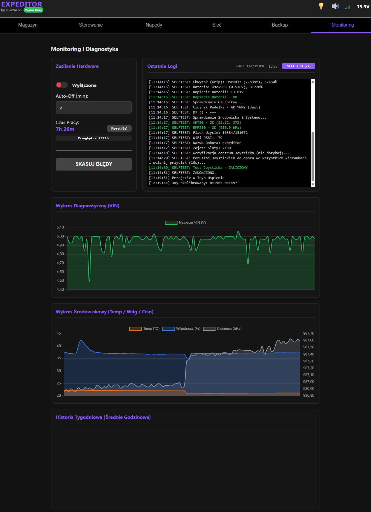

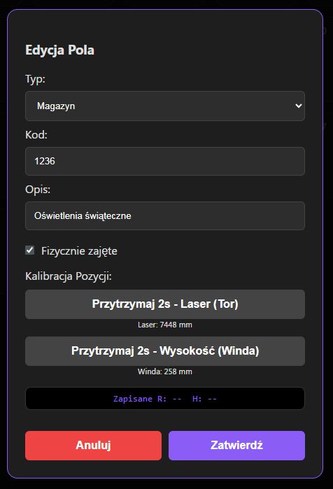

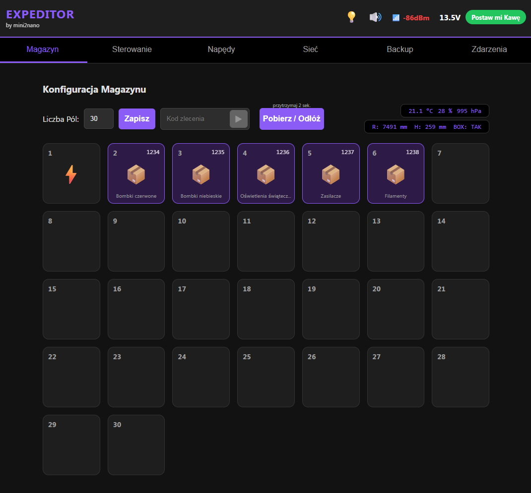

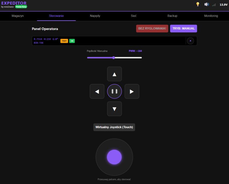

  • AI-assisted kiosk gains robot telemetry and box-color calls

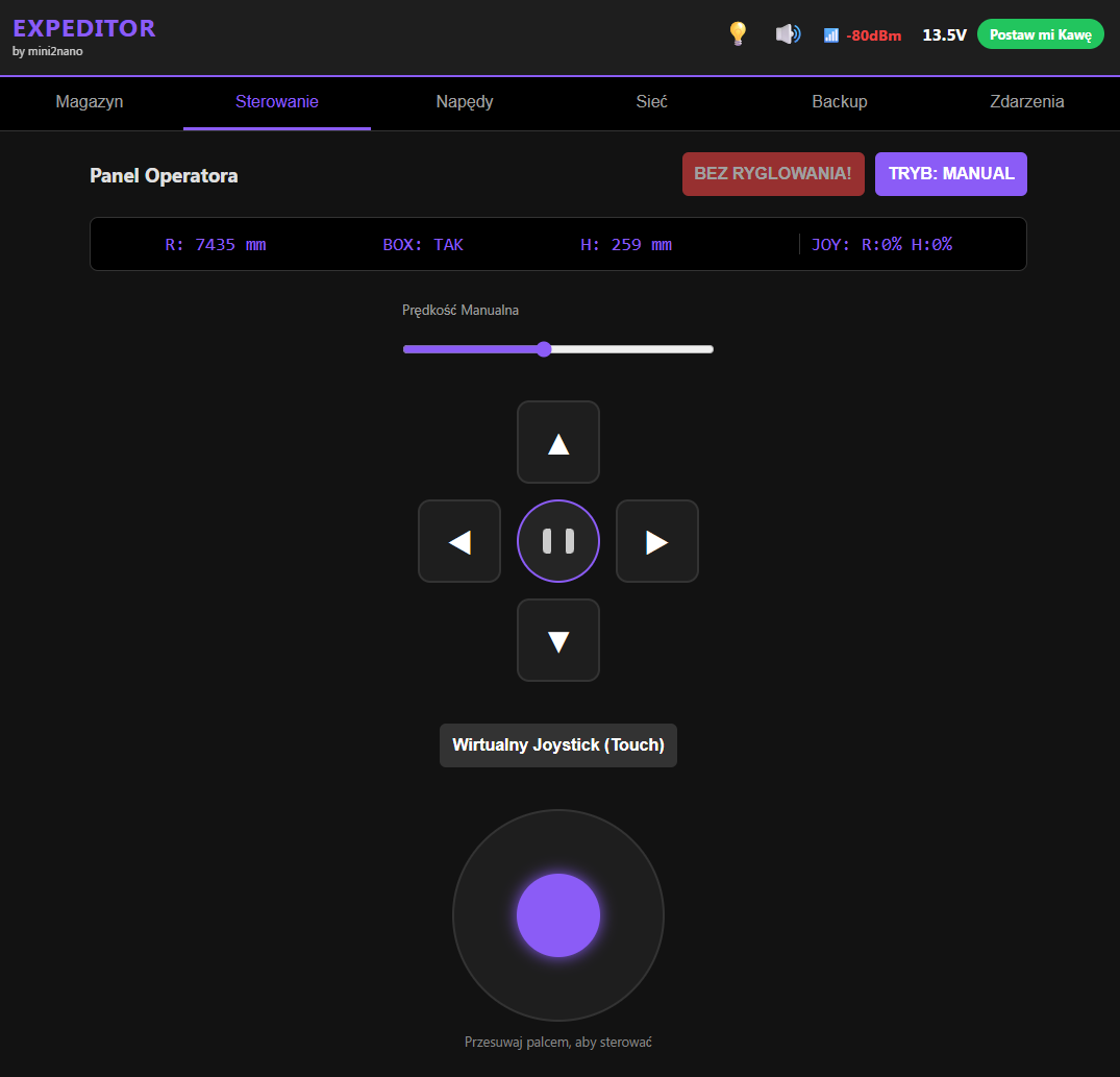

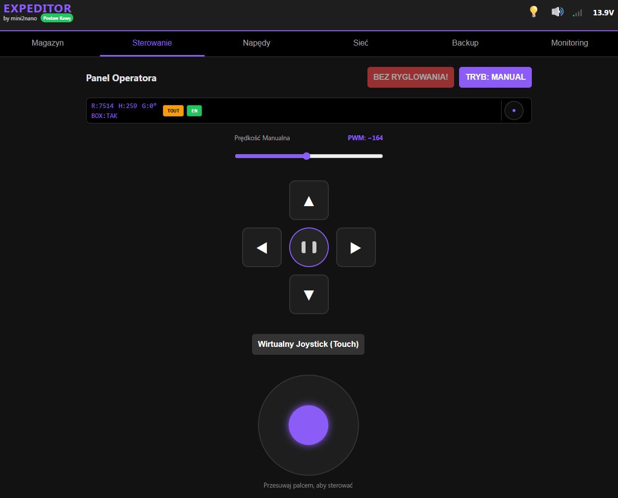

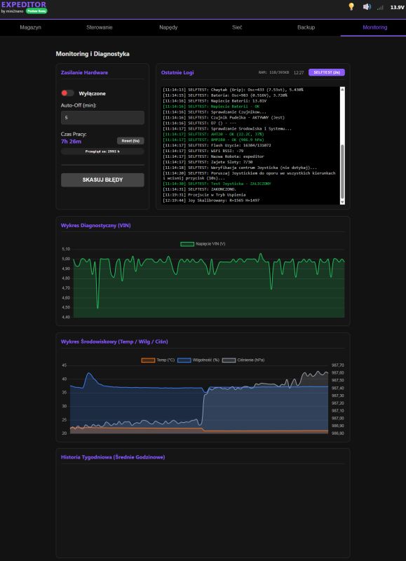

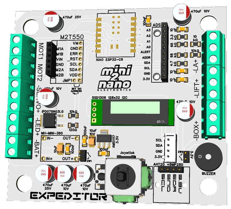

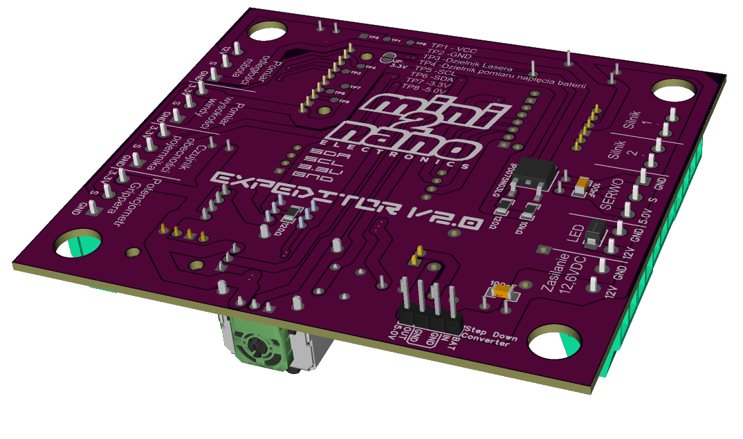

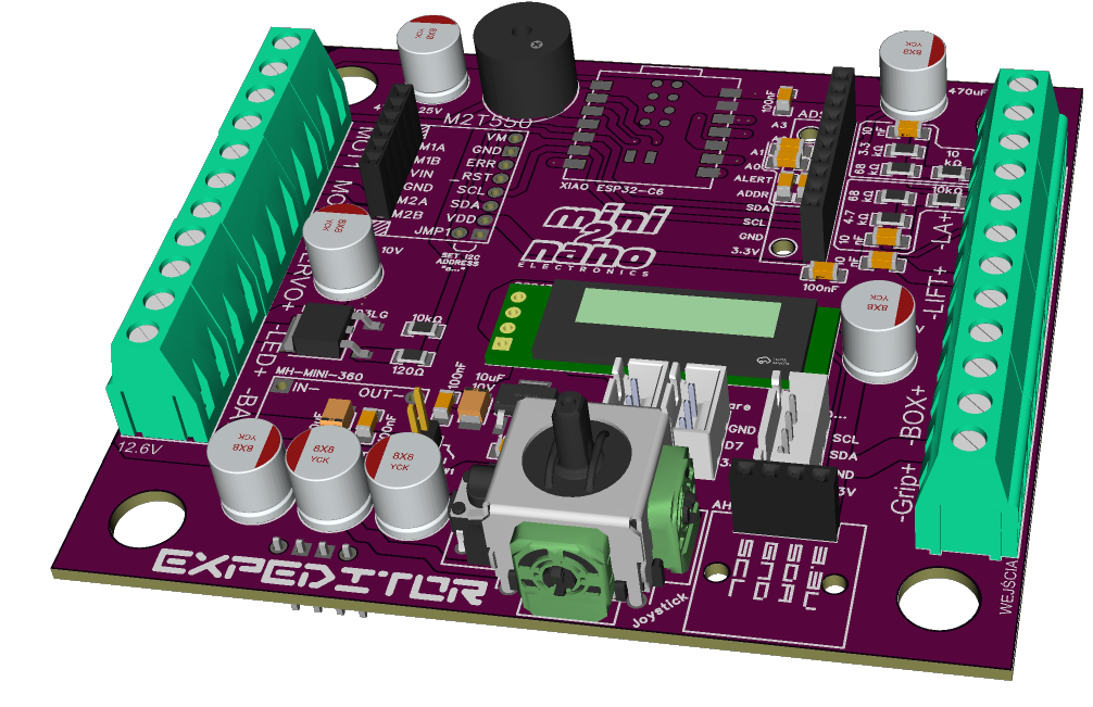

    #43 21828340
    dgproject
    Posts: 183
    Rate: 272

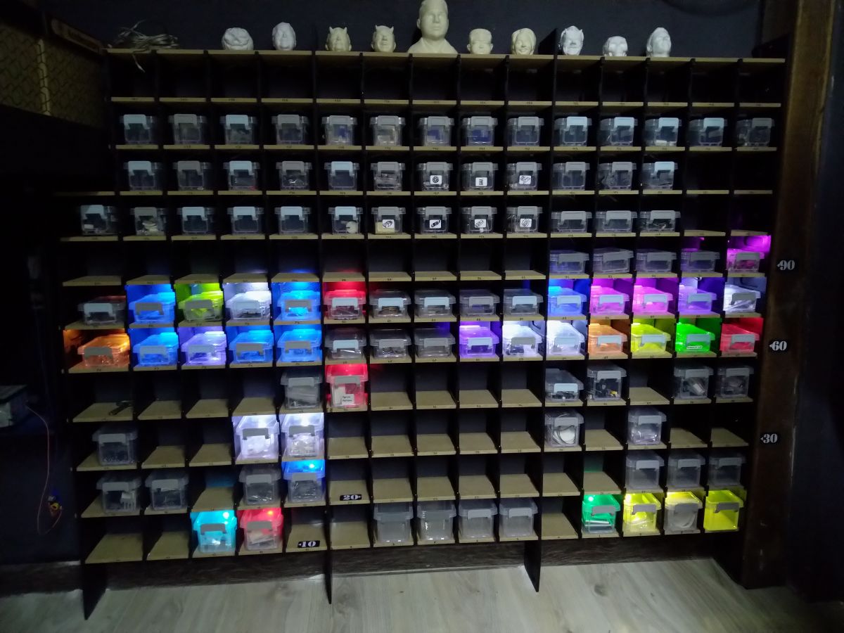

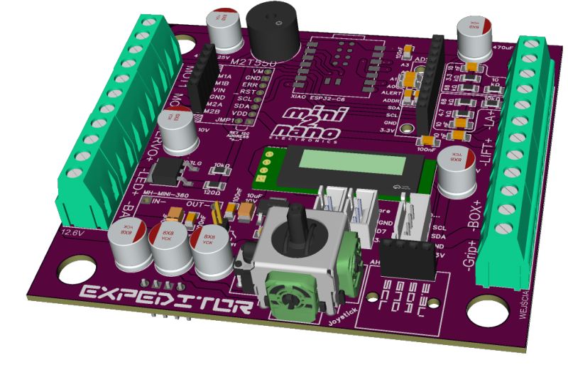

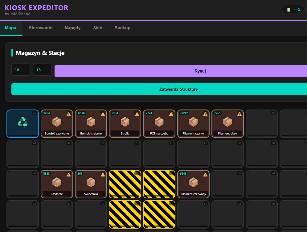

    I decided to follow the spirit of the times and take advantage of the possibilities offered by AI and I will honestly say that I am pleasantly surprised.
    As variety in the design for the shelves I added some screensavers and the design looks good enough for me now.
    I will leave the remaining 25 LEDs to illuminate the Filaments on the shelf next to it.
    Shelf with transparent boxes illuminated by multicolored LED lights

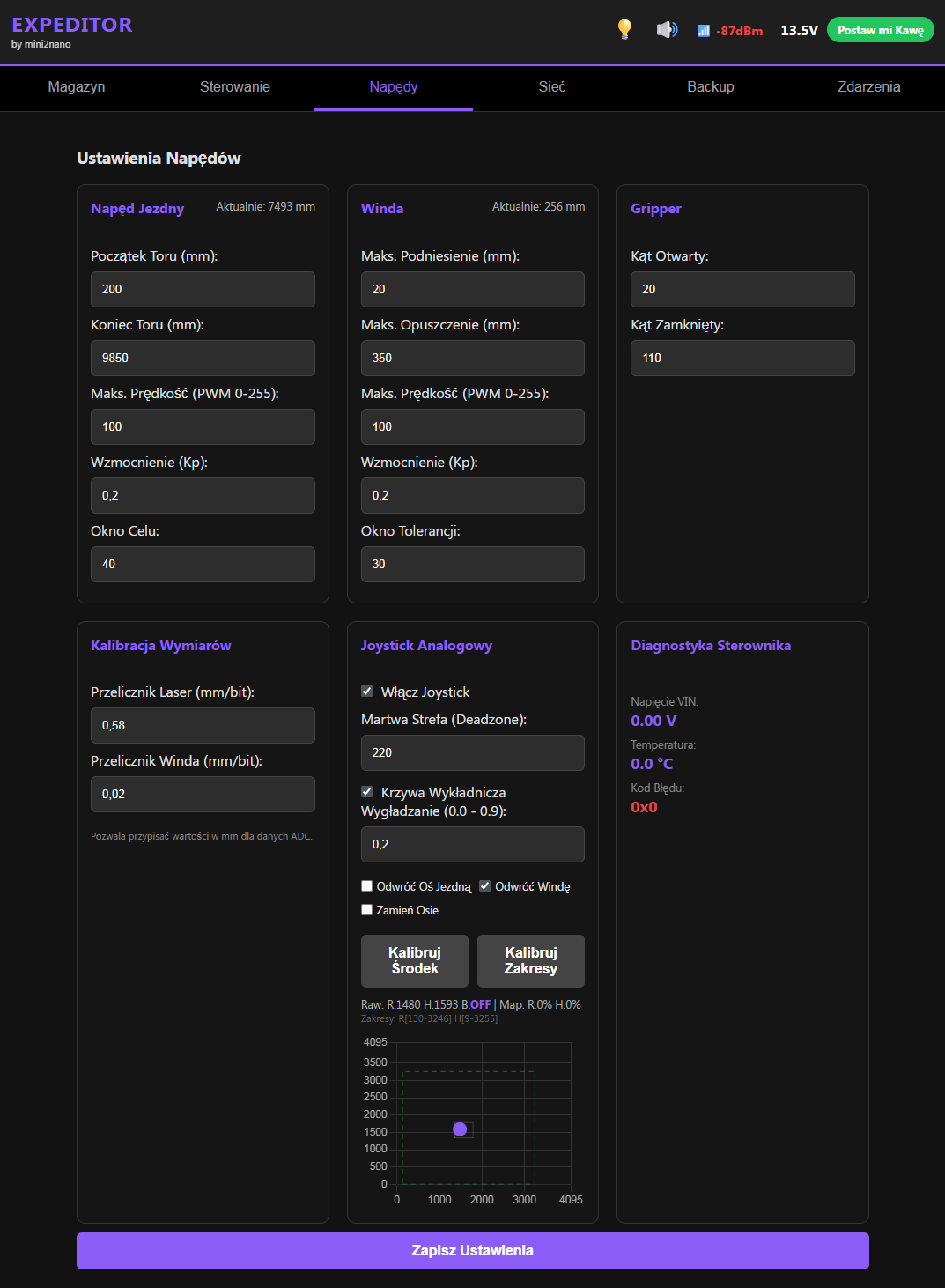

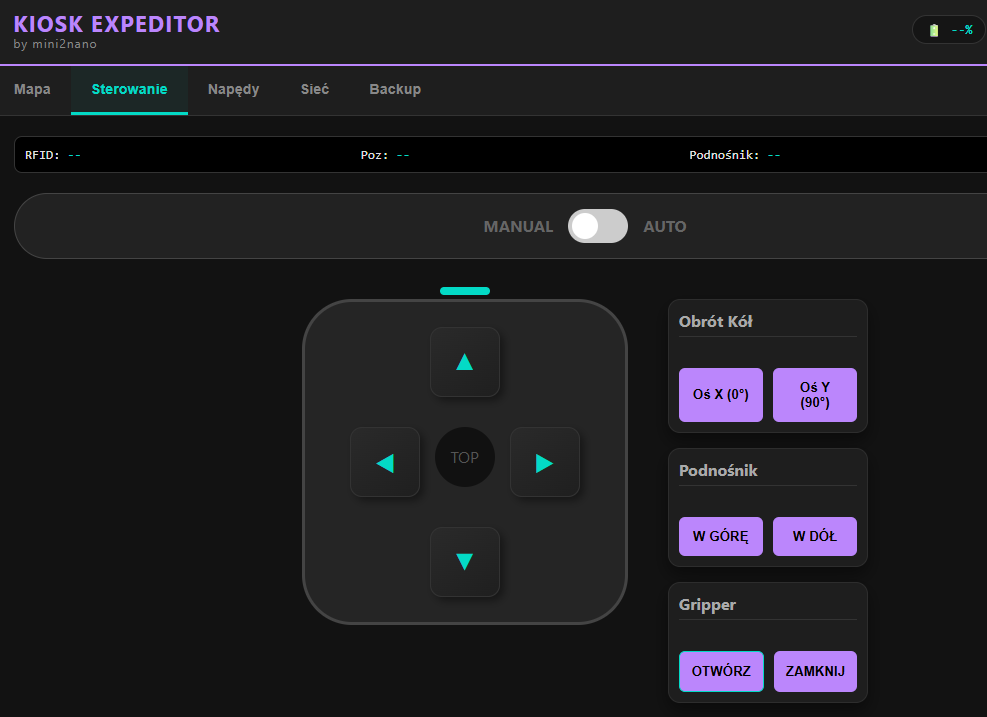

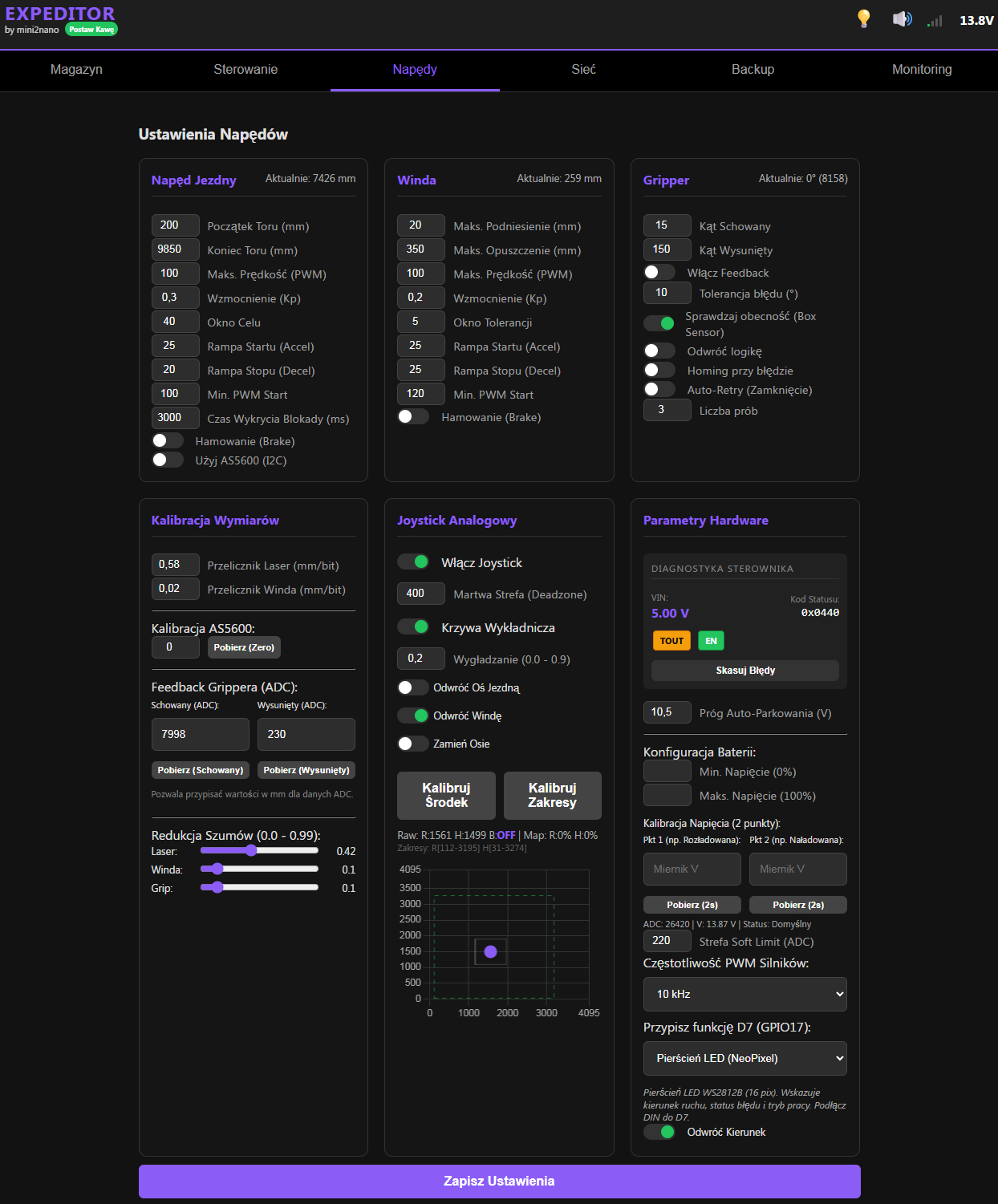

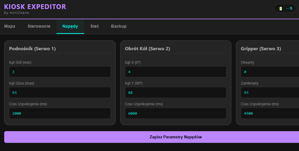

    However, I was planning to combine the Warehouse Expeditor Kiosk with the 'EXPEDITOR' robot that I have been working fiercely on for several weeks.
    The robot, in the first version I will make, will move on a single track above the containers in a fully autonomous manner.
    The choice was made after analysing the loft space, where I have about 13m of length tapering off at the back.

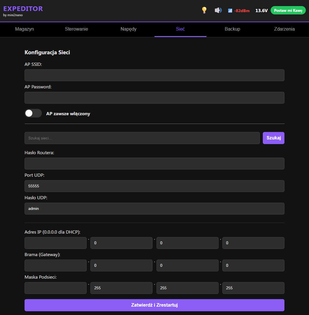

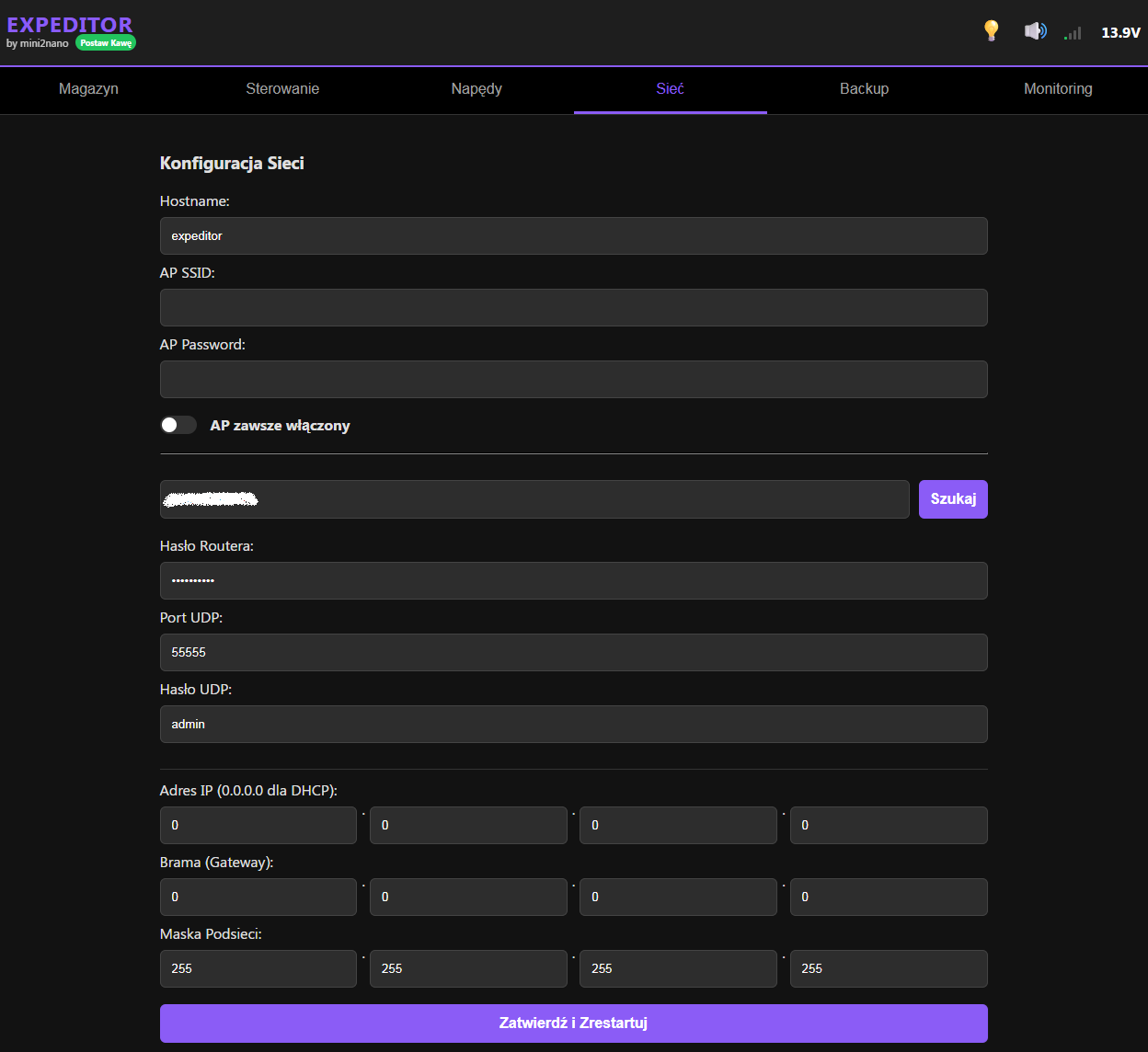

    A robot based on XIAO ESP32C6 using I2C communication modules, which as it turns out, is perfectly adequate and reasonably fast.
    Sure I had considered SPI, CAN and other solutions, but a few days of reviewing functionality versus price tempted me to just do it.

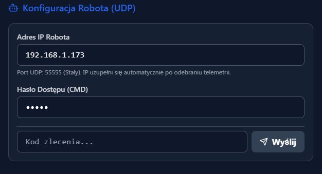

    The premise was that a fleet of robots would be able to communicate with the Kiosk, and the Kiosk itself would give us an insight into what was happening in the enclosed space where the robot was working.
    After much deliberation, it fell to telemetry of information exchange via UDP.
    A few moments with the AI and we got it....
    Application interface with electronic component categories and robot status bar
    The new version of the Kiosk gained the function to simultaneously call out the colour of the boxes on the shelf, and to send commands to the robots to search their own base and execute the command.

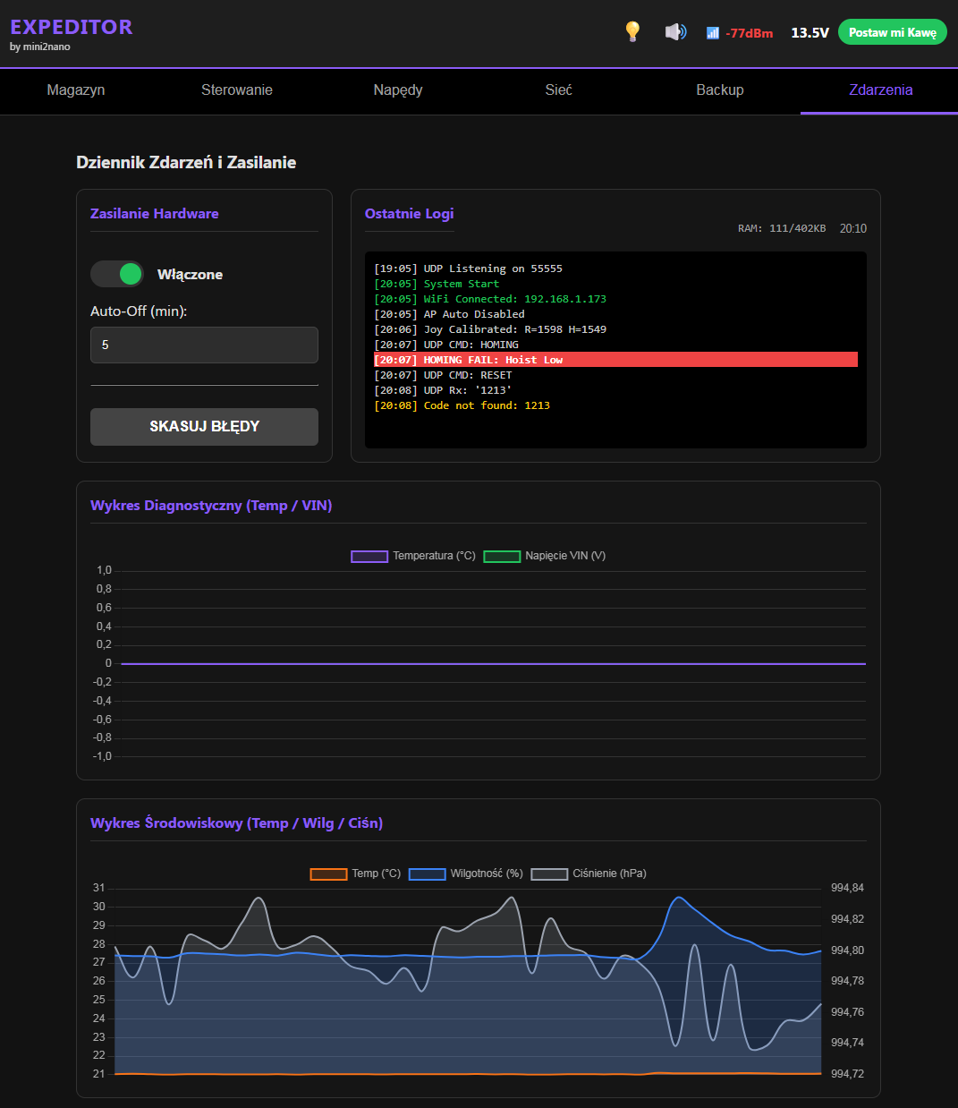

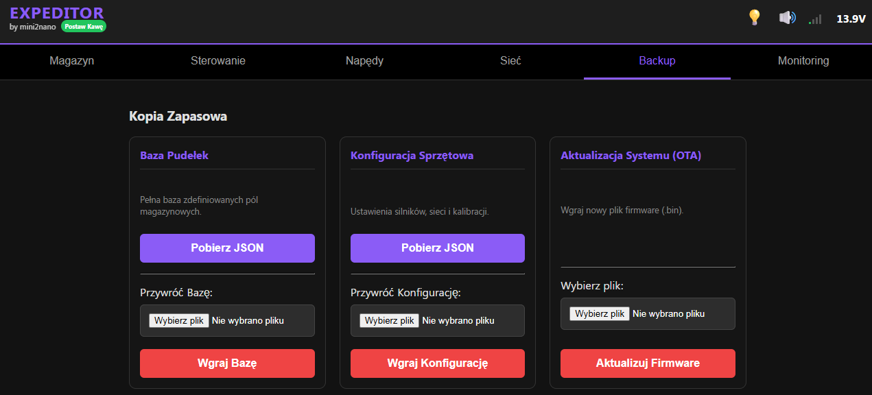

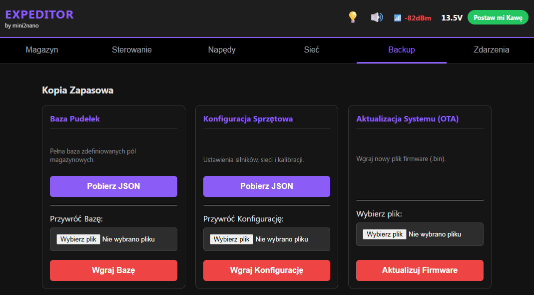

    Footer:
    EXPEDITOR control panel with status, network, and environmental data
    UDP robot configuration interface with IP, password, and command code fields
    I implemented the state machine in the robot and added a bit of interesting functions like.
    -Environmental monitoring (temperature, humidity and atmospheric pressure in the work zone - Sent telemetrically and available on the robot's WEB page.
    -Addition of a log field.
    -Time downloading from the web for logs.
    -Possibility of switching off the Hardware after a set time.
    -Measurement of motor controller module parameters.
    -Adding graphs to the "Events" tab
    EXPEDITOR panel with logs, environment charts, and power control toggle
    -Addition of a manual control tab with the possibility of selecting the operation "No Locking" - to set the position in place.
    -I have also added the ability to smoothly control the drives via the virtual Joystick on smartphones.
    Robot EXPEDITOR control panel with virtual joystick and directional buttons
    -Added a full Backup tab.
    EXPEDITOR system backup panel with three sections: boxes, config, and firmware update
    -Expanded network settings for AP, Router, UDP, and the ability to establish a static address.
    Network configuration interface in EXPEDITOR app with input fields and UDP settings
    -Added support for multiple drives via I2C M2T550 +metering module.
    -The Gripper's jaws will handle two model servos due to the negligible forces needed to extend them, under the top edge of the box.
    -For the path measurement I will use a laser I had on hand with a range of 10m (0 - 10V) - via a divider.
    -For on-the-spot operation, so as not to have to use, for example, a phone, I have added a general-purpose joystick (PS2) with full calibration capability.
    Robot drive settings panel with track, lift, and gripper parameters
    -And most importantly, the main EXPEDITOR applet
    EXPEDITOR system user interface showing warehouse configuration section
    -The use of a state machine offers great possibilities as it turns out.
    -Once the fields have been determined, the robot itself defines how it parses the code it receives and performs the task based on the occupancy of the physical fields to which the code applies (It brings, or returns the box).
    -Options have been added so that the robot can be operated practically from the WEB page, without external programmes.
    -In each tile we can define what it is, what is there, whether it is physically there, etc.
    -In addition, I have added the ability to set individual height calibrations for each box (I will be using several different boxes with different litres).
    Warehouse field edit panel with data inputs, calibration buttons, and action options
    What remains to be done is to order the PCB and I think it won't be long before the modular layout is up and running.
    Judging by the prices of the components, you can easily fit in a few hundred when building the robot.
    The electronics alone will cost around 100 PLN, plus the drives for a few dozen PLN each and the construction.
    EXPEDITOR robot control PCB with ESP32C6, joystick, and OLED display

    This is what the WEB page of my robot looks like....
    I'm curious if you guys have any interesting ideas to improve the design.
    Of course, I am providing a new version of the Kiosk Warehouse Explorer for PC (Windows x86 / 64) WarehouseExplorer 1.5.0_UDP.EXE
    https://drive.google.com/drive/folders/16Tt3g5scoqoold9HkTwjGDNBsBE9sNGm?usp=sharing
    The programme virtually only needs to be swapped with the existing one.
    UDP support for data exchange with warehouse robots has been implemented into the project.
    Below is an example of telemetry sent from EXPEDITOR:
    Code: HTML, XML
    As you can see, the Kiosk receives Information about the robot, its status, battery level, track position, errors, Storage conditions [Temperature, humidity, pressure], info about the current order, and recent logs.
    The kiosk listens to the traffic on a given port and establishes a connection with the robot itself, posting information on the robot's status on the Footer with a refresh every 5 seconds.

    The stage of completing the electronics and testing the robot is behind me.
    Let me upload some screenshots of the WEB Control Panel of my robot.
    -The robot was based on the XIAO ESP32C6 as the brain.
    -For the additional analogue inputs I used an ADS1115 (16 bit)
    -The POLOLU MOTORON M2T550 is responsible for the smooth control of the motors (running and lift).
    -I added environmental measurement of the robot based on an ATH20 +BMP280 module.
    -The on-site operation of the robot is via a PS2 Joystick. (Not to be confused with a game pad - the JOG module itself).
    -The SSD1306 128x32 I2C display is used to display the current information on the robot (could it be bigger? Sure, but for basic functions it is enough)
    -The display in normal mode (if not asleep) shows IP Address, Track Positions, Elevator Height, and Battery Voltage.
    The PCB was improved during delivery and a final version with additional inputs/outputs for peripherals was ordered.
    The operation itself from the WEB works, after modifications and implementation of asynchronous models, surprisingly smoothly.
    Screenshot of “EXPEDITOR” web panel showing a 28-slot warehouse grid and top navigation tabs
    Screenshot of EXPEDITOR “Control” web panel with direction buttons, PWM slider, and virtual touch joystick
    Screenshot of “EXPEDITOR” web control panel with drive, lift, gripper and joystick settings
    Screenshot of a web control panel “Network” tab with Wi‑Fi settings, UDP port, and IP address fields
    Screenshot of “EXPEDITOR” web panel on Backup tab with JSON download and OTA firmware update options
    Web control panel screenshot with logs and charts for VIN voltage and environmental readings.

    This is what the new version of the PCB looks like.
    3D render of a purple PCB with screw terminals, joystick module, and connectors for XIAO ESP32-C6
    3D view of a purple PCB with labeled connectors, pins, and the text “Extrema v2.0” and “Elektronika”.
    Of course I create the whole project in Polish ;)
