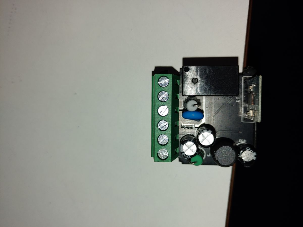

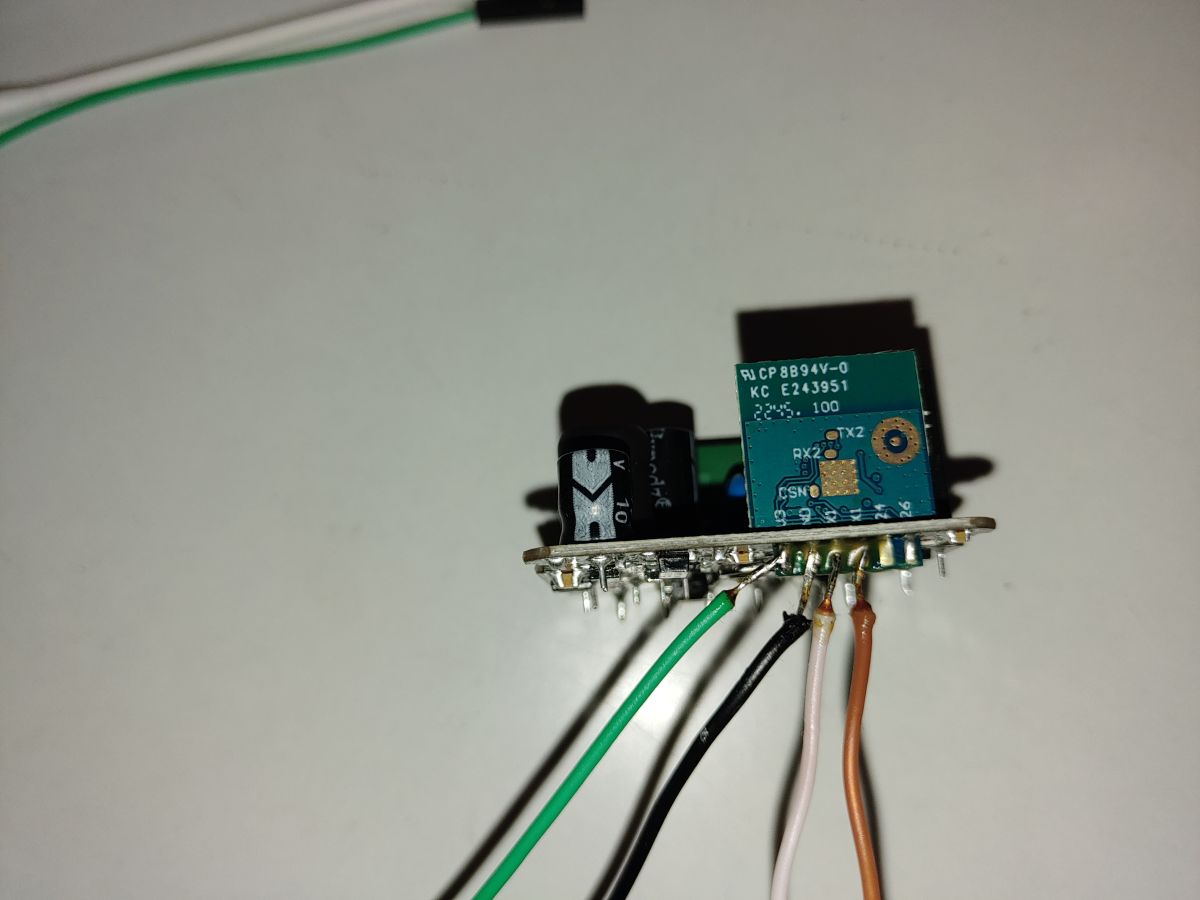

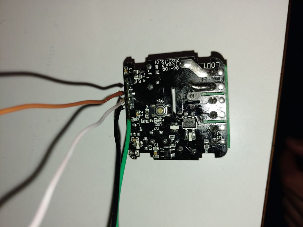

    Hallo again . I have as single older smart switch based on the BK7231N chip . Haven't seen any related forum topic so i created this one . I upload firmware (will have credentials) , template and photos .

    Small PCB module with soldered wires, a capacitor, and printed labels “RX2” and “TX2”.
    Close-up of a circuit board with a green screw terminal block and a black relay
    Circuit board with SMD components and several soldered wires on a white surface
