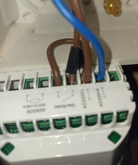

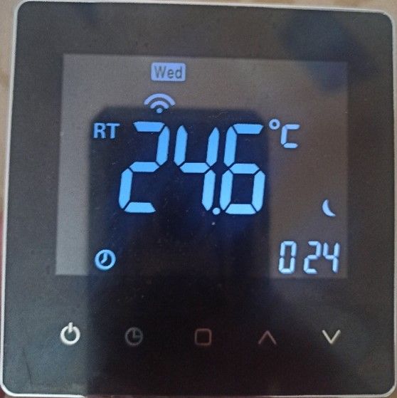

    This thermostat is for a gas boiler, and has wet contacts i.e. mains powered. FOR SAFETY, YOU MUST MAKE SURE IT IS INSTALLED BEFORE ATTEMPTING TO FLASH IT. The unit does not require opening up, so DO NOT OPEN - but you will need to power cycle during the Cloudcutter procedure which can be achieved simply by switching off and on your relevant circuit breaker when it gets to that stage. This will only need to be done once.
           Thermostat display showing 24.6°C, Wi‑Fi icon, “Wed,” and time 0:24
          Close-up of electrical terminal block with brown and blue wires inside a white housing.         Green PCB close-up with IC chips, a QR-labeled module, and red wires connected to a white connector

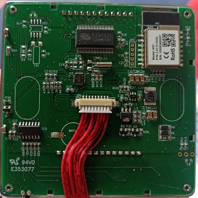

    This particular thermostat variant (circa 2020), has a WR3 Wi-Fi chip, and the FZH1621 chip looks like a MCU. I successfully used Tuya Cloudcutter to flash OpenRTL on it, using the following selection in the list by firmware:

    ‘Sorry, no meaningful pins data found. This device may be TuyaMCU or a custom one with no Tuya config data.
    No module information found.
    Device internal platform - RTL8710BN_2M, equals RTL8710B.
    And the Tuya section starts at 2011136 (0x1EB000), which is a default RTL8710B/XR809/BK7231Q offset’
    But it was a good guess it had an MCU from the photo.

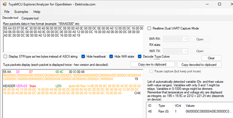

    There appears to be 2 profile dumps in one here (determined by repeated dpids):
    000002fn93 – this thermostat, and 0000002r12 – another device, possibly a fan heater with timer functions.
    The WebUI shows Firmware: FW2. This chip seems to use 2 partitions (hence the OTA1 & 2 in Cloudcutter). Maybe each partition holds a profile. Updating via OTA doesn’t work unfortunately. It should be possible by UART but if like me you don’t want the hassle, this version is good enough (unless it’s a patched WR3 chip and you can’t of course).
    Also note: Not all functions are shown here, as not every function on the thermostat is controllable remotely. Some settings can only be done in the thermostat’s menu by design. Also the screen when first started up shows more icons than this thermostat uses – it must be a generic template for many devices.
    Initial Configuration
    As it uses TuyaMCU to communicate with the MCU, no pins need to be assigned to the WR3.
    Just a few minor changes in the WebUI, and creating a startup file in the Web App (autoexec.bat).

    # Schedule HEX (DP48) - via MQTT so you can see/send the full string / HIDDEN
    setChannelLabel 12 "Schedule (Raw Hex)" 1
    setChannelType 12 TextField
    linkTuyaMCUOutputToChannel 48 mqtt 12
    #linkTuyaMCUChannelToOutput 12 raw 48 0
    setChannelVisible 12 0

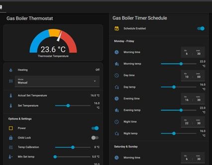

    The Web UI is now updated
    It’s starting to look more like a thermostat screen. It may look a bit basic but everything that needs to be controlled can be done through Home Assistant later.

    When Display is ON:
    Power Button – Powers off display and boiler if already on [Hold] Toggles wifi
    Clock – Sets device time
    Square – Toggles Operation Mode: Manual, Auto [Hold] Schedule Mode*
    Up – Increases Set Temperature
    Down – Decreases Set Temperature
    *Schedule Mode
    There are 6 periods each for Mon-Fri, Sat and Sun
    Power – Exits Schedule Mode
    Square – Cycles between Days/Time/Temp/Period on/Period off
    Up/Down – Changes selected option
    When Display is OFF:
    Power Button – Turns on display (and boiler if set temp) [Hold] Says ‘ON’ and FFF in right corner (unknown)
    Square [Hold] – Menu options*
    *Menu options (with defaults and (ranges))
    Press Square to cycle - Up/Down to change – Power to exit
    1 – Temp Calibration – 0 (-9 to 9)
    2 – Deadzone - 1.0c – (1.0-5.0)
    3 – Lock Mode Buttons 1 (0 All except power or 1 ALL)
    4 – Sensor – in (in, all, ou)
    5 – Min Set Temp - 0.50c (05.0-15.0)
    6 – Max Set Temp - 35.0c (15.0-45.0)
    7 – Display Mode – 0 (0 RT & SET or 1 SET)
    8 – Screen Dimmer brightness - 10 (0 Black to 100 Always On)
    9 – High Temp Protection Setting - 45c (25.0-70.0)
    A – Low Temp Protection Setting - 0.50c (02.0-10.0) – Only resets in Eco Mode
    B – Unknown Function??? – 0 (0,1)
    C – Factory Reset - 0 (0,1)
    D – Economy Temp 16.0c (05.0-30.0) – Only resets in Eco Mode
    E – Brightness - 80 (1 dim to 100 bright)

    Decoding the Timer Programme Schedule
    This thermosat has 3 day selections – Mon-Fri, Sat and Sun. Each has 6 timer events.
    Fortuntely these are all exposed and can be controlled.
    The TuyaMCURecevied line with the long hex numbers is the key here. Setting DP48 to publish to MQTT and using MQTT Explorer the line of hex appears, and flashes with each change - which is a lot easier than sifting through all the code in the web log.
    Screenshot of TuyaMCU Explorer showing UART frames and decoded hexadecimal packets
    When changing the settings of time and temp (but not days), it will reveal which segment changes, and depending on what block it changes also reveals whether Mon-Fri, Sat or Sun.
    ChatGPT was useful for this purpose – by adjusting the time by 1 minute on 1 programme, posting it up, then adjusting the temp for the same programme and posting that up then rinse and repeat for the others - it didn’t take long to decode it. Just the Mon-Fri segment was enough to extrapolate the rest.
    Here’s an example of what was found:
    The raw block
    053B00D2073B00A50C0100E60D3B00AA113B00E6153B00AA060000DC080000A00C0000DC0E0000A0120000DC160000A0060000DC080000A00C0000DC0E0000A0120000DC160000A0
    Broken down to 3:
    053B00D2073B00A50C0100E60D3B00AA113B00E6153B00AA – Mon-Fri
    060000DC080000A00C0000DC0E0000A0120000DC160000A0 – Sat
    060000DC080000A00C0000DC0E0000A0120000DC160000A0 – Sun
    First block broken down:
    053B00D2 073B00A5 0C0100E6 0D3B00AA 113B00E6 153B00AA
    053B00D2 - 05:59 21.0C (05 is 05, 3B is 59, 00 is 00, D2 is 210 which is 21.0c)
    073B00A5 - 07:59 16.5C
    0C0100E6 - 12:01 23.0C
    0D3B00AA - 05:59 21.0C
    113B00E6 - 05:59 21.0C
    153B00AA - 05:59 21.0C
    Whilst unsure about the channel IDs, it’s reasonable to assume that this part of it would be consistent with any other thermostat of this exact model.
    To write back via MQTT use
    cmnd/vislone_thermostat/tuyaMcu_sendCmd
    Publish (raw) – only one space after the 6.
    6 30000048060000CD073B00A00C0100E60D3B00AA113B00E6153B00AA060000DC080000A00C0000DC0E0000A0120000DC160000A0060100DC080000A00C0000DC0E0000A0120000DC160000A0
    In this example

    Getting this Thermostat in Home Assistant
    As this device requires a lot of code it’s better to have it in a Package. Add this line to your configuration.yaml if you don’t already have it:
    homeassistant:
      packages: !include_dir_named packages
    Create a folder called ‘packages’ in your config dir if you don’t already have one. Inside this folder create 2 files and paste in the code for each:
    gas_boiler_controls.yaml
    Code: YAML
    And gas_boiler_schedule.yaml
    Code: YAML
    For the dashboard, you'll need these Lovelace cards:
          Gas boiler thermostat control screen showing 23.6°C and a timer schedule panel with sliders
    One for the Controls:
    Code: YAML
    And one for the Schedule:
    Code: YAML
