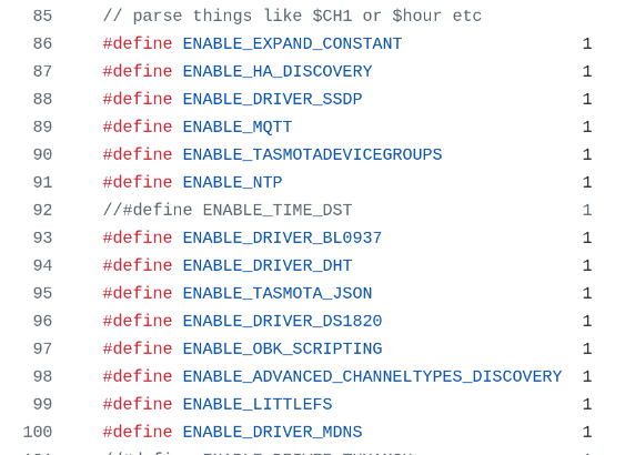

    There is the time_setDST ccommand, but it isnt activated in the downloadable versions.
    Isnt that ridiculous?

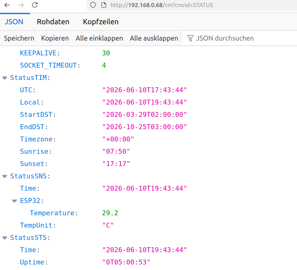

    I'm confused. I get errors for any of the DST settings (Built on Jun 2 2026 12:15:38 version 1.18.289). Reading through this thread, I see that the prefix changed, so I tried the old prefix. In another answer, it's called clock_calcDST, so tried that too:
    Error:CMD:cmd time_setDST NOT found (args 0 3 1 2 1 0 10 1 3 0)
    Info:CMD:[WebApp Cmd 'time_setDST 0 3 1 2 1 0 10 1 3 0' Result] Unknown command
    Error:CMD:cmd clock_setDST NOT found (args 0 3 1 2 1 0 10 1 3 0)
    Info:CMD:[WebApp Cmd 'clock_setDST 0 3 1 2 1 0 10 1 3 0' Result] Unknown command
    Error:CMD:cmd clock_calcDST NOT found (args 0 3 1 2 1 0 10 1 3 0)
    Info:CMD:[WebApp Cmd 'clock_calcDST 0 3 1 2 1 0 10 1 3 0' Result] Unknown command
    Error:CMD:cmd time_calcDST NOT found (args 0 3 1 2 1 0 10 1 3 0)
    Info:CMD:[WebApp Cmd 'time_calcDST 0 3 1 2 1 0 10 1 3 0' Result] Unknown command
    What is going on? Should I load some extra driver?

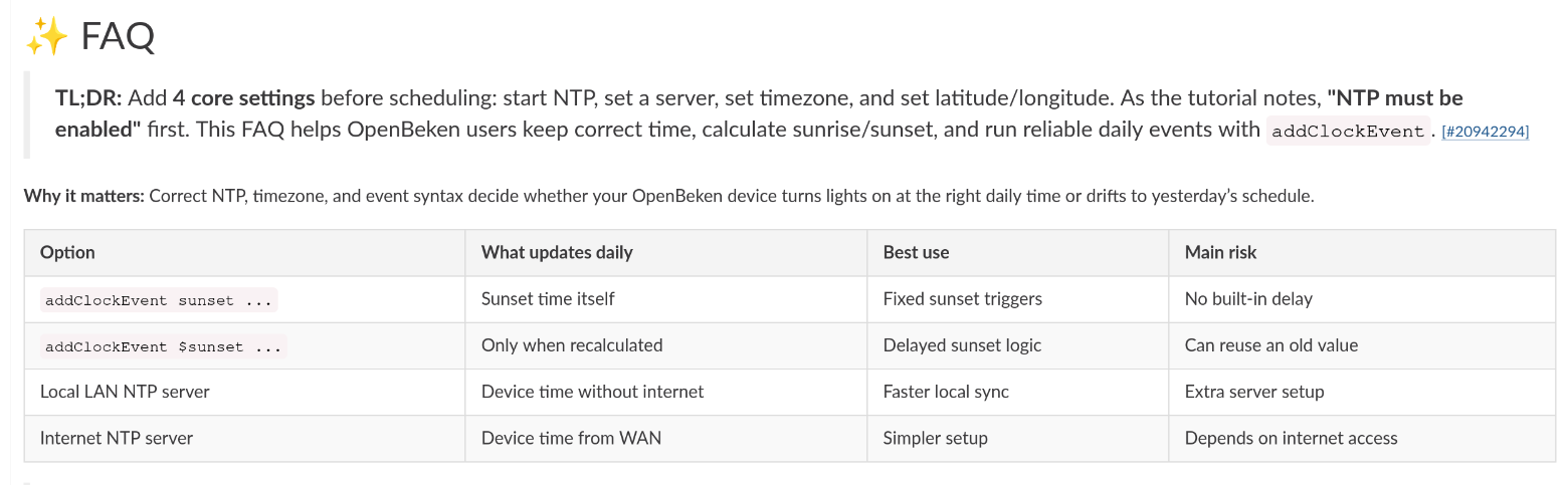

    The problem I'd like to solve is to have the MCU change the time automatically. If there's another way to do it, I'd like to learn about that.
    Before anyone asks: this in my autoexec.bat:
    // name      : $RCSfile: Action_Socket_3202087-2_unit_1_autoexec.bat,v $ $Revision: 1.2 $
    // issued   : $Date: 2026/06/05 10:24:57 $
    // description   : OpenBeken autoexec.bat for LCS Socket 3202087.2
    // id      : $Id: Action_Socket_3202087-2_unit_1_autoexec.bat,v 1.2 2026/06/05 10:24:57 adriaan Exp adriaan $
    // Based on script found at https://www.elektroda.com/news/news4087228.html
    // Do not enable powersaving because the BL0937 requires exact
    // pulse/interrupt counting. See comment 16 Nov 2024 11:01 at URL
    // above
    PowerSave 0
    // Set IP of NTP server (if you'd like to keep things local)
    // ntp_setServer 172.16.1.73
    // Start NTP driver
    startDriver NTP
    // Timezone is Central European time (1 hr ahead of UTC)
    time_setTZ 1
    // Change time offset (last week (0) of March (3) 1st (1) at 2:00 (2)
    // with one hour (1), and last week (0) of October (10) 1st (1) at
    // 3:00 back to 0 hours).
    // https://github.com/openshwprojects/OpenBK7231T_App/blob/main/docs/commands.md)
    // Setting the devices location will allow for calculating sunrise and
    // sunset times
    time_setLatlong (removed for privacy)
    // Energy statistics: enabled, 60 sec intervals, 60 samples, no JSON
    SetupEnergyStats 1 60 60 0
    // Switch the socket to always "on" after boot
    SetChannel 1 1
    // Wait for NTP to connect
    waitFor NTPState 1

    Only now I understand what @RappaSan meant: In the source on GitHub, this function is not enabled, so it's not part of the binaries that are downloaded with the EasyFlash tool under Windows.
    OpenBK Timer Web Interface Similar to Tasmota: Availability and Options
    I will try and compile the firmware myself when I get around to it.

    Some code is used for "correcting" output, for example, enabling DST will give correct DST information in JSON output instead of "2022-03-27T02:00:00" and "2022-10-30T03:00:00".
    On the other hand, I don't think we come near to the maximum size yet, I only see BL602_berry near it's limit for 1MB (907508 to 909716).
    OTA isn't working even for "regular" berry, but flashing DST firmware by serial worked fine, DST is working.
    Just realized, the command documentation for "time_setDST" is wrong :-( describing it will use "hours" for offset, while it will use minutes.
    Will fix that and look if I can squeeze some more bytes by optimizing the code.

    This?
    NOTE: Use of sunrise/sunset requires compiling with ENABLE_TIME_SUNRISE_SUNSET set
    I must be getting old - I never deducted that sunset (instead of $sunset) could be used from that remark. I also missed what the difference is. I did find something else under the article mentioned before:
    Screenshot of an OpenBeken FAQ about NTP and addClockEvent, with a table of options and risks
    I'm not sure where that comes from - I usually ignore this kind of auto-generated stuff at the bottom of pages. Oh well...
