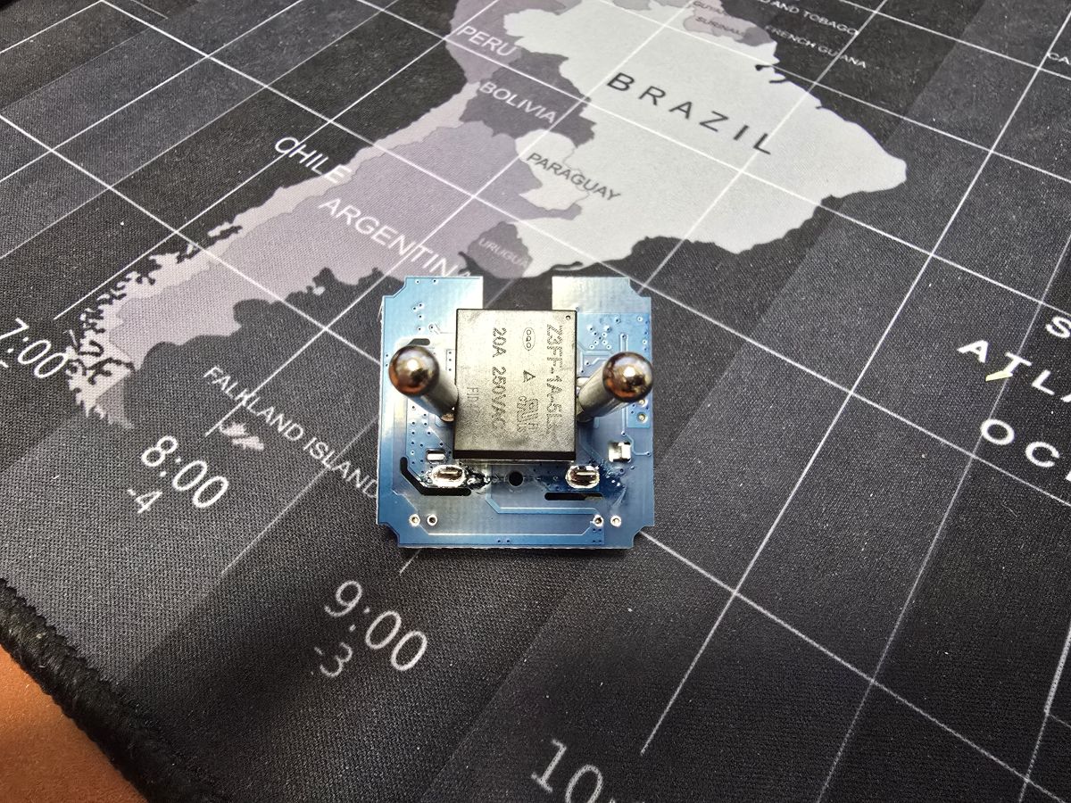

    Wylosowało się wyjątkowo trudne, kolejne gniazdko ze wschodu WF09 PLUG 20A
    White TNCE ZigBee smart plug with power button and energy monitoring
    https://pl.aliexpress.com/item/1005006597670357.html

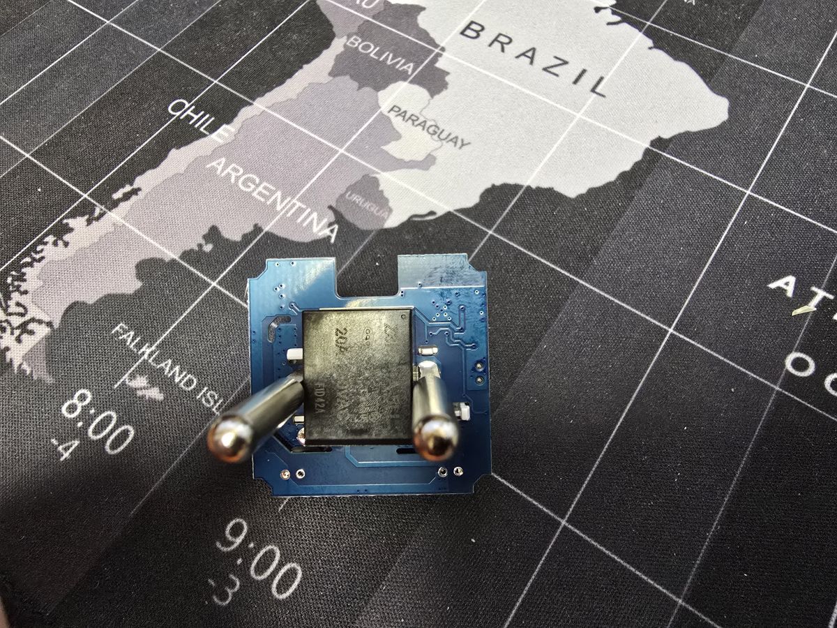

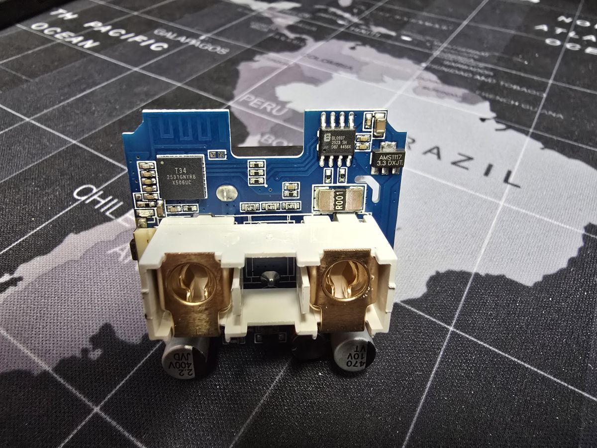

    tym razem bez punktów do przylutowania programatora:
    WF09 PLUG 20A PCB board with bottom-mounted components and no programming pads WF09 PCB board without programmer pads, held over a world map mousepad WF09 PLUG 20A circuit board with bottom-soldered components WF09 PLUG 20A circuit board with soldered components, no programmer pin headers Close-up of the WF09 plug PCB with two pins and bottom-only soldering WF09 PLUG 20A module with relay and no programming header visible
    Ktoś już się z tym spotkał? Zostaje lutowanie bezpośrednio do chipa?

    I have this socket. It's the latest evolution of the LSPA9. It was on the ESP8266, then on the WB2S, then on the CB2S, now it's on the T34.
    Unfortunately, it seems to be the only method left:
    Changing firmware is getting harder? Smart Switch on T34 and LGA/QFN soldering
    Do you have hot air?
  • #3 21808362

    You have hot air?
    Luckily I have a Yihua 872D, but they've got it pretty well figured out. Already the first better magician with a soldering iron can't handle it.
    What temperatures did you work at?

    Unfortunately the mission fell through, my RX pad fell off the chip while soldering (it was stretching the soldered wire too much). Not the eyes, not the skills :)
