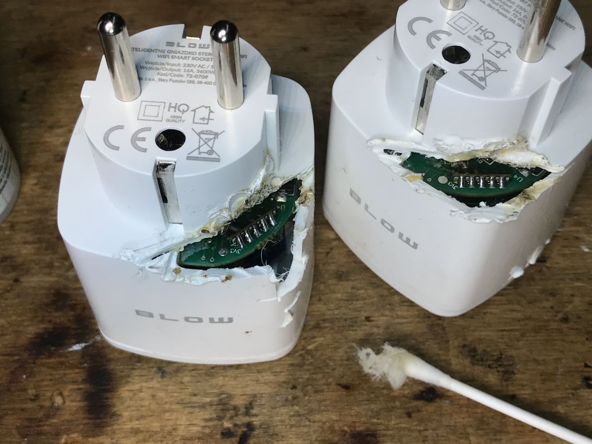

    I will show you a little interesting fact - a quite invasive but effective way to change the firmware of the cheapest WiFi-controlled socket. This socket is characterized by a low price (PLN 30) and a structure that makes it impossible to remove the board with the WiFi module from inside, which makes changing the insert very difficult. This is not a product like Blitzwolf sockets, where we have either a hidden screw or retractable pins, here everything is held together and there is really no way to get to the programming pads. Normally I wouldn`t touch it, but I received a request from a reader to change the insert of such a socket at all costs ...
    You can buy this socket really cheap and it`s not strange at all - it`s the cheapest option possible:

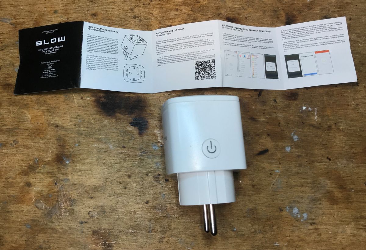

    Set:
    Blow smart socket with instruction manual in the background.
    Polish-language instructions:
    User manual for Blow WiFi smart socket. User manual for a smart Wi-Fi socket in Polish. Instruction manual for a WiFi smart socket with the Smart Life app. Polish-English user manual for using Amazon Echo to control smart devices. User manual for Blow smart socket with WiFi Declaration of conformity for the BLOW WiFi smart socket.

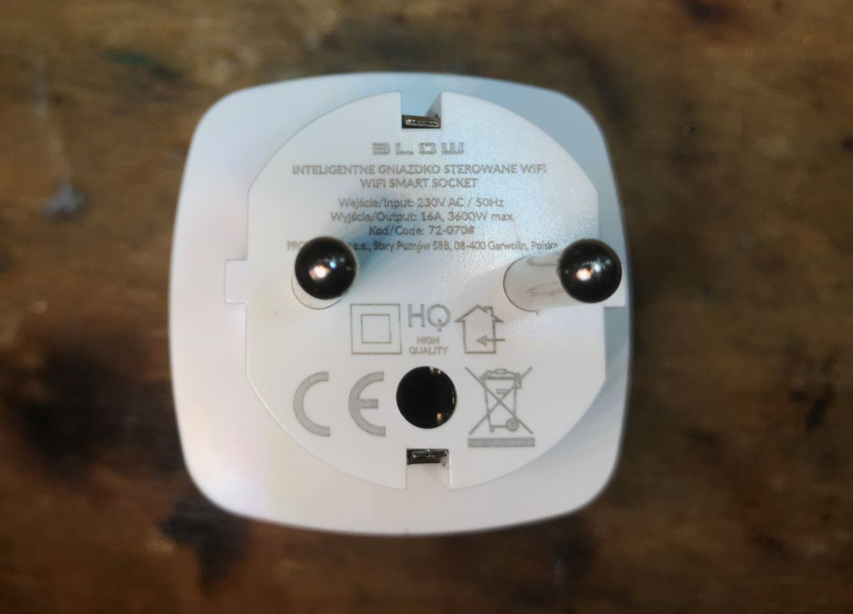

    Socket itself:
    Front view of a WiFi smart socket with visible prongs and technical markings.

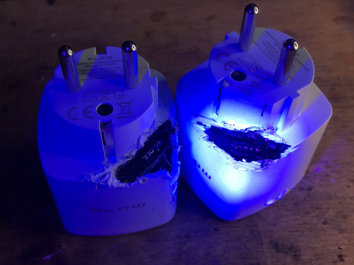

    Interior and blow flashing

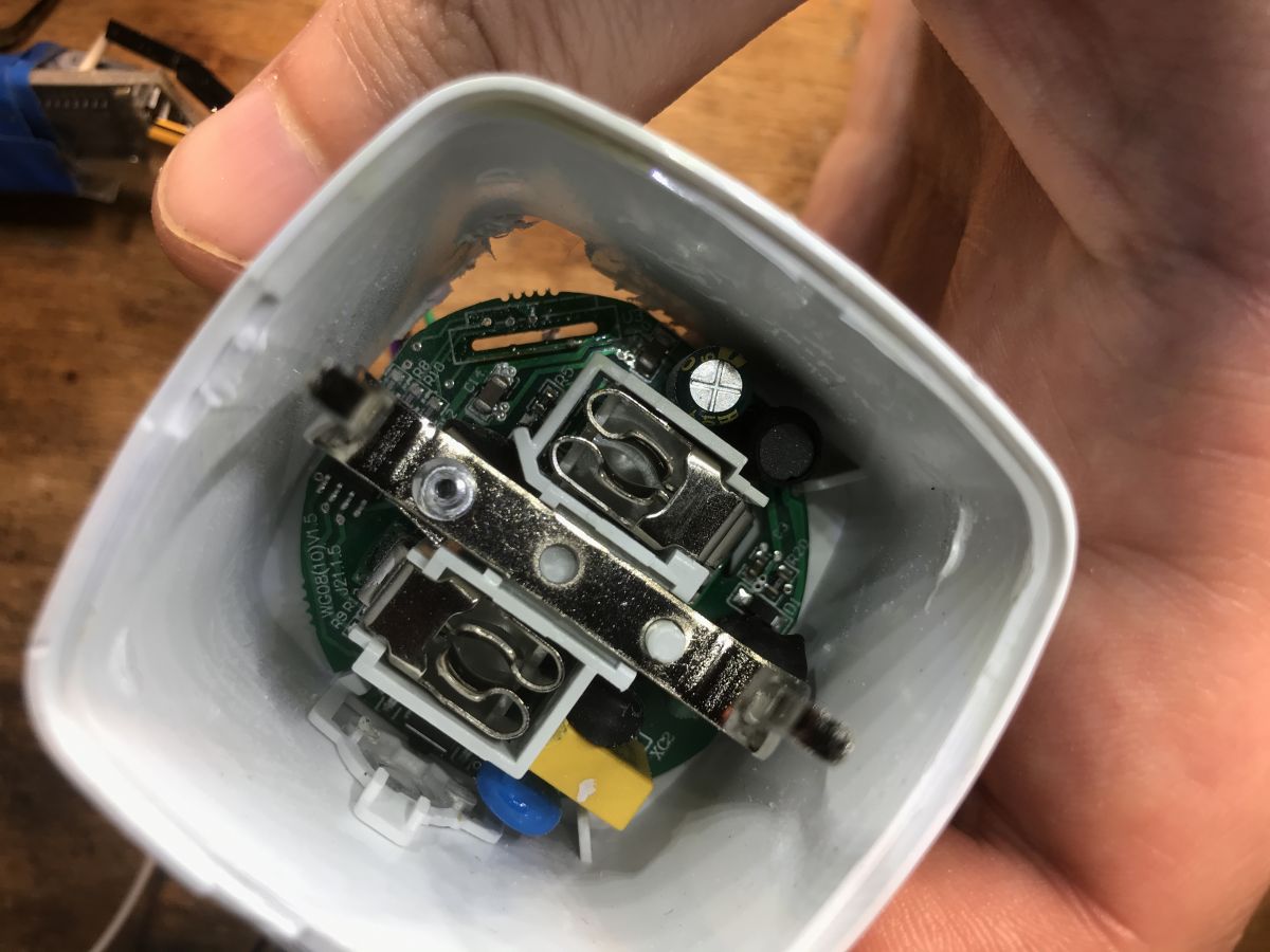

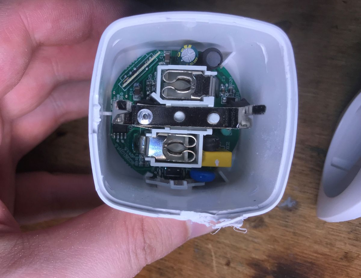

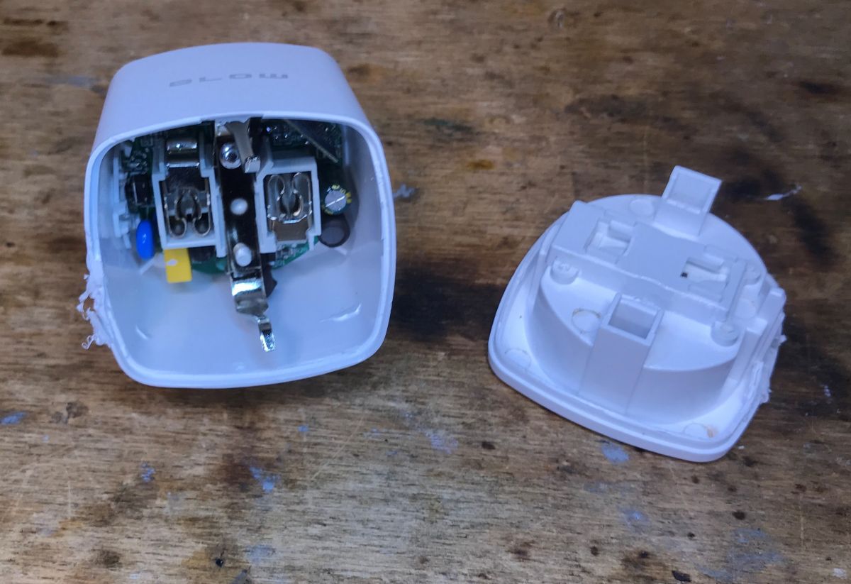

    At first, they are disassembled like LSPA9, but after a while we have a surprise - the ground plate holds the rest of the system:
    Open plastic electrical socket with visible interior components.
    I don`t know how to make sense of this:
    Interior of a cheap WiFi socket showing the PCB and electrical components.

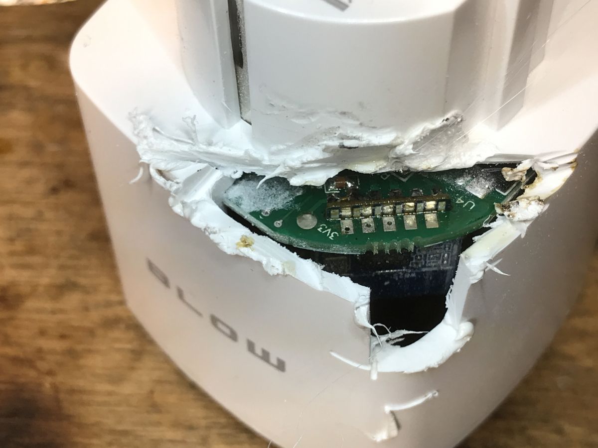

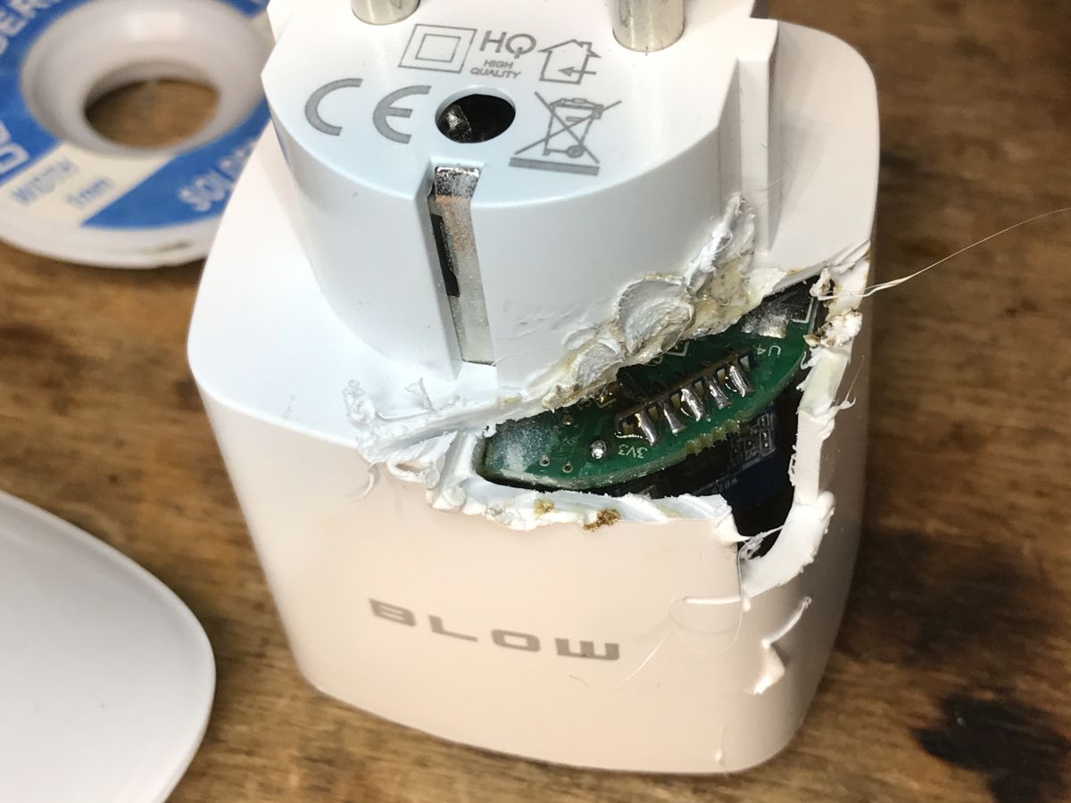

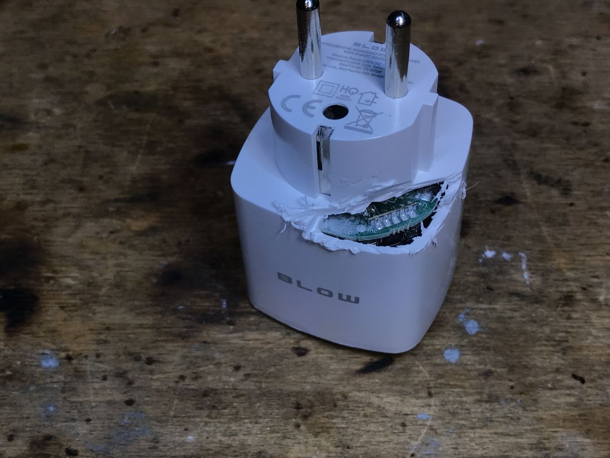

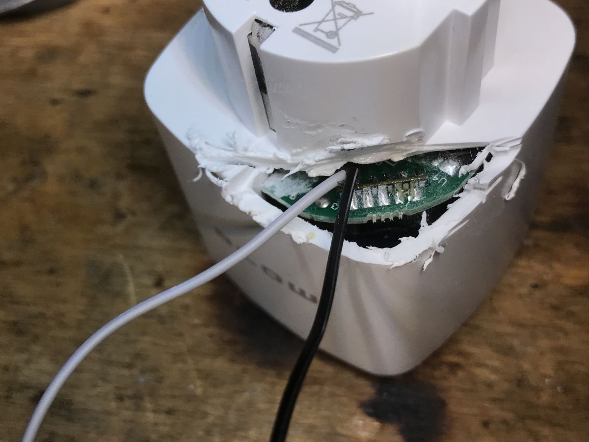

    After consulting the reader, the decision was made - we cut:
    WiFi socket with open casing revealing the interior.

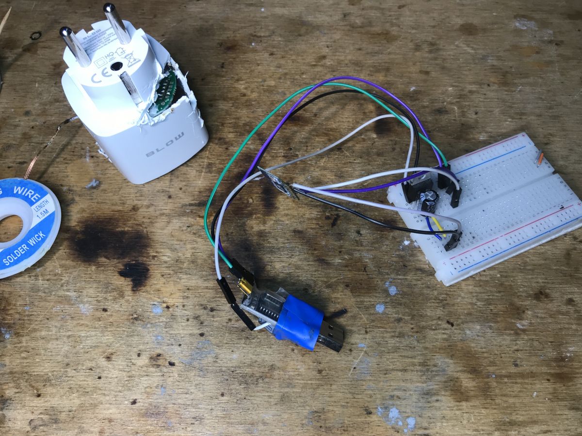

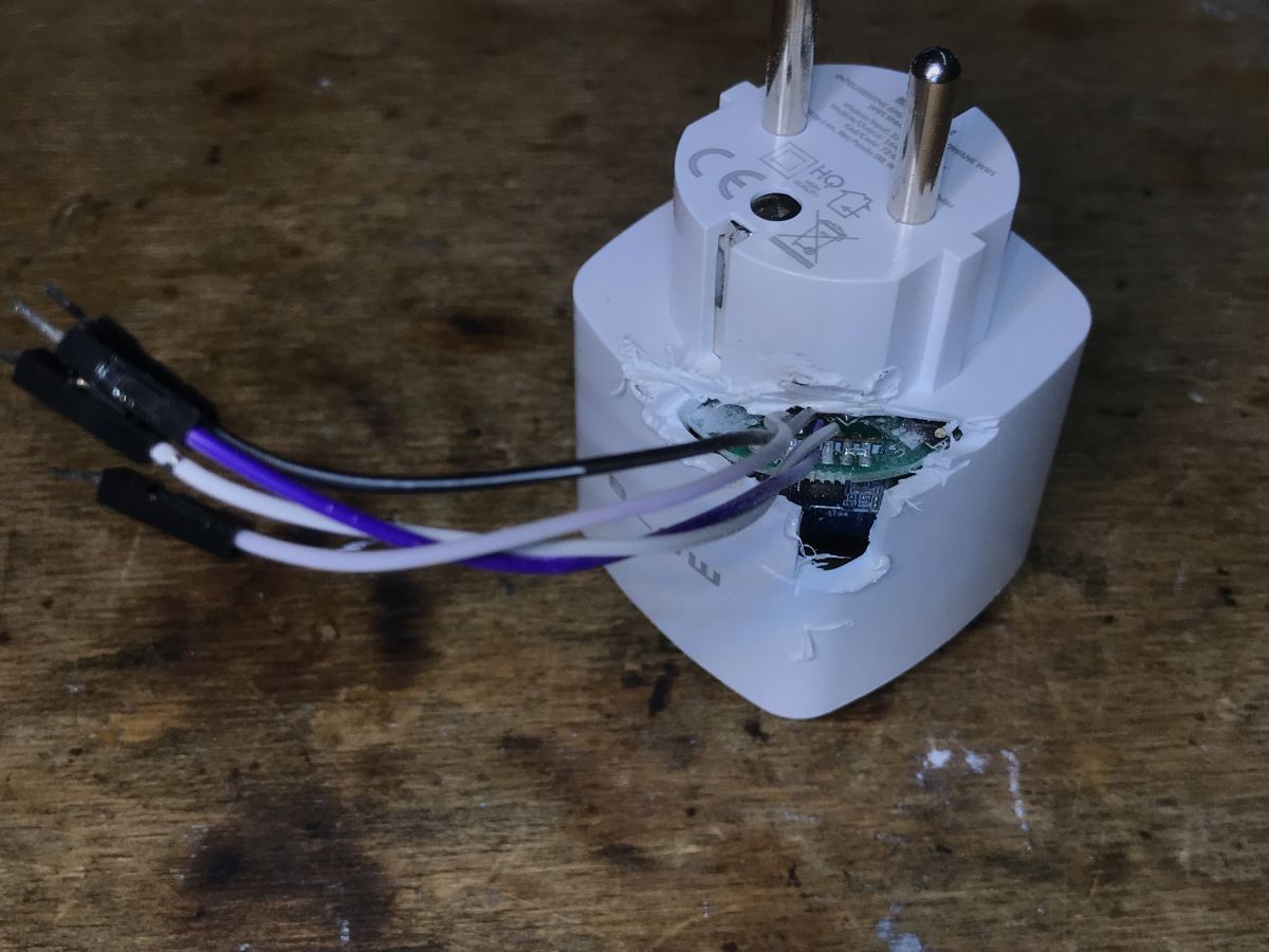

    Already then I tried to connect with the programmer:
    View of a damaged electrical socket with exposed wires and exposed PCB. Modified electrical socket with exposed interior.

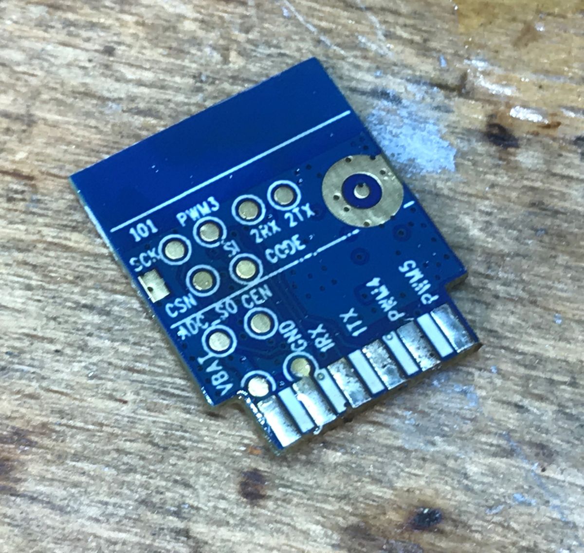

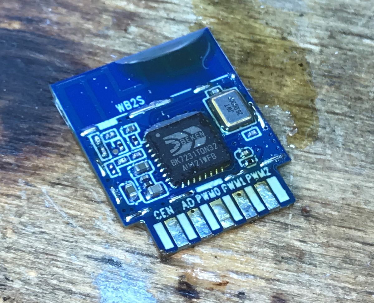

    There is of course BK7231 inside, BK7231Flasher should be able to handle it:
    but here is the problem, because the energy measurement system is probably on RX/TX... so you need to desolder the module:
    Damaged Blow socket with exposed circuit board. Image of a damaged electrical socket with visible electronic components inside.

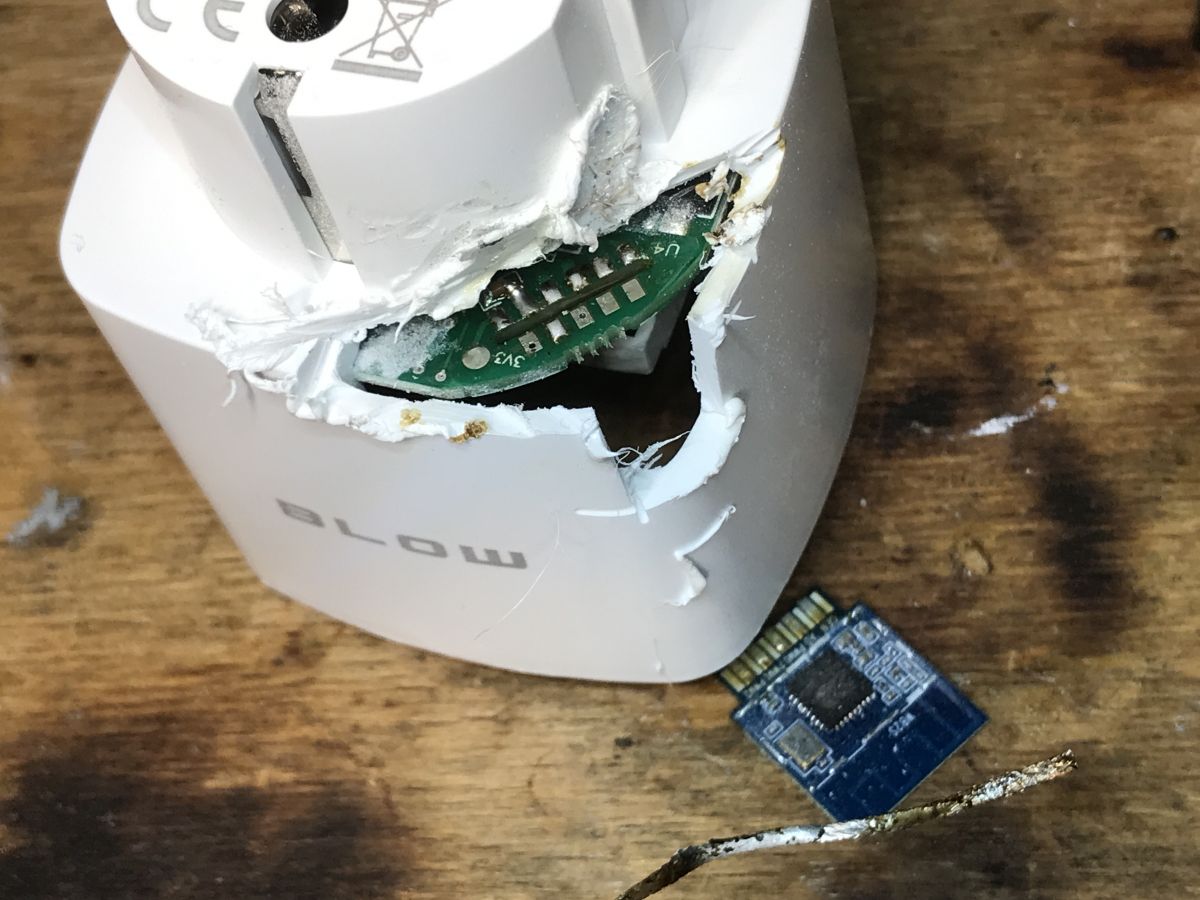

    Outside the system, you can change the input normally:
    Image of a WB2S module with a BK7231T chip placed on a wooden surface. Printed circuit board with markings on a wooden surface.
    View of a disassembled Blow electric socket with wiring and a breadboard on a wooden table.
    This is what the socket looks like from above:
    Close-up of the inside of an electrical socket showing a circuit board.
    The module returns to its place:
    Damaged electrical socket with an exposed PCB.

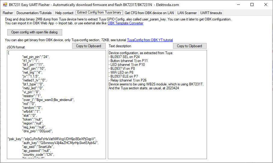

    Flasher obviously detected the configuration:
    Screenshot of BK7231 Easy UART Flasher software with device configuration.
    Verbal description:
    - BL0937 SEL on P24
    - Button (channel 1) on P11
    - LED (channel 1) on P10
    - BL0937 VI on P8
    - WiFi LED on P6
    - BL0937 ELE on P7
    - Relay (channel 1) on P26
    Device seems to be using WB2S module, which is using BK7231T.
    JSON Tuya:
    OBK template:
    After changing the firmware, you still need to perform calibration, similarly to Tasmota - CurrentSet, VoltageSet, PowerSet commands.
    Finally, we protected the socket - first with a solder mask, and then (on the reader`s side) with epoxy or some form of filler, at our discretion:
    Two damaged electrical sockets with exposed PCBs. Two electrical sockets with visible damage and glowing blue light.

    Wouldn`t it be easier to drill out the rivet?

    Well, I don`t know if I would be able to solder it solidly without melting the center of the socket. If I have some to destroy, I`ll try.

    If there was determination, it had to succeed.
    Alternatively, after drilling out the rivet, you can rivet it again or tighten it with an M3 screw.

TL;DR: For a PLN 30 Blow 72-070 smart plug, “we cut” was the working method when the grounded riveted plate blocked PCB removal. This FAQ helps DIY IoT users reflash a WB2S/BK7231T socket, recover energy metering, and choose between invasive hardware work, older OTA options, and local-only remote access. [#21004173]

Cut metal part High Riveted ground plate High When PCB cannot be removed at all

Key insight: The real blocker is not the BK7231T chip. The blocker is the grounded riveted plate and shared serial lines, which force invasive access before safe flashing.
  • The socket discussed costs about PLN 30 and includes energy measurement, making it cheap but still useful for local automation after reflashing. [#21004173]
  • The extracted Tuya config identifies a WB2S module with BK7231T and a BL0937 metering chip, with relay on P26 and button on P11. [#21004173]
  • Tuya settings in the dump include approximate protection thresholds of 90 V low voltage and 260 V overvoltage. [#21004173]
  • One suggested mechanical fix after drilling is to reattach the structure with an M3 screw, instead of leaving the ground section loose. [#21004597]
  • A home VPN was described as taking about 5 minutes to configure on supported routers, while one tuner setup streamed up to 8 SAT programs and terrestrial TV from 2 muxes. [#21011703]
1. How can I flash alternative firmware on the Blow 72-070 WiFi socket when the PCB cannot be removed because of the grounded riveted plate?
You can flash it only by using an invasive hardware method. 1. Open the socket until the grounded riveted plate stops PCB removal. 2. Cut the blocking metal part, then desolder the WB2S module so the programmer can access it cleanly. 3. Flash the module outside the socket, solder it back, then protect the area with solder mask and filler. The working example was done on a Blow 72-070 sold for about PLN 30. [#21004173]
2. Why is the Blow 72-070 harder to reflash than the original LSPA9 socket with energy measurement?
The Blow 72-070 is harder because its grounded riveted plate prevents normal PCB extraction. The original LSPA9 let the whole PCB come out of the housing, which made pad access much easier. Here, the author says the Blow design leaves “really no way” to reach the programming pads without destructive work. That makes reflashing slower, riskier, and more mechanical than the earlier LSPA9 approach. [#21004173]
3. What role does the riveted ground plate play in the Blow 72-070, and why does it block access to the programming pads?
The riveted ground plate mechanically holds the rest of the socket together. Because it is fixed through a rivet, it traps the internal PCB and prevents the board from sliding out like it does in easier designs. That blocks direct access to the programming pads, even after partial disassembly. In practice, the plate turns a standard serial flash job into cutting, drilling, or other invasive rework. [#21004173]
4. Which pins and functions should I configure in OpenBeken for the Blow 72-070 with a WB2S BK7231T module and BL0937 power monitor?
Use the extracted mapping: P26 relay, P11 button, P10 LED, P6 WiFi LED, P24 BL0937 SEL, P8 BL0937 VI, and P7 BL0937 ELE/CF. The dump also identifies a 1-channel device on a WB2S board with a BK7231T chip. In the posted OBK template, those pins are assigned as Rel, Btn, LED, WifiLED_n, BL0937SEL, BL0937CF1, and BL0937CF. That mapping is the starting point before calibration. [#21004173]
5. What is BK7231GUIFlashTool, and how is it used to read Tuya configuration from a BK7231T-based socket?
BK7231GUIFlashTool is the flasher used here to detect the device and extract its Tuya configuration. "BK7231GUIFlashTool is a flashing utility that reads and writes BK7231-based modules, exposing Tuya pin mappings and board details from device memory." In this case, it detected a WB2S/BK7231T socket and produced a readable configuration that listed pins such as P24, P11, P10, and P26, plus the Tuya section start address 2023424. [#21004173]
6. Why do I need to desolder the WB2S module in this socket before flashing, and how do the RX/TX lines used by the energy metering circuit affect programming?
You need to desolder the WB2S because the socket’s metering hardware occupies the serial lines needed for programming. The author states the energy measurement system is on RX/TX, so in-circuit flashing is blocked or unreliable. Removing the module isolates it from the BL0937-related circuitry and lets the programmer talk directly to the BK7231T. Without that step, the flasher may not get a clean serial connection. [#21004173]

9. Drilling out the rivet vs cutting the metal part in the Blow 72-070 — which approach is safer and easier when modifying the socket?
Drilling out the rivet sounds cleaner, but cutting the metal part was the proven method in this case. The author had already completed two units by cutting and was unsure whether reattaching a drilled-out structure could be soldered solidly without melting the socket center. Other users suggested drilling, then re-riveting or using an M3 screw. So the easier method is the one you can also reassemble safely afterward. [#21004588]
10. How can I restore the mechanical strength and insulation of a smart socket after invasive reflashing, for example with solder mask, epoxy, or an M3 screw?
Restore both strength and insulation before reuse. 1. Cover exposed modified areas with solder mask. 2. Fill or reinforce the opened section with epoxy or another filler. 3. If you drilled the rivet, reattach the structure with a new rivet or an M3 screw. The thread shows solder mask first, then optional epoxy on the reader’s side, and another post suggests the M3 fastener route. [#21004597]
