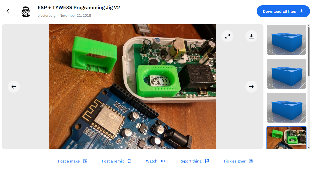

    @insmod I think he meant a jig for a beginners, like the one that is used to flash ESP8266 TYWE3S:
    ESP programmer with a green TYWE3S jig on a table.
    Source: https://www.thingiverse.com/thing:3231225

    >>21473692 I can understand that, but no module is specified, so it must be just a chip soldered on board, like other known plug. And creating a jig for a chip, considering how small it is, is impractical and i have doubts about its possibility.

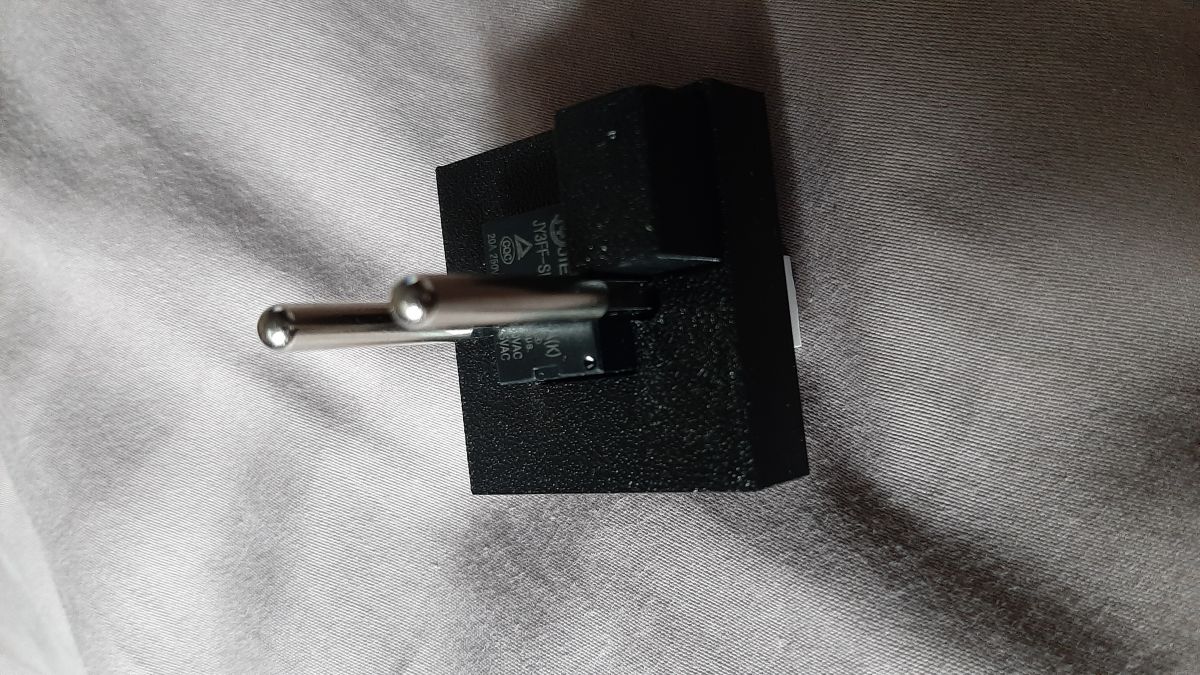

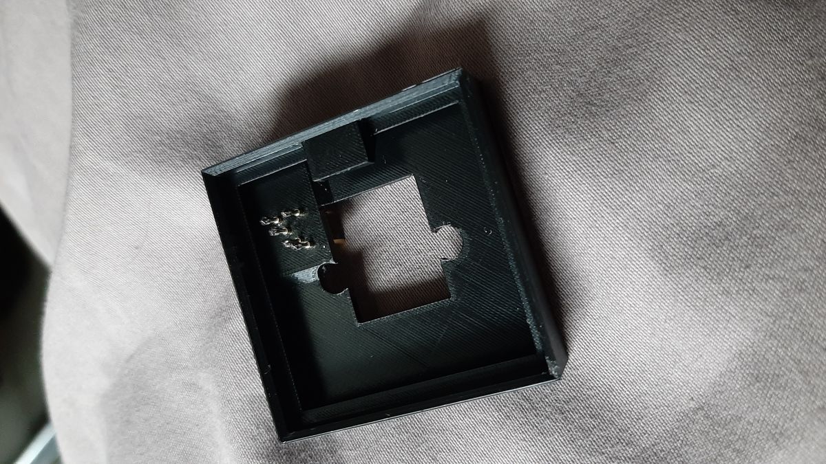

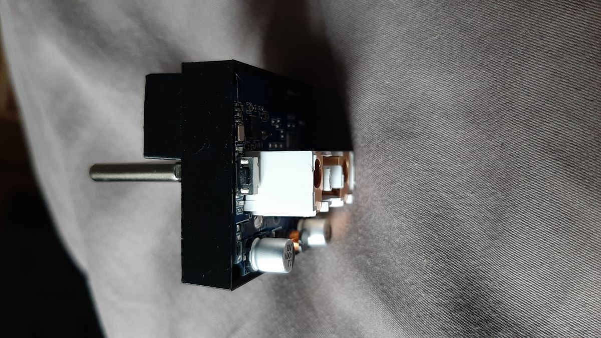

  • #10 21476597
    jannie_doedel
    Posts: 9
    Here are some photos.
    and the stl files.
    Black plastic casing on a gray background with a rectangular hole in the center.
    Close-up of an electrical plug.
    Circuit board with mounted switch and capacitors.
    It was printed on a Bambu Lab X1 Carbon with 0.2 mm nozzle in PETG
    • ecr6600_programmer_stl.rar (56.46 KB) You must be logged in to download this attachment.

    cool. so, yes. looks like it's one of these >>21473698
    did you manage to take a backup of the ECR6600 firmware?
