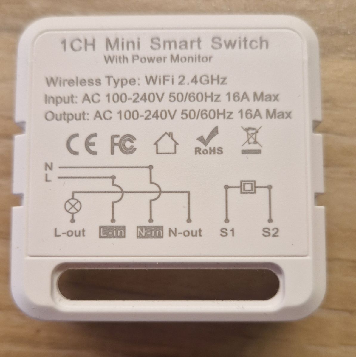

    Got some mini switches to check for 2026.

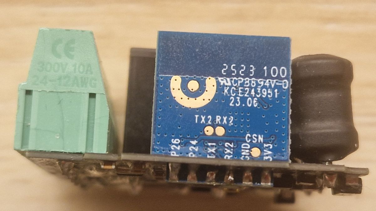

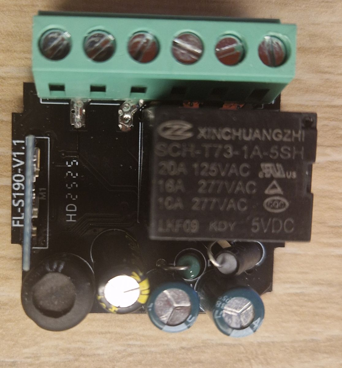

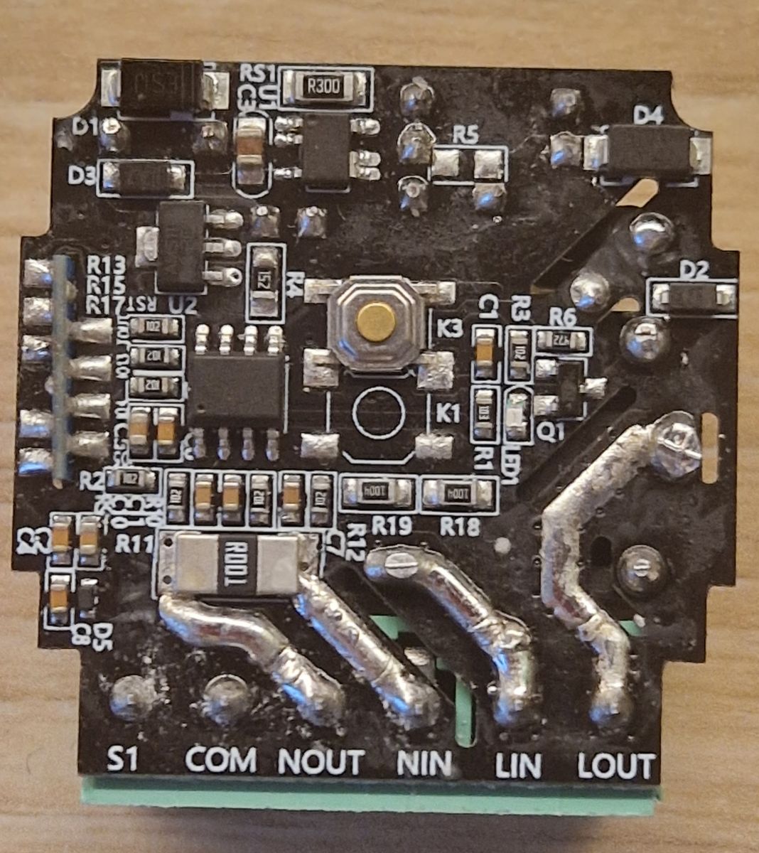

    This one is rather unusual, it has BL0937 metering chip, which I have not seen in mini switches yet. CB2S module is mislabeled on this switch. Has usual standard BP2525 and AMS1117 3.3V regulator chips. There is space to upgrade capacitors.
    Config should be like this (not tested)

    WiFi 1CH smart switch with technical specs and wiring diagram on white casing
    Relay module with terminal block and electronic components on a black PCB
    PCB with electronic components, labeled connectors, and visible solder paths

  • #3 21812636
    Posts: 14764
    Rate: 12898
    What do you mean by mislabeled CB2S? VDD pins, TX, RX swapped?
  • #4 21812661
    miegapele
    Posts: 173
    Help: 15
    Rate: 29
    Yes, labeling is mirrored, 3.3V and ground should be on the opposite side.
    Electronic module with blue PCB and green terminal block in close-up
  • #5 21813796
    Posts: 14764
    Rate: 12898
    Ah, again... I'm curious whether we are still seeing this single mislabelled batch, or is there a factory that keeps producing it, or... what's going on with it, in general.
  • #6 21814757
    miegapele
    Posts: 173
    Help: 15
    Rate: 29
    The date code is 2025 so this is not the same as previously seen with date code 2023. Seems like new batch.
