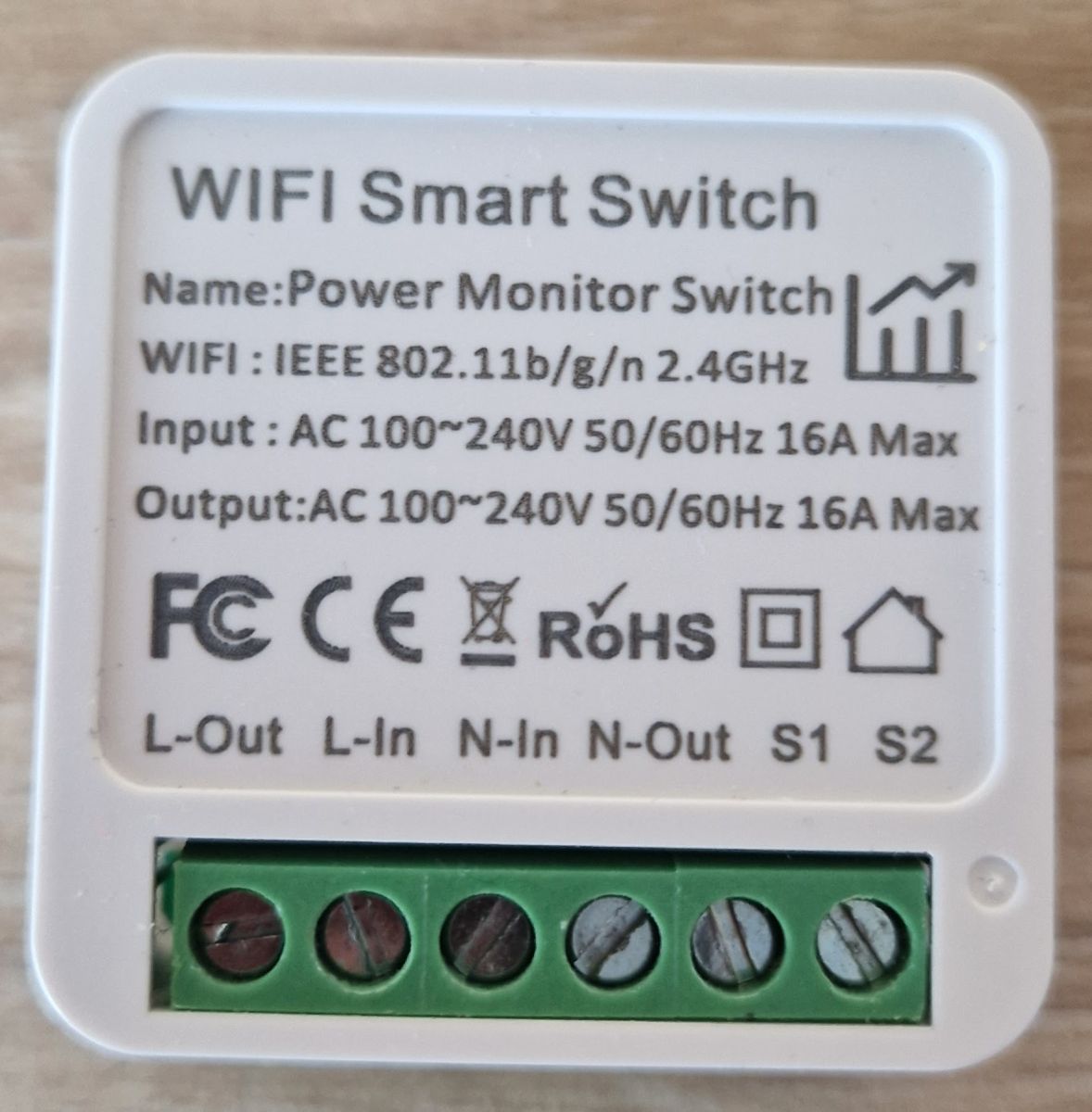

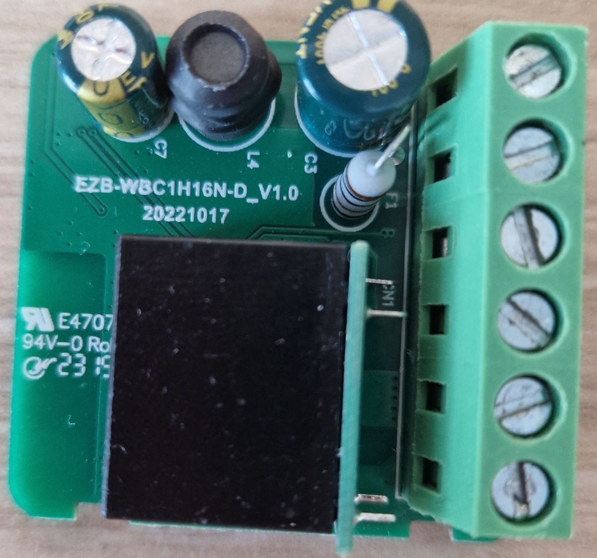

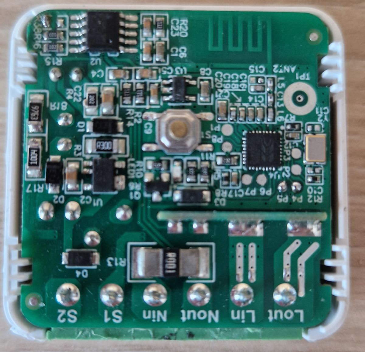

    This is another smart switch with BK7231N and power monitoring. There is similar already posted with mostly same pcb, but without BL0942 chip. Mostly standard affair, easily flashable, and capacitors are accessible for replacement. Board is marked 2022 year, but standard flasher can't extract config, so might have new firmware.
    Close-up of printed circuit board with electronic components and labeled terminals Close-up of an electronic control module with capacitors, terminals, and model marking. Wi-Fi Smart Switch module with technical specs and terminal connectors
    Config looks like this, not sure what's the deal with that RF pin, probably wrong:
    Device seems to be using CBU module, which is BK7231N chip.
    - Relay (channel 1) on P15
    - WiFi LED on P6
    - TglChannelToggle (channel 1) on P14
    - RF Pin on P23
    - Pair/Toggle All Pin on P8
    - BL0942 (?) RX on P10
    - BL0942 (?) TX on P11

  • RF pin mentioned in boot log, likely different PCB layout

    older v2 SDK. common 1.3.10 cloudcutter-patched firmware version. There's even mention of the RF pin in boot log. I wonder where the components would have gone, I don't see an obvious area. I guess fw was made for different PCB layouts?
