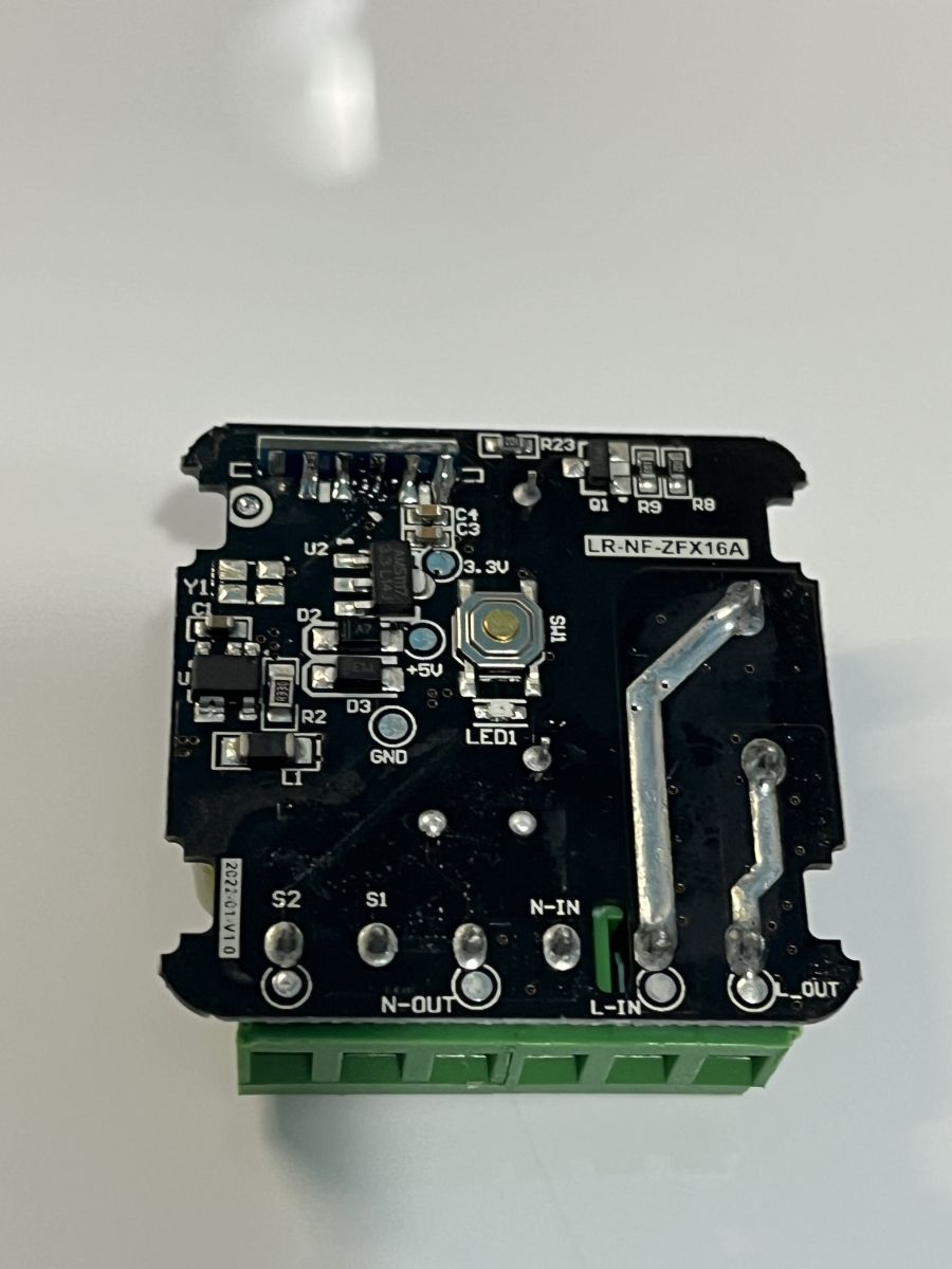

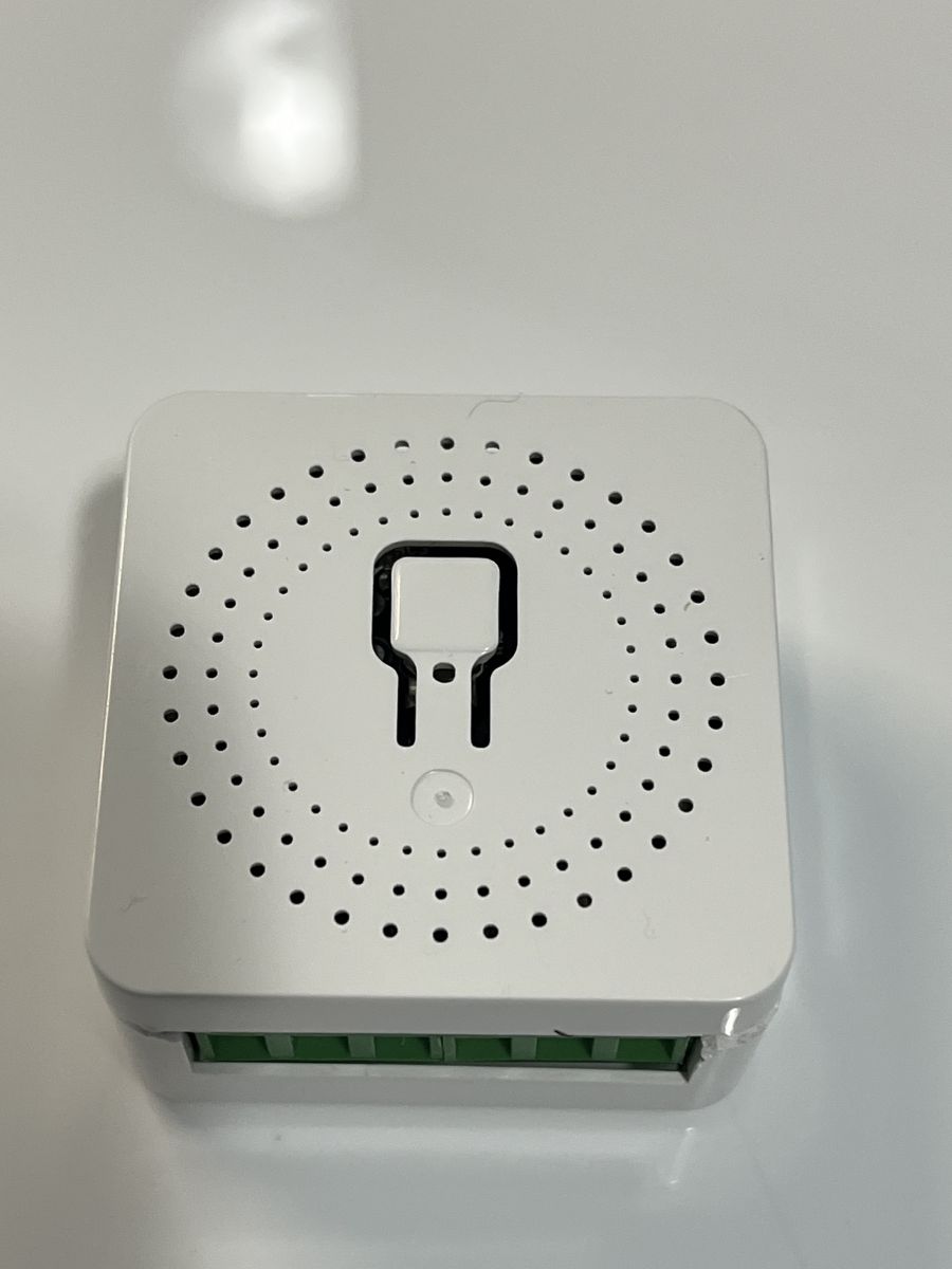

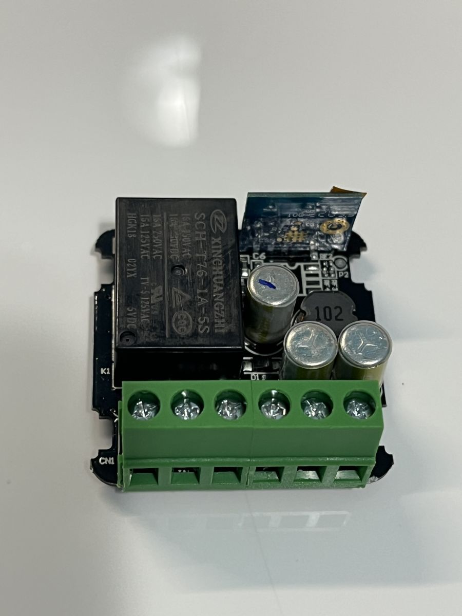

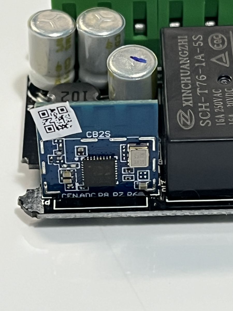

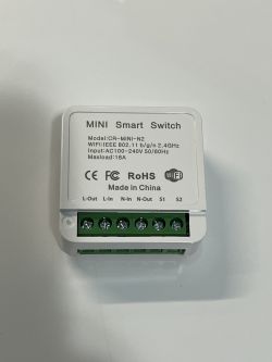

  • BK7231N/CBS2 Mini Smart Switch CR-MINI-N2 gets a full function pinout.
  • It flashes easily with Tuya-Cloudcutter using the Tuya Generic profile.
  • Pin mapping lists P7 TglChanOnTgl ch 1, P8 LED_n ch 1, P11 Btn ch 1, and P24 Rel ch 1.
  • All functions work perfectly after flashing.
  • Purchased from Amazon.
    Can easily flash via Tuya-Cloudcutter using Tuya Generic.
    Pinout for all functions. All work perfectly.
    PinNameChannel
    P8 LED_n ch 1
    P11 Btn ch 1
    P24 Rel ch 1
