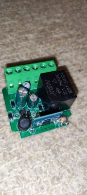

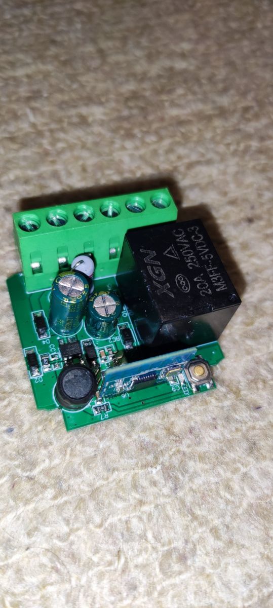

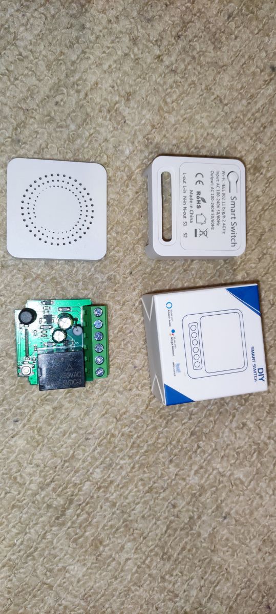

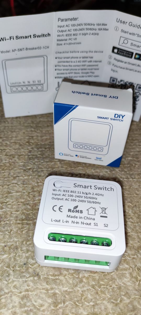

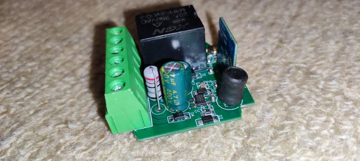

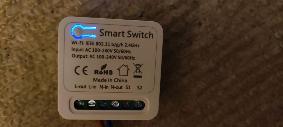

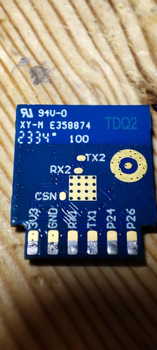

    I thought I'd give this device a look-over as I hadn't had one with the toggle button in the top left of the front casing. Maybe I'd get the T34 as seen in https://www.elektroda.com/rtvforum/topic4036852.html posted by @Advian1
    The unit, as if often the case, from Ali Express. https://vi.aliexpress.com/item/1005006014373963.html
    Smart Switch 16A Wi-Fi with 2.4GHz on Digitaling Store, promotional price £3.44.

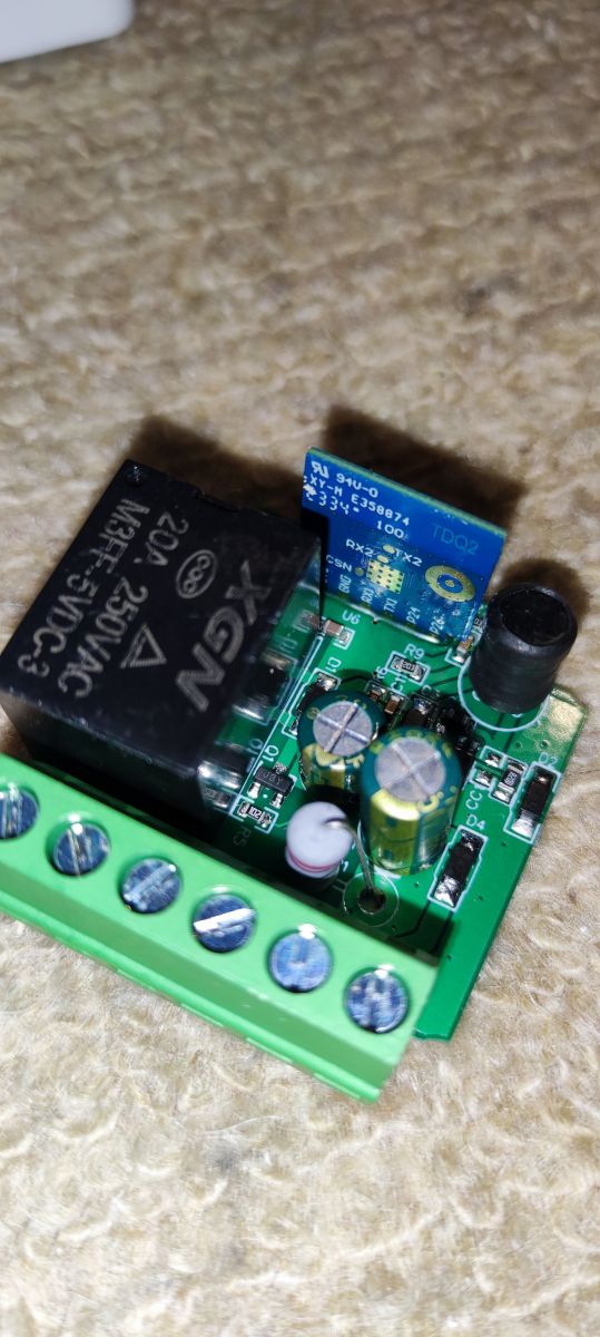

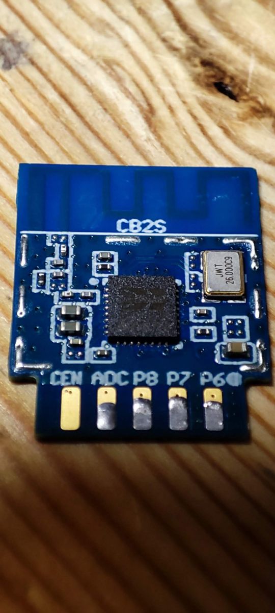

    There is no power monitoring chip and only a standard CB2S module with BK7231N. Kind of interesting the relay print suggests 20A and there are unused pads for the seemingly more popular central push button and LED.

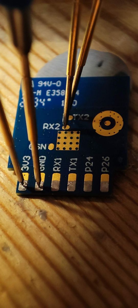

    Close-up of a CB2S module with visible pins 3V3, GND, RX1, TX1, P24, P26, and probes connected to the pins. Components of a DIY smart switch, including a casing, PCB, and box. CB2S module with integrated circuit and connectors on a wooden background. Electronic module with pins and labels on a wooden surface View of the device's circuit board with connectors and electronic components. Close-up of a green PCB with clearly visible solder pads labeled SW3 and LED2. Relay module on a circuit board with green terminals. Close-up of an electronic module with a relay and capacitors. PCB with a relay and CB2S module on a beige surface. Wi-Fi smart switch with manual and box. White square Tuya switch with a dotted pattern and packaging with QR codes. Smart Switch with technical label and illuminated LED.
    I desoldered the module and captured the boot log on RX2/TX2

    The firmware version 1.3.10 is on the known patched list so no good for Tuya-Cloudcutter.
    I attach a factory firmware dump and the pin assignments are as follows
    - Pair/Toggle All Button on P8
    - WiFi LED on P7
    - TglChannelToggle (channel 1) on P26
    - Relay (channel 1) on P24
    Despite this being so similar to other 16/20A breakers in the device list, there isn't an exact pin match, so here is OBK
    • readResult_BK7231N_QIO_2024-26-2-19-42-17.bin (2 MB) You must be logged in to download this attachment.
  • Autoexec.bat maps LED pin to WiFi and relay states
    #3 20981399
    Posts: 5209
    Help: 446
    Rate: 914
    to complete the setup, the autoexec.bat:
    alias mode_wifi setPinRole 7 WifiLED_n
    alias mode_relay setPinRole 7 LED_n
    alias mode_relay2 setpinchannel 7 1
    // at reboot, set WiFiLEd
    mode_wifi
    // then, setup handlers
    addChangeHandler WiFiState == 4 mode_relay
    addChangeHandler WiFiState == 4 mode_relay2
    addChangeHandler WiFiState != 4 mode_wifi
    behaviour is:
    -flashing blue LED on wifi connecting
    -LED off with relay open (off)
    -LED on with relay closed (on)
