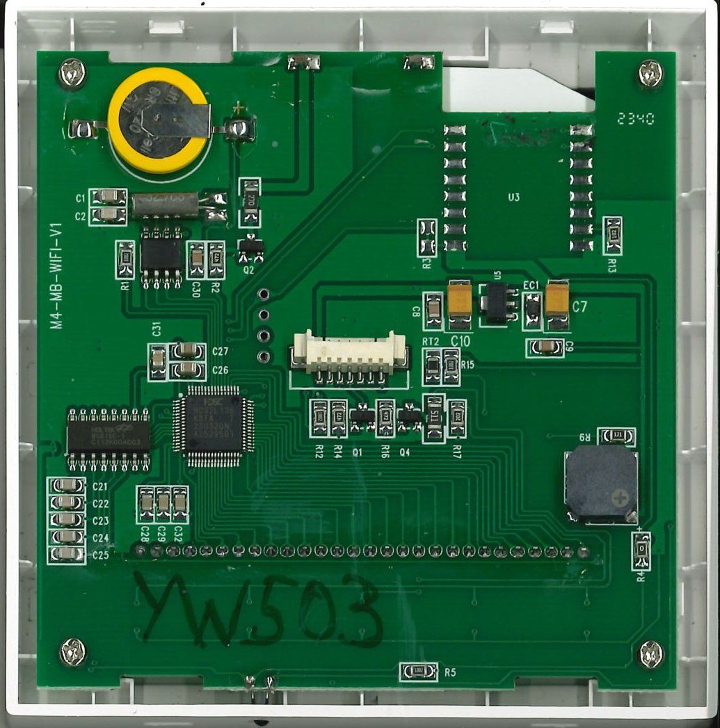

    bought with no wifi and retrofitted an esp8266 (esp32 also possible) module with tasmota.:
    Printed circuit board with electronic components labeled M4-NB-WIFI-V1

    I saw them being sold with no WiFi version. Are you saying that.... they still come with MCU supporting TuyaMCU? And you can just... solder then WiFI module like that and it will work?
  • #3 21818866
    insmod
    Posts: 1432
    Help: 168
    Rate: 455
    >>21818856
    Yes, and it's usually like this. I got 3 thermostats that way, Avatto WT100, ME81H and a newer revision of ME81H. All originally without wifi but converted to it with ESPs.
    At least if there is a version with wifi, then version without wifi will have everything needed for conversion. Though i'm unsure about pet feeders.
  • #4 21819026
    vincenzoernst1
    Posts: 100
    Rate: 7
    >>21818856
    yes as @insmod said there must be a wifi version also available, then the non wifi version often has just the wifi module missing (in 9 out of 10 imho).
    not in any case it will be just soldering in the module and you are good to go. often you also have to check the pins so that the module is able to boot (isolate pins or make bridges.). this differs from model to model.
