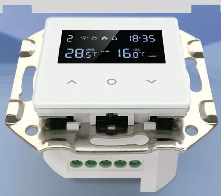

    Does anyone yet have experience with Avatto WT200? A small thermostat that fits European standard electric appliance series (50x50 mm front size). Tuya smart life WiFi.
    Avatto WT200 thermostat with display and touch interface.

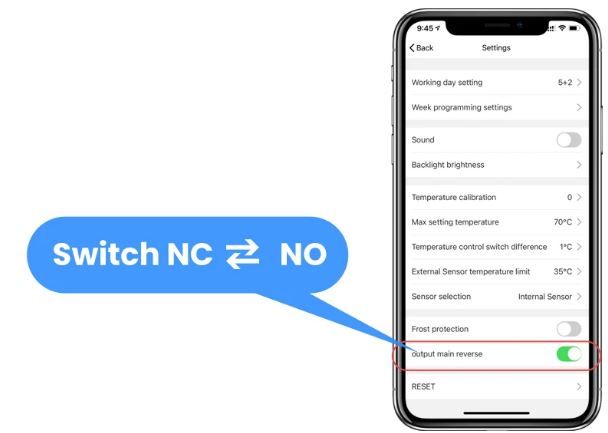

    The App says that you can switch logic from "normal closed" to "normal open", which would make it suitable for both heating and cooling usage on the same underfloor heating circuit. If cooling is activated, it should switch logic (has to be done in home automation software, of course). Smartphone settings screen for an app allowing switching logic between normally closed and normally open.
    I ordered two of them from Avatto official store, said to be here within a week. Let's see. Will post pictures from inside, if not yet available on this page.

    >>21103586 Obviously there is already support for the device (with original firmware) in Home Assistant:
    https://github.com/make-all/tuya-local/issues/1166
    Contains also information about DPS mappings.
    Especially this data point is of interest for me: 常闭型_常开型","105"
    It changes the valve type from "Normal open" to "Normal closed"

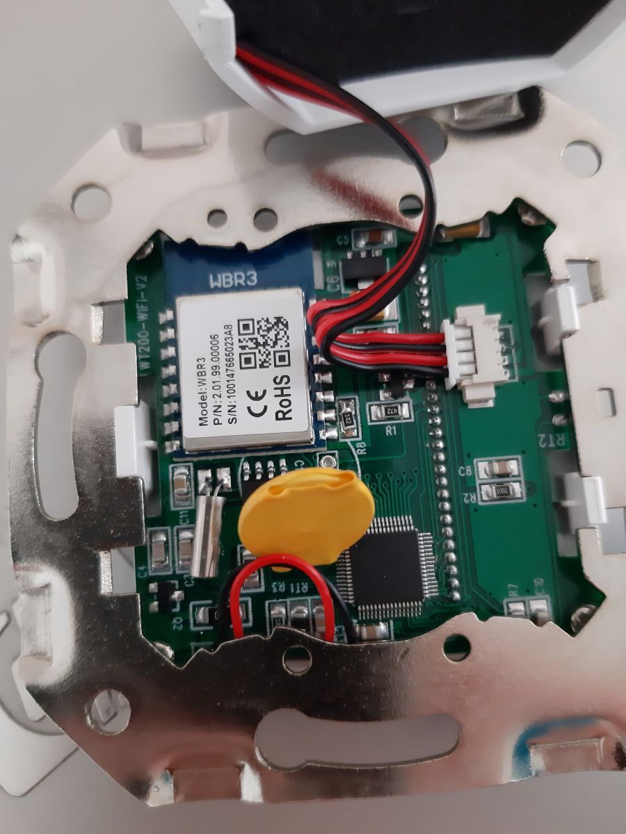

    insmod
    Posts: 1432
    Help: 168
    Rate: 455
    It's possible, that your device will arrive with WBR3, which is RTL8720CF and no support in OBK yet. You will have to flash libretiny. I can share my esphome WT100+ESP12F config, it should be similar enough for you to adjust.

  • #9 21111629
    io2345
    Posts: 273
    Rate: 7
    >>21109432 Arrived some minutes ago, and is indeed WBR3 (as suggested by @insmod). Probably not supported here, right?
    WBR3 electronic module mounted in a metal frame.
