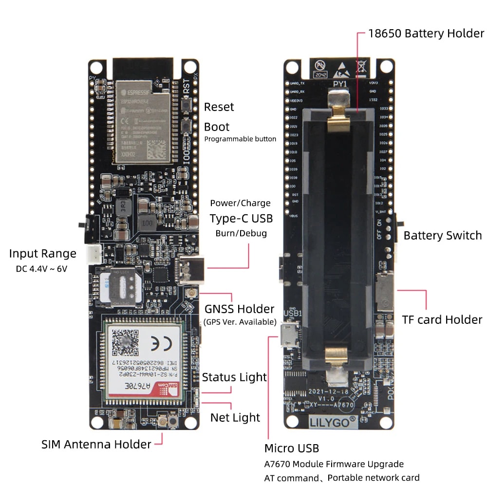

    Hello, I have a question for professionals regarding the LILYGO® TTGO T-A7670E board. I don't paste links, because you can google it on Ali for PLN170, and in Poland the highest price is probably PLN700 ;) .
    My question is: is the modem boot from the battery pack programmed in hardware, or uploaded code from the ESP32?
    Why my question? I bought two boards and one won't fire the modem on battery and the other fires up. The former was plugged in and programmed by Thonny, and in order to upload the code you have to clear the memory; this is the default setting, so I don't know if I deleted some default code when uploading, or if the board is just faulty.
    Please don't laugh at my ignorance (I'll return the favour with my expertise on bees or cookers ;) ), and here I am enjoying tinkering with something, trying to create a gateway that sends temp and weight data.
    I've connected the latter for now, but without uploading, then I have no file preview and no comparison in the shell, only the parameters are displayed.

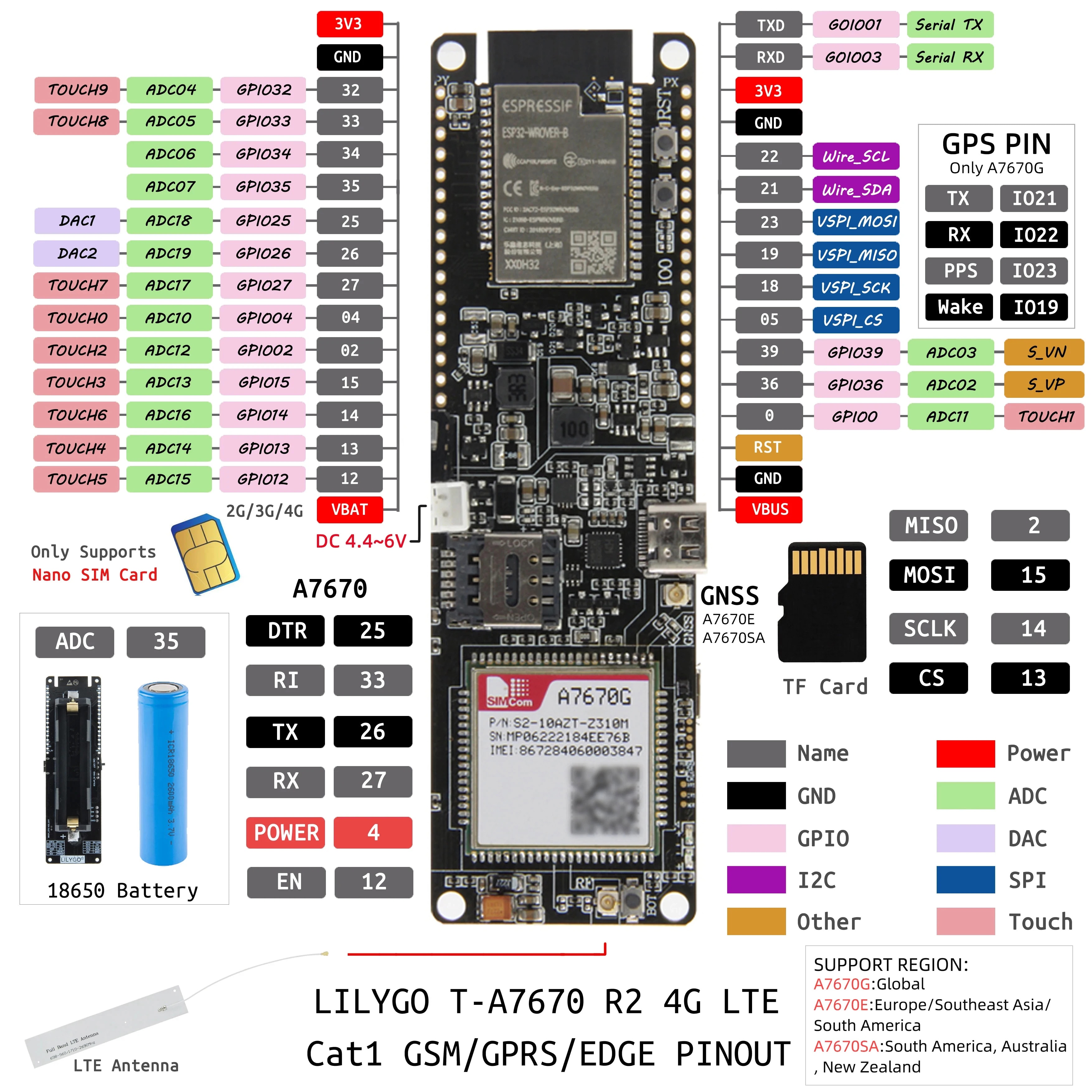

  • Battery powers ESP32 but not modem on T-A7670E
    #12 21831304
    baru0
    Posts: 49
    Rate: 16
    >>21831283
    Because it works, i.e. executes the program code, connected to USB or power supply, but it doesn't run the modem from the battery - here is the problem.
    Only the ESP32 starts up on battery (executes command - blink diode), diode connected to ESP pin.
    And the error in the terminal could be because the board has a program preloaded that starts it up when it's connected to power (USB here, to read what it's doing) and at the same time probably cuts off access in the terminal. (The residual message it managed to get between reboots, I think, is 'data sent, I'm turning on listen'.)
    This board is a two-module board, are you familiar with it? Probably so, although I couldn't find any mention of this model on Elektroda.
    Anyone has, had dealings with it? I would be happy to get in touch .

  • Flash dump to inspect virgin board contents
    #15 21831370
    baru0
    Posts: 49
    Rate: 16
    >>21831338
    For me it's simpler in Thonny.
    It all works, it's as you write, thanks, but it says the problem is "not switching on" (not executing the program from the battery).
    TvWidget wrote:
    I can't understand what you write
    It's a shame, I was asking about "what a virgin plate might have in memory and how to see it".
    baru0 wrote:
    If ( the virgin one - not uploaded yet ) boots itself on the battery and starts the modem , for example; does it have the preloaded code
    I have uploaded these posts to ChatGPT. Here is the response ;)
    This is what you are looking for: flash dump (dump). Then you can:
    keep a copy,
    even upload back to a second disc.
    If anyone could help with a piece of code on how to run the modem from the battery, I would appreciate it.

  • Flash dump copied to restore battery startup
    #17 21831407
    baru0
    Posts: 49
    Rate: 16
    >>21831381
    Are you making posts? To a visitor (maybe a layman), who has uploaded the soft and works, you explain how to do it?
    If you want to help, know how: what you're explaining would just erase that first memory, otherwise you won't get to Thonny.
    baru0 wrote:
    GPT chat - wrote :This is what you are looking for: a flash dump (dump). Then you can:keep a copy,even upload back to the other disc.
    "Stupid chat" understood me and answered half the question and you didn't.
    Sorry, if anyone wants to really help me, please do and I will be grateful.
    Edit: flash ripped beautifully from the new one and uploaded to the older one . The old one on the battery now fires without a problem, so it is working, half the problem solved.
    Now need to write code that will do it like the original , because from the binary it can not be extracted , at least by me ;)
