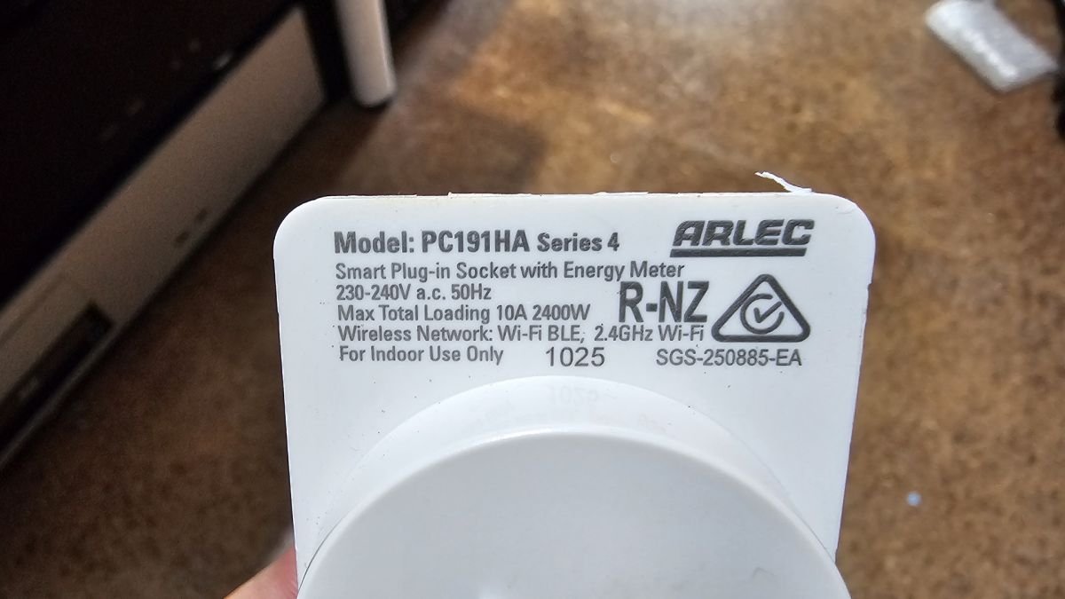

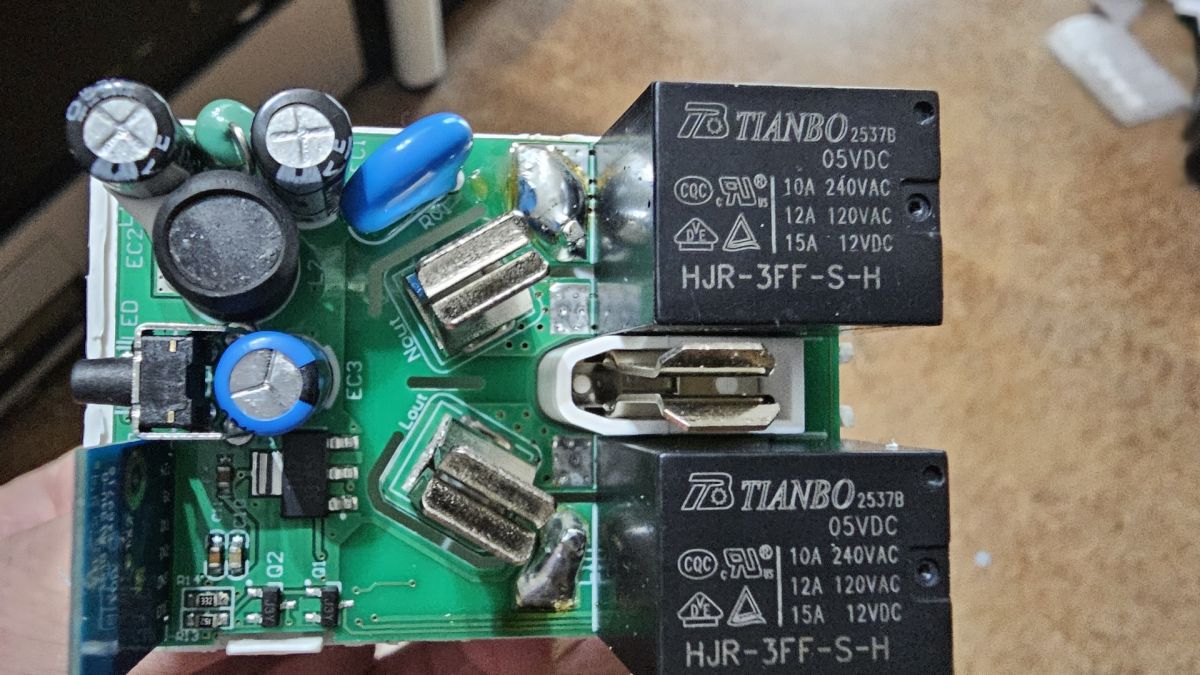

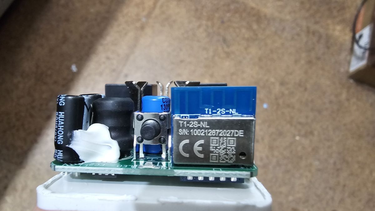

    Arlec Grid Connect PC191HA Series 4 (BK7238 / T1-2S-NL)
    Close-up of a circuit board with a push button and a T1-2S-NL module on a white base PCB held in a hand with two black TIANBO relays and electronic components Label of an ARLEC PC191HA smart plug with energy meter, showing specs and compliance marks
    Unsuccessful with CloudCutter.
    - Wi-Fi LED on P8
    - Button (channel 1) on P24
    - Relay (channel 1) on P26
    Device seems to be using T1-2S-NL module, which is using BK7238.
    Device internal platform - T1, equals BK7238.

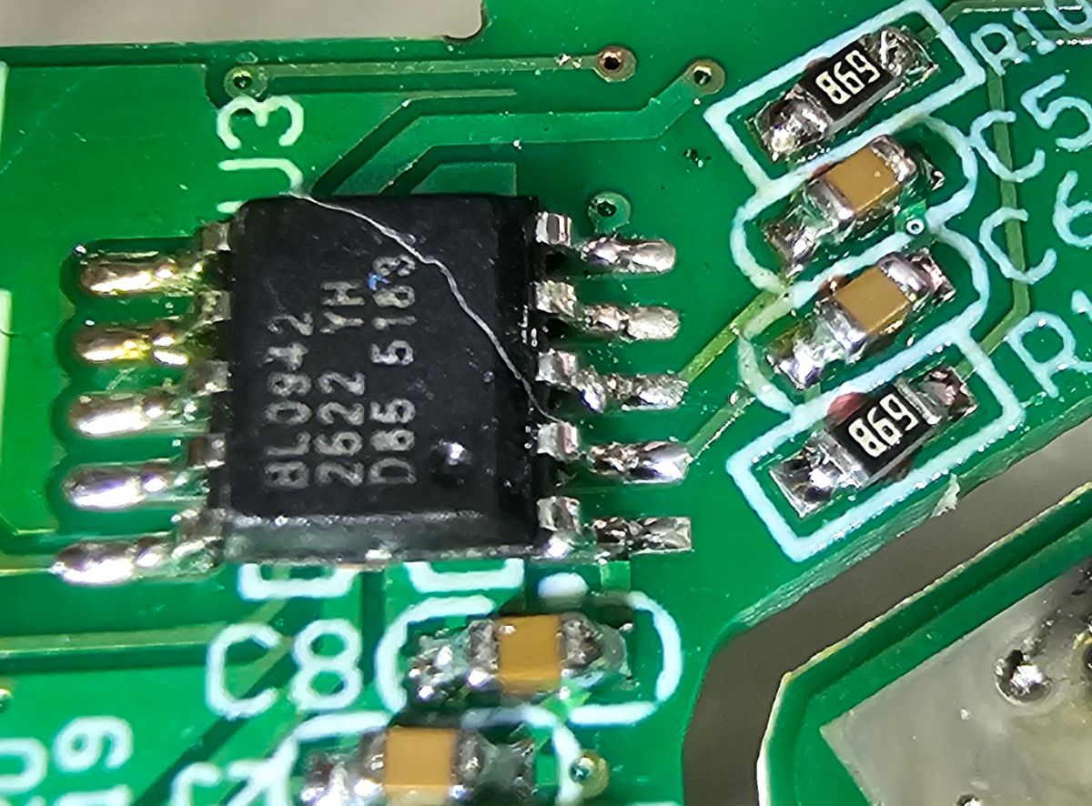

    Close-up of a green PCB with an IC and SMD parts, including resistors marked 889.
    Looks like the Series 4 uses a BL0942 for energy measurement.. not identified above?
  • BL0942 startup command enables energy monitoring
    #3 21901987
    andrewmarkcongdon
    Posts: 22
    >>21901308
    Just need to add
    startDriver BL0942
    in startup, and all seems to be working.
