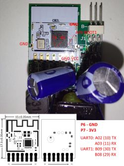

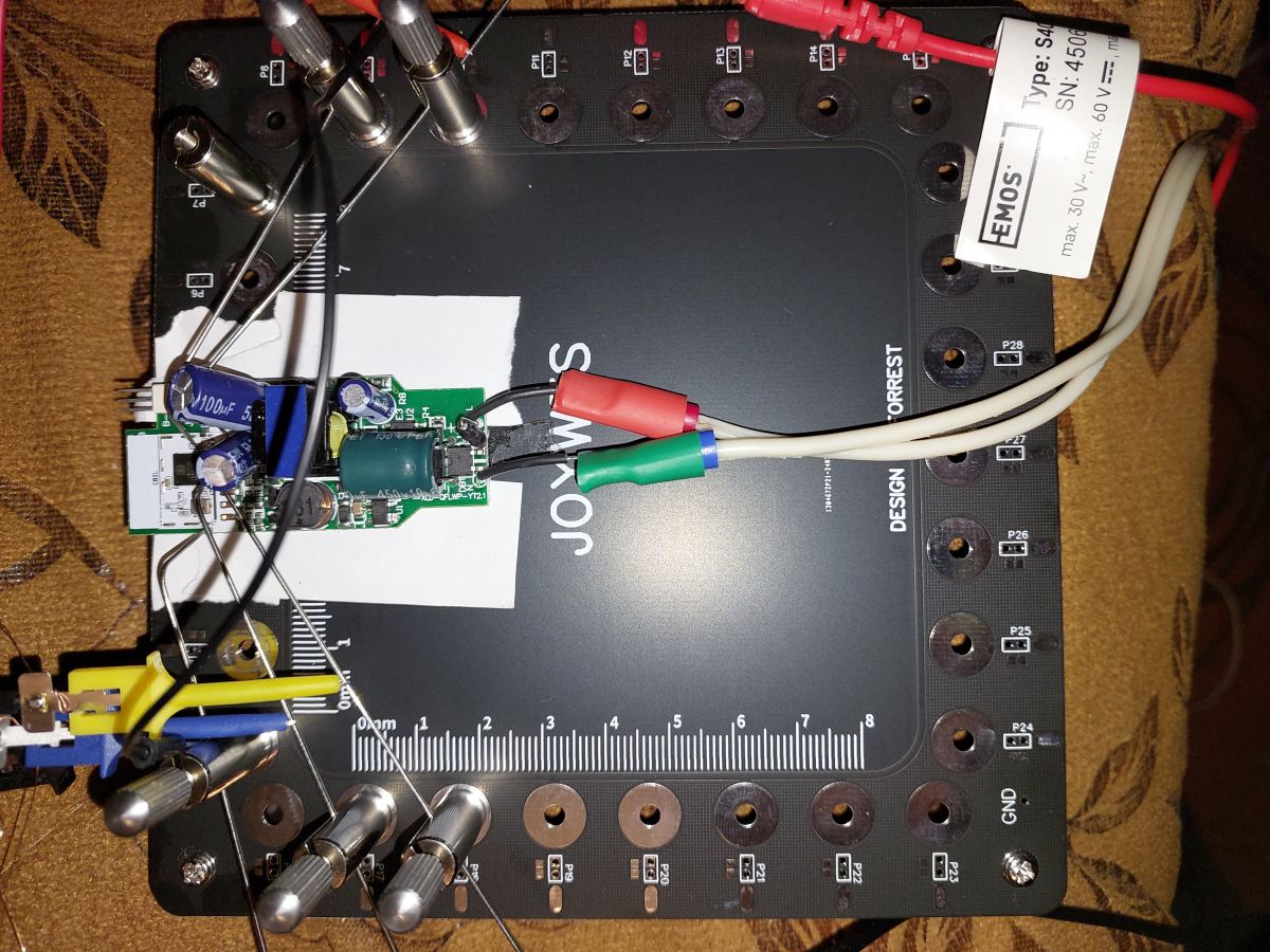

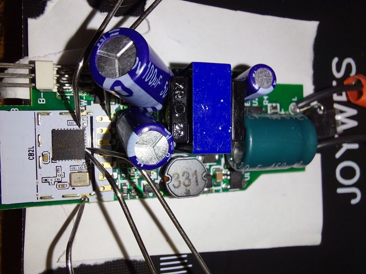

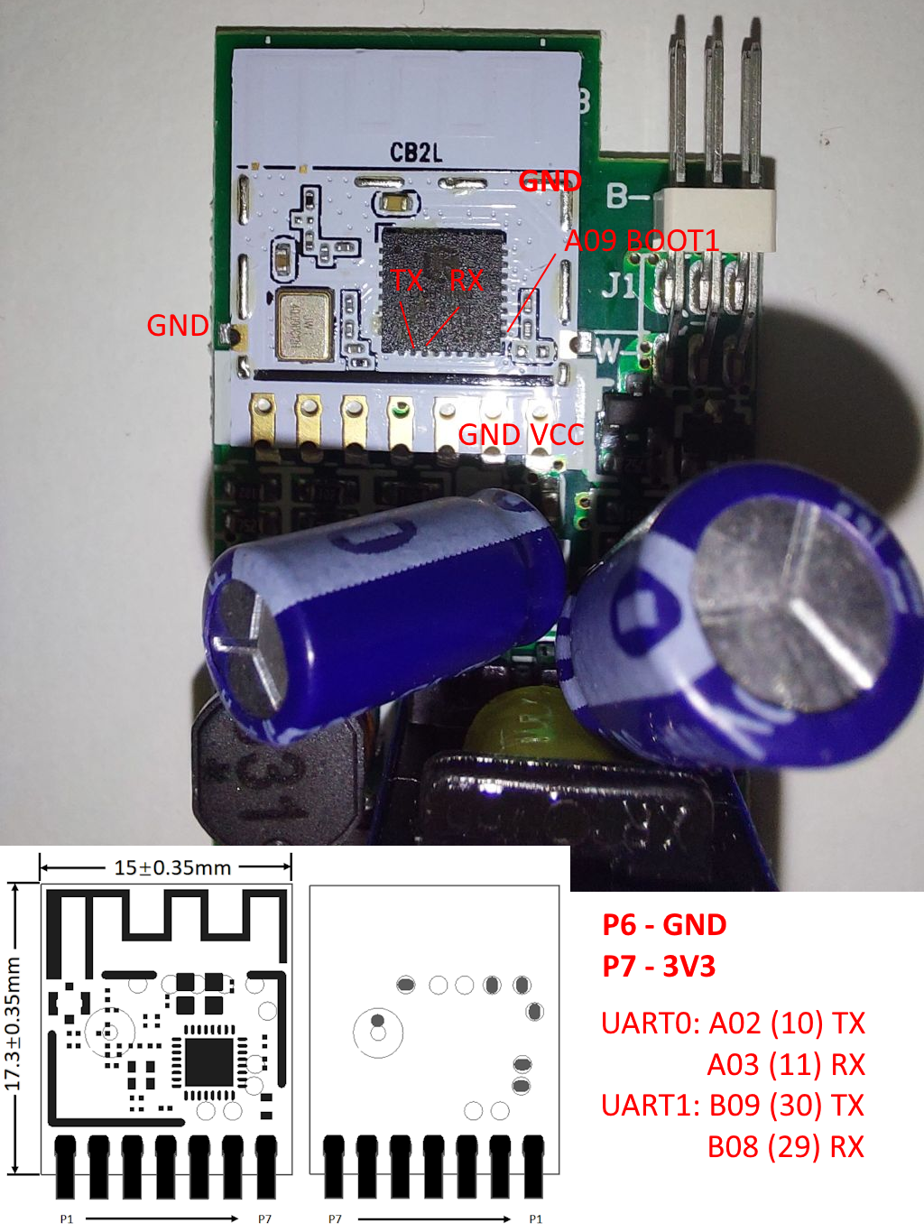

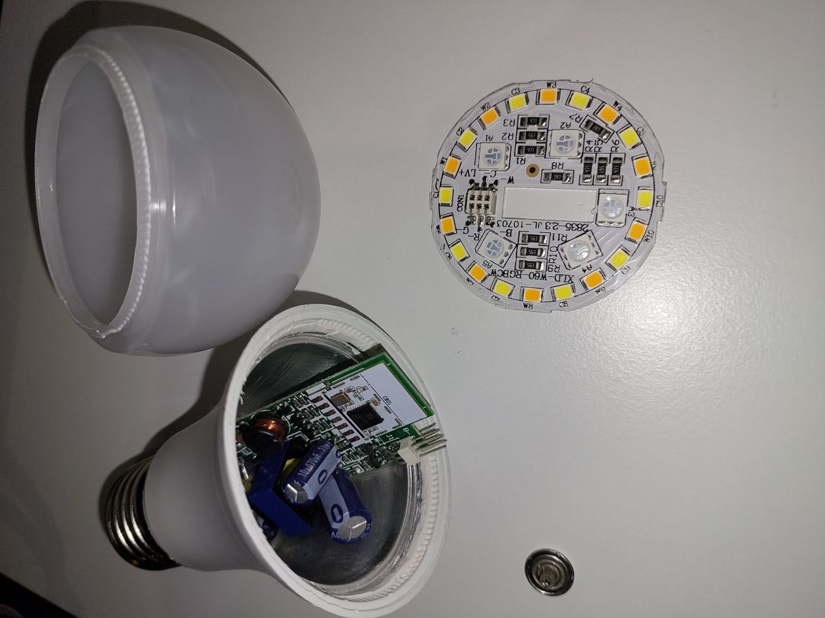

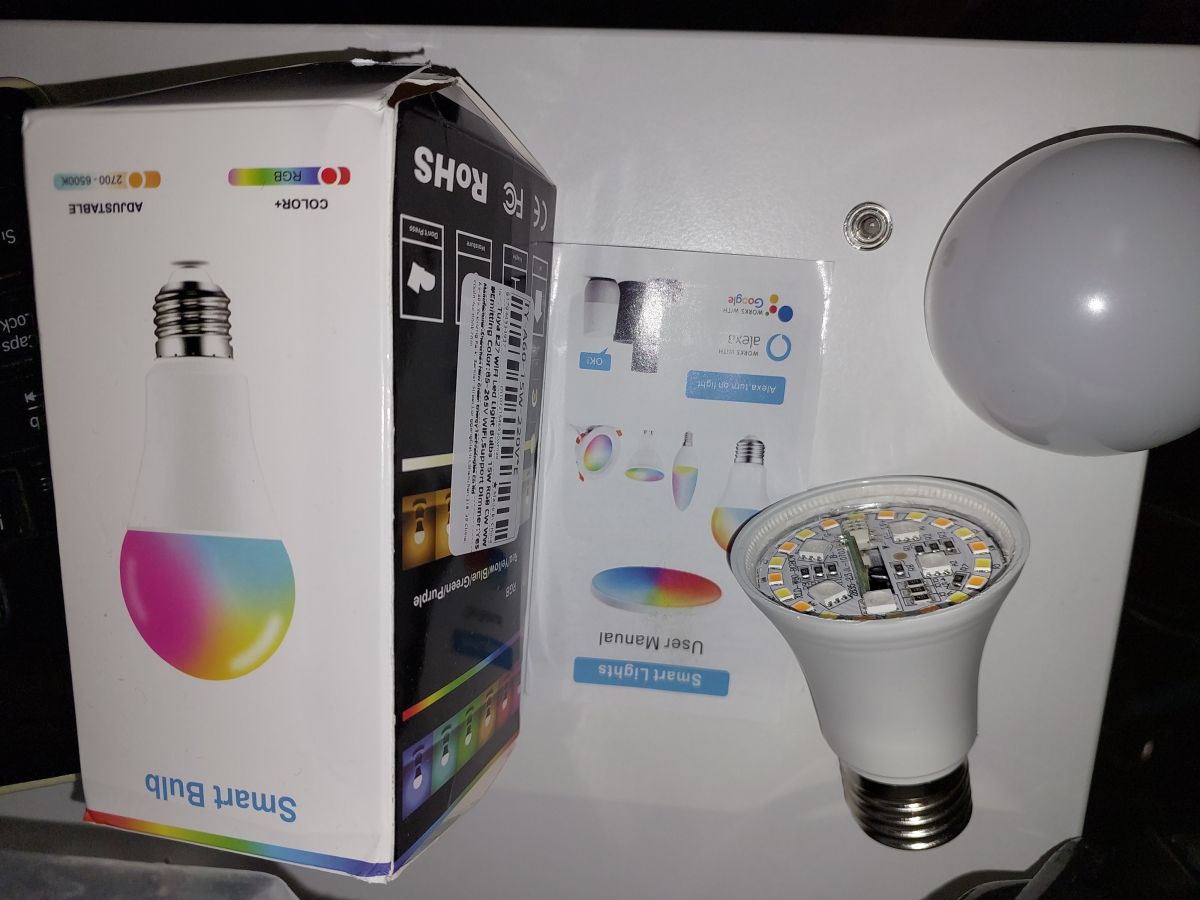

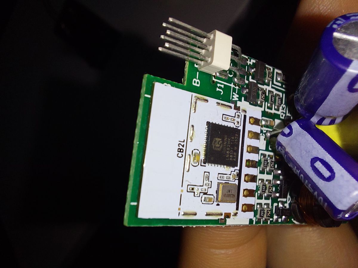

    Recently bought new "smart" device - Smart LED Bulb, E27, Wifi - XLD-WIFIBLE-A19
    Bulb can be easily disassembled without any issues. Inside there is CB2L with LN882H.
    Put it on the table and with help of needles was able to power it from USB to UART and successfully downloaded original firmware (it is "pristine", I did not turned the lamp on before). And flashed OpenBeken for LN882H. No soldering needed.

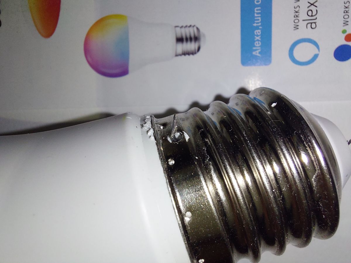

    Just when was assembling it back - drilled small hole for the N wire and soldered it (see on pictures).
    In the end - it works but I disappointed by the WiFi range of the module - bulb cannot connect to home wifi if moved 1 room away (1 brick wall, 5m) from the router.

    Device seems to be using CB2L module, which is using BK7231N.
    And the Tuya section starts at 2015232 (0x1EC000), which is a default LN882H offset.

    Antenna obstruction may be limiting WiFi range
    #3 21901316
    max4elektroda
    Posts: 756
    Help: 48
    Rate: 187
    Might be "only" a poor design: looking at your pictures the antenna on the module seems to be partially covered by the LED PCB. What's the rssi shown on main GUI?
    Did you try before putting the module back? I would expect a better connection if my guess is right...
    Yes, but only in the same room, and did not notice RSSI values.
    But I think you are right about the design and antenna placement. Maybe it will be worth to drill another small hole, and put "external" antenna wire.
