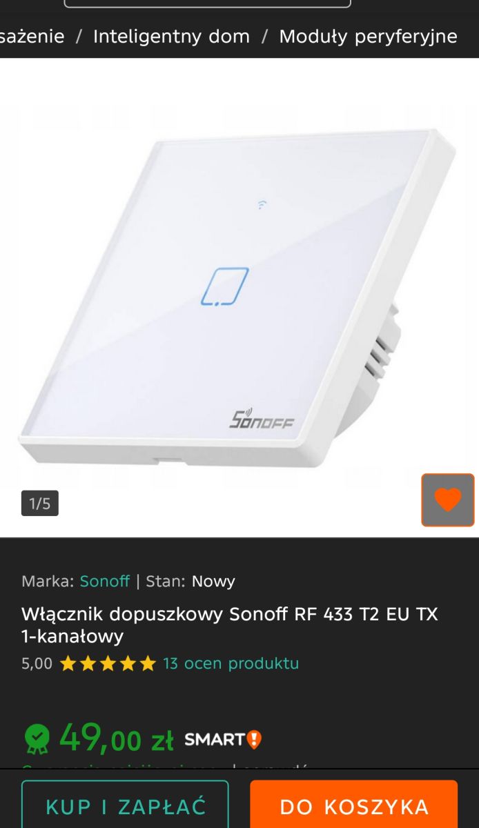

    Hi.
    The last time I bought a switch it was somewhere around 10 years ago, now I want to buy one from the same company but I'm puzzled by the battery power in the description, my old switches from this company don't have any batteries, what is the battery for?
    Screenshot of a listing: white Sonoff touch wall switch with logo and price 49.00 zł Technical specs list for Sonoff T2EU1C switch, 6 V power from CR2032 batteries and 433 MHz RF

    Rate: 3920
    Since there is a radio module in it (433MHz), this means that a power supply, for example from a battery, is necessary for operation. That is, to answer your question directly - the battery is used to power the communication module.

    Rate: 295
    They don't make any other single channel ones now, just with a battery?
    I'm looking for a single channel and all I see are with this battery.

    Rate: 1127
    I wonder how long this CR2032 will last.
    Since it can be overridden remotely, I guess the RF module must be active all the time and listening to what's going on in the circle?

    Rate: 295
    @Karachan
    There is just a lot of negative feedback about the battery dying quickly.
    I have two Smart Sonoff switches at home bought 10 years ago and they didn't have this battery.
    Also from what I've noticed they used this battery for the single channel ones in the two channel ones they don't have it anymore.
