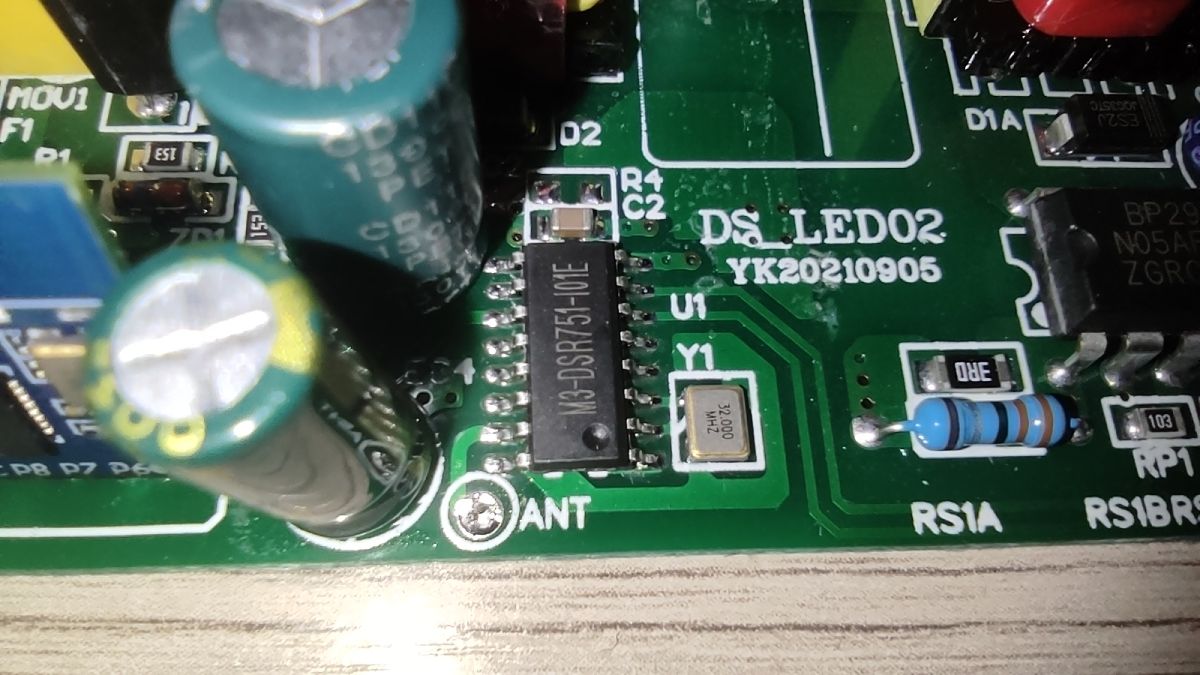

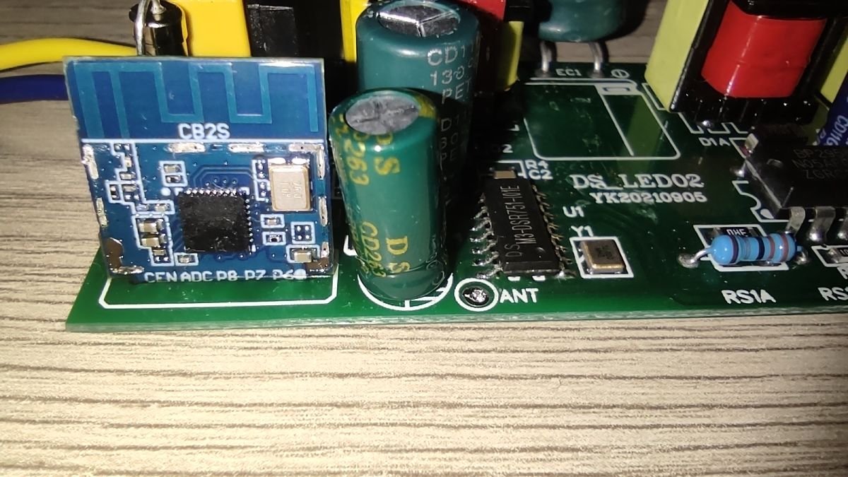

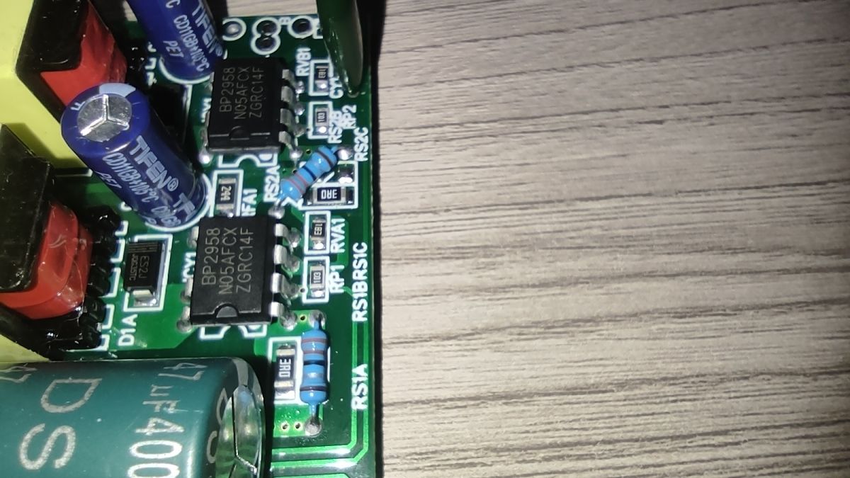

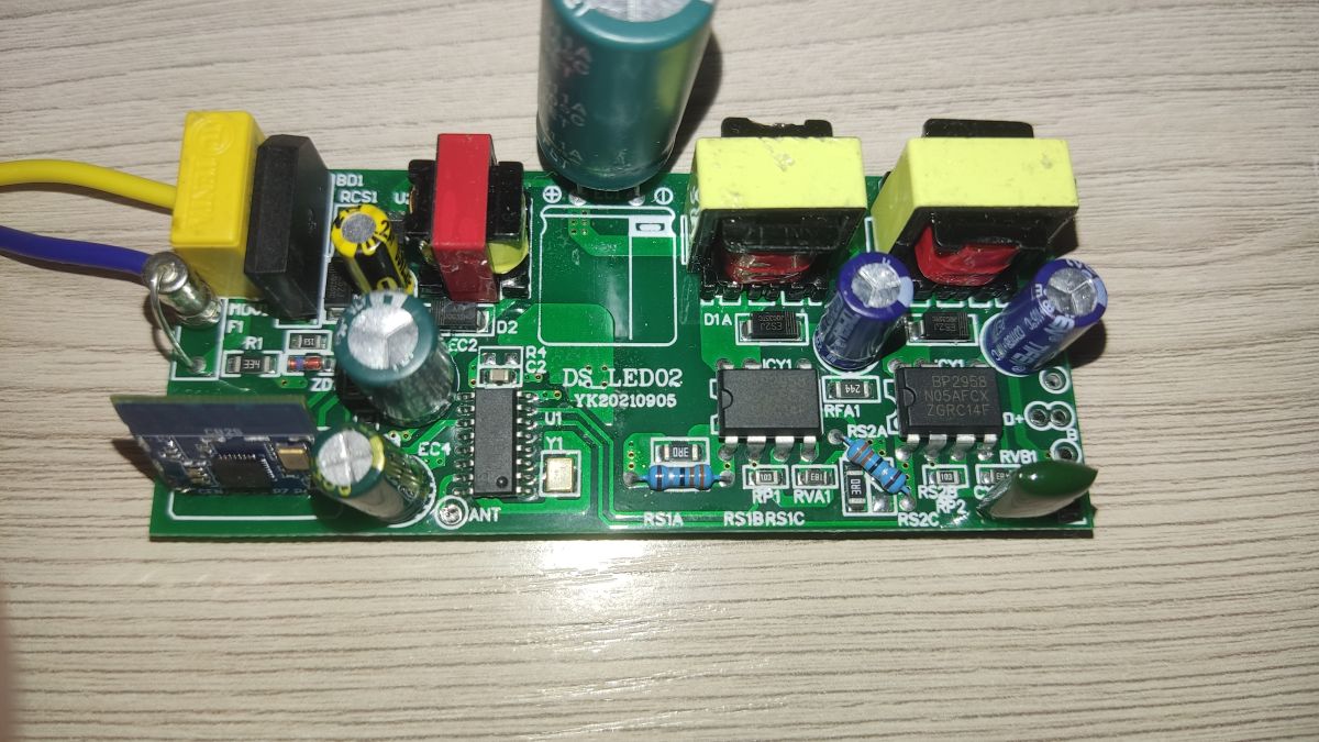

    Hello everyone. I got an LED driver for an LED chandelier. The CB-2S module (BK7231N) is soldered on the board, an unknown microcircuit and analog drivers with PWM regulation BP2958. On the CB-2S, only 3.3 V, GND, TX1, RX1 are soldered. Pins TX1 and RX1 are connected to an unknown chip directly, and this chip is connected from BP2958 to PWM pins. Does anyone have an understanding of how it all works? There are plans to flash on OpenBK.

    this is a TuyaMCU device. CB2S talks to the MCU over rx/tx. The M3-DSR751-I01E controls the LEDs
    Added after 4 [minutes]:
    assuming the device in this thread (PCB marked DS_LED02), is the same as the one with dump in here https://www.elektroda.com/rtvforum/topic4173909.html
    Is the N is DNS_LED02 in title a typo?

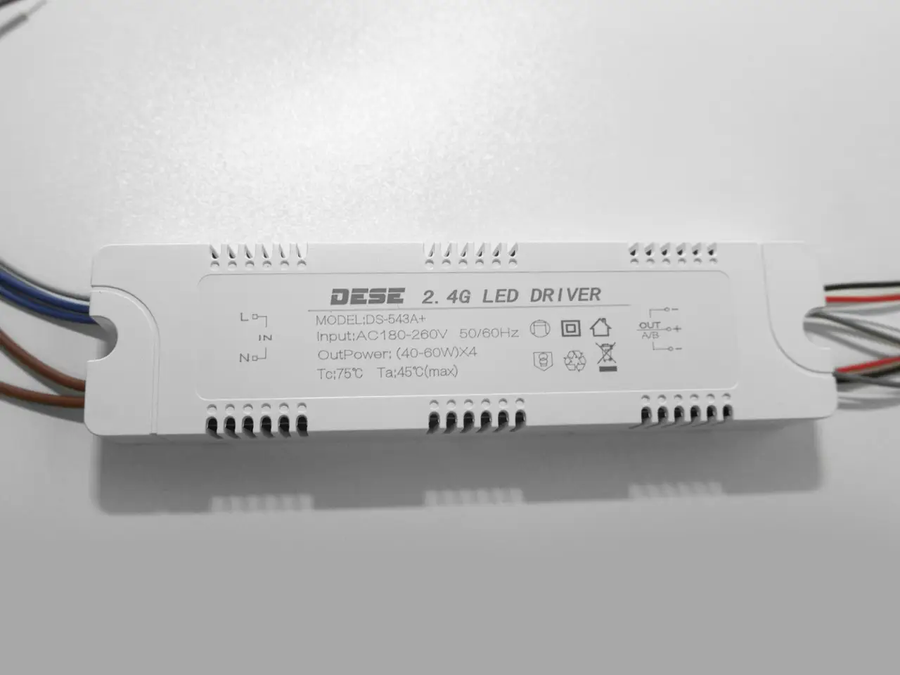

    also, what's your device? A 2.4G DESE - something like this?

    >>21906532 Yes), N This is a typo, it looks like the device in your photo. The connection lines are clear to me, I'm trying to find out which signal goes from the CB-2S to the microcircuit. The chip itself is strange, has a radio channel, because this module can be controlled via a radio remote control.

    Interesting, so M3-DSR751-101E with the crystal oscillator and antenna is used as TuyaMCU chip? Well, the "signal" is probably TuyaMCU traffic over UART.

    >>21909335 Unfortunately, I didn't get any further. The scheme of operation is as follows: microcircuit M3-DSR751. This is some kind of controller that controls the PWM drivers via radio control via a remote control, and the CB-2S module is an add-on to control it via WiFi, because there are versions of this LED driver without CB-2S.
